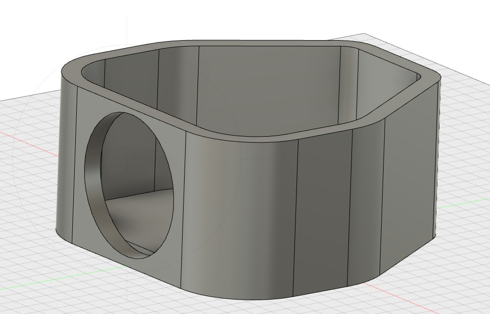

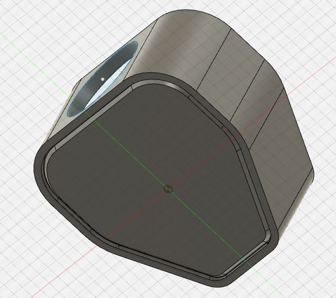

Joined 2008
I have just put together a simple test module to calculate the material needed. Without any optimization, one would print in ca 17 hours and 4 could be printed from one spool. The wall thickness is 10 mm and the divider is 8 mm - the outer shell will stay at least this thick, the separating layer will be definitely less.
For a 25 driver array I will need 50 pieces which would total in ca 18 days of printing 24/7 and 7 spools of filament per speaker. So the shell should weight around 7 - 8 kg including the base with another 6 kg for drivers. A bit time consuming, but certainly feasible. So the total weight should be less than 15 kg per speaker including polyfil, terminals and wiring. The enclosure should cost around 1/4 cost of the drivers. I hope the structure will be rigid enough and I will most probably run a threaded rod through the whole speaker with nuts and spacers at every module bottom. Maybe even two. The size would be M6 or M8, and still should not add too much to the total weight.
The 3FE22 will be flush mounted from outside, I am not sure if I will like the look, so I will think about adding some sort of cloth cover into the front.
It will take a few test prints to make the seams as little visible as possible. With 0.2 mm layer height this should be definitely doable.
This project will end up in the living room as main speakers as this is the only form factor that will fit the front wall. The left speaker will replace a green plant, but I will not tell my wife yet:)

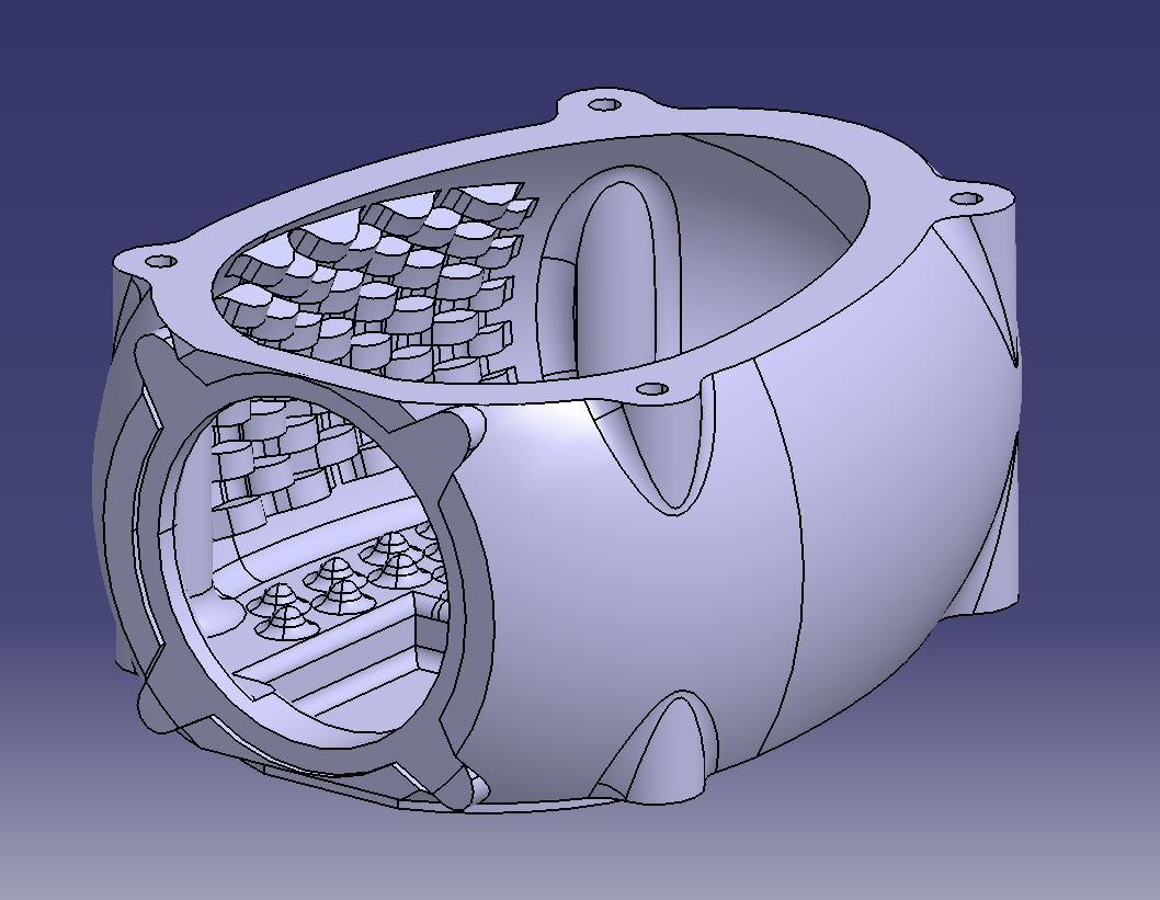

I've been trying to decide what project to do. I just don't know enough about speaker enclosures to be confident that I'm not going to end up with something awful sounding.
I start over thinking it and I want to add built in sleeves for the rods. Nesting profiles for mechanical interlocking. Egg carton patterns printed into the walls and floor to block resonance. Printed in flush mount for the speaker.

I see you have similat ideas as I do. The pattern on mine would be more similar to the low profile acoustic foam so that the curves are smoother for easier print. The nesting on mine would be around the whole top/bottom with 45 deg chamfer for easier printing. The final shape will be also more similar to yours or wesayso's TC9 array. And mine will be nost probably held together by a series of screws.
I am now investigating driver alternatives.
A line array like this is easy - the volume needs to be around Vas and then it is just the shape. The rest is production. A line array like this needs EQ - in wesayso's monster thread there is a lot of information.

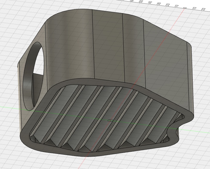

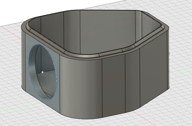

I imagined something like shown in the attachments. And instead of using sleeves for the rods, I would use nuts both from top and bottom of the divider, providing strenght in both directions. The final product will be most probably glued together.

I have a crazy idea for the dividers. 3D printers like 45 degrees, so the divider does not have to be flat, but can be made of a few smaller hollow pyramids or maybe just triangular wedges and reduced in thickness as the pyramids/wedges will provide structural strength.
While thinking about it, the wedges would be definitely easier to print and would allow for better screw/threaded rod placement.
Also the presented footprint shape is not the final one, I would like to have something like a cut-off teardrop shape, to have one single curve from the front to the back. It needs to look great. I imagine silver PLA at the moment, but it can change anything between white and black.
Edit: This thread was indeed inspirational The making of: The Two Towers (a 25 driver Full Range line array)

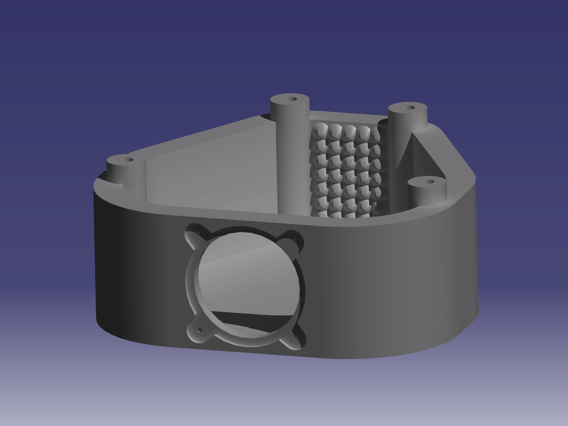

I would suggest removing the parallell sides in the enlosure, especially the backwall. I would also put in big diffraction patterns on the inner walls which would also strengthen the cabinet. Triangular wedges on the inner wall sounds interesting! Features that serves 2 or 3 purposes is often achived with 3d printing :) From other designers on YT I've seen that wider walls with moderate infill will dampen wall resonances effectively.
Also don't make a super advanced box with perfect tolerances since plastic schrinkage is a huge problem when printing large things. So avoid designs where parts needs to go together perfectly, instead use CA glue to hold parts together. I would also avoid small details that creates a lot of retractions since that increases the probability of filament failiure. It's very annoying to se 20 hours print fail just before completion.
I am looking forward to your next box iteration so please post more pictures :)

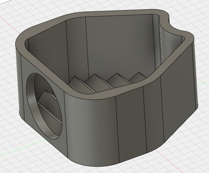

839780d1588360699-modular-3d-printed-range-line-array-lamodule4-jpg
This is how I would not want it to be, honestly. Look at the back of the cone, imagine the wave front that comes from it, now look at the series of possible reflection surfaces you created...
You want the energy to move away from the back of the cone as freely as possible, not be reflected back to it.
Lots of people see the wavy shape of my enclosure and think: it is to break up the internal wave front. Well, these are small shapes so it would only work well at higher frequencies, the frequencies that are easily absorbed by damping material. But don't forget the outer shell. I did create a varying thickness of that outer shell.
Joined 2008
Thanks for the feedback! So you would recommend waves instead? Or just plain flat? Uneven wall thickness is relatively easy with 3D printing. Also, it is reatively easy to arrange the surfaces inside in a way that nothing is really parallel. And maybe add some internal structure to break up the waves even more - like a sphere, elipsoid or even just a cone if that would make any sense.

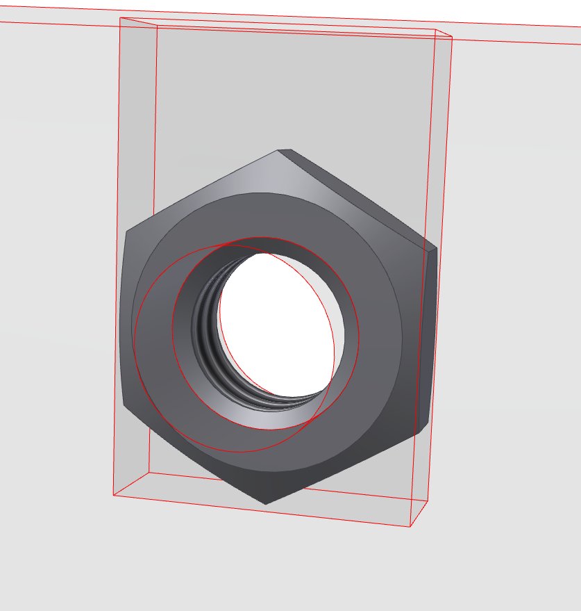

I lost a previous reply, in which I had made another observation. Personally I like some weight in an enclosure to offset the moving mass of the drivers. I'd use/design slightly hollow walls that can be filled in with something like sand.
Edit: another thing that popped up... we usually use nuts that are hidden in our 3D prints. Just make clever openings to slide a nut in so you can mount anything you need. It can be hidden but easy to use:
attachment.php
It takes some test prints to figure out tolerances for the nut to slide in but it works once you know what to use.

Very valid points. The backmounting is an option I also considered, that is why there is just a round hole. The outer shape will be some sort of spiral / curve. These will be printed on a delta style printer, so smooth curves are the best option.
Regarding the weight, I would be a bit afraid of the strength in the long dimension when glued together from pieces. I will let it sink in and try another shape.

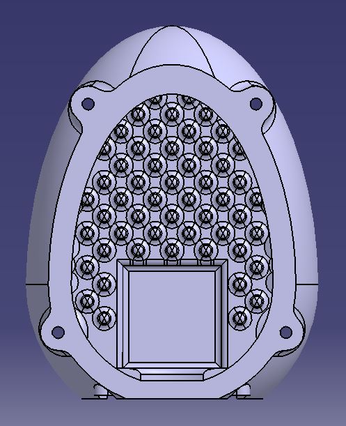

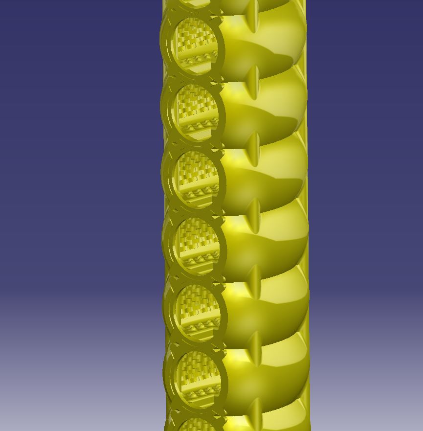

I think I like designing them more than actually building them. I like to try to design things for 3D printing that can't be easily constructed with conventional manufacturing techniques. Instead of triangles, I was experimenting with rounded dimples on the floor.
If your printer is capable, you can consider using a 64D TPU filament instead of a PLA filament. Both for the acoustic properties and to reduce issues with shrinkage.
I was reading these forum posts about this line array.
