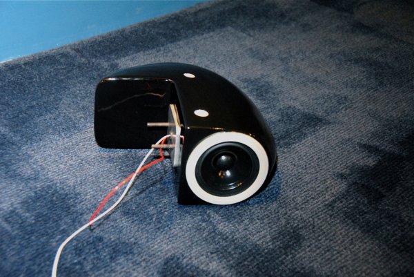

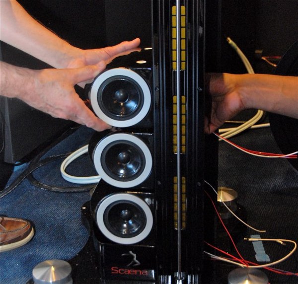

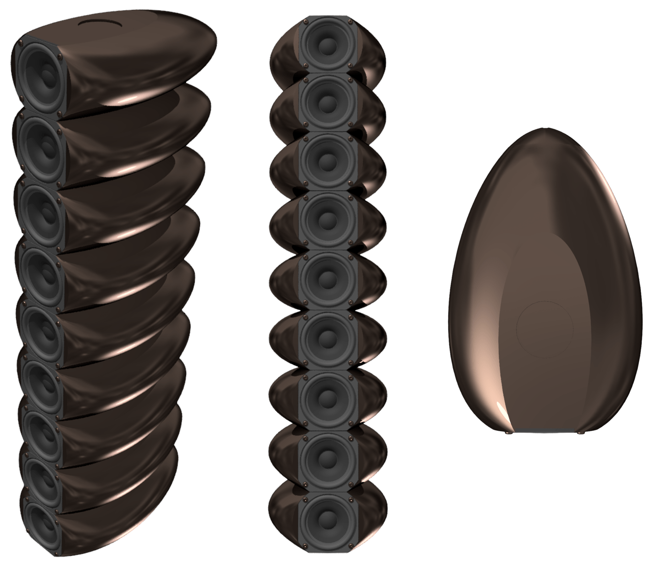

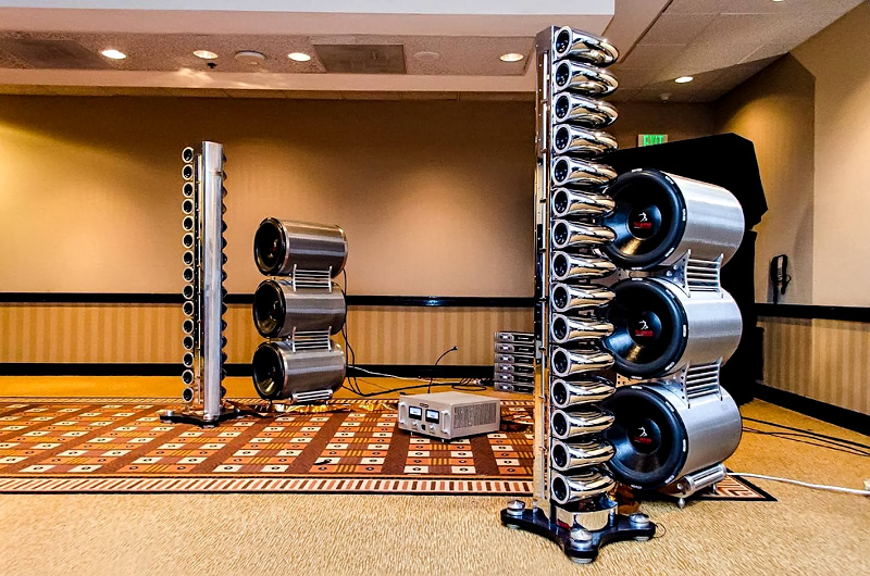

Your eggs do have a 'Scaena' feel to it 🙂

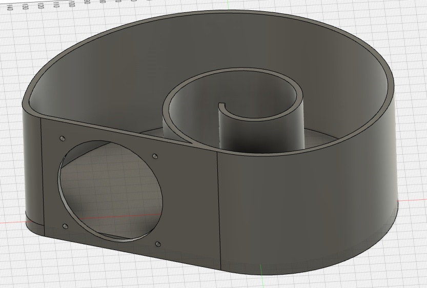

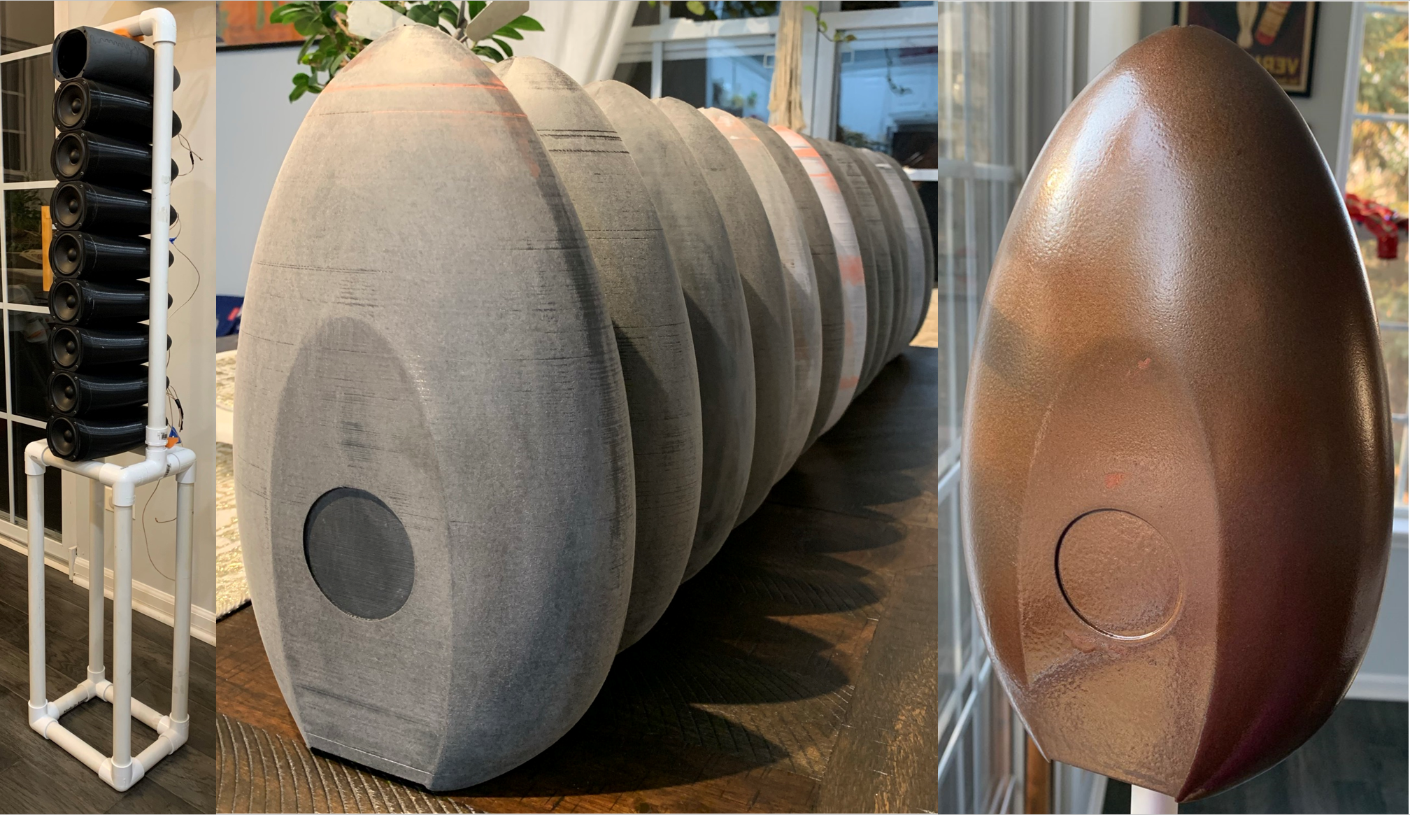

Not quite a snail shape but getting closer to it:
Link to Scaena speakers: Scaena :: Iso-Linear Array
Link to picture source: Scaena install | What's Best Audio and Video Forum. The Best High End Audio Forum on the planet!

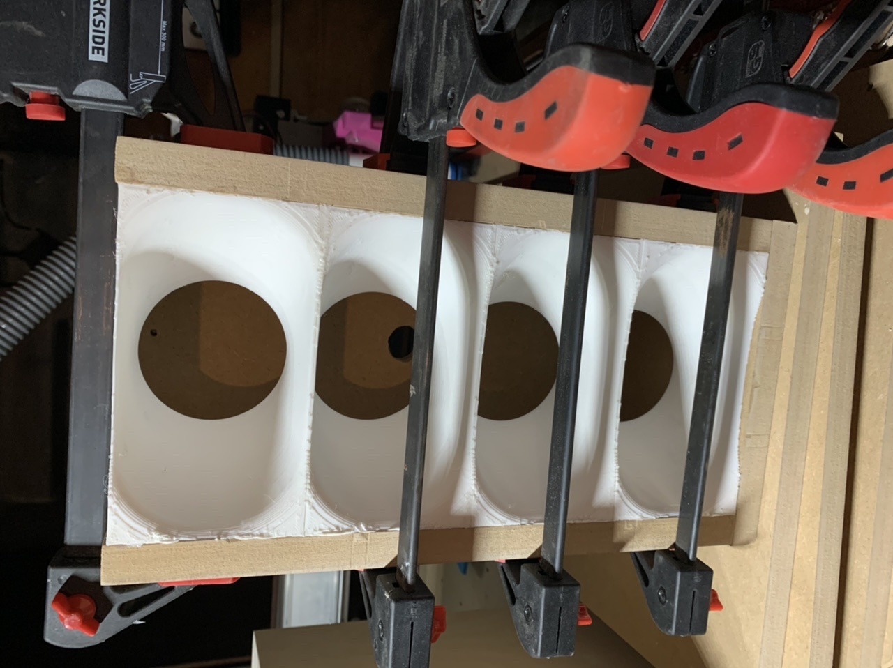

Don't be afraid to use CA glue on PLA, several YT channels have tested CA glue to give more strength than the PLA itself when parts are touching each other. This is also my own experience. CA glue also works pretty good on PETG. I would look into epoxy glue for larger gaps.
The dimples idea looks cool but whould increase print time with all the extra extruder movements and cause many retractions. They would also only breakup ca 15kHz+ at best. What if you rotated the triangles 90 degrees and let them start 6-9 cm from the driver? The start could also be very gradual so no early reflection. The triangles would stiffen upp the bottom and the ceiling without costing to much material and print time. When using a lot of fillets in horisontal dimension one often need more support material than just a sharp transition. I'm often printing in Petg without a heating box(just a warm room and some spot lights) I tend to make my large designs bulletproof. So less overhangs and fillets. Looking at the Scaena speakers I think the sharp bend from speaker to cabinet side would create audible diffraction so I think your design is better. Having a smooth radius on the baffle is something I've started to belive in.
I've also considered a snail shape but the box gets large quick! It would cost a lot more and take a lot longer to print as well. I think the rounded front baffle is more important than the snail effect on sound in a fullrange. That said the bragging rights whould be pretty awesome on a snail cabinet 😉
I tested CA and liquid nails (Mamut glue) and it works well on PLA, PETG and rPET. So I am not afraid of the strength of the glue. Yes, the print must be reliable, so no overhangs with the exception of the driver opening.
Just a quick play with Euler spiral in Fusion 360. I wonder if it would be worth the effort. The only parallel surfaces left would be the top and bottom of successive modules. I think that would create a 1/4 wave resonance around 1 kHz. I have no good idea on how to make the top/bottom uneven. The only idea I have is that I could have two types of modules, each with different floor but keeping the total volume for one driver constant.
The outer shape could be made into anything non-diffracting with large roundovers, etc. so it is the inner arrangement that I am now thinking about.
The more I get into it, the more I think I will just use a plain simple easy to print box for the tests anyway.

Regarding the test box I would make the outer walls slightly curved since that is free cabinet performance with minimal effort 🙂 Some YT printed boxes have had huge problems with wall resonances making it difficult to evaluate the drivers tested.. A box resembling a pressure wessel should be used or else its quicker to find an old speaker box and just make an adapter plate.
Yes, the box will be definitely curved and simple shape. Still waiting for the drivers, so there is time left for design. I like the Euler spiral, so I will base it on that curve - just to see what I get.

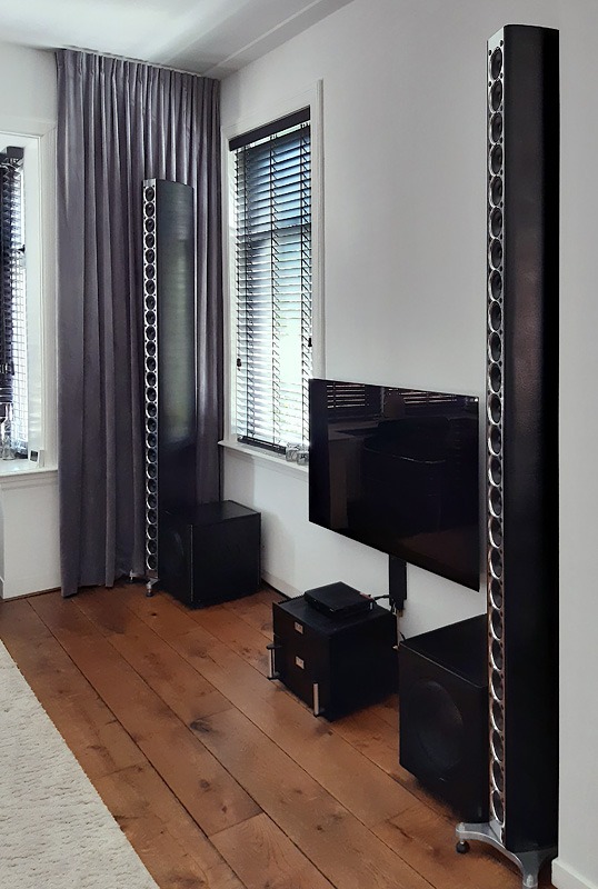

Expect to need some EQ to make them sound their best. I can't say much about aesthetics, as I managed to get away with placing these in my living room.
That I like em, as I designed and build them is obvious, but I do feel very lucky that I get away with it to place them in our living room where they have been for
about 7-8 years now, in total. Obviously these aren't printed, but then again, it took me 1.5 years to build them!
If your stack is much smaller, it will react different than tall arrays like these, but as most of the work has done, running some simulations can help
understand the stack of speakers so you can make them sound way better.

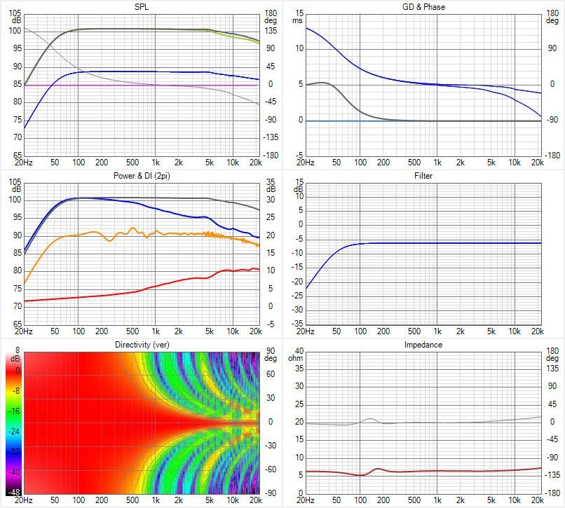

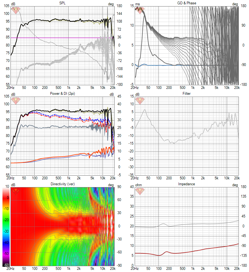

A simulation of a 25 driver stack with my driver spacing looks like this in Vituixcad:
The above is without any EQ on it. That would sound "interesting" at best, but not beautiful. (note the grey in-room prediction)
With a little EQ we get a whole other picture which can actually sound quite beautiful:
Again, look at the grey predicted in-room frequency response. Key point is: they need EQ. And preferrably a smooth outer shape
to limit diffraction as much as possible. And if you're also willing to absorb early reflections off of nearby walls, it will only start to
sound better because of that. (absorbing panel behind that curtain in my picture).

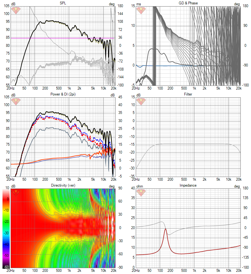

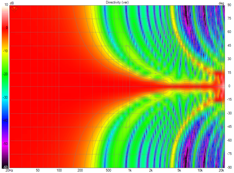

Shorter arrays react quite different. Here's a sample of a 15 driver array, still quite tall:

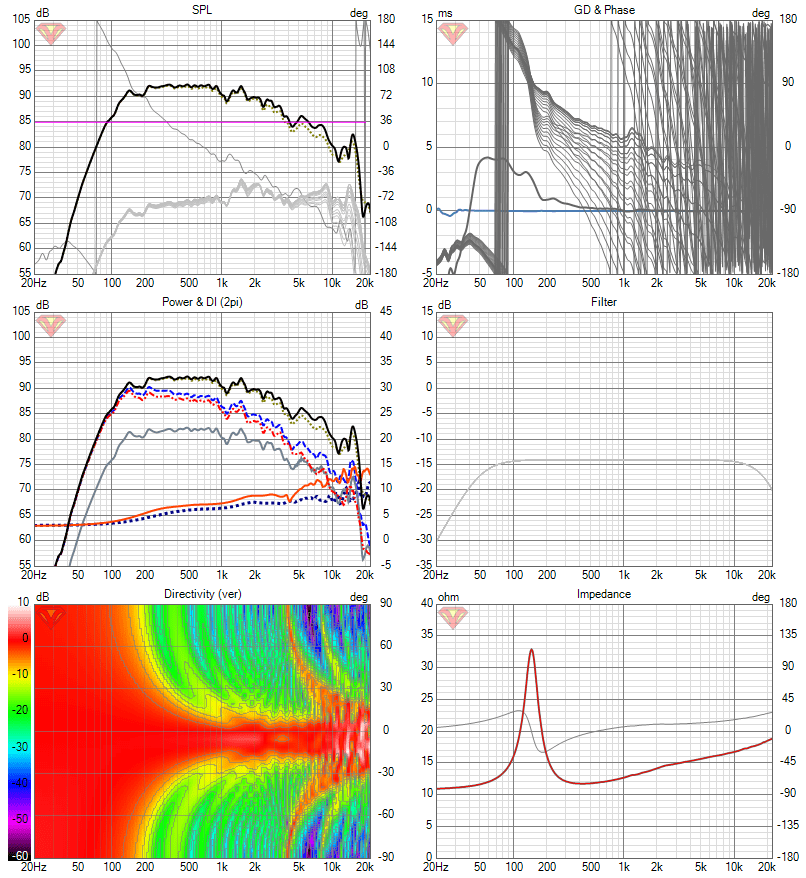

Or even more extreme, look at a 4 driver array:
With an array like that, move even less than an inch up or down and you've lost all high frequencies! On the plus side it does not show any
evidence of combing 😉.
