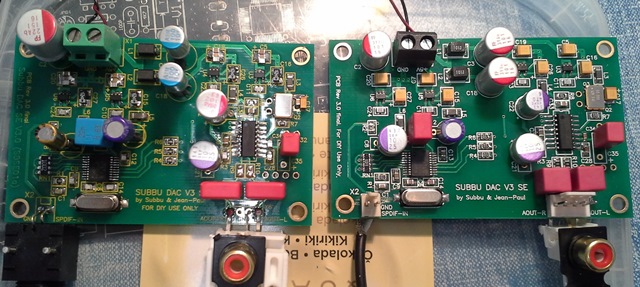

Today i assembled one Subbu dac for my friend. I used his BOM last version material. I also assembled one my version... Ultima Subbu Dac. (work is still in progress)
First... SEP 10uf oscillated abnormaly at position C13 that i must turn sensitivity for 2 position higher to see it clearly (also 10Uf ceramic cap oscillated so esr is too low)... at position C8 is ok but line is still dancing a little. I change it to old Oscon not to low esr 47uf type to try polymer on that position and MUSE KZ instead Fine Gold that you see. I think at the end wil be Sal-rpm.

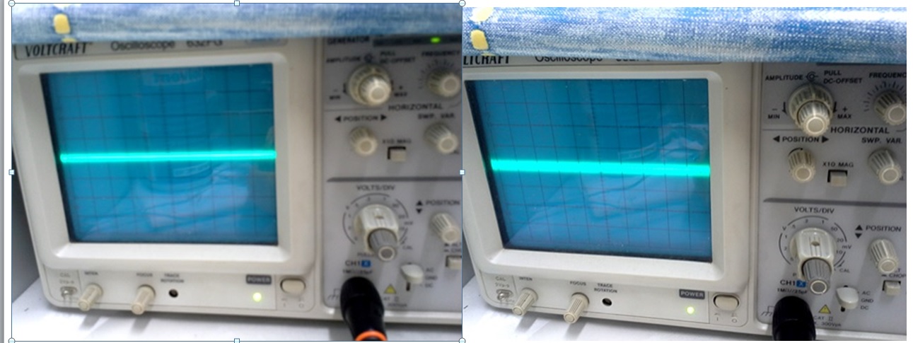

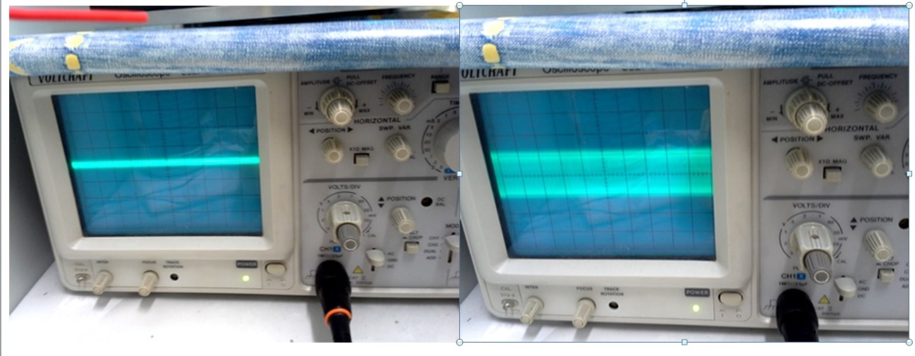

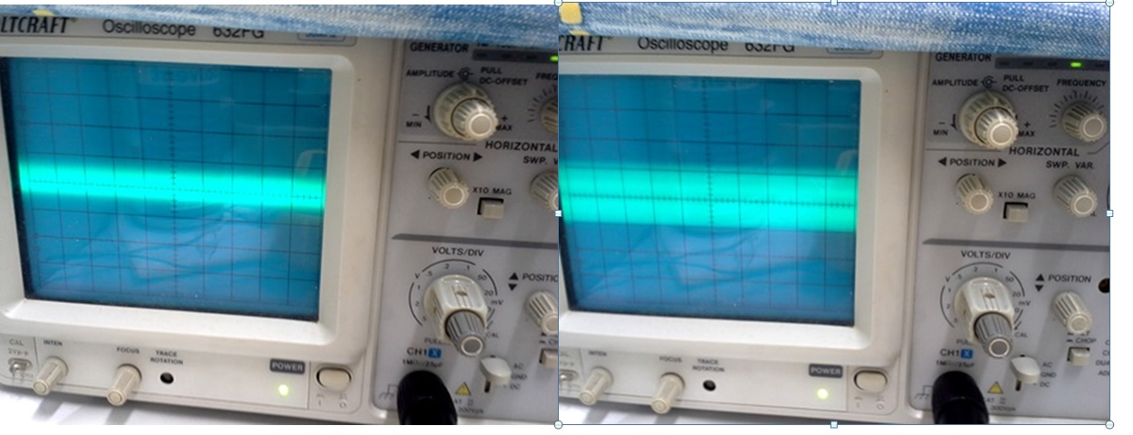

Here are some scope pictures comparisson between my Ultima Subbu and V3 last BOM .
Picture 1 famous C17 clock supply - ultima vs BOM
Picture 2 AVCC pin es9023 - ultima vs BOM
Picture 3 WM8804 pin 7 PVDD - ultima vs BOM

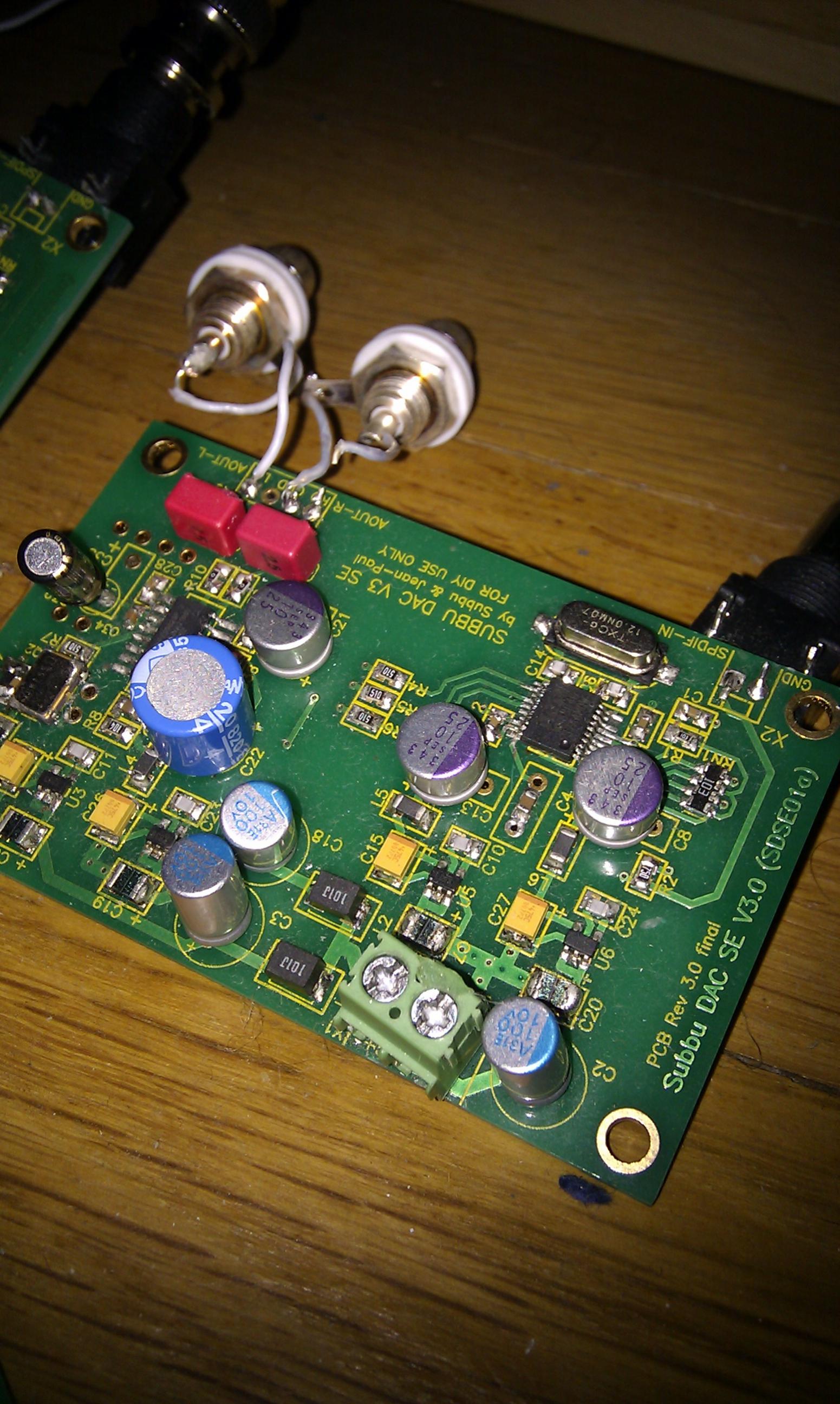

C8/C13 : I like very much the KZ Muse 20 uF but objectivly speaking : KZ Muse 10/100 V has a better tonal balance and no harchness anymore (though loosing little of its fantastic clearness in the bass the 20 uF has while staying dynamic and lively on my system).
C8/C13 have no problems at home... but : C2 is the same than C3 : a UCC PSA serie (the same as the other one on your pcb : negativ mark in blue !)
I will swap the C22 on the two pcbs by a SEP > 470/ uF (did you putt a SEPC ?) or an old SP Oscon : >520uf /4V ... Of course also the Nichicon PSE serie 470 uf/6.3 V. I don't like at all the red Nichicon you use in any place... any !
C21 : stay with the 10 uF SEP like on your photograph.
Second board is the non moved reference to compare : i have still to pick the 1 uF BG at C32 as I have only one !
On my photograph : the UCC are the PSA serie low profile ! You can see the two KZ Muse 10 uF ! In your shoes i will test the two values of KZ 10 uf like te he 20 uf to understand what can do this dac chip in the bass without buffer... for the hobby ! (you listen to it between two scope screens or just check with scope ?)
important : C32 :the MKS2 2.5 mm pitch (1 uF) or better (for me) : Black Gate 1 uF !
You are not too far much from my personal BOM, could you give it a chance ? c2/c3/c18 must be the UCC 100 uF of the first BOM of JP/Subbu with the official BOM (further GB parts have littles changes in relation to the official genuine BOM)
photograph of the PS used ? Important !

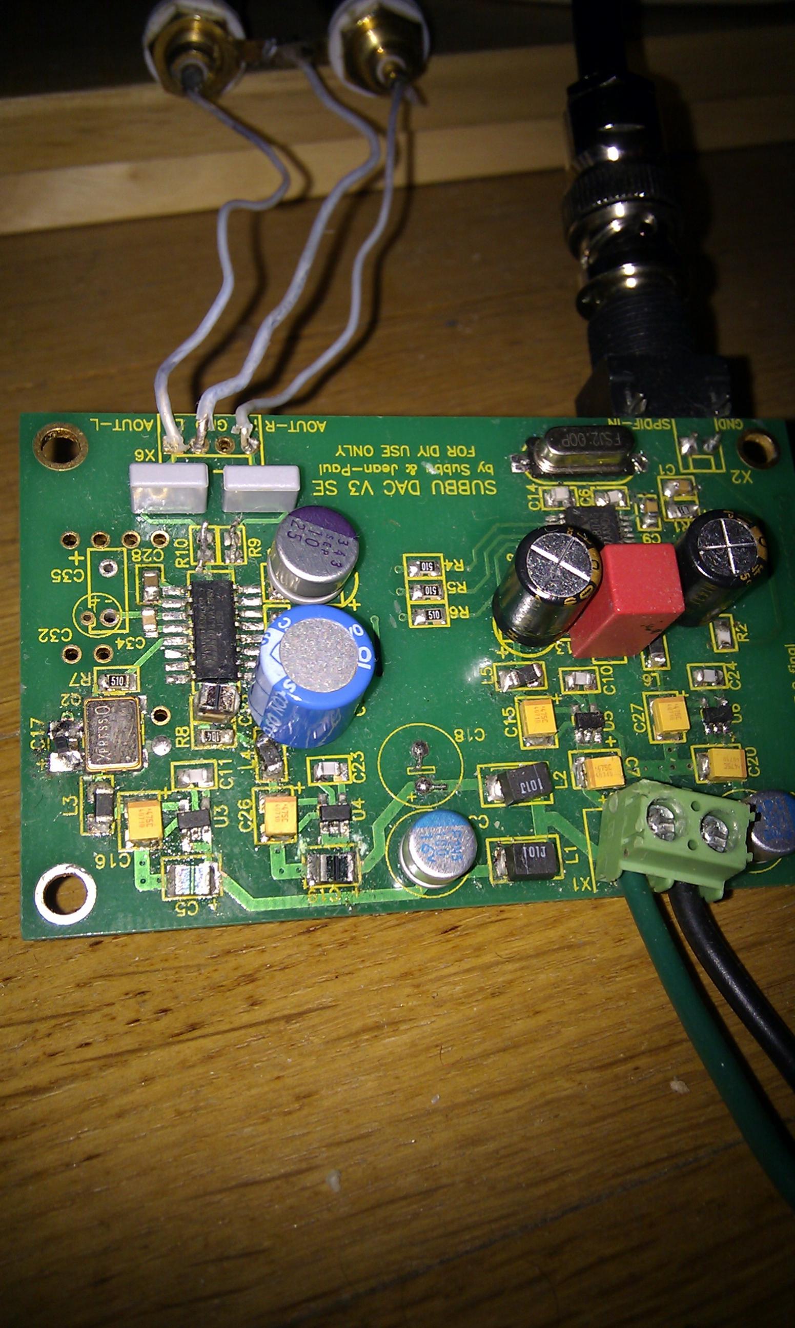

The first pcb on the left was my first smt soldering in my life... the one of the right picture was my second pcb of my life less a bottle of Bordeaux (still without "pincette") !
DDX, the one of HIfimyDIY ? or a diy one ?
Why not just putt an amp in the same pcb than the V3 : it sounds good ? add it a buffer for speaker (that some call an amp) et voilà ? !
You work in a bio bank and want to go with DDX everywhere ? (joke)
Without kidding (just try two kz Muse 10 uF to compare apple to apple like you like... have you not two sal 10 uF to sell : buying ten is expensive !)
