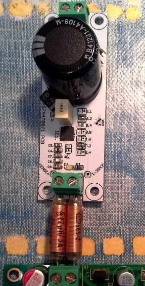

I have a very good trade off with the two 10 uf MZ Muse : they have not the magic of the 20 uF but have no harchness and a good mix between crisp and timbre in the treble and stay confortable ! Tell me what you feel instead the SAL-RPM ! Timbres are acurate in thickness and the tonal balance is good at home (my main concern with setups !)
Because of the fantastic result in the bass of the 20 uf KZ Muse at c/8/c13, I will try two 20 uF in serie +--+ arrengement to compare with a standalone KZ Muse 10 uF.

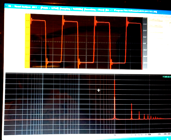

I measured Audio Gd dac by my friend. At OS2 sqare is similar to NOS dacs... 8OS has traditional pre and post ringing like and sund is some more intense but still very good 3D.
2OS and filter1 for wm8741 is reaxed 3d sounding. Some more finese and microdynamic and right timbre(colour of instruments) are missing. For that i must go deeper in wallet 🙂

For comparison, maybe one of some reasons for difference in sound
1. Audio Gd17.32 nfb OS2 filter1 square response 1khz
2. Subbu dac square response 1khz

Androa,
The 100 nF with any other value (10 uF, 4.7 uF or 1 uF (the acrylic) before the Micrel on the AVCC must be avoided IMO: ringing, too thin high-medium :digital sound.... at least at home ! de colored tonal balance despite a better mid bass and some clearness in the highs but very bad at ears ! And the mid-bass are too low in timing (desseapper fastly): surmise the difference of our systeme here : speakers !
Worked to follow your advice about c8/c13 ! SEP 10 uF are still give me good result despite the low capacitance on c13 in relation the 47 uf you advised. I can't hear any sibilance or ringing with them just a little lacke of dynamic but they are still soft on my system.
But the better result is my BOM with c8 AND C13 : 22 uf//10 uF both KZ Muse ! Splendid ! C8 despite the only 10 uF has a great improvement here : good balance and tonal colar and dynamic on strings, harmonica, saxo, piano : very hard instruments !
Stock PS rocks already with the 47 uF Black-Gate I advised on my BOM : no need of another PS for better transcient but if it improve clearness (transparency) more !
I will follow with C2 advices. (Panasonic FR, FM, OSCON SP, Rubycon ZL, Panasonic HZ of the same value you advised.

Hi, what is the load ? Could you show plots measured with the same device ?
BTW I stopped listening to square waves, they give me a headache 😉

Audio gd load was emu 0404 soundcard acuu suplied not wall adapter supplied and Subbu load was amplifier with 20kohm pot.

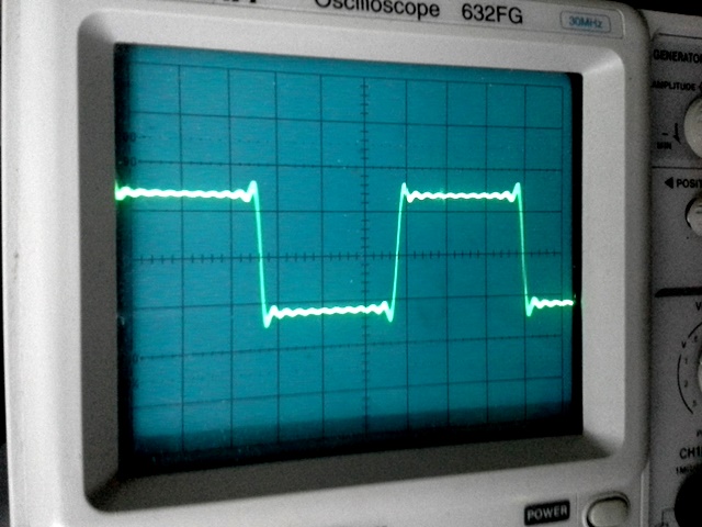

Square sample picture is nothing bad...even es9018 has pre and post ringing, even audio gd has it on 4 and 8xOS.

Today i made TPS7A4 (from MRAVLCA) ... main PS. Very good, even less noise than very low noise original Subbu one.
PS ... lines must be opposite connected, picture was made just for sample look.
