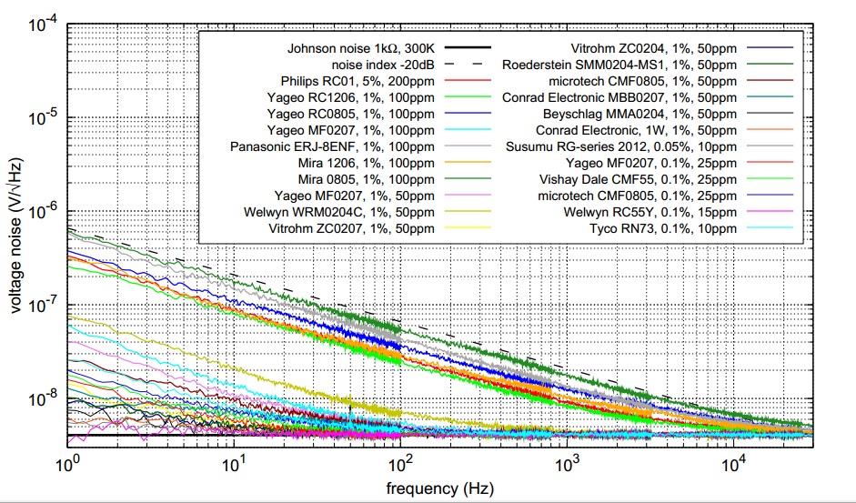

Did you try the little vishays tubes smt resistor (sorry don't remember the correct name) between the W8004 and the DAC chip ? or even through hole dale resistor as the distance is wide enough on the pcb ? Or did you put directly the best sussumu because good QP and quiet enough ?

No I haven't tried all the stuff you mention. Why would I need to use other resistors between WM8804 and ES9023 ? I challenge you to back it up with measurements if you hear or see any difference in digital signals with the resistors.

Ok, usefull to know. so no need of bigger resistor for reducing Johnson noise, or whatever...
Finally the only limiting factor here is the embeded oap in the dac ship, ah if they can product the same cheap dac chip without it !
Bigger resistor?... i think Sussumu is a good choice.
