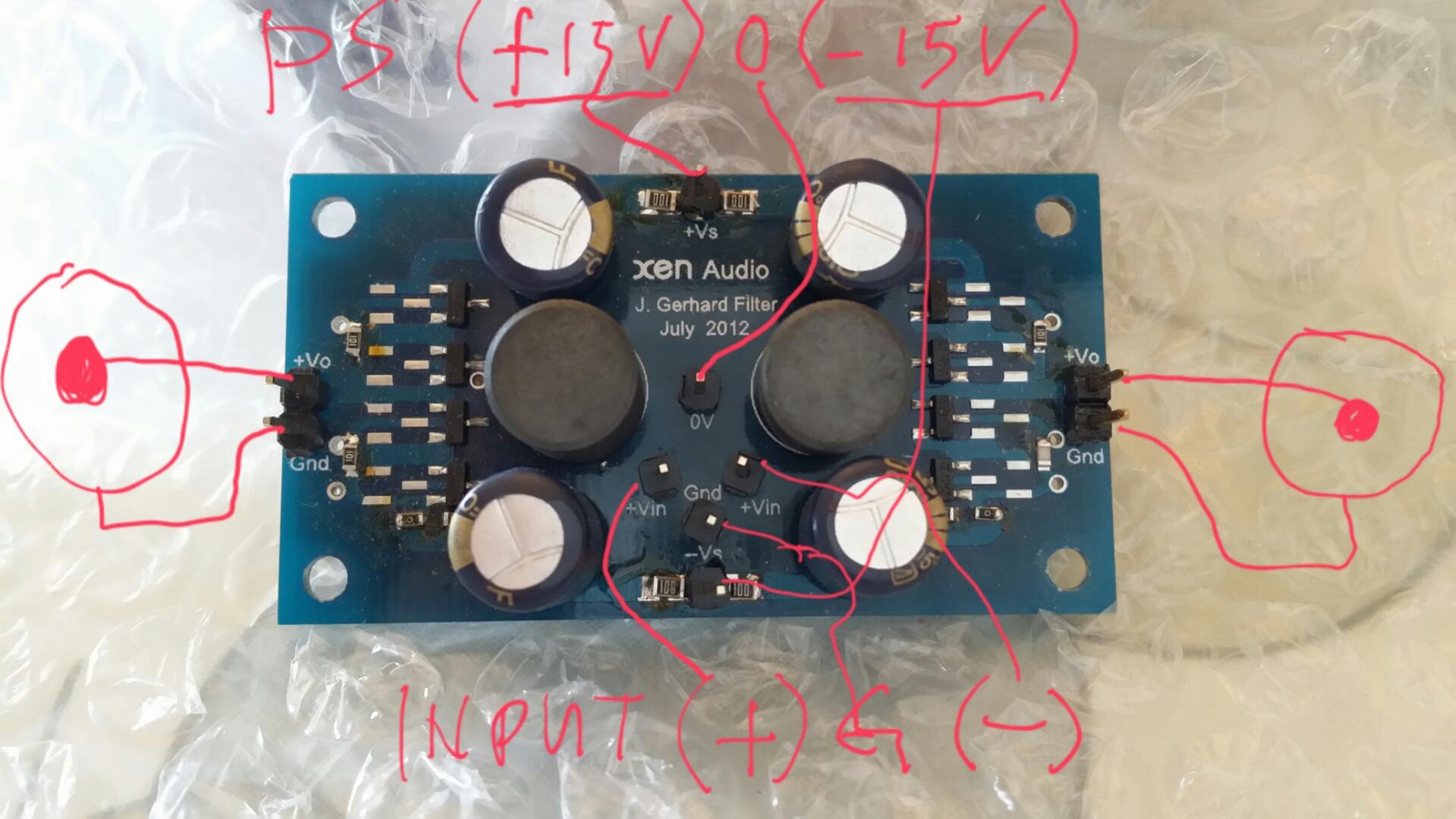

Many report better final result with the JG buffer (design gifted for the ommunauty also).
