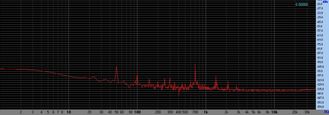

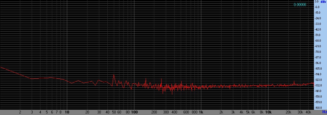

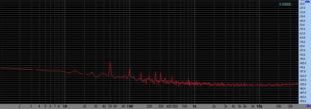

Suubu mesurement
JP, did you do any mesurements of parameters for SUBBU dac?
Noise thd...
I want to do it yesterday, but time is not my friend.
Me and my friend who has more mesurement equipment, were trouhght some parameters.
Remesure al the regulators...and starting to mesure snr,
There we got on one strange situation.
1 graph... on output of dac. bnc connected or not both gives same graph.
Forget 50-100hz noise because of open line wires, trafos... because dac is not instaled in case.
But at around 700hz and again in 1,2,3 harmonics til 2800hz, is present strange noise???
Metal cover didn*t solve the problem. We do some dac checking, all is ok.
Then i touch first regulator...ups noise is gone ...???
More precisely vhen i touch with finger or metal screwdriver bypass pin 4 on Wolfson supply rail ...U5 and U6 the noise is gone....2 graph
After checking MIC pdf... we get to graph where is shown that bypass cap can be til 10nF but startup will be longer and noise smaller. I tried and replace 470pf with 10nf at both regulators. Almost the same result. Noise is still present. I put ceramics before regulator out...nothing.
Lets go on. I tried also at other 2 regulators for ES9023 MIC3,6V and on clock supply 3,3v. After touching baypas cap noise get dramatically worse at all the spectrum. After measuremet supply pins at clock, after touching the cap we get hughe noise in rails...the same at es9023 position and input at PVDD and DVDD supply pins. Touching the input capacitor C9 and C12 not cause any problem or difference at both graphs.
3 graph is modified Dacmagic scope....If we could get rid of this nasty 700hz noise it is wery good noise performance. The hour was late so we couldnt do other thd mesurements.
Noise thd...
Did anybody do mesurements for SUBBU DAC?? Can somebody do it? I am not abble to do it for a while.
Hi ANDROA, can you hear this distorsion or is it just annoying to see it on the scope measurement ?
If the distorsion is pleasant, maybe not a problem... e.g. sometimes you change a cap, it's worst on the scope but more pleasant to the ears because better match in relation to the whole hifi-system ?

Hearing or not hearing....dac must be technically good...so the measuremets must be in range of specs.
After that is finese tuning like you, I and all the others do.
