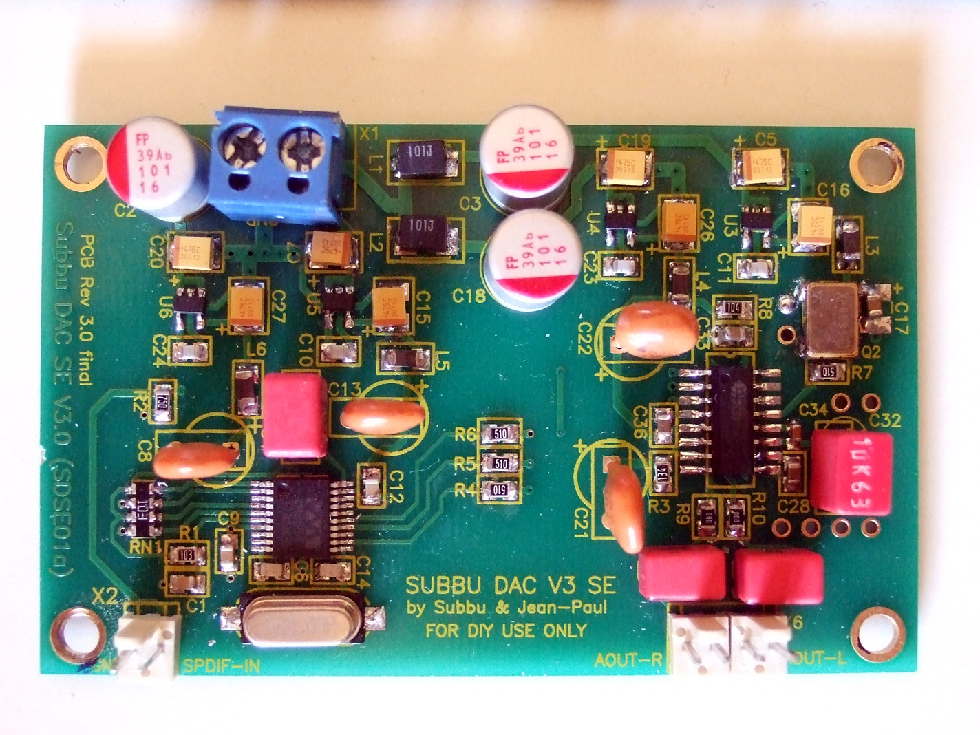

I had hoped one extra Subbu V3 power supply would have enough current to run a waveIO USB converter. It doesn't.... Can I run my two Subbu V3 power supplies in parallel?
I think each one supplies about 250 ma current....Would two yield 500 ma at the same voltage. That would be enough.

If you check the datasheet for the WaveIO USB, it says it needs 5v @ 0.5A. The Subbu DAC needs ~0.1A, so you need at least 5v at 0.6A. I'd suggest a power supply that has some margin, perhaps a 5v supply rated at 1A.
Regarding your question about using 2 Subbu power supplies, even that won't be enough current capability. You could tweak a single PS to supply enough current but you'd need to make some modifications. You'll need a transformer with a larger VA rating, you'll need to heatsink the output transistor to handle the higher current, and you'll need to change the current limit resistor to raise the output current. A careful reading of the LM723 datasheet should show the way.

Better go with Reflektor-D if you want to try shunt reg. Its configured for DAC etc. I have a friend's Subbu V3 SE running on Ref-D right now on my main system. Its set for 5V output and 0.4A constant current limit. Both stable and low noise rail on the scope as a combo. Smooth but not veiled big sound and nice dynamics, rich in warmish details. I was wondering if the DAC can "feel" differences in the shunt reg since its just in prereg role and I already measured 7.3 Ohm parasitic resistance on those Pana SMD coils forming the main LC with the polymer caps plus there are local SMD regs. Enough stuff located between the shunt and the digital chips already in other words. I thought lets tweak the shunt reg's open loop gain parameters a bit. And the combination was still calmly responding. If tweaks in same type pass through then there will surely be detectable subjective differences between whole different types of external supplies as well as personal taste and various systems tone related preferences I guess.
DC resistance of the coils is around 8 Ohm, I earlier suggested trying out 47 µH with 5 Ohm DC resistance but did not take the effort myself (having a quantity of the 100 µH ones) The V3 does not seem to mind.
Do L1,L2 SMD coils look like the usual Panasonic 8 Ohm? If yes, maybe there is some tolerance. They were closer to 7 Ohm in this build.
Yes, I just measured them and the older ones I have are lower in resistance than the newer ones. The soldering tab is also different. It probably won't hurt to use a coil with lower DC resistance. I doubt if it make a difference except for slightly less voltage loss over the coil.
