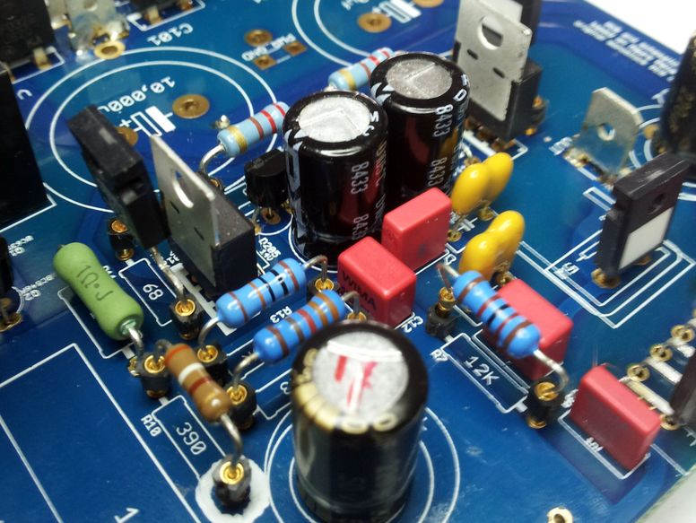

I believe it may have been mentioned before, but sockets are a great aid for quick comparisons of through hole caps and resistors. They help reduce the memory leg time and allow easy swaps.
Good idea. I've got lots of different caps I could try for C35/C32 but I'm not sure I have patience to solder all of them in and listen carefully. Quick tests with insertion of different caps might be more fun. I've got the following Wima MKS caps here to try: 1uf, 2.2uf, 3.3uf, 4.7uf and the following BG N/NX 1uf and 4.7uf. In the V2.6 DAC I did compare 1uf BG to 4.7uf BG and liked the 4.7uf better. But in the V2.6 DAC there is only a single 1uf X7R bypass cap, not the double 1uf X7R bypass of the V3 DAC.

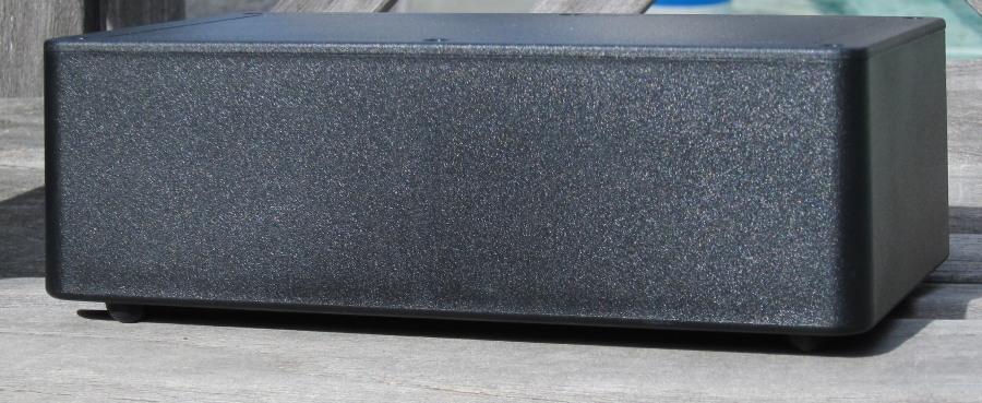

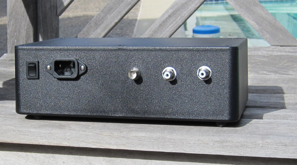

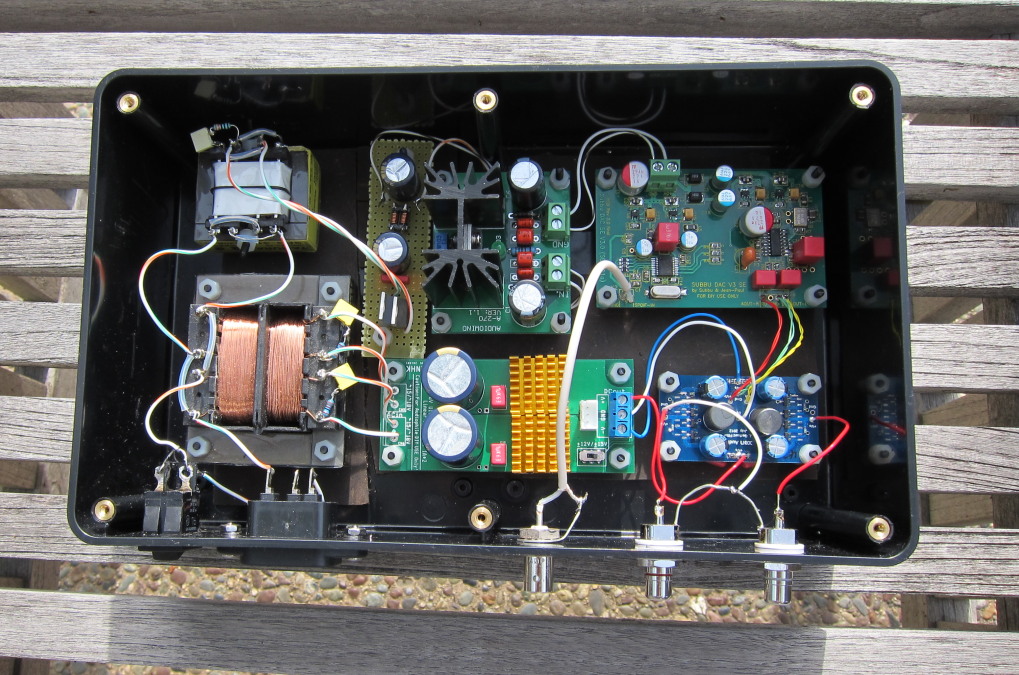

I finally got around to putting the DAC combination that I experimented with 1 1/2 months ago and liked quite a bit into a box. I discussed the details of this build in posts #183 and #225 of this thread.
Briefly, this version of the DAC has the various tweaks that I've described through this thread, 470uf Nichicon FPCAP for C22, Wima 4.7uf MKS for C35, C4 is 3.3uf Wima MKS + 0.1uf MLCC. The power supply for the DAC is upgraded with an LT1764a regulator with CLC prefilter and Fairchild soft recovery diodes. I use a JG filter/buffer and power it with a +-15v supply based on the TPS7A4700 regulator. This fits nicely into a box that I bought from Polycase that measures 10" x 6" x 3" or for those more comfortable with metric measurements, 254mm x 152.4mm x 7.2mm. The Polycase model number is DC-96P. This is a plastic box, so I leave the ground floating as several people have recommended earlier in this thread.
I've attached pictures of the DAC from the front, from the back, and then an interior shot. Looking at the interior of the DAC, you can see the power transformers to the left, power supplies in the middle, and DAC + JG filter to the right. The bigger transformer towards the back of the case is a dual 14v transformer for powering the JG buffer - Tamura PL30-28-130B. The smaller transformer is a dual 5v transformer - Tamura 3FD-410. Since the LT1764a is a low drop out regulator, the lower voltage works fine here. After rectification, I get ~ 7.8v to the regulator which provides plenty of margin. The perf board next to the 3FD-410 holds the soft recovery diodes and the CLC filter. Towards the back of the case you can see the regulator board with the orange/gold low profile heat sink - this is the TPS7A4700 regulator board providing +-15v. The board with the bigger black heat sink is the LT1764a board. The V3 DAC is in the upper right hand corner and the JG buffer is near the RCA outputs.
I turned it on a short while ago and it works fine. Time will tell if it sounds as good boxed up as I remember from previous listening sessions.
---Gary

Nice!
This is a compact build considering the number of psu's 😉
I will be using a JG buffer myself that I initially wanted to power with batteries (aka EUVL's scheme).
But with a charger and everything this got too big physically so I switched to a Sjostrom Audio board that still is a bit bigger than the Diyinhk thing. Have to go for a slightly larger case!
Looking forward to your listening impressions!
