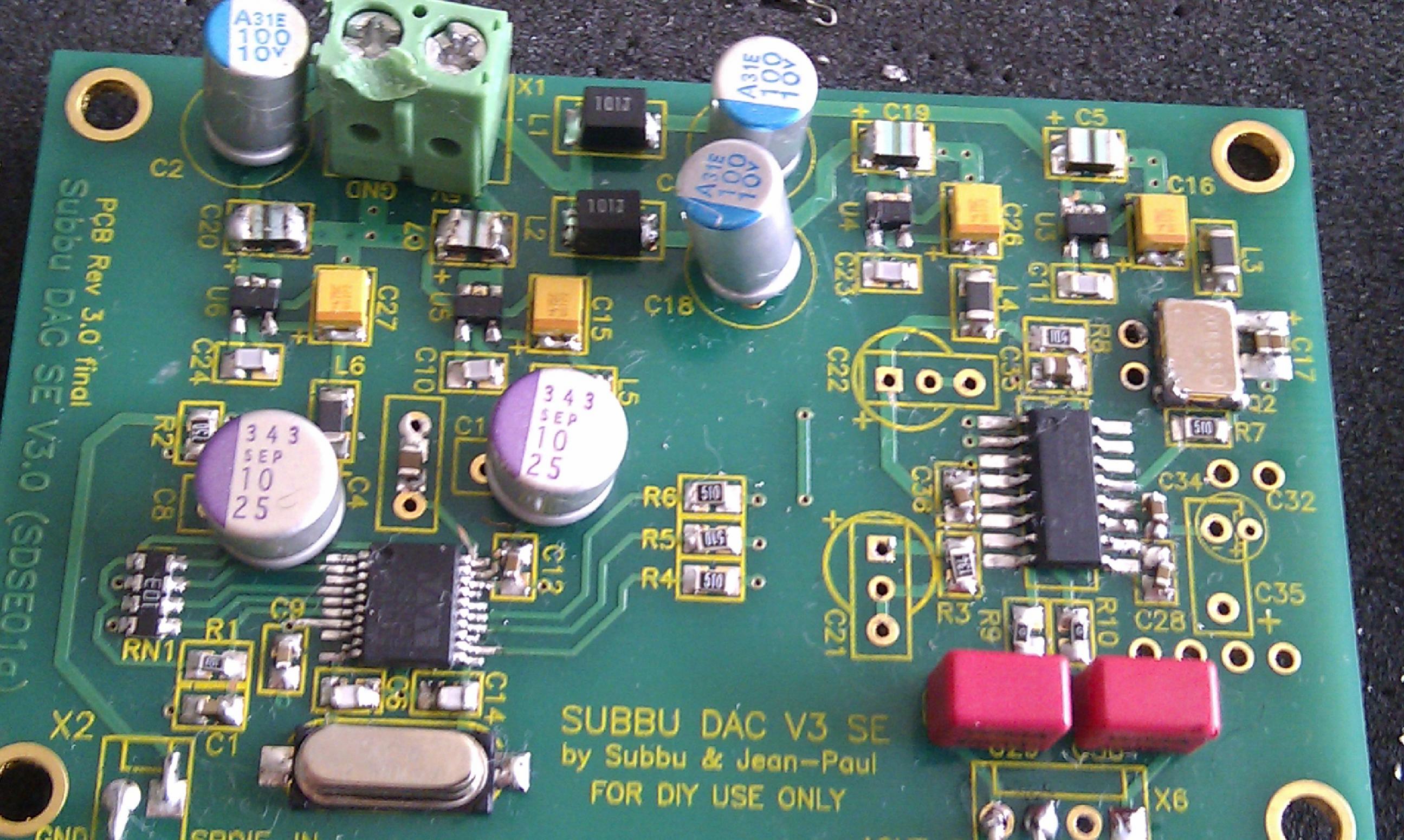

I’ve got 2 Subbu V3. the second is to try to tailor, to cook the DAC in relation to my system. The Speakers have a 5” mid aluminium from 125 hz to 2600 hz then an aluminium tweeter said to climb to 35 khz but with a mechanical notch trap at 22 Khz. Those are the Boston Lynfield 400 L : very transparent (clear), very good sound stage, very fast, fabulous mid bass, tight with details (closed band pass with two 17” with double spiders : 35 hz to 125 hz.
The speakers are difficult : when I change a little cable, a capacitor, a resistor… everything I can hear it. And the treble is a little to brighty… So many things have to be cooked to match with a neutral sound with keeping all the qualities (superb transcient and subjective fastness, very analytic, none directive (they diseapper) and defaults : bad recording… They can be fatiguing after 1 or 2 hours in relation to a more steamed Kef 104/2 ref I own also.
Well what about the V3. first I think the BOM is very good… no doubt at all. Here it’s not to be better in the absolute but in regards to my system and personal tastes. At the beginning I with the Garry’s revision with increasing C35 with 3.3 Wima MKS2 (Garry: 4.7 uF) but come back to 1 uF. C4 is 1 uf MKS2, I put 8 tantal 4.7 uf (Garry: went to the 4x 10 uf X7R before the regs)
C8&C14 are Panasonic FM. & C21 Silmic2. The 100 uf caps are the very good UCC polymers of the BOM but C22 where 470 uF Panasonic SEPC was firstly choosed according the advises. Both Subbu have a 75 ohms BNC direct on the pcb (no wires). Sense of the wall plug are marked. Wires of the analog RCA are 0.6 mm² copper, silver plated with PFTE insulation. Tracks for the tests are always the same from many years and are classic, instrumental, rock, jazz, world music, lives with applauses also. Genuine PS is used : the same is shared with the twp PCB at each test !
I like cooking & I like cooking the devices with caps also because I think most of devices have to match with the rest of the whole system and the own flavour of the listener. There is no neutral sound… sound is always an interpretation of the tastes of the listener IMHO and what he can do with what he has at home.
I took also a JG buffer but those taste was made without it. First Subbu V3 is the reference.
The second was firstly tweaked in relation to the first for C8&C13 : after trying two polymers : the ASA serie from UCC and SEP and SEPF serie from Panasonic : 10 uf SEP won : better.
C4 : I swap MKS2 for 1 uf NPO in 603 case (Marce input : no // advised, low inductance). I stay with the same 3 x 100 uF polymers as my first taste showed they was best than SEPC or Nichicon R7 here (but after an error tested with 40 uf here not 100 uF) : the difference is huge according to me and the UCC of the BOM with SEPC at C22 is a very good match in my system. 2 SEPC is too lighty…too thin !
The tantal caps just before the regs were swaped for 1 uF acrylic : the same as the PS BOM. Caps of the XO at C17 : I put three : 1 nf, 100 nf, 1 uF, first NPO, others X7R, first close to the crystal.
All the 805 X7R were swaped for 603 case with the same values (more cracking or better inductance…time will say which won !). So the second board is very different from the first. How it sounds ? With the same 470 uf C22, C21 & 1 uF C35, with just 1 uF at C34 : the second win by a very good margin : better trade off, softer without lake of definition.
So all the tests was maid many times and always two times: with the first board as reference as populated above in relation to the second populated as above. And also with the first board with the same C22, C21, C35. Why ? Most of the time the second board was better, so it was needed to benchmark with its own ref alone the tests with the three caps (C22,C21,C35).
I have to propose also three confs in relation to your main type of sound to try at the end for the fellows who have two Subbu… something else. As it’s risky for the PCB who is fragile, it is not advised for the owner of a standalone Subbu. I repeat it : the official BOM is neutral which is hard to do. I never tried the SAL but surmise a very good match at C35 with the caps tested below :

After the introduction above, here the end of the subjectiv mods in the PDF :

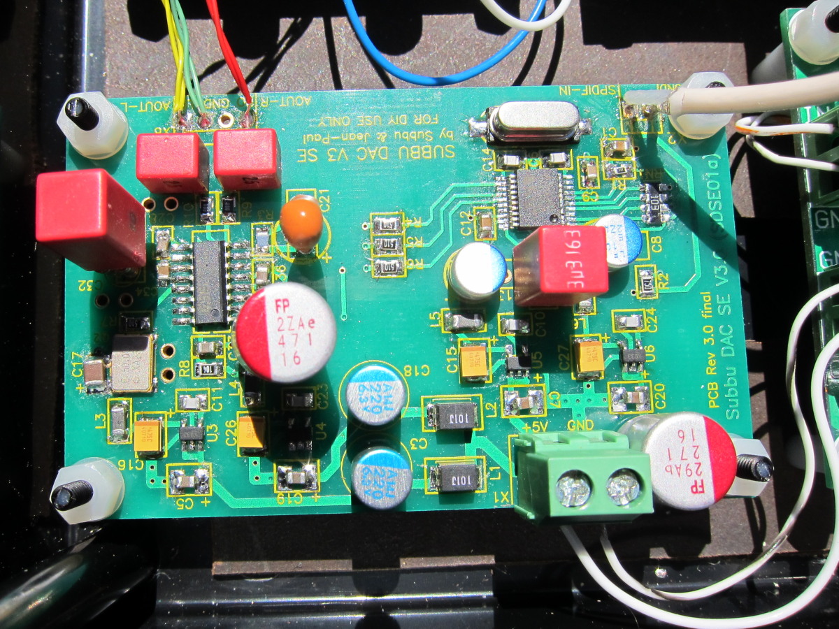

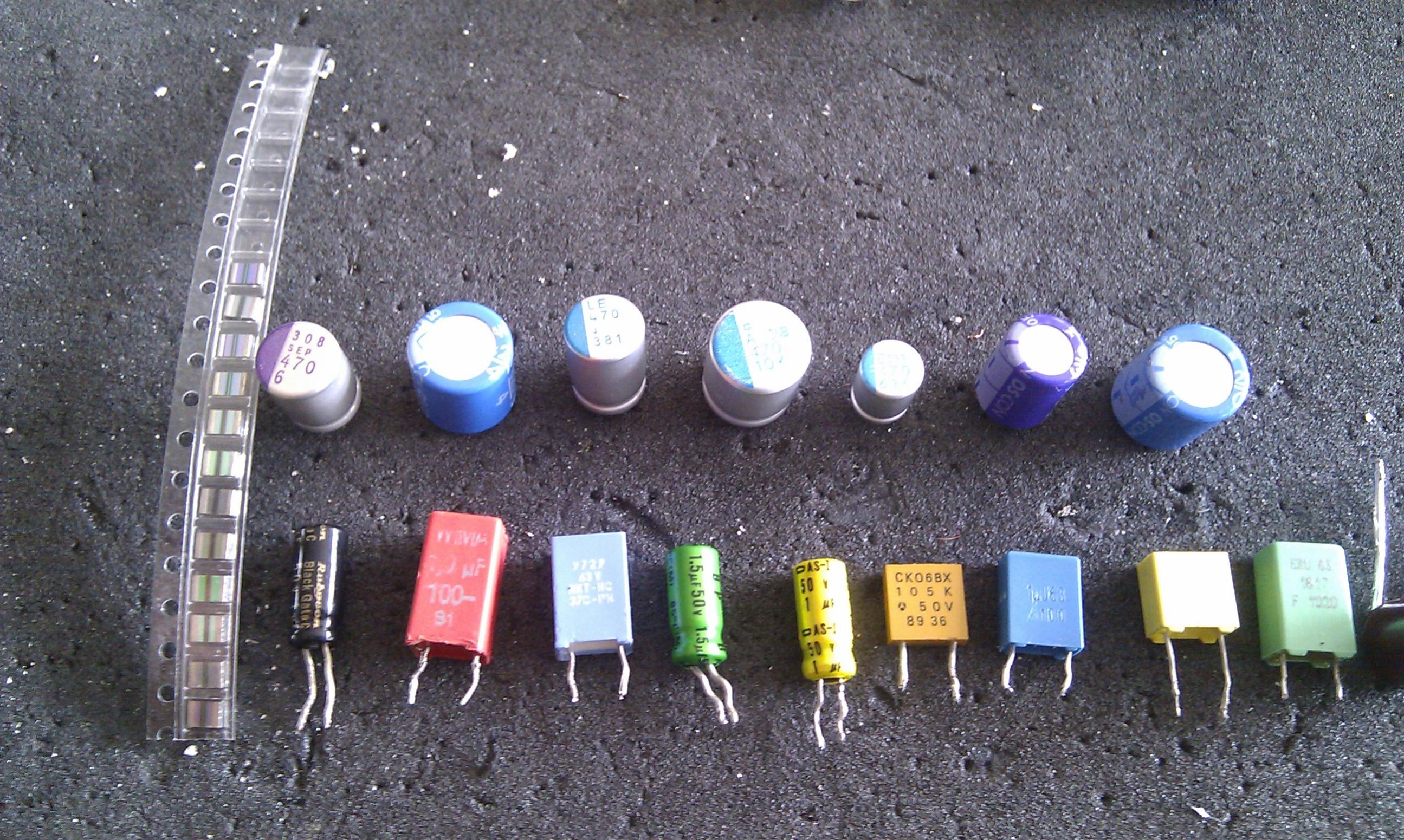

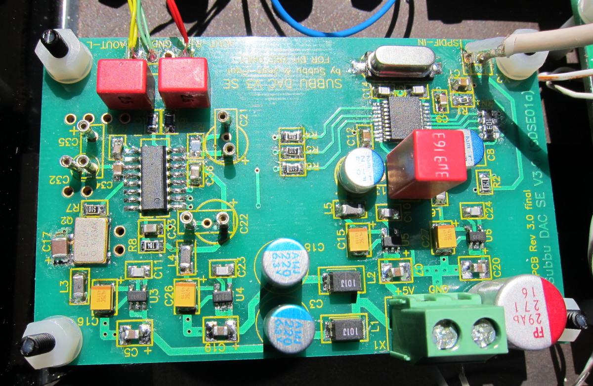

Eldam,
If even JP can't resist your enthusiasm, who I am to try. Your latest efforts have convinced me to relisten to different parts for C22 (Avcc), C21 (Vreg), and C35/C32 (Vneg) - the different power supply caps for the ES9023. I took the V3 DAC that I just boxed up last week and removed C22, C21, and C35 and installed machined pins so that I could quickly swap parts back and forth and do these experiments without having to unsolder anything. Here are a few pictures of the DAC with the machined pins installed and then the "standard parts" that I used plugged into the sockets. I'll let the newly soldered connection settle in for a few hours and then see what I can hear when quickly moving parts in and out - of course, always with the power off when swapping parts.
First up - comparing caps for C35/C32. My current part is Wima MKS2 4.7uf. I will compare to Wima MKS2 1uf in the C32 location and a 1uf BG NX cap. A very quick listen shows subtle but noticeable improvement moving from 4.7uf to 1uf.

Hi Garry,
Seeing your photograph, I believe it should be not hard to desoldering your two C19/C5 to give a try at 1 uF/16V Cornell acrylic (Panasonic have an equivalent plastic also) with your next visit at Mouser/Digikey. New Ipdia glass cap is promising also, but hard to sold (soldering must not touch the body and the pads are below the cap not on the sides also like the more classic smt caps: not DIY friendly.

Gary, nice idea to solder in those machined pins for part swapping. However they will significantly increase inductance. So when you find your subjectively preferred combination just keep the pins 😉
kind regards, Daniel
With ears check, i found the inductance between many pitch to have very few influences with the final result... many caps with 2 mm pitch were bad !
I assume also than it's less important because smd decoupling exist already and I choosed to go 0603 case everywhere (any courage for 0402 case !)
nice idea to solder in those machined pins . . . however they will significantly increase inductance . . .
Daniel,
Thanks for raising that concern. I agree that this is a drawback that could affect the results. Fortunately all these caps are bypassed with at least a 1uf ceramic cap so that will partially ameliorate the bad effect at high frequencies.
I agree that these pins are only useful for quick experimentation and that the results will then need to be confirmed with parts that have been soldered directly to the board.
