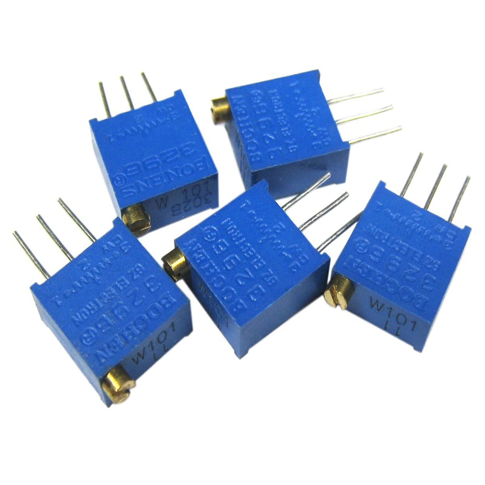

I was looking for these trimmers today.
I realized I didn't really know what values to look for. 2kOhm? 1kOhm, 2MOhm? Any others? Is manufacturer important?
Reactions: cumbb
I would buy a few different values as they are a great way to set up and optimally adjust circuits quickly and easily. 200 Ohm, 1 kOhm, 10 kOhm, 50 kOhm, 100 kOhm, 1 MOhm. I think these are good values to start, to be able to adjust most things precisely. Manufacturer doesn't matter.
