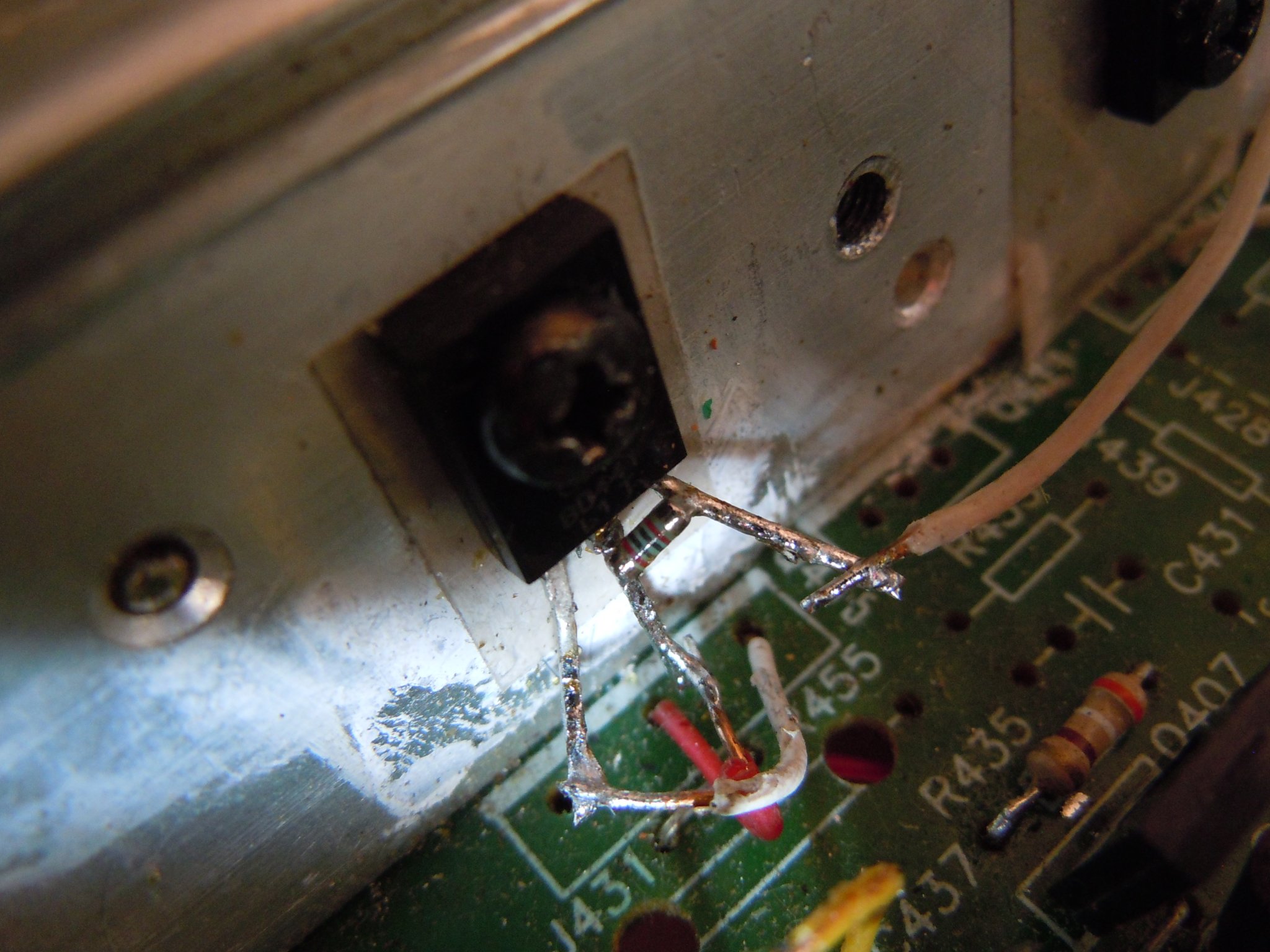

I'm sleep deprived and super busy, but got my BD441s and replaced the output and bias (I had BD139) transistors. These do have extreme clarity and detail to the point that the music seems to have an entire layer of ambience that was lost somewhere in the noise previously.
One of the 12 BD441s I ordered measures very differently and looks different. Not just a different batch, but a different era it would seem. Haven't listened to it yet, but Ube is quite a bit higher than my BD442s. Higher current and amplification too.
I'm sleepy. Waking up early too. I'll enjoy the music for now. Thanks for sticking around and keeping this project/idea alive. I shall finish mine sooner or later I believe. Also received HE6se v2 from Hifiman today. This will be very useful to discern subtle differences between components once I make my cables and resurrect both channels into working order.

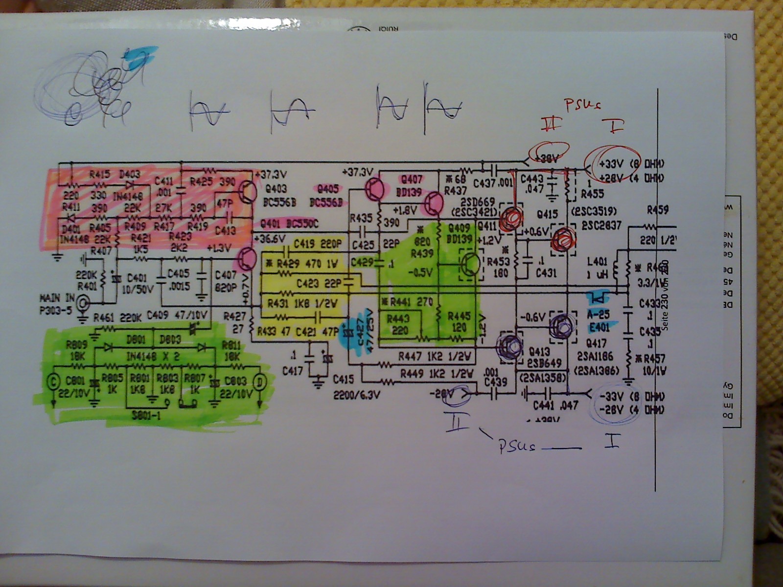

I used the same colors as the PA-940 circuit:
This illustration of the NAD circuit is confusing, irritating. I have made a dozen misreadings;-)
- the green soft clipping area at the bottom left. Disadvantageous in terms of sound. Must be separated by C409! The switch on the back of the device is not enough.
- top left the orange-pink area: corresponds to the PA-940 R3. R3 is all you need! All this hocus pocus unnecessarily modulates the current, disadvantageous.
- what two transistors do as a volt amp in the PA-940, three transistors do in the NAD. Two would have sufficed here too - two phase inversions (Q401 + Q405) result in the correct phase again. In the NAD, a "buffer" is connected (Q407), unnecessarily, disadvantageous.
- the middle green area is the bias control, including C429, which best bridges the entire control with the entire frequency range.
- the yellow area is the feedback. Here with the NAD an unnecessarily complex network, which can be heard: several circuits that smear the signal, disadvantageous. R429 is sufficient.
- the blue area in the middle is the bootstrap capacitor. It only makes noise and dirt.
- the blue thing on the right is a "breaker", a "fuse", E401. Sounds bad and is unnecessary.
- on the right is the 2 stage complementary transistor push-pull follower, marked red, pos. half wave, and blue - neg. half wave.

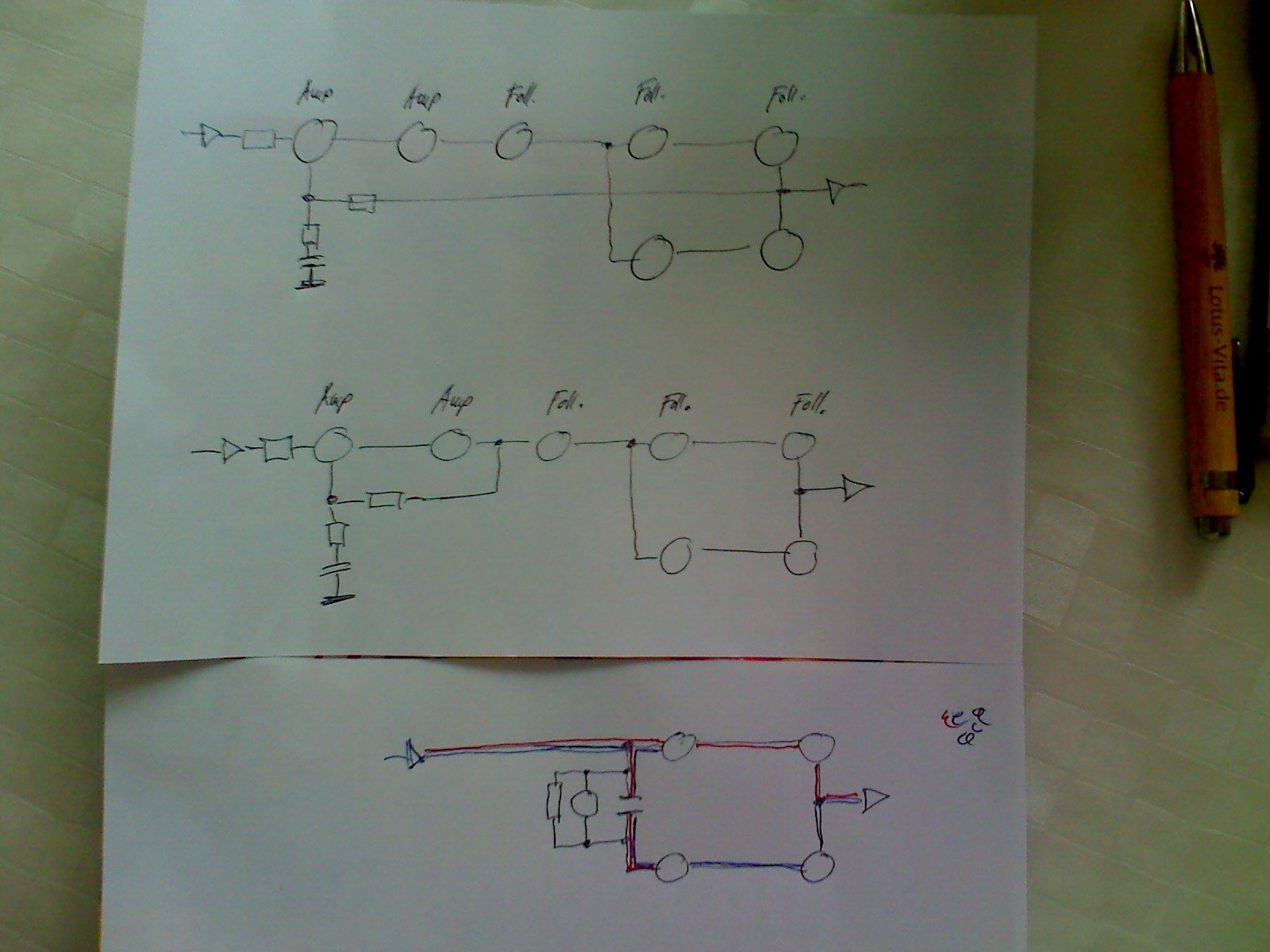

I have drawn the principle circuit diagram of the NAD again. Above with the original over all feedback.
Since I want to keep the NAD circuit final (It is a friend's NAD - I also have his loudspeakers and will rework them and adapt them to the NAD) - 3 stages preamplifier, two stages PP power follower, but want to keep the special sound of the Folger, I will later limit the feedback to the two voltage amplifiers. Because these make the noise without feedback.
The bottom picture shows the push-pull stage again. Here with the bias network and a capacitor recommendation. Many do without this capacitor, others only use a small capacitor.
What many people are not fully aware of is that the AC signal must pass through this bias regulator as unchanged as possible so that the - in this case negative - other half-wave can be amplified. In any case, the regulator is a double PN junction and also the resistor network. No one can say what will come out on the other side, when and how: it is "non-linear".
I recommend bridging the entire regulator by means of a capacitance that is oriented to the sum of the resistors involved, cut-off frequency < 20 Hz. Then also take into account in AC withstand of this capacitor. The expected signal voltage is much higher than the set "bias voltage".
Use the cleanest and clearest and most neutral one.
But also the bias transistor is elementary for the sound: here, too, use the best-sounding, cleanest and clearest, most neutral one, because its current quality is clearly audible, see e.g. observation #102, #125.

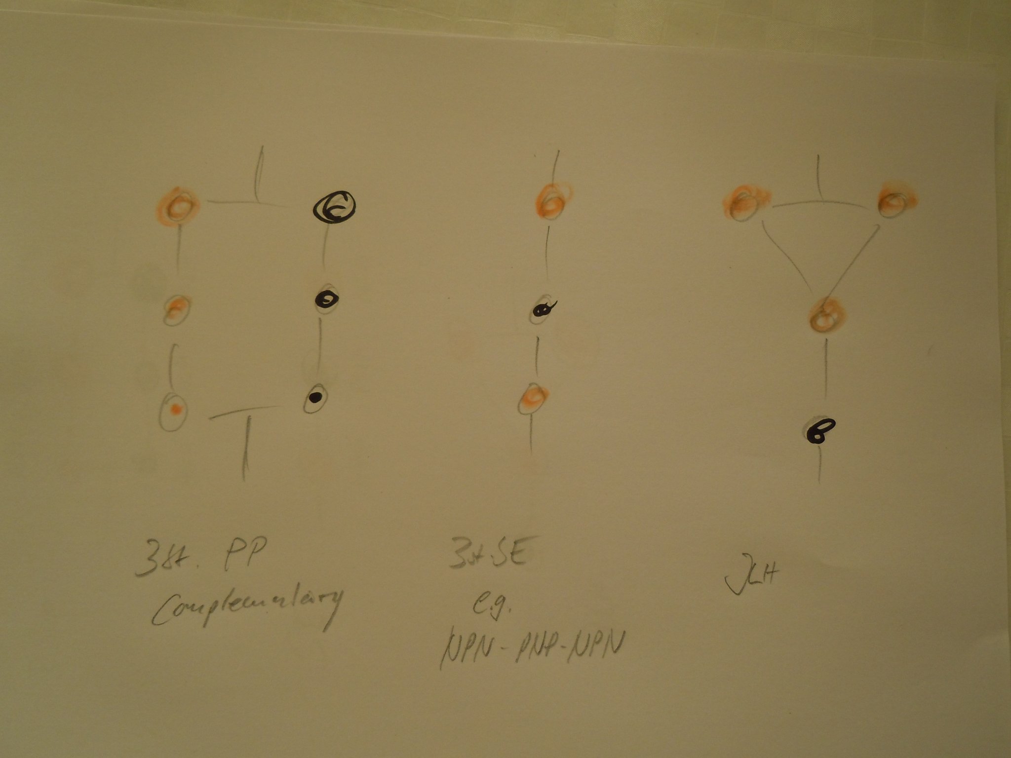

There are circuits in which each half-wave has both an n-channel and a p-channel type. The tonal characters of the components remain the same in every application, in every function: it therefore have both characters in every half-wave, which homogenizes the sound. However, it also sum the modulations with each stage. The sound becomes more homogeneous, but also dirtier, greyer, duller, more overcast.
A great example is Jean Hiraga's Classe A:
4 complementary steps, of which 1, 2 can be crossed and 3, 4 can be crossed:
https://sound-au.com/tcaas/hiraga2.htm
