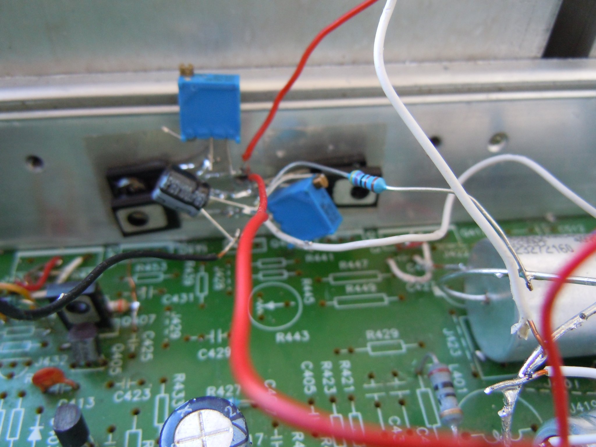

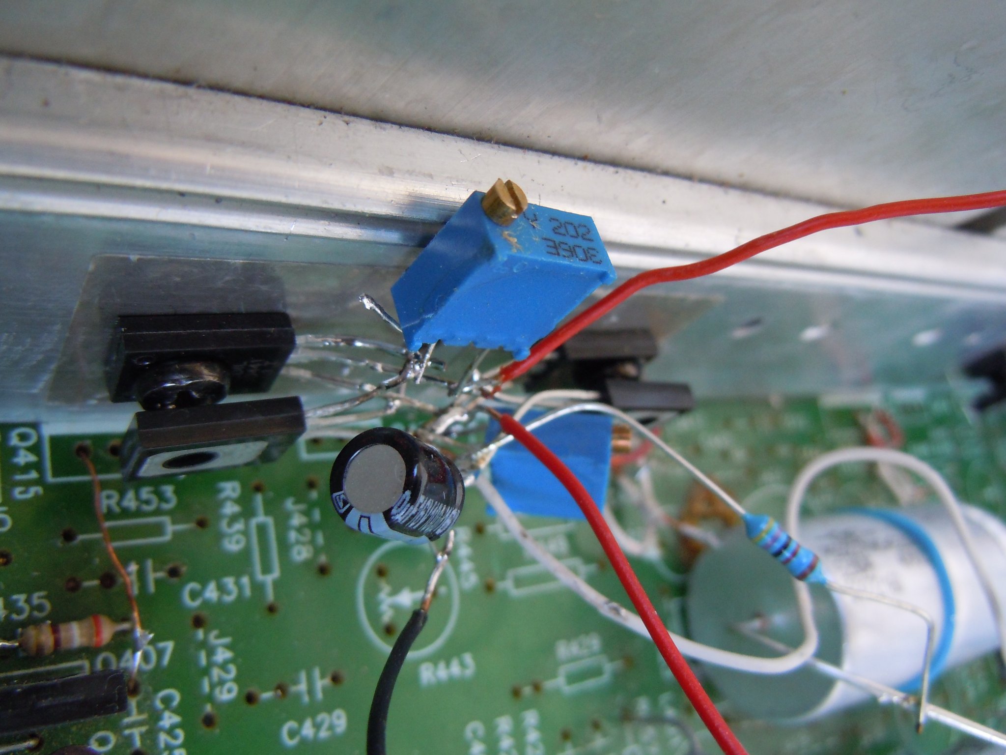

I quickly made a 2-stage "crossed" follower. Initially without anything, I would only react if problems arose. The sound is more overcast, more tired, more doughy than a single-stage follower, less "flowery". But very balanced and fine. The BD 441 sounds very focused, the BD442 even tighter: this follower also shows these characters: it is tighter, more focused and has more spatial depth with uncorrected connection compared to almost all other power amplifiers. If it is too clear, one should move the speakers slightly apart.
I think it will be one day. A bit here and there, but it will be round enough;-)

So you turned it into a diamond buffer? That’s not actually a bad idea, since it does have thermal stability advantages over a regular EF. But all 4 trannies really need to be heat sinked together to gain that advantage.
IIRC, some NADs actually use diamond buffers. They also use “diamond buffer like” front ends, and run them as conventional (push pull, not SE input like the 3020 and it’s cousins) CFAs.

Got me thinking you may be onto something with that diamond buffer. The BD441/2 are perfectly adequate for an easy to drive 8 ohm load (one that doesn’t dip to 6) as far a power handling. Three in parallel would beat a 2N3055. Maybe a DB, with one driving three, and you have something that’s technically sound for a +-30V rail and real 4/ohm loads. Switch to MJE243/253, and then you even have their fT advantage. All with cute little TO-126’s. And you even get the fun of matching 4 transistors - well, 16 really because you get to do it twice per channel. Matching would be recommended. And the closer NPN is to PNP the better too, as that reduces input bias current.
Wouldnt be the first time somebody just replaced a NAD output stage. @poundy used LatFets and was pleased with the result.

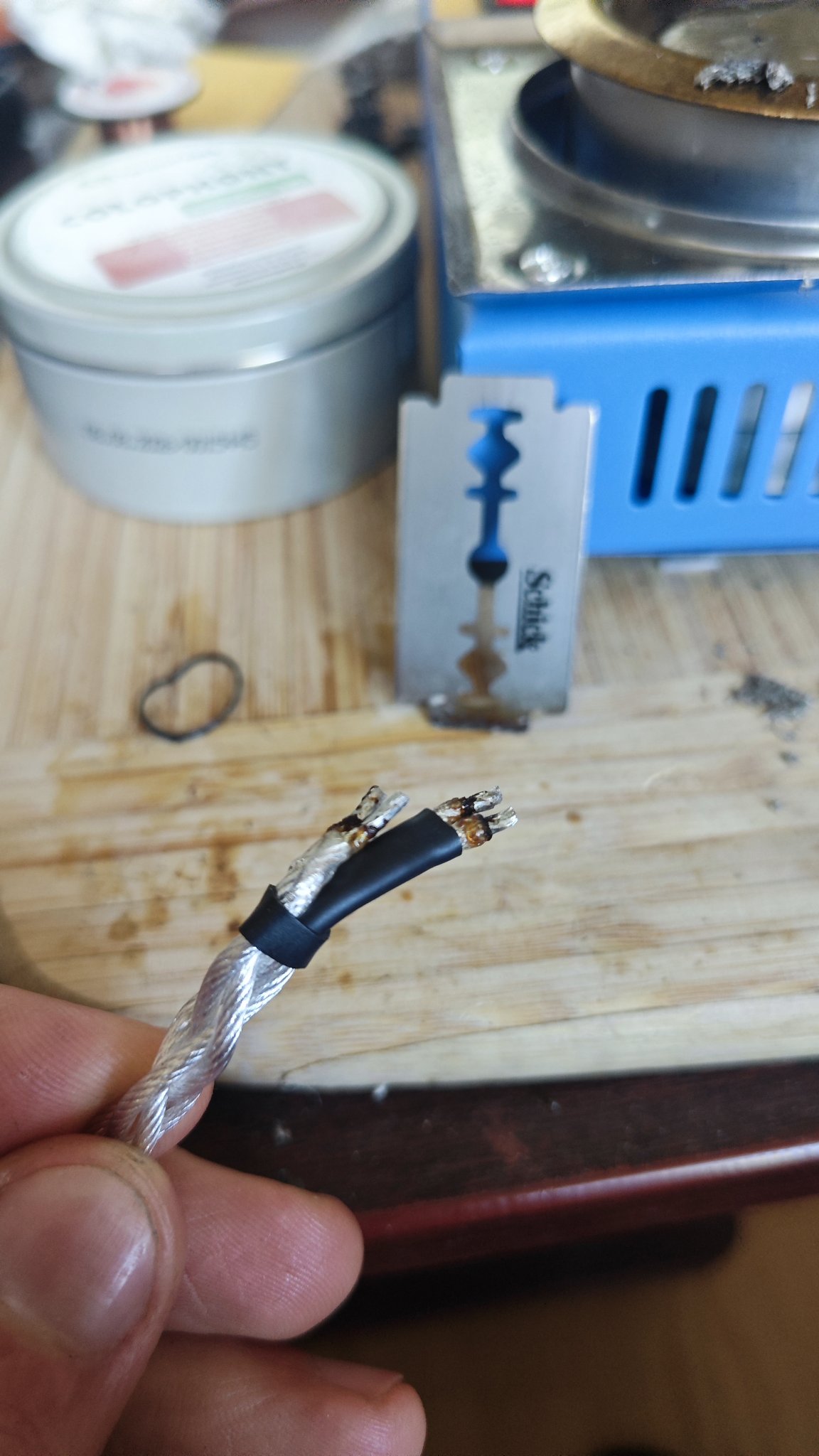

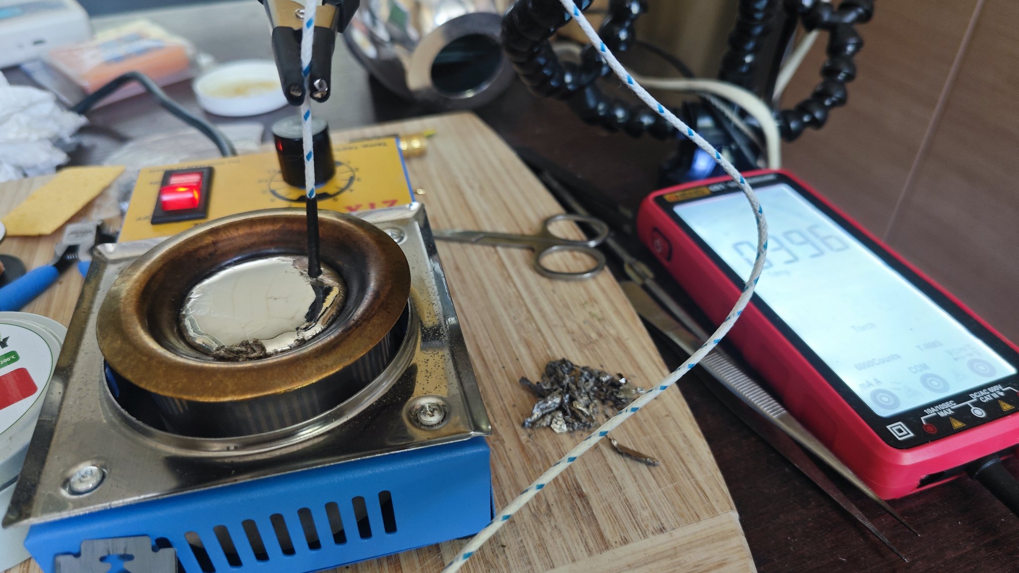

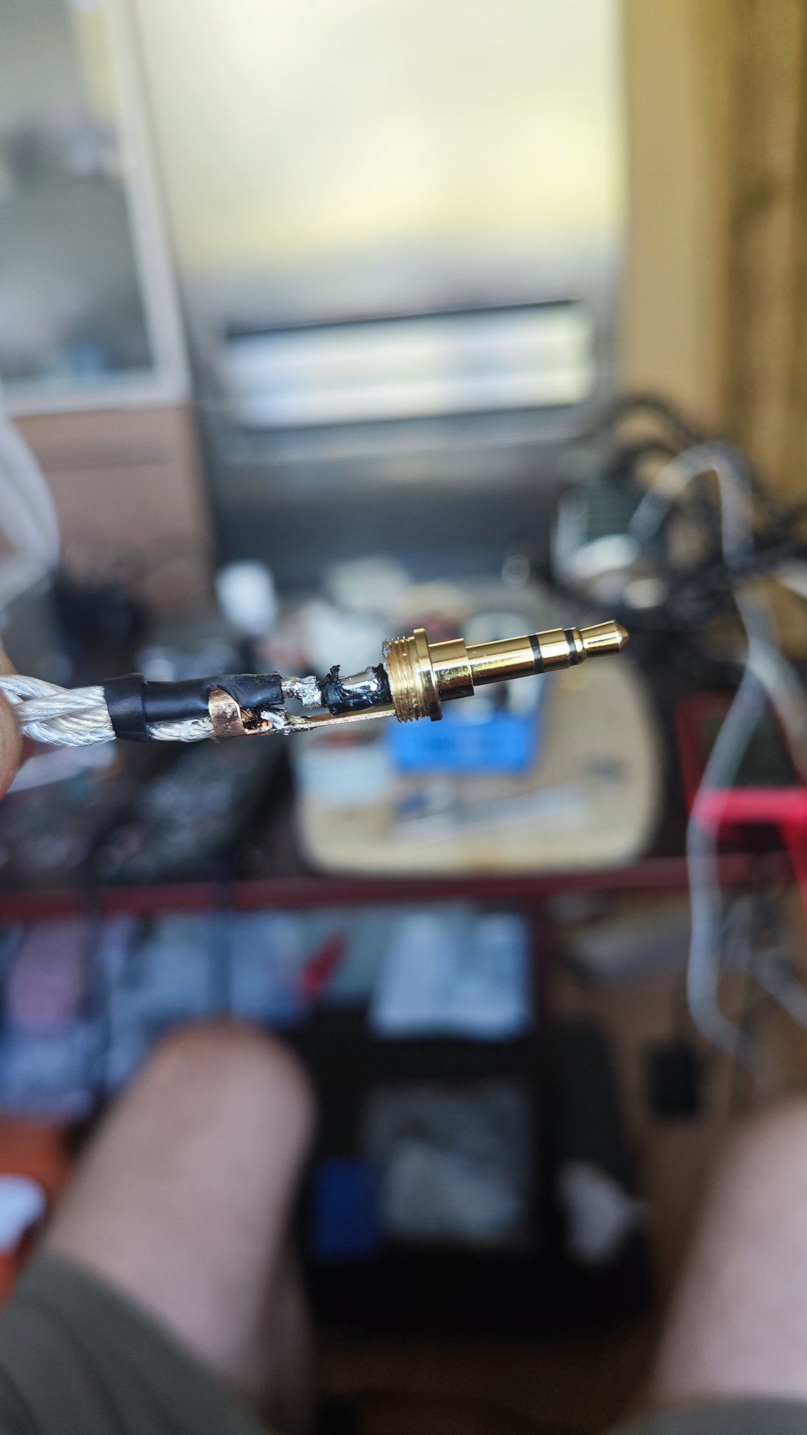

Also today is a great day. After years of mostly failed attempts, today I became a man capable of soldering litz wires. 999 pure Tin works perfectly. This is a great wire here. Advertised as 6 or 7 N OCC silver plated copper from Furakawa Japan, but in any case it sounds as good as some of the best cables I've ever heard. Very alive and preserves the bass nicely. Similar character to Nordost, but way more conductor for the price.

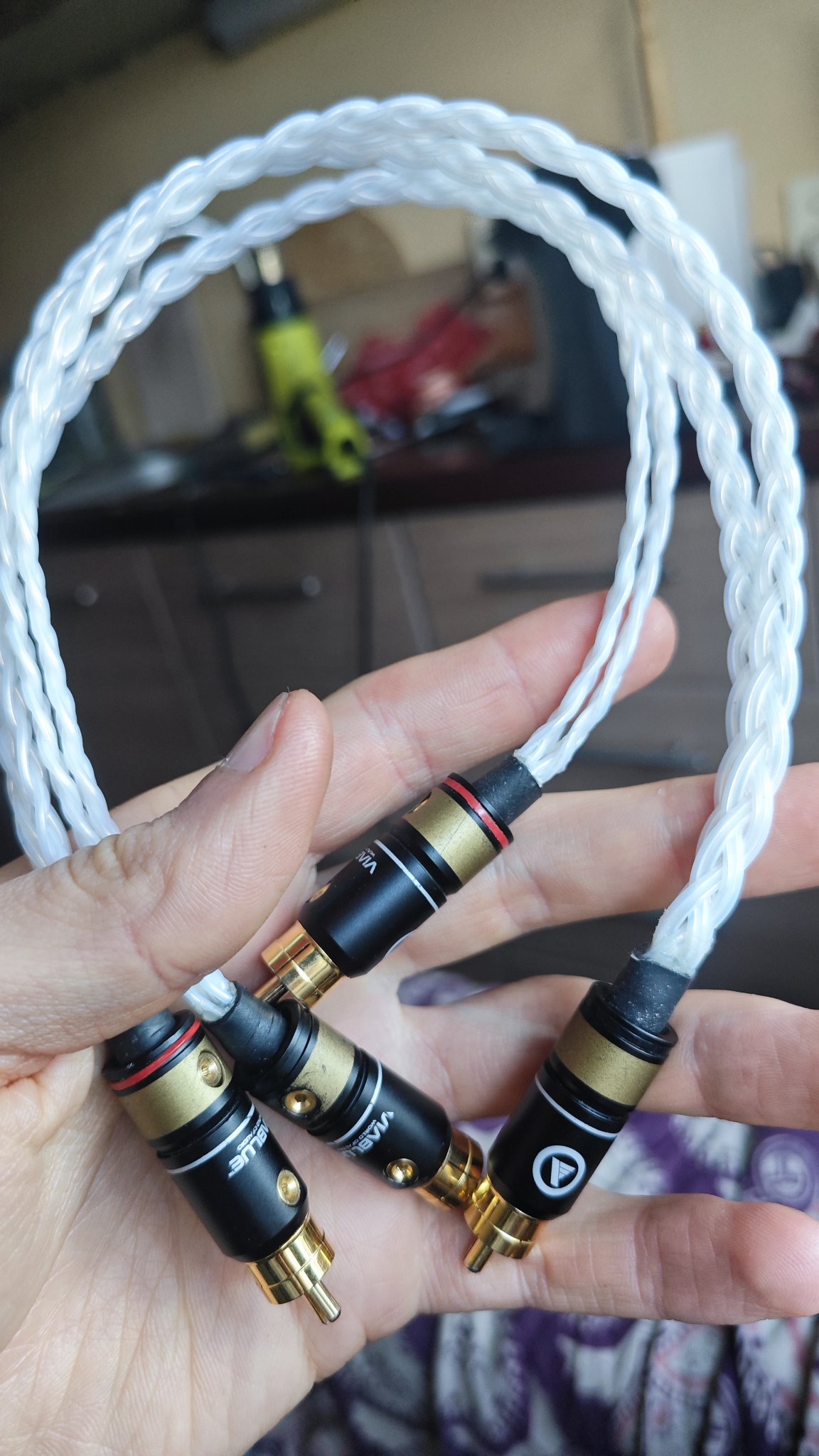

Just yesterday reworked my RCA cables - sound like a dream. Six silver cores per pole in teflon tubes. Short as that greatly reduces noise floor in unbalanced cables. Much more effective than any screen! The silver is from Latvian folk named Lavricables. Not the best (some OCC silver is on another level) but it's great for the price. And it's as good or better than any copper I've heard regardless of price!
Sir, when matching the transistors, what should I focus on most, the Ube, Ie or hFE? My first batches of BD442 441 had completely different hFE and Ie, only the Ube was close enough to find matches. Now my new batch of BD442 have almost two times smaller hFE and Ie so a possibility of matching on that opens up. Well more the current, less so amplification, but what should I focus on most when matching?
If you are doing a diamond buffer, it is necessary to match the NPNs to each other and the PNPs to each other, for vbe and hFE. Putting in degeneration resistors in the output pair removes this requirement for thermal stability, but they would be nice to at least minimize. Scaling of the bias currents between the two stages is done by the ratio of device areas in ICs, for discretes, that’s paralleling. Mismatch between NPN and PNP vbe results in an offset voltage. Mismatch between hFE results in a net input bias current. It is nice to eliminate both, but neither is a show stopper. Paralleled transistors need to be matched for sure, if parallel outputs are used. All the transistors need to be at the same temperature to maintain any of the advantages of a diamond buffer and to be thermally stable at all. All on one heat sink, co-located to the extent possible.
Properly implemenTed, it is probably more thermally stable than the original emitter-resistor-less EF2 that was there in the first place. In practice, I’d probably put .047 ohms in the emitters which would allow safe paralleling and allow for some temperature gradient without runaway. If you used three outputs for one driver, that’s a 120W output device which you can actually beat on.

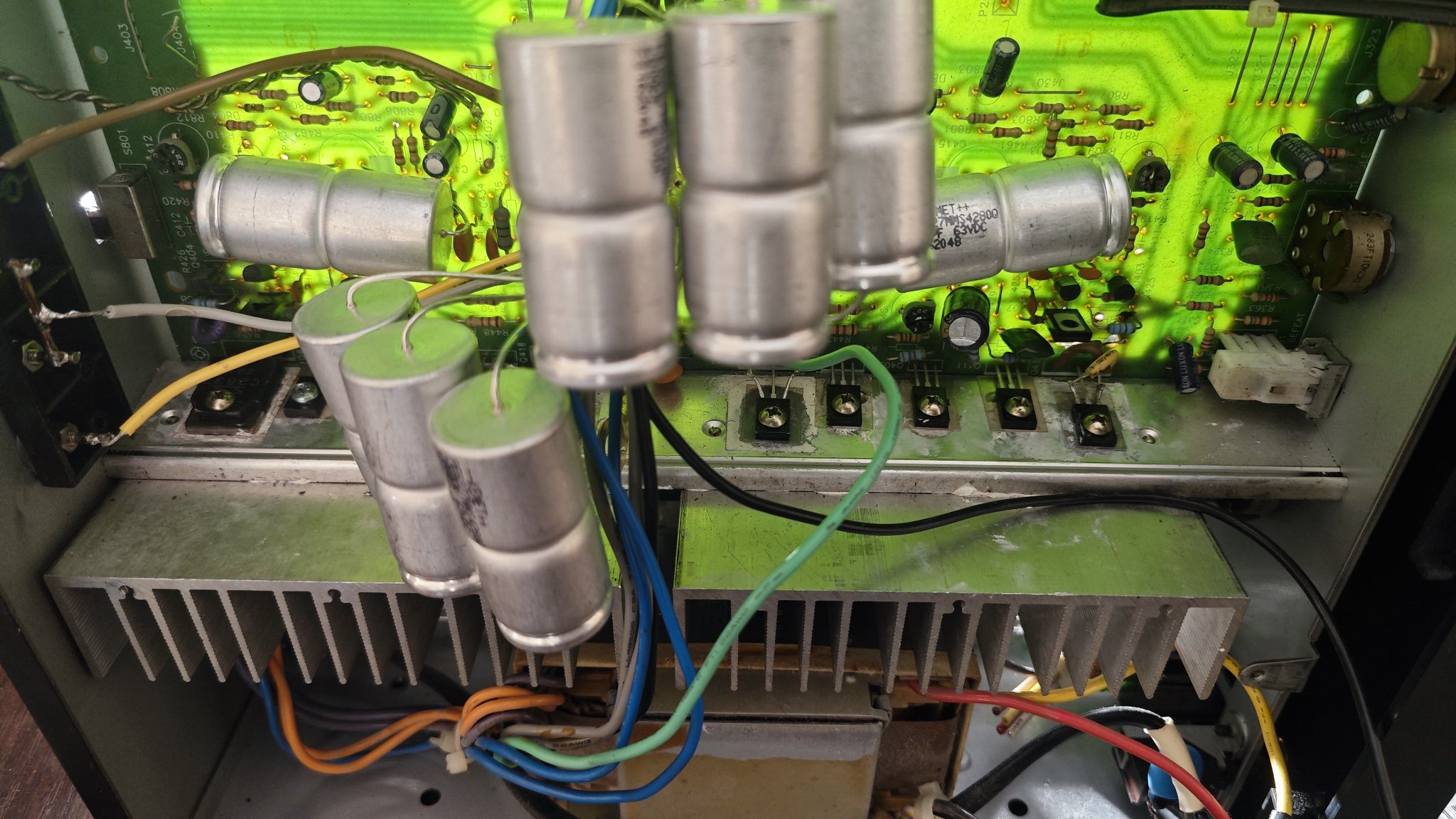

I added a couple more of 2.8 mF PEH227 to the PSU. The noise floor is perhaps a little lower and a lot smoother, but it persists. Other than that the sound seems to have become even more enjoyable and powerful and serious and detailed. Well, detail didn't change, but everything's more effortless, more musical so it may be perceived as higher resolution. Or I still can't get over how amazing my headphones sound with this amp truly awesome. For sure the noise floor has improved (smoother, less audible) and overall enjoyableness factor has raised or at the very least hasn't become reduced.
Now I tried making left channel into 1 stage follower with BD output transistors, I tried it as 2 stage with BD outputs, I changed it into newer batch BDs, I changed the output transistors into the original ones, but the high frequency fuckery that is static like is still very present with the sensitive headphones. That's a bit unfortunate, because all other factors being equal between the channels, I have no idea where the issue may be. On the positive side, I know it's not the BD output transistors that are causing this so I feel free to use them if I want at the end of the day. But this issue will make it much harder to do critical listening and comparisons with headphones rather than just one speaker. Oh well. I might have damaged some part of this channel. Most won't ever notice it. It's subtle. Unless you listen through sensitive headphones. On most speakers this will be completely inaudible.
Still even with speakers this complicates doing comparisons between different configurations because I lost ultimate trust in the left channel. So deciding on 1 vs 2 stage follower or which output transistors to use will be post poned for a later time, possibly with another amp entirely unless I find the culprit. The headphones will be very valuable in making this decision.
Although I did most of the modifications recommended by cumbb there's more to be refined. However, I don't feel like doing further refining before I even figured out which kind of output agreement I want to use. Besides diagnosing this issue or starting from scratch, I don't know what else to do with this project. Probably most important and valuable steps have been taken, I doubt it can sound much greater than it already does unless every corner and fascet has been polished and refined, for which this doesn't feel like the right timing. I guess I'll just try to study the diagrams and the basics of what is happening here at all and put down the physical tools for the time being.
