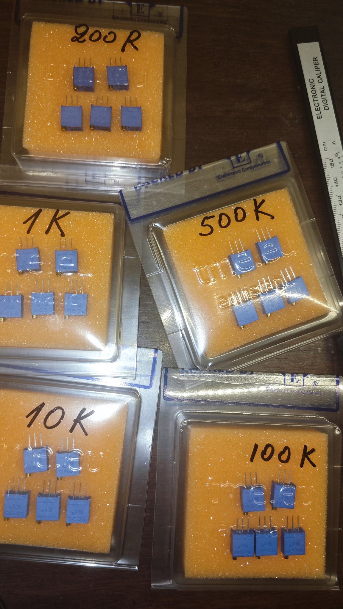

The simplest way could be a trimmer instead of the bias transistor. Set it initial 0 ohm, power the amplifier and then adjust until the 1.2 (1 stage follower) or 2,4 volt (this 2 stage follower) volts are reached (further adjusting increases the idle current, but not the idle voltage).

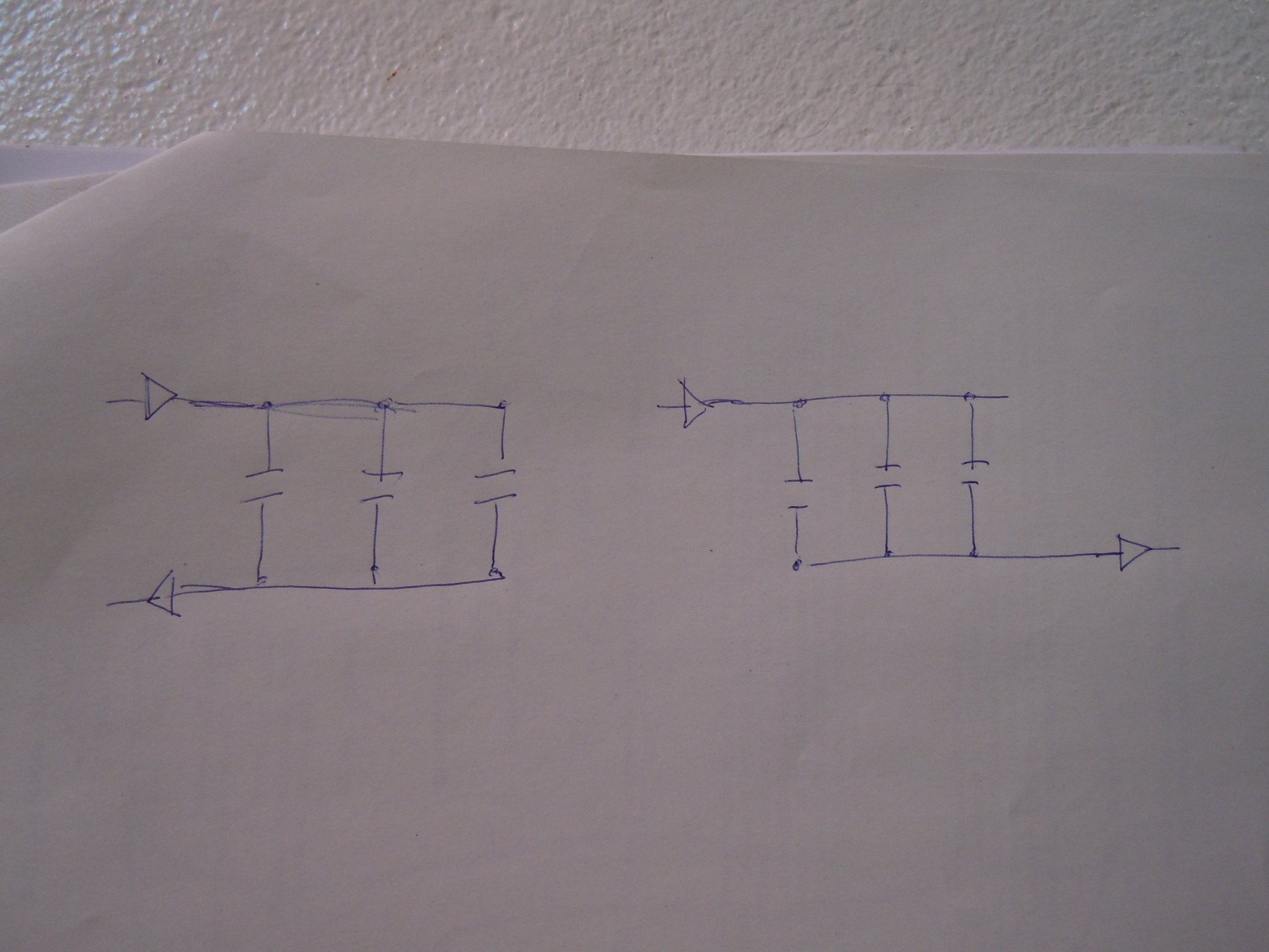

22mF(actually 20mF) PEH200 vs 2.8mF PEG227 (all 8 measured more or less exactly 2.8mF). Big ones are blacker, more silent (not talking about noise floor here but about music presentation), more analytical and the noise floor is so low I couldn't hear it with my speakers last I remember. The small ones have clearly hearable noise floor, but more emotion, warmer, I don't know about ultimate detail, but voices are more realistic and enjoyable, everything's smoother, but what I mean is not smothered rather more liquid, I don't think I'm loosing any detail, maybe even the opposite - the detail that was there before is still here, now more engaging and grabs your attention more. As I said - everything is quite a bit warmer. Surprisingly, the bass is actually better defined and more incisive and textured at least on the moderate/low levels I usually listen at (this seems to carry on on higher volume too - the bass seems better) which is very welcome! Overall preferred are the smaller ones in most if not all aspects. Well except of course in terms of having higher noise floor, which can be very significant with headphones.
That sounds like a comparison of 1 piece 22 mF and 1 piece 2.8 mF.
Try putting a few 2.8 mF in parallel. And since we don't just have a basic education in electrical engineering, here's a selection that defines current differently. See if they sound different, and feel free to write about the differences, if there are any;-)
