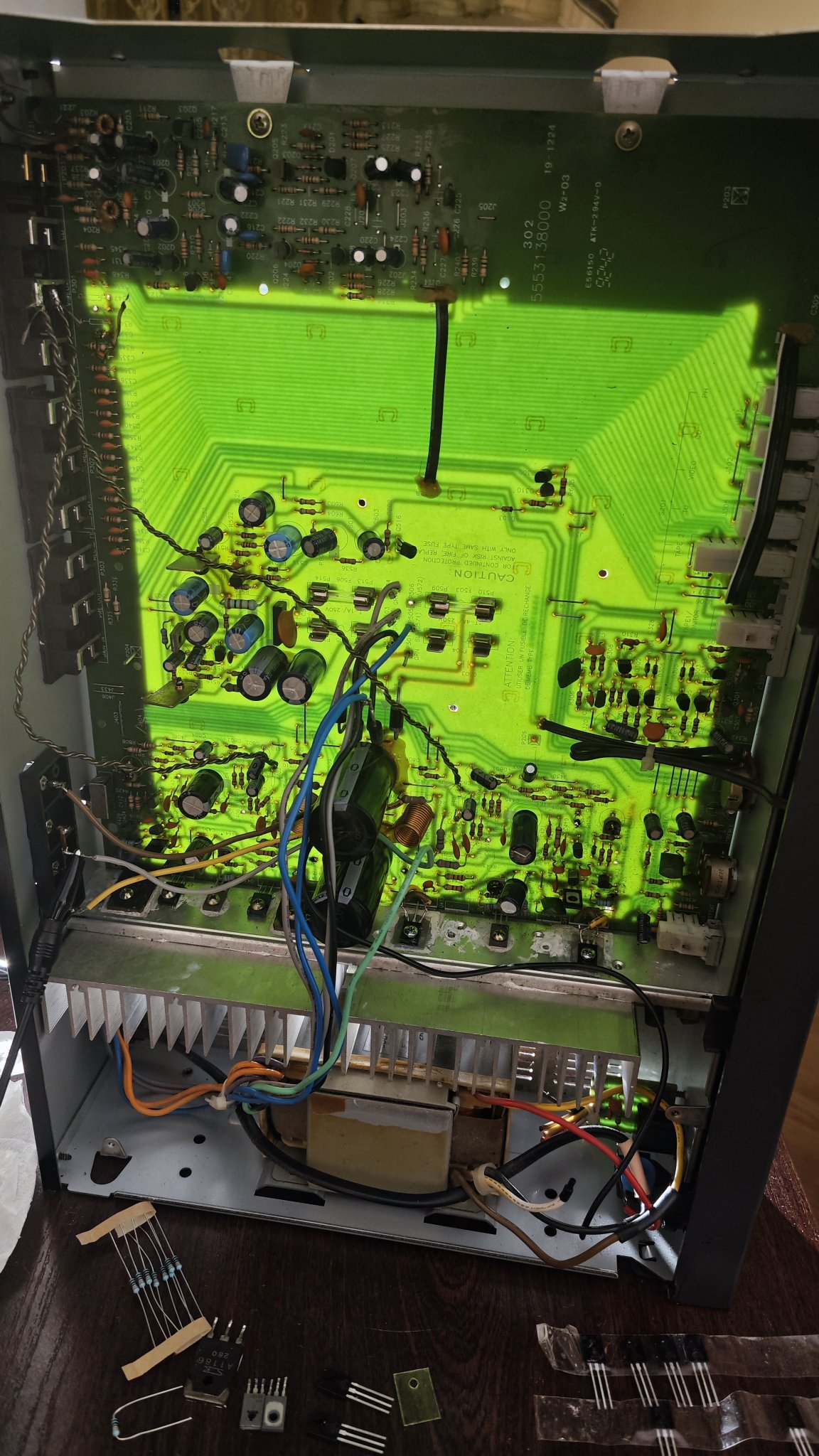

Regarding the (left) channel with completely negative bias - I have measured -27.5 V at the base and -27 V at the emitter of both the BD441 and BD442. The collectors receive -30.7 and 30.5 V. So it seems only the BD442 is actually turned on. But when I disconnect BD442 base - both bases are still reading 27.5 V.
Took me a few hours playing around and just looking at the board trying to understand what it even is, but it seems I found a couple of culprits.
The 200 uF cap C415 was inflated and sizzling. Luckily I bought a single 220 UF Panasonic for reasons I don't know.
And another culprit the Q409 (which I assume is some kind of bias regulating transistor) which wasn't working as a transistor anymore. Replaced by BD441. Now I read same collector voltages, the bases have BD442 -19 which then drops and stabilizes around -17.6V and BD441 has a contant -27.9V. Emitters BD442 and BD441 both have -19.5V.
I'd like to repair the left channel (which given the somewhat simplier design and my knowledge increasing everyday I believe I will manage at a point in time) for easier comparison between with vs without driver transistors and only then proceed with the removal of driver transes on the right channel as well.

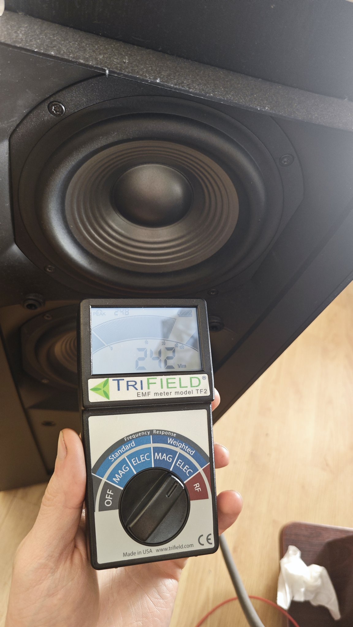

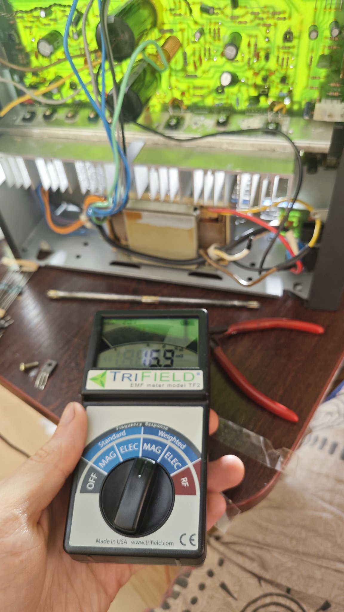

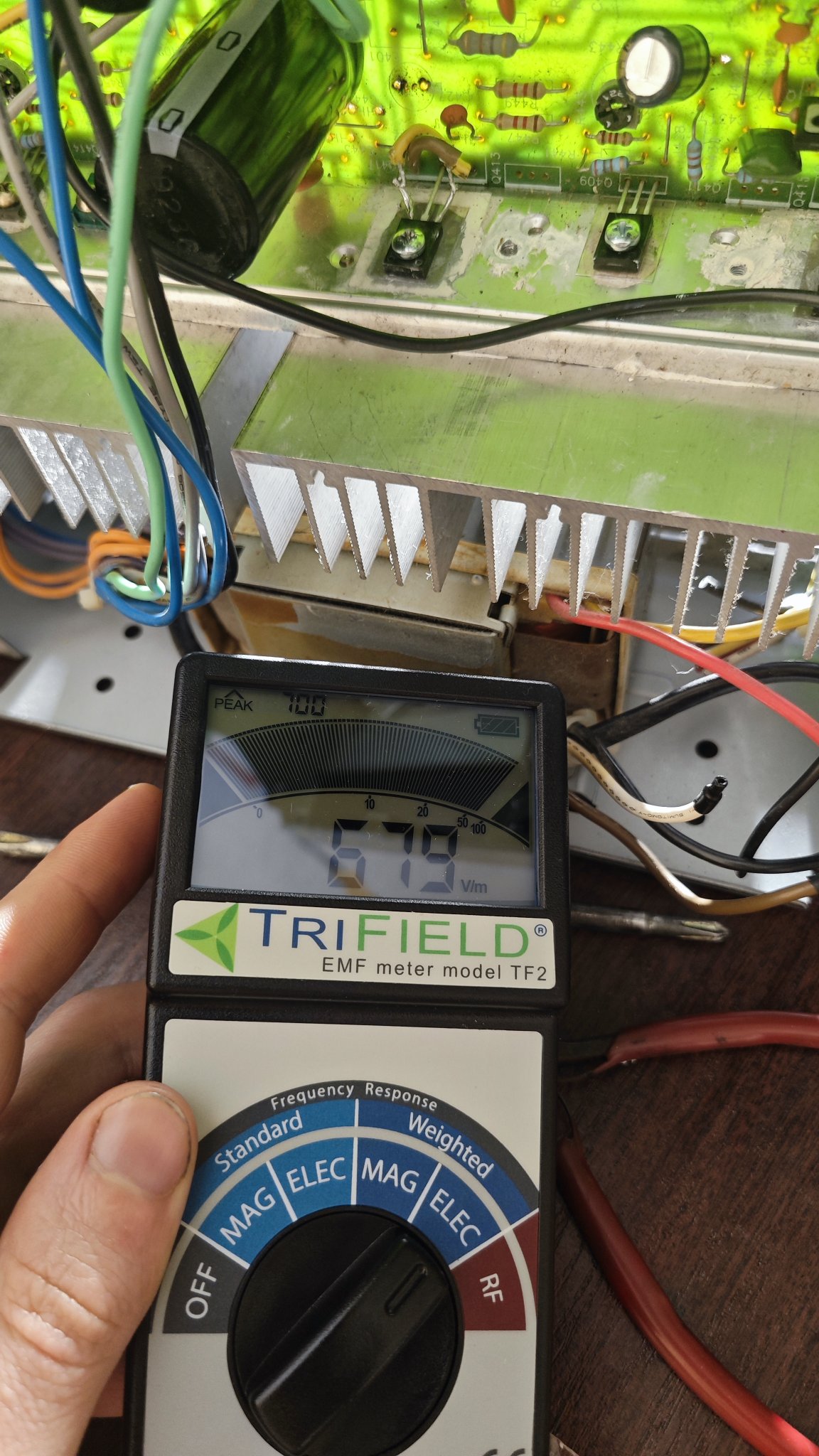

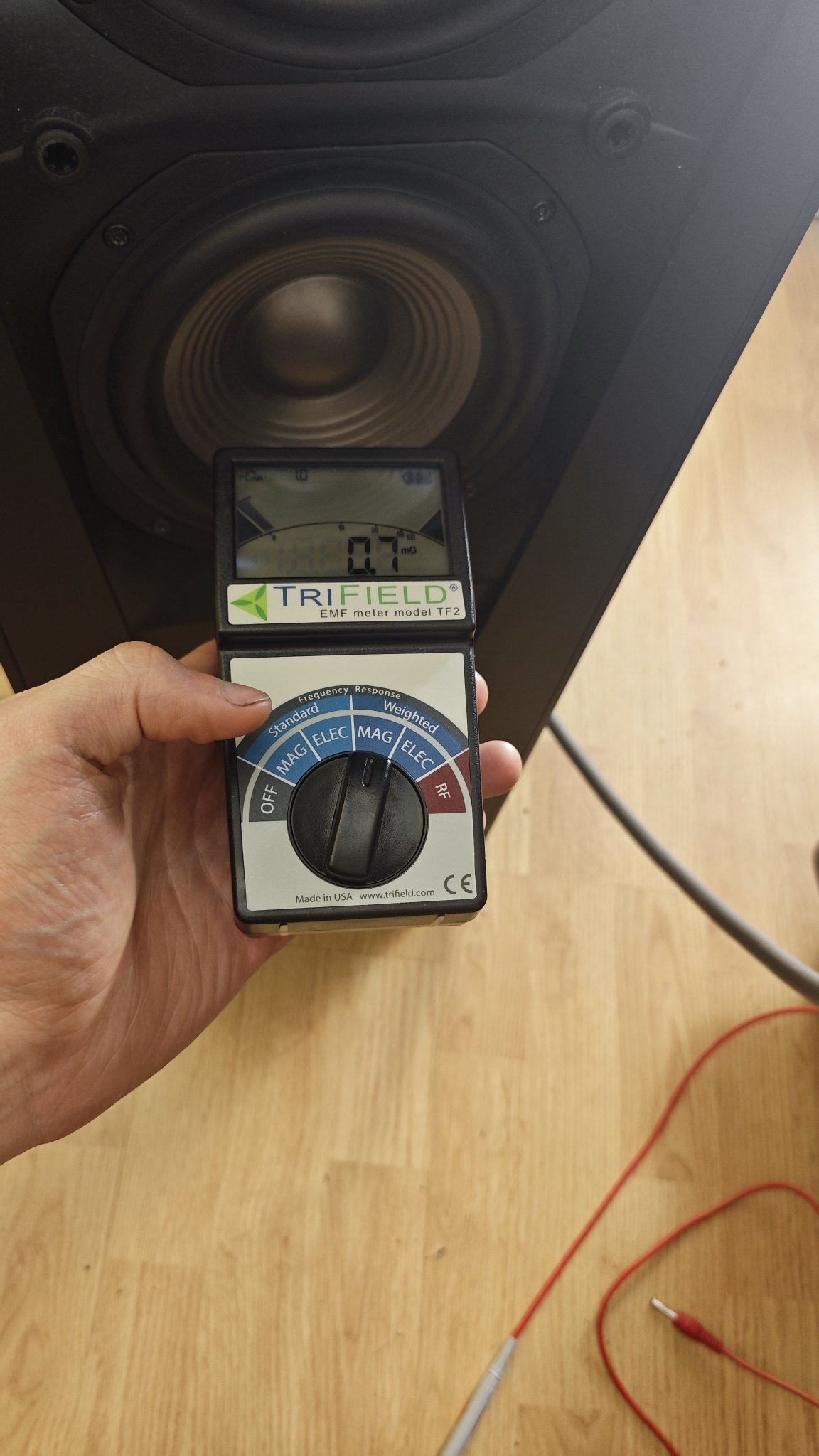

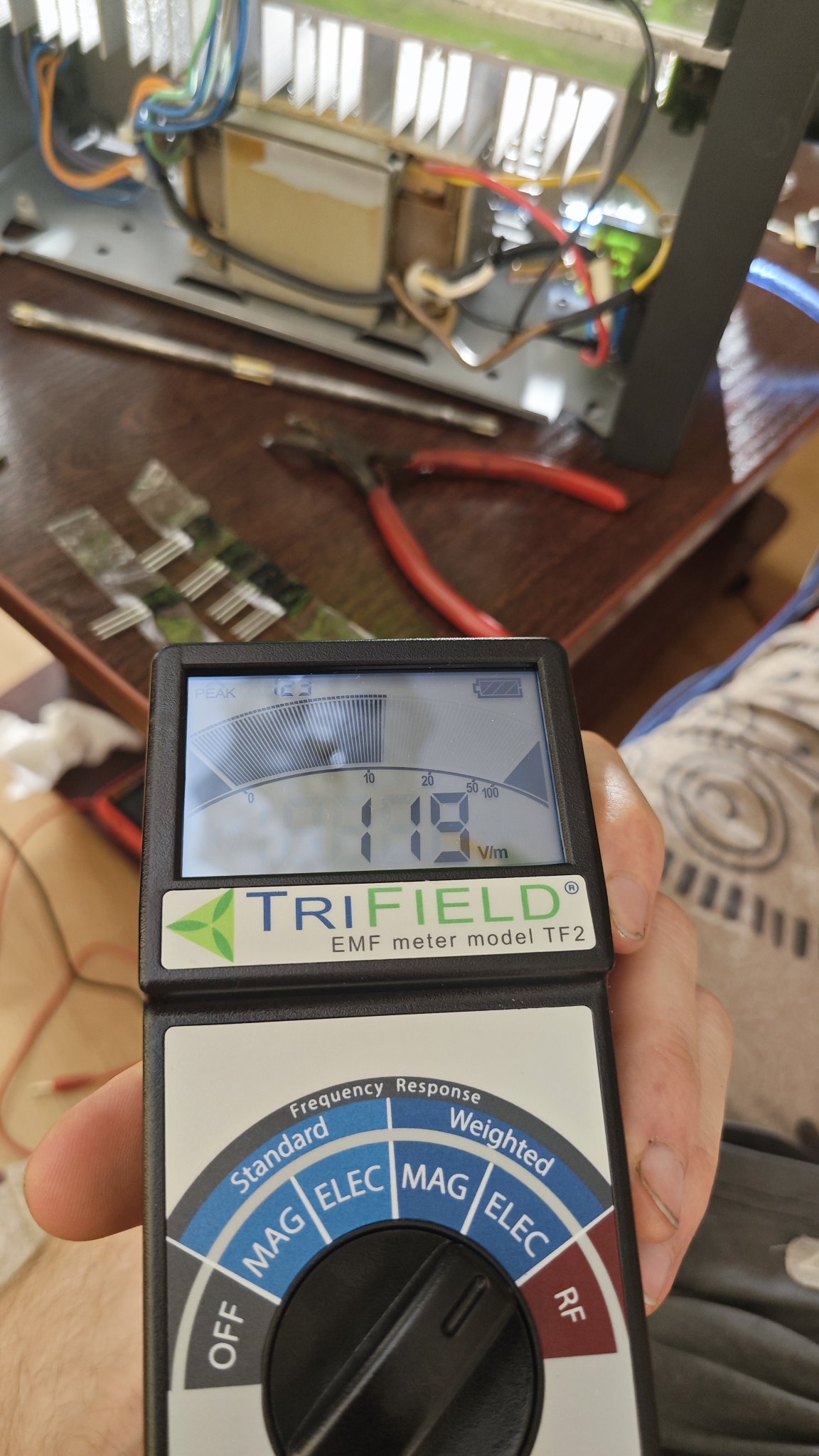

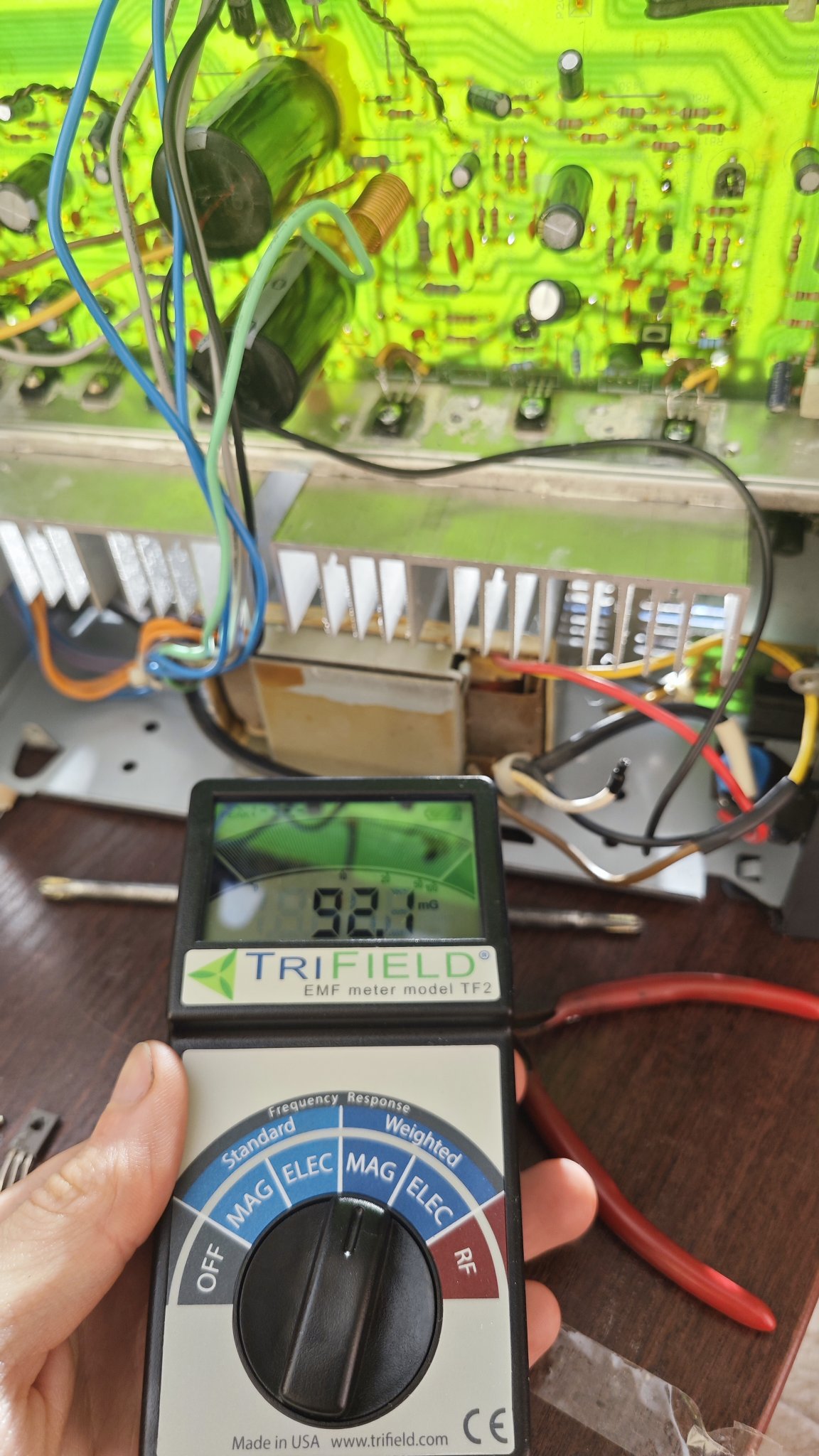

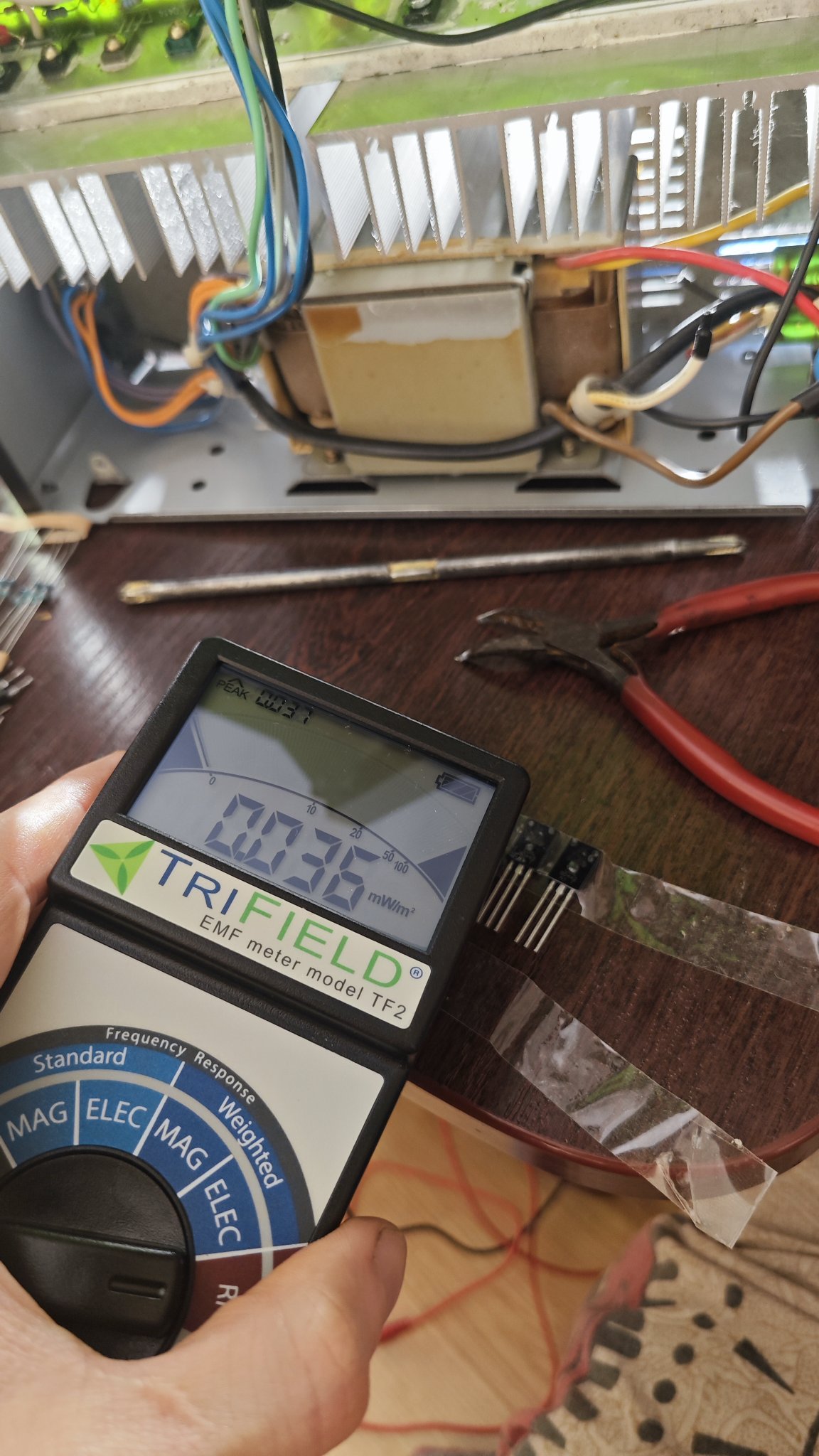

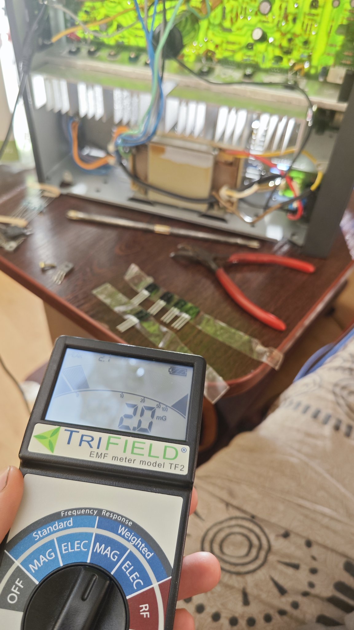

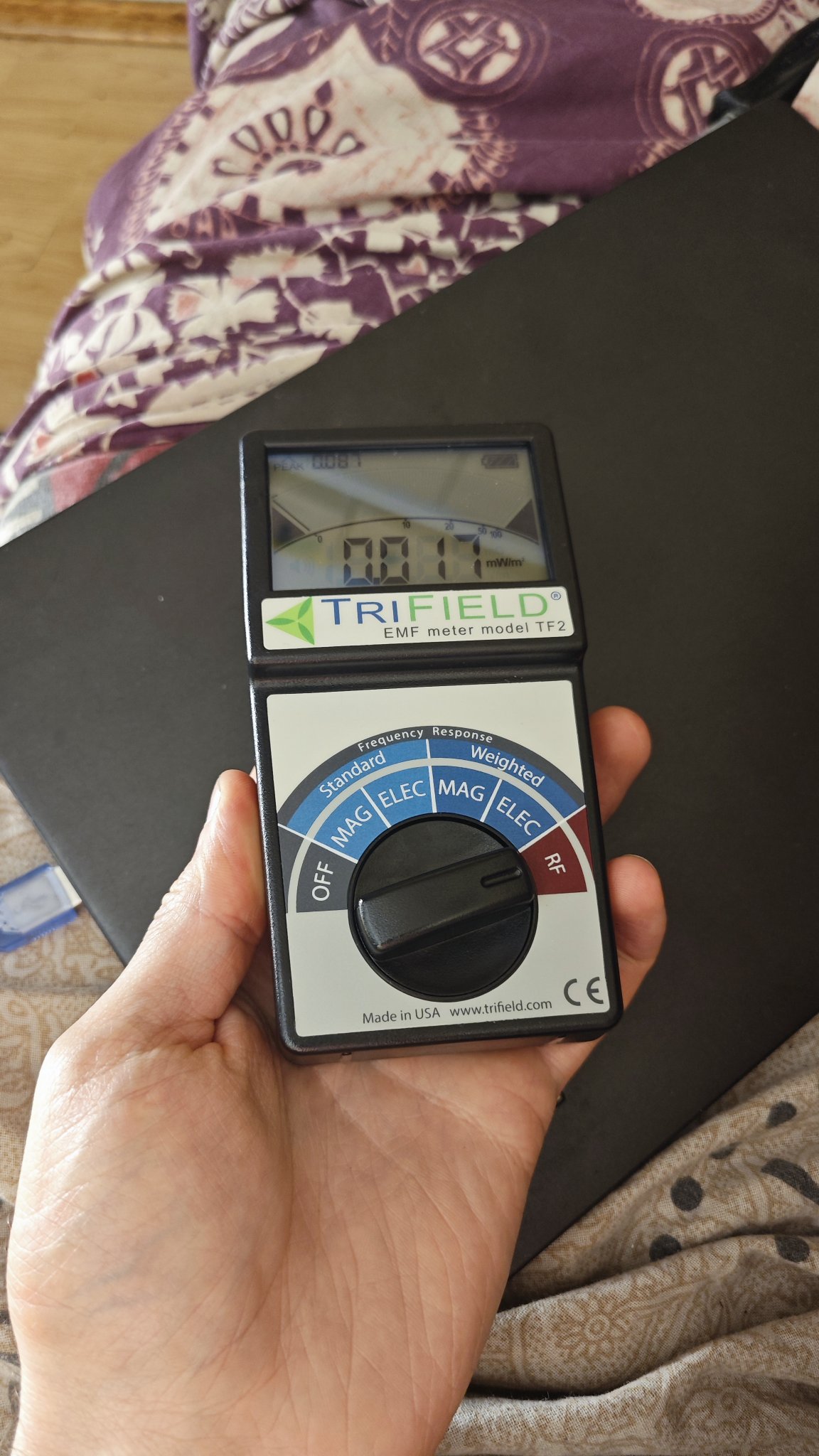

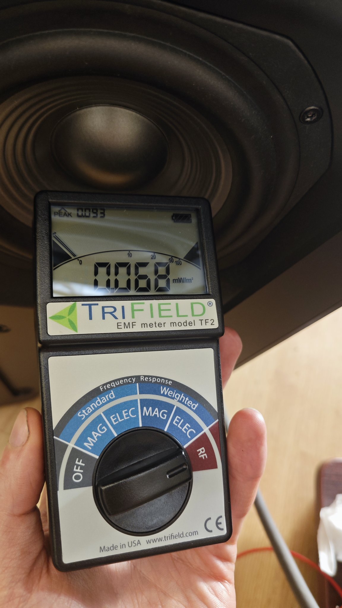

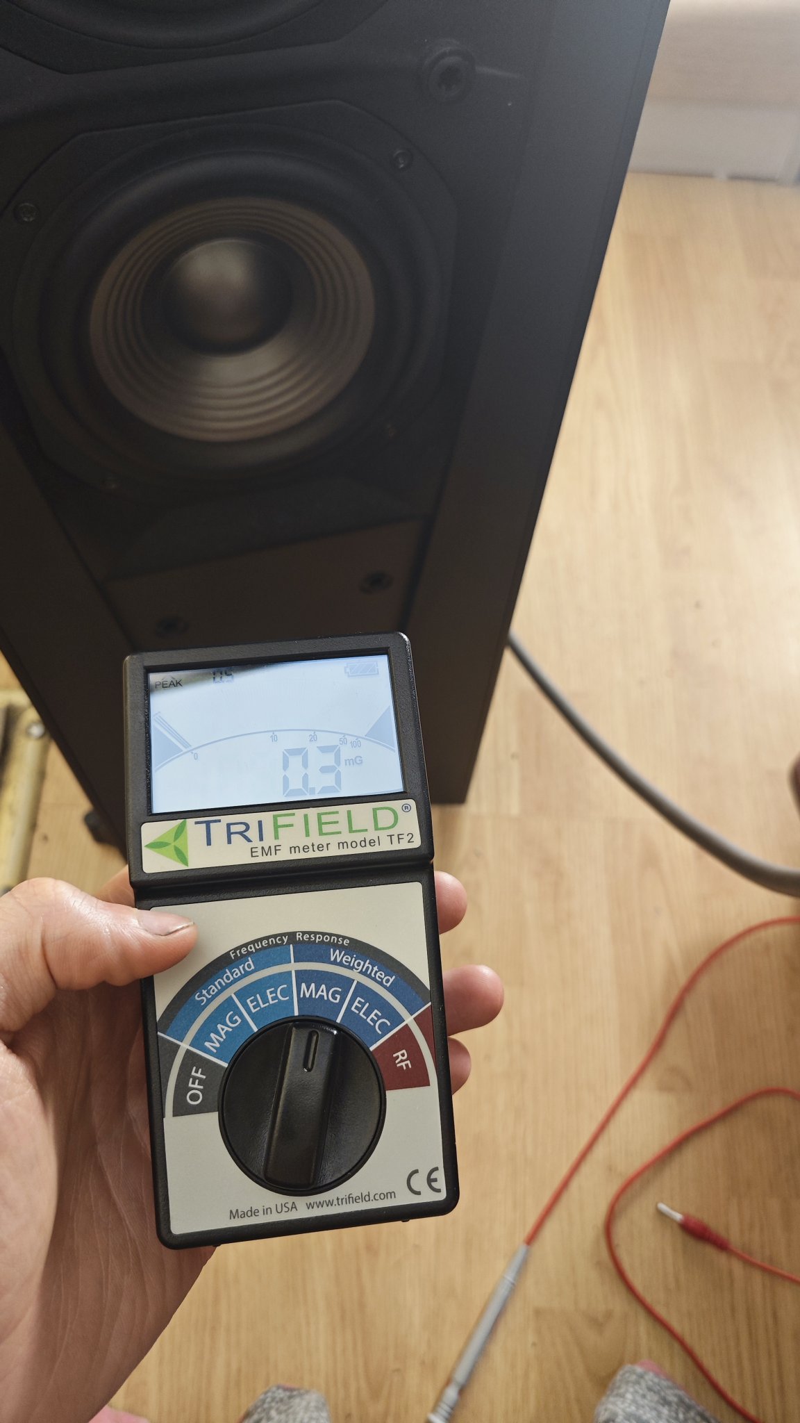

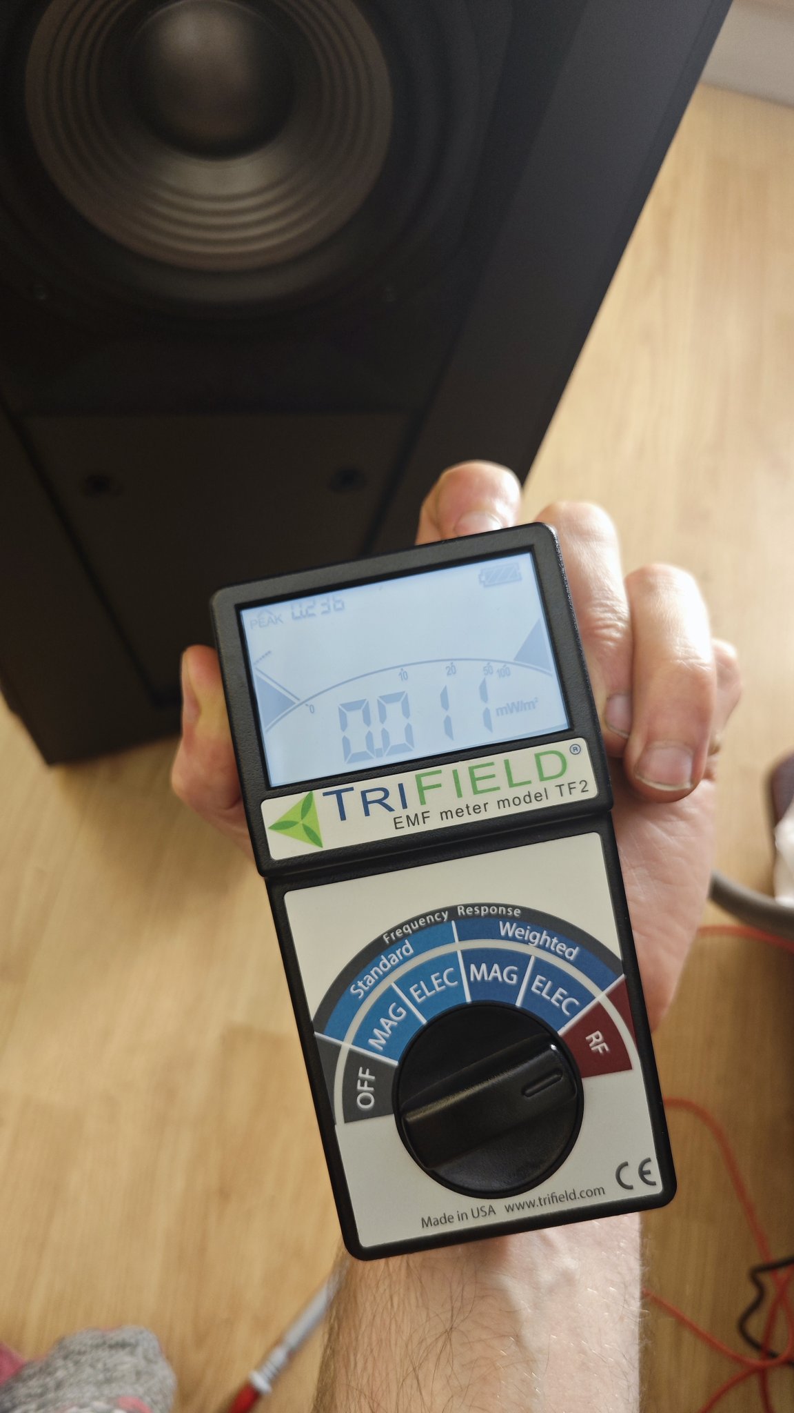

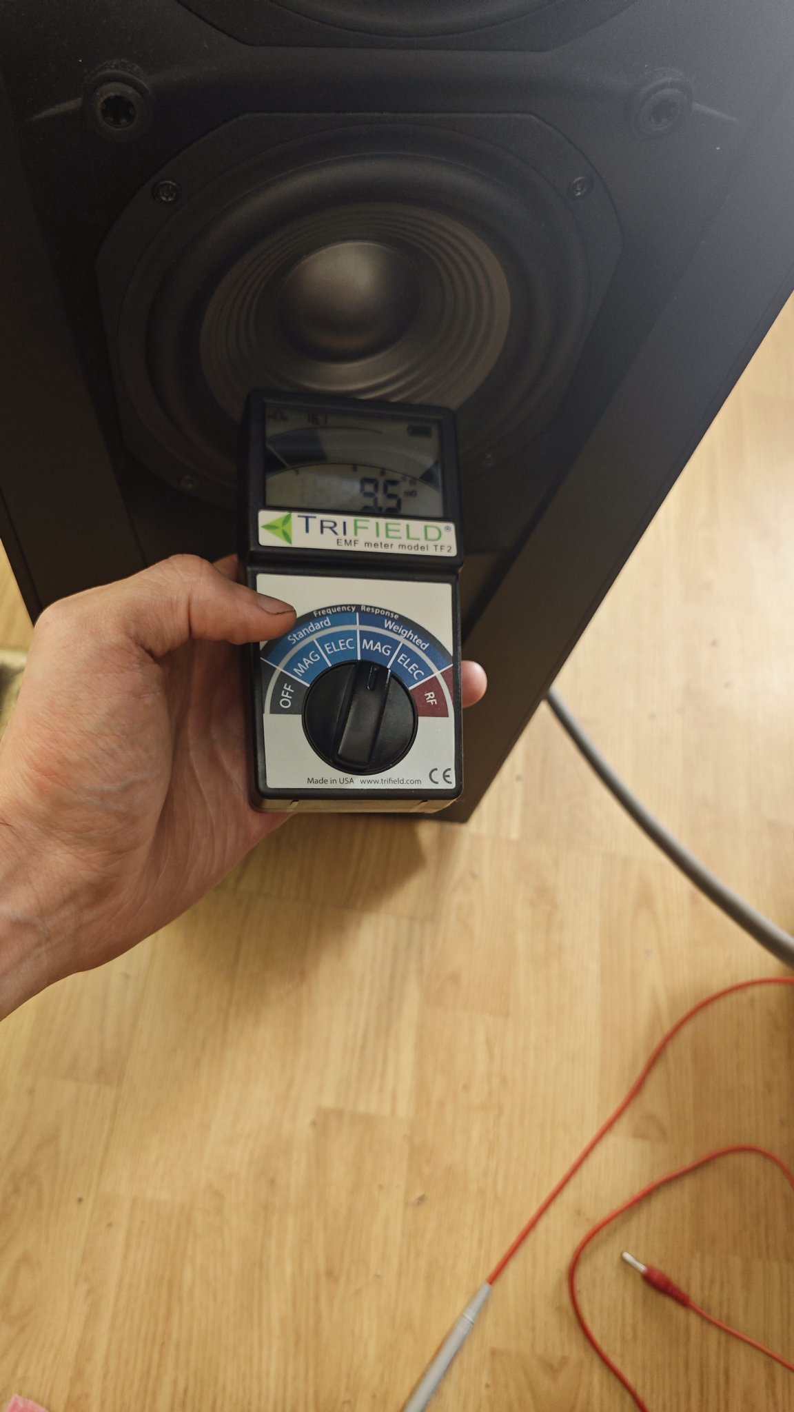

The woofers produce much greater magnetic field when louder bass is playing.

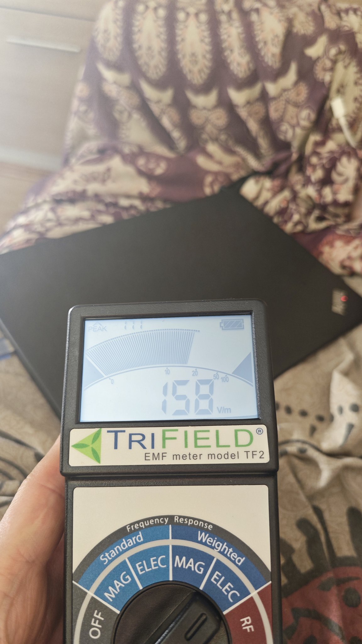

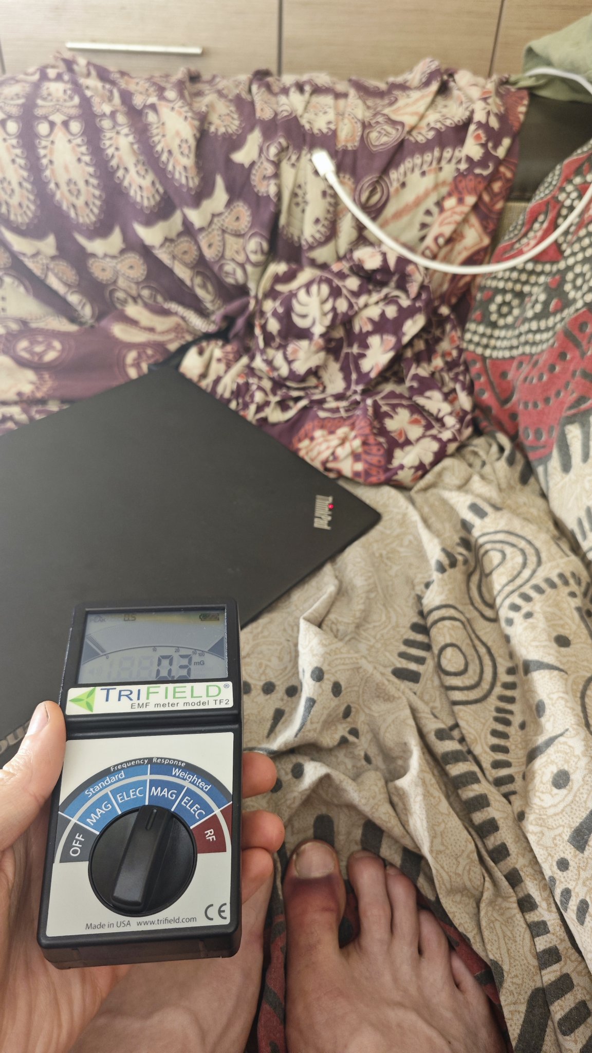

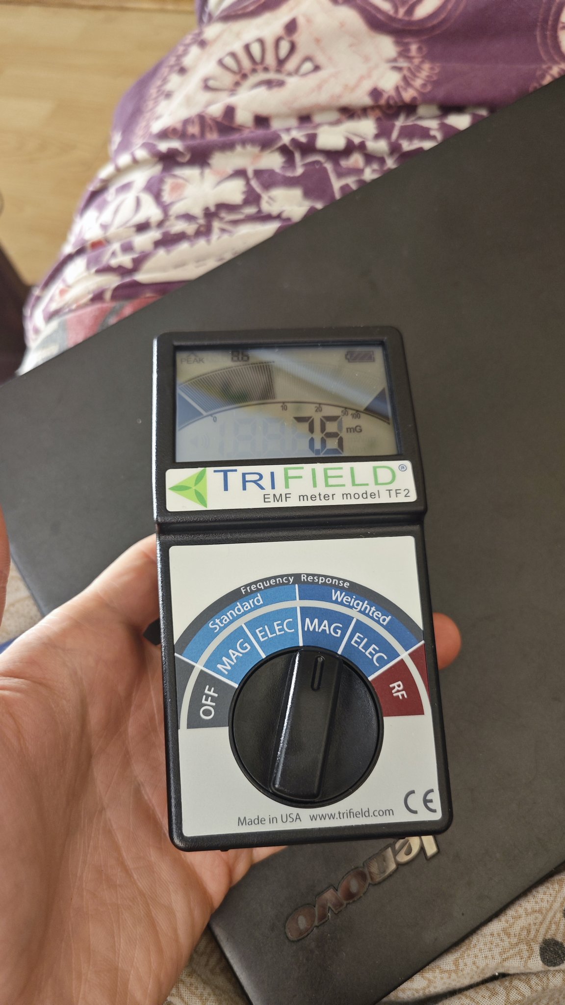

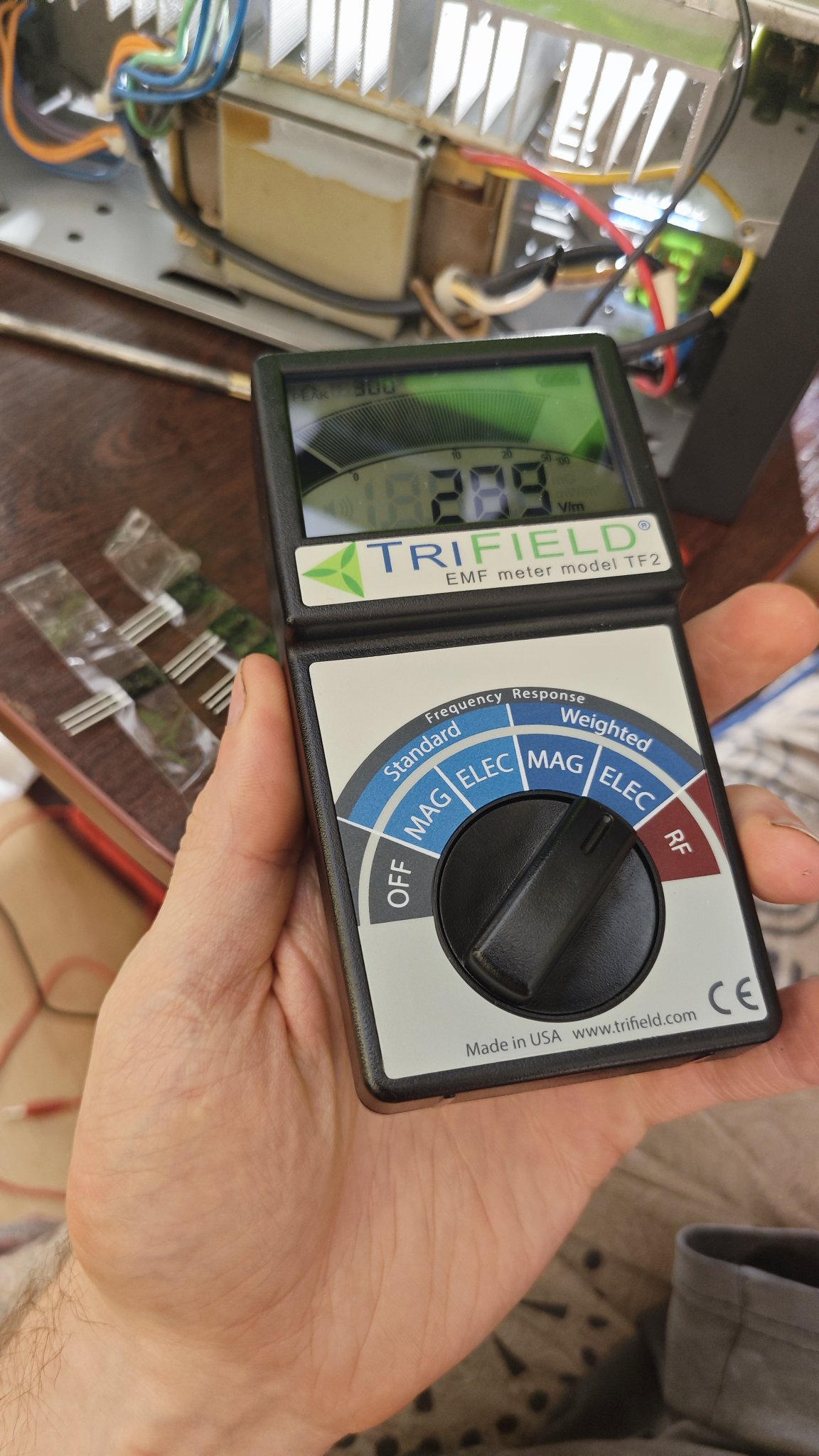

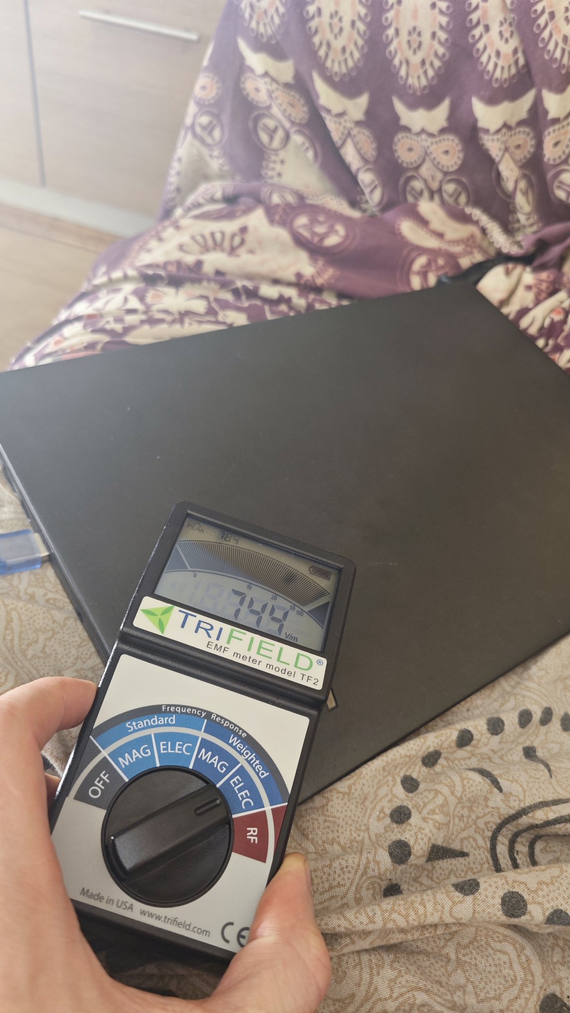

The phone produces up to ~60mG. It also made around 12 V/m but that was also just ambient all around the area.
RF was mostly quiet everywhere except for the phone producing huge peaks here and there.
The ELEC measurements were very stable and very weird in terms of locations. Also they mostly remained with amp turned off which I found strange.
MAG measurements fluctuated constantly. And woofers would of course make magnetic field according to the music.

Q410 replacemed by BD441 - again as in Q407, Q408 - more clarity and focus and aliveness everywhere and bass is more enjoyable too.
I then proceeded to remove the driver transistors on the working (right) channel and found out indeed that the sound became more musical for lack of a better word, more interesting, more nuanced. However I listened very briefly - around 2 minutes maybe and my transistors burned. I think it's because I forgot to set the right bias, but I don't really know, it's very mysterious to me, but hopefully it'll work after replacing the BD441 BD442. I don't think my bias regulators are even enough. I need to get some of those trimmers. So I'm left with no working channel and ran out of BD441.
Later on I found some more faults with the Left channel - turns out that as much as two PCB paths were broken - the base of output BD442 wasn't receiving signal and also the bridge we created in place of C437 was broken (likely the real culprit), so I fixed that. Replaced burnt BD441 with BD139 and I'm happy to say I'm back in working order on the left channel, this time I didn't forget to adjust the bias, but it wasn't much off at all anyway. Again it feels mysterious that the right channel burned after a couple of minutes, probably not a bias issue. So now I'm playing with BD139 on the previously faulty channel (with no driver transistors), but that's much better than nothing.
Anyway the last configuration played very well. I would find extreme differences between 44.1 kHz sample rate and 96 or 192 and although I couldn't hear much benefit between 192 FLAC and DSD in my years of listening, I think I can hear now even improvements in higher bitrate than 192 FLACs. Recording quality is also extremely obvious and is more important than the sample rate as long as it's at least 44.1 kHz. With driver transistors it was all beautiful and I played for around 24 hours in this configuration. Without them it's too early to comment about preference since I have around 3 minutes of experience (with the BD441s), but it sounded like it contained even more information, even richer colors and more nuance and fluidity.
BD139 aren't horrible, but sound less black and focused, warmer, but less depth, a lot less body, everything's flatter. But still high resolution or it's the one BD442 that's still giving that resolution. Occasionally I'm hearing pops though, similar to vinyl pops, but louder and more sparse and coming from the amplifier, which is a bit scary, but no trouble yet. I'm waiting for my transistors to arrive to continue working on this amplifier.
I wish the right channel didn't burn so soon after removing driver transes, because I still had pretty fresh in my memory how it played with them. Oh well, I guess I'll have to experiment more then. But the initial impression was that without them the sound was more clear, defined, lifelike.

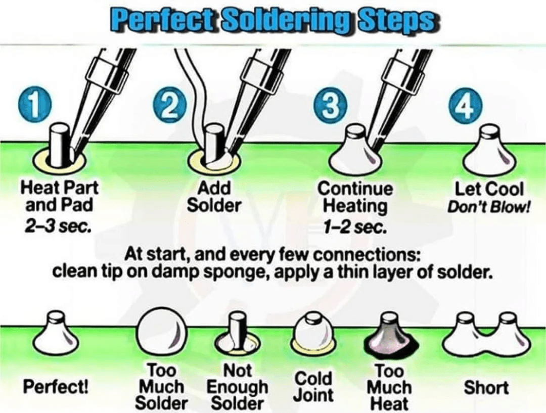

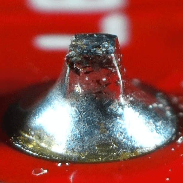

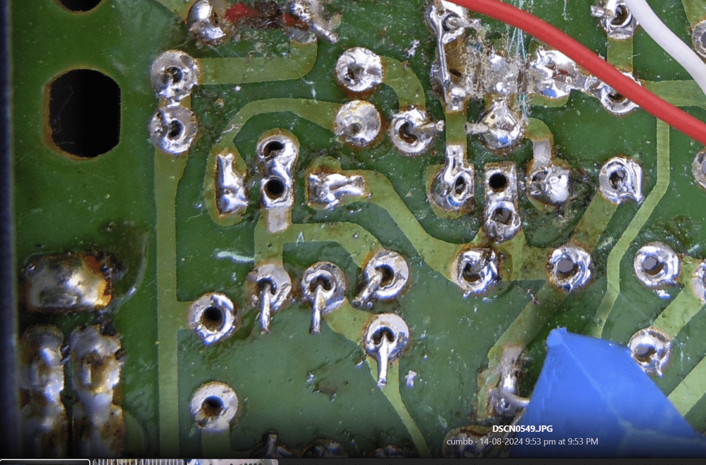

Don't take this the wrong way, but your soldering technique needs some work.
These connections are not reliable:
The joints should look more like this:
There's nothing worse than wasting precious hobby time than chasing a fault because of a bad joint.
