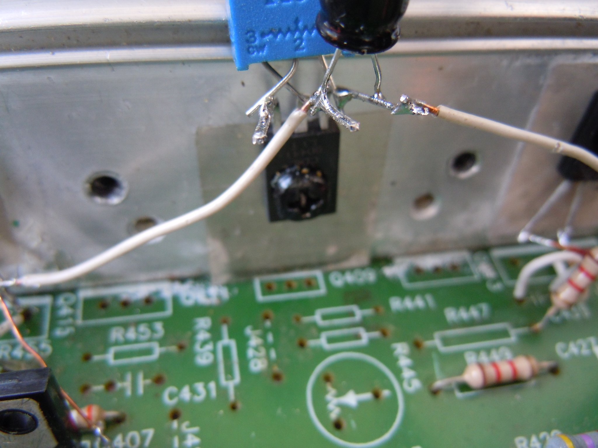

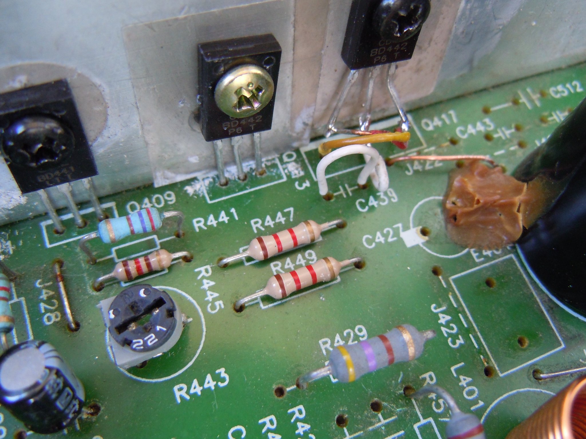

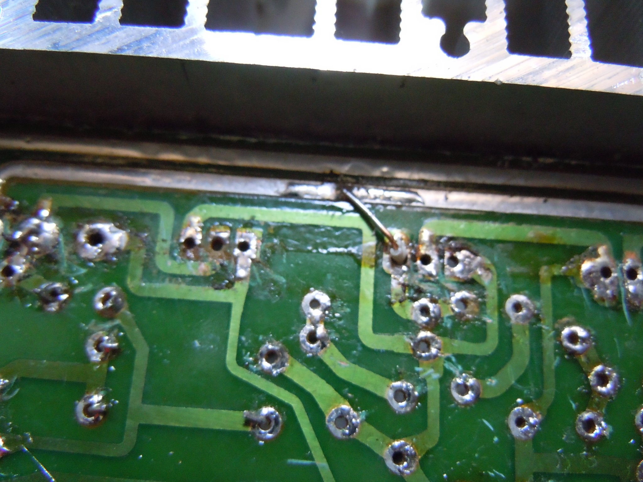

One more tip regarding transistor replacement: the holes in the heat sink have minimal burrs. Be sure to deburr them. And check the mica disks for exact and minimal holes. And it's best to measure again after replacing the transistors: simply use an ohmmeter to measure the middle leg of the transistor to heat sink - should count up to infinity.
By the way: I have discovered further, other necessary construction sites on the NAD. I will let you know.

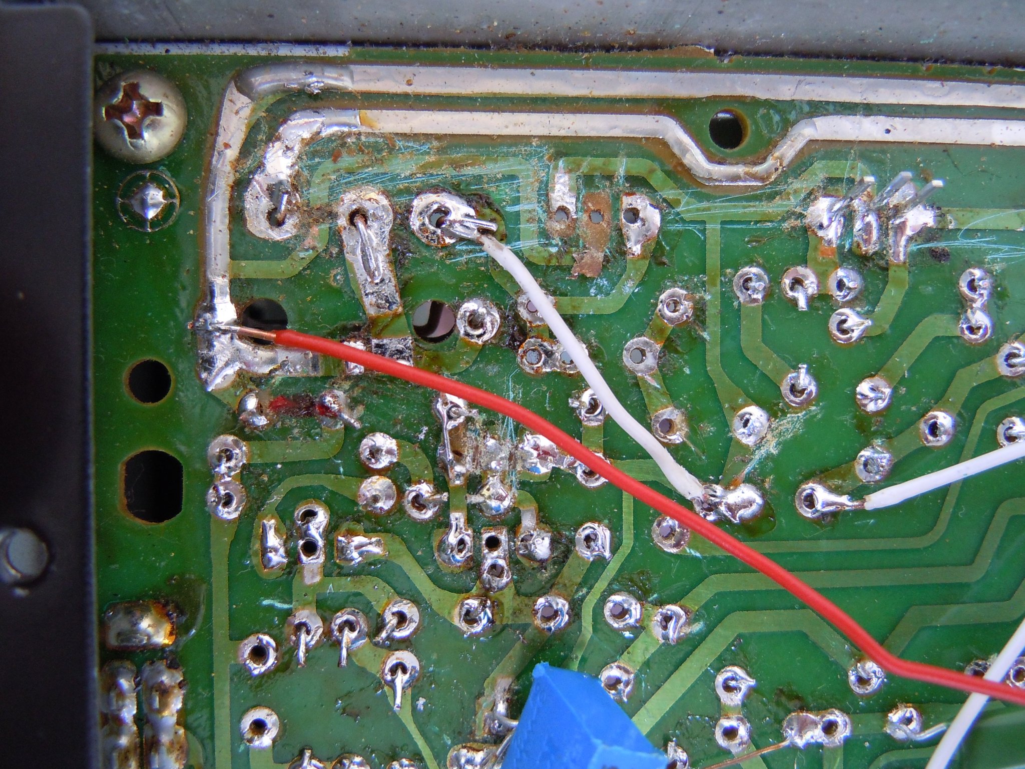

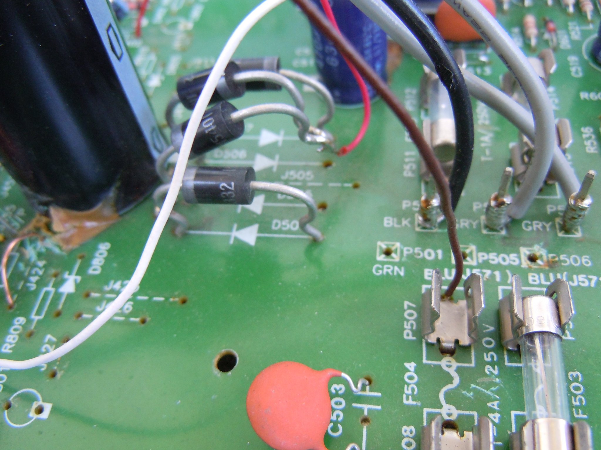

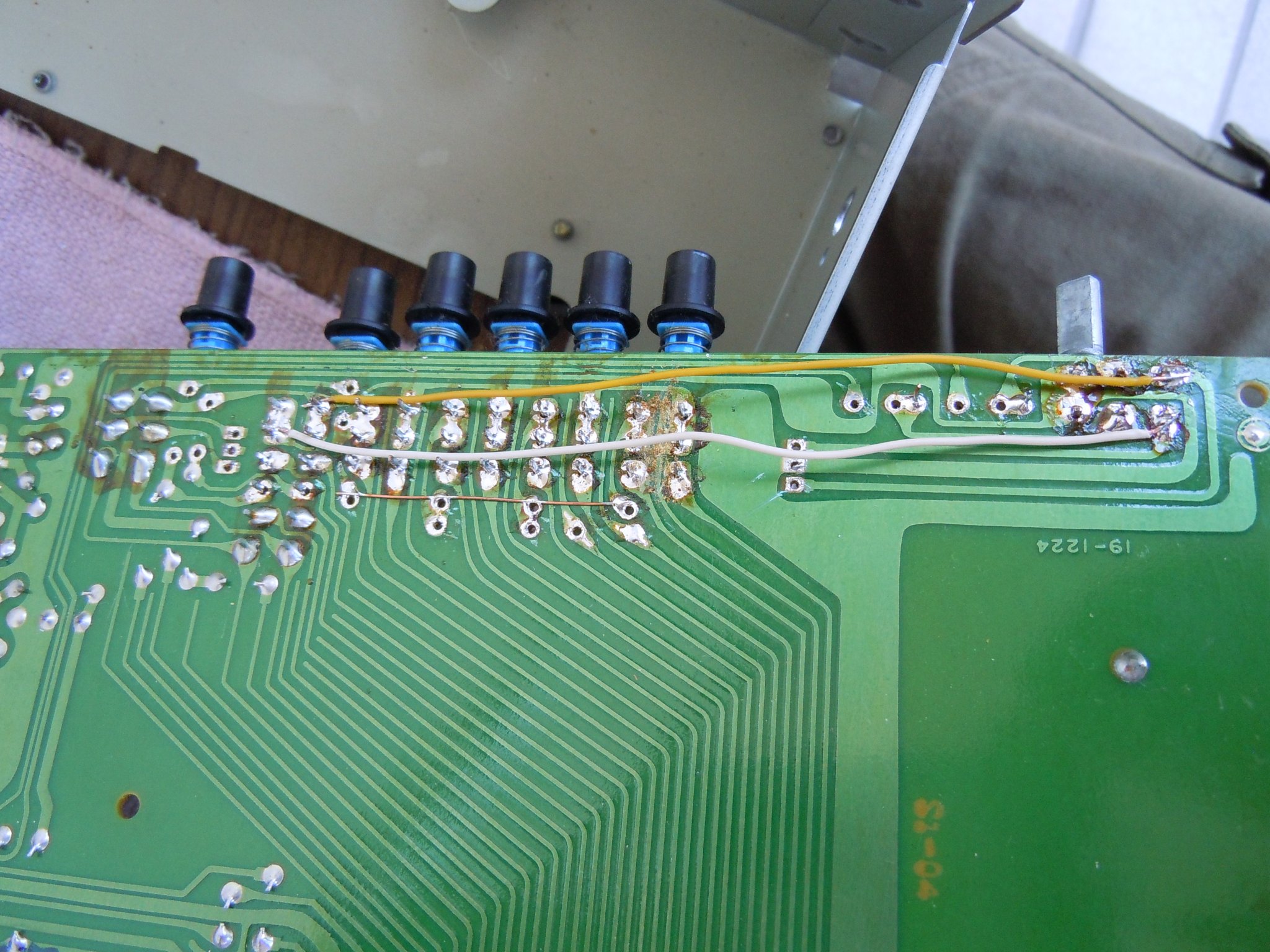

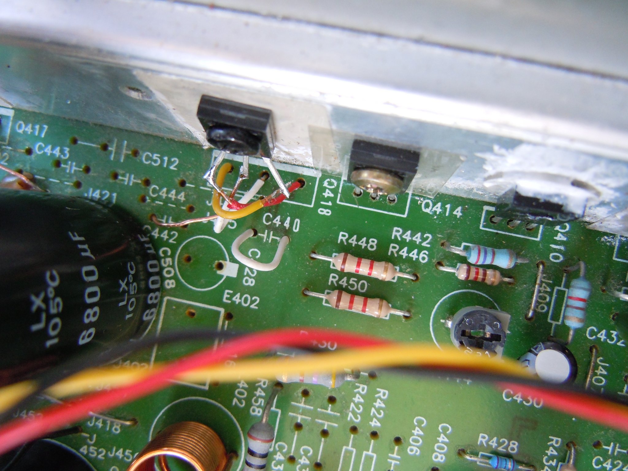

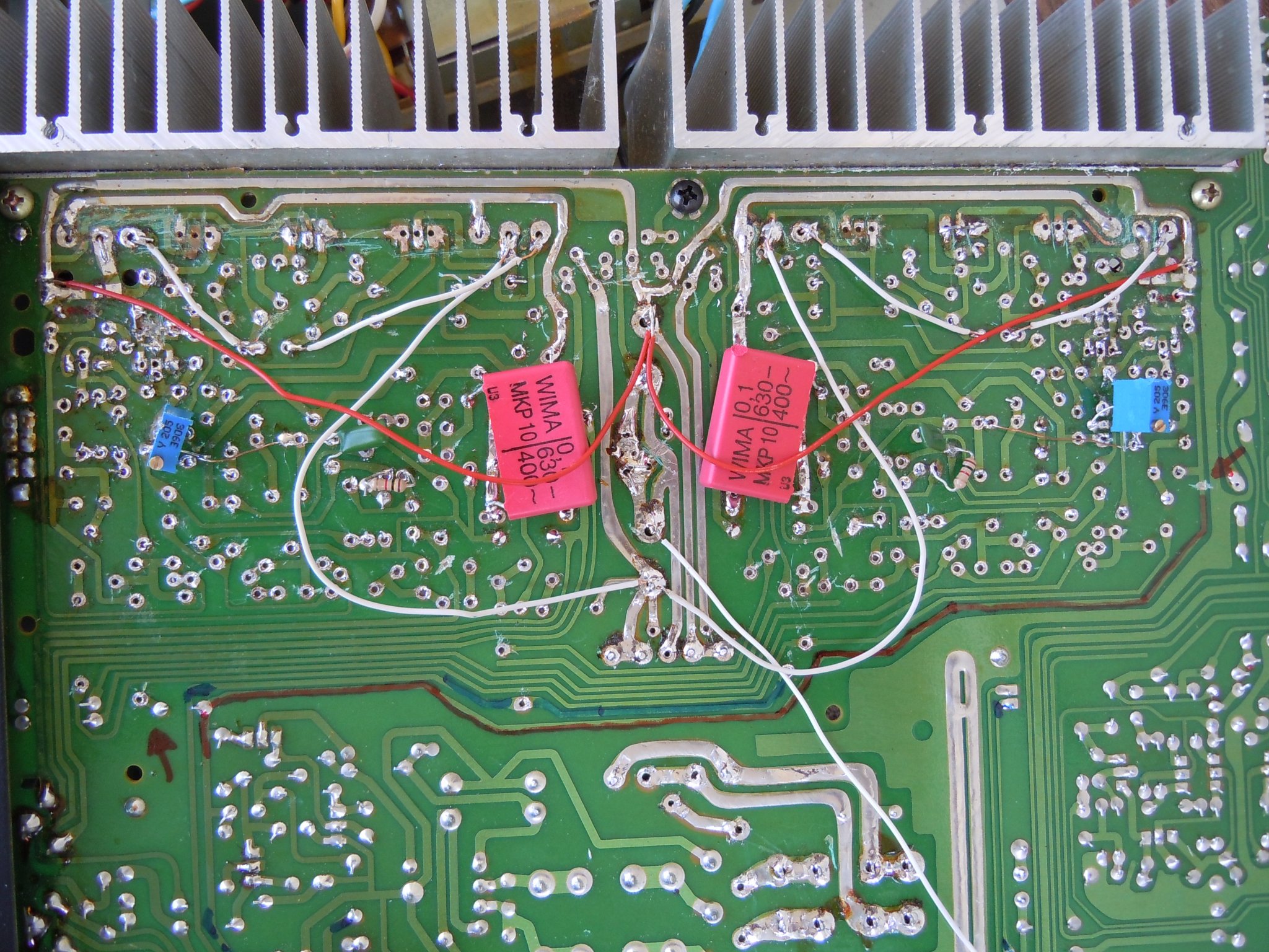

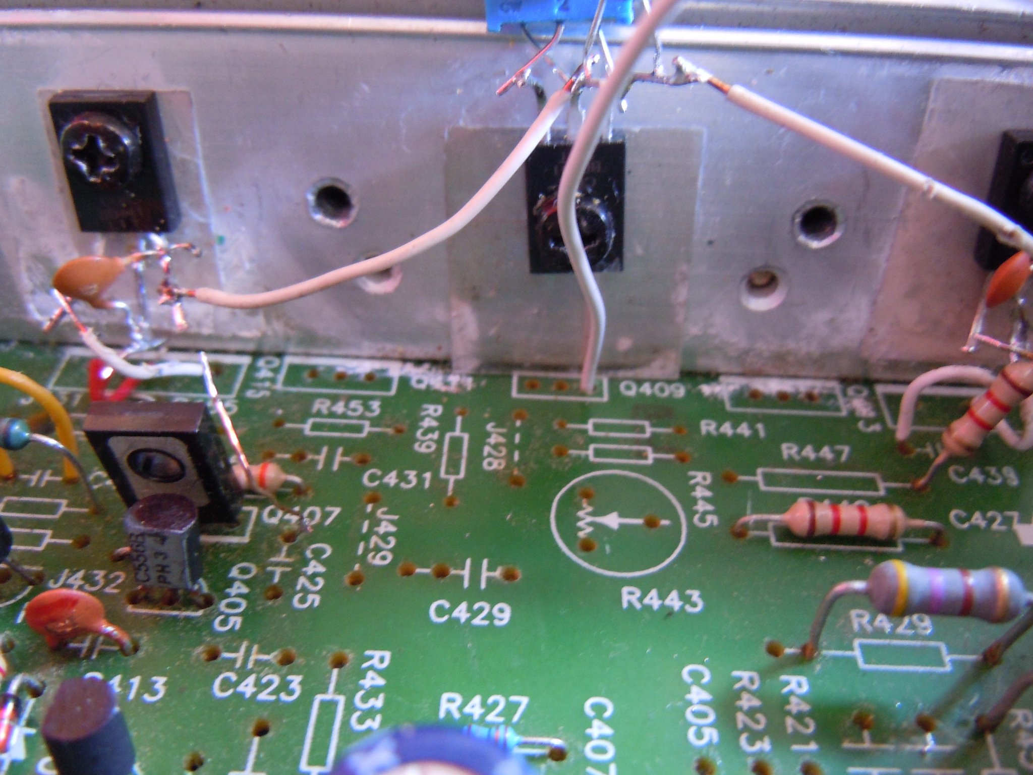

The negative half-wave of the output stage is also fed from two power supply units. Here too, as with the positive voltage, I have replaced the regulated one with the large power supply unit. Here the 28 volts with the 28 volts;-)
Bottom side the blue marked line. Top side the white wire arcs that sit directly on the collector connection: instead C 439, C 440. Here, too, the aim is to avoid multiple modulations due to multiple power supply units.
Reactions: Hotep

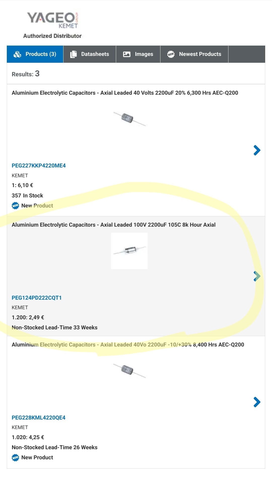

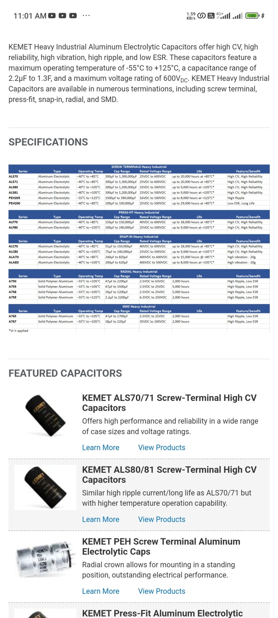

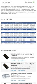

Mouser has some of those KEMETs. Which exactly are we looking for? Also I have locally the option of Mundorf or Panasonic for the large electrolytic power supply caps. Mundorf is ~3 times pricier. Also any option on Mouser. Any recommendation? If it's not too expensive like Panasonic I'll do 20k, if pricier I'll do 10k uF. Should I also do KEMET here? What is the best available that you know of?
Reactions: cumbb
I have purchased a few large electrolytic capacitors for power supply units, for example, but so far I haven't found any that stand out. They sometimes differ significantly, but none of them have been outstanding so far. Their different characters serve more to tune the sound. I don't know the Mundorf yet. I would be interested to hear how they sound;-)
But we also need the 2,200 microfarads for the negative feedback. I would go for the KEMET axial. These axial Kemets are among the best electrolytic capacitors I know.
https://www.mouser.de/c/passive-com...N3h8uZj8V2_MfGANXU9_ckjtCR-0KiI_ISAH-hN5NJJiT
Decades-old electrolytic capacitors can also be a real sonic surprise. But you have to shop around and test them, for example on ebay.
What also worked: several small ones. For example, 2 x 4,700 KEMET axial, then parallel and off to the bed;-)

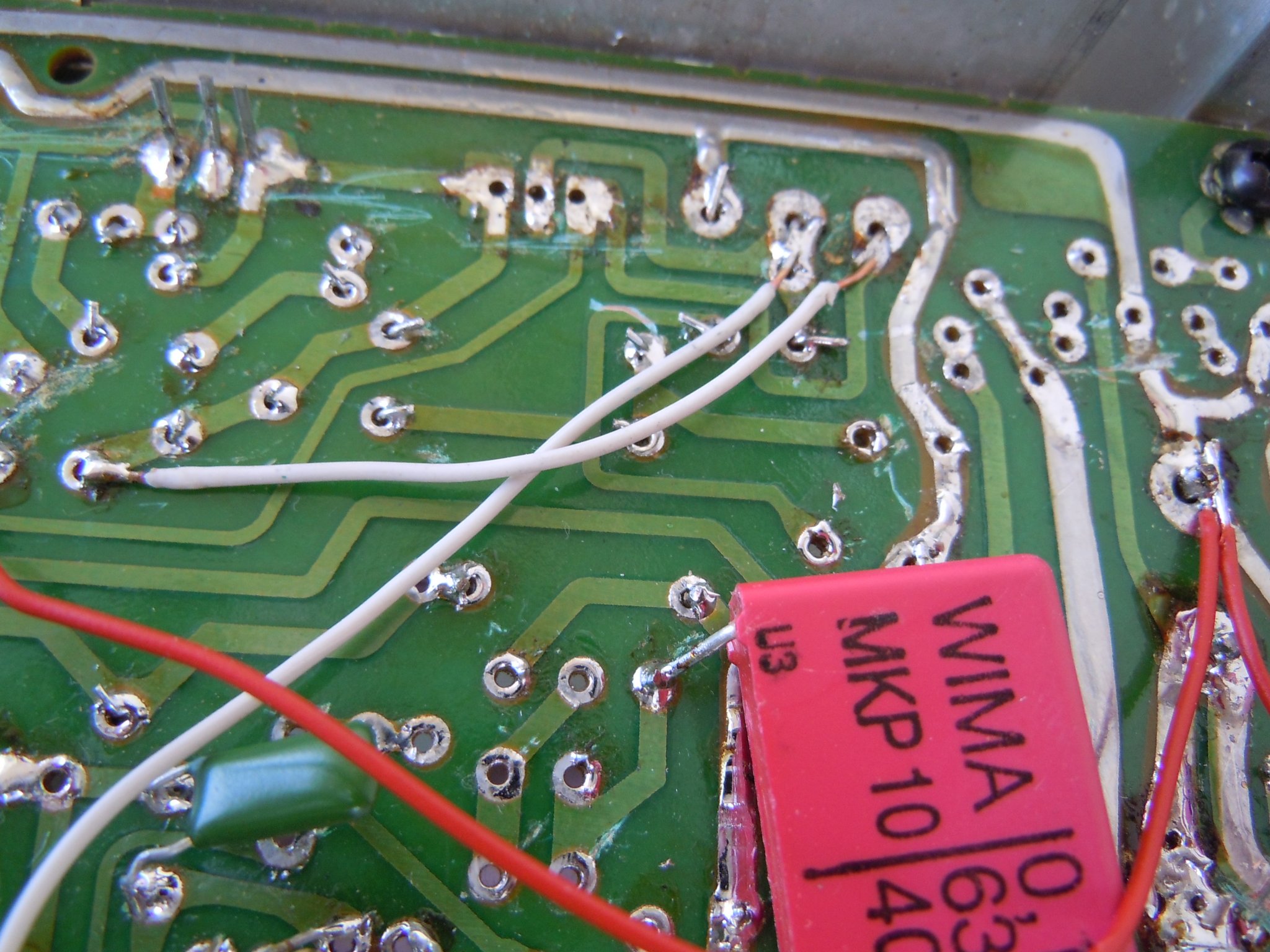

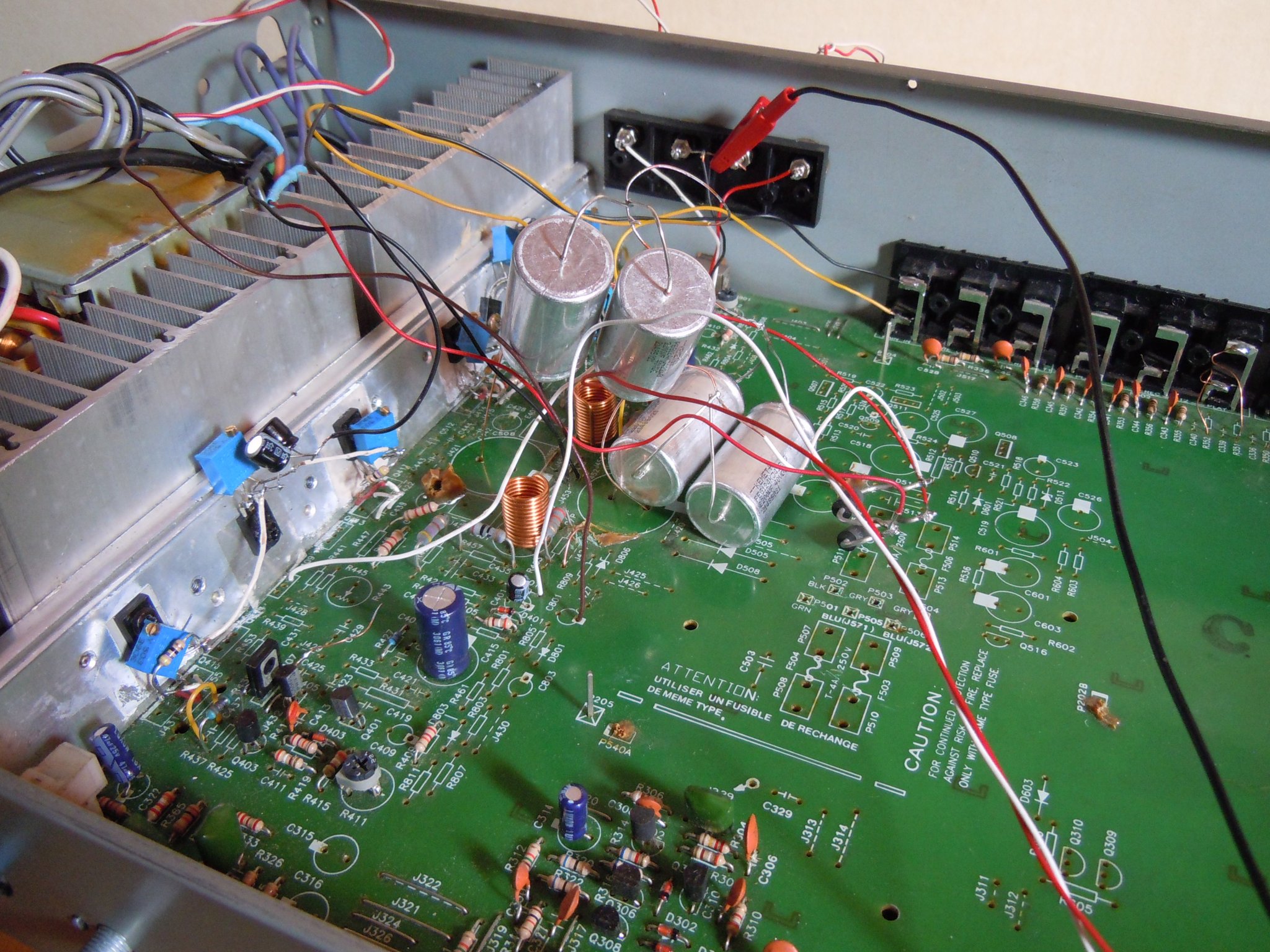

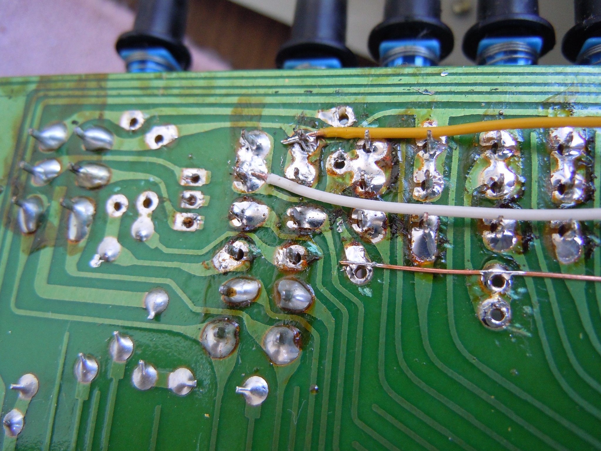

I have just had a look at the underside: If you want to operate this NAD with source selector and potentiometer, the tape input is the one with the fewest transitions. In other words, the one with the highest sonic potential. One channel has to send the signal over a few bridges. I have removed these and bridged them with a thin wire.
And I also made the "Tone defeat" dead. It doesn't have to be there. Tone control is out of the question with a good device, because sound ("bass, mid-range, treble") comes from cleanliness, i.e. by omitting parts that degrade the sound.
And I have removed this little black three-wire jumper (switcher - poti). The material doesn't sound good. I laid two copper wires from the last selector switch (tape) to the potentiometer on the underside (white, yellow)
Regarding fuses: I have attached a secondary winding from the transformer directly to the diodes. To do this, I pulled the diodes out of the circuit board at one side and soldered the wire (red) directly. I leave the second secondary winding connected before the fuse. The fuse can then be connected in if necessary, allowing the second secondary winding to play along - for parties, for example, when you want a rumbling sound;-)
This work is should done once you have compared the sound between just one and both secondary windings. You can do this simply by removing one of the two fuses.
To ALL: Please only operate without fuses after you have used small TO-126 transistors as power transistors. These will then serve as fuses.
And to ALL: Please take personal responsibility here! I can only tell you what is the better way in terms of sound. It can also be the unsafe unfusedd one;-)

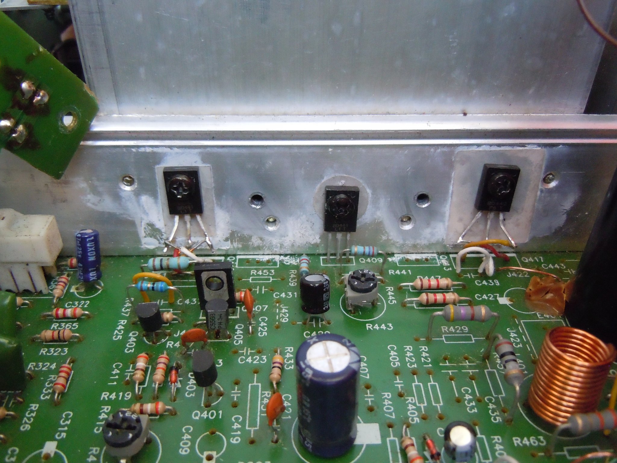

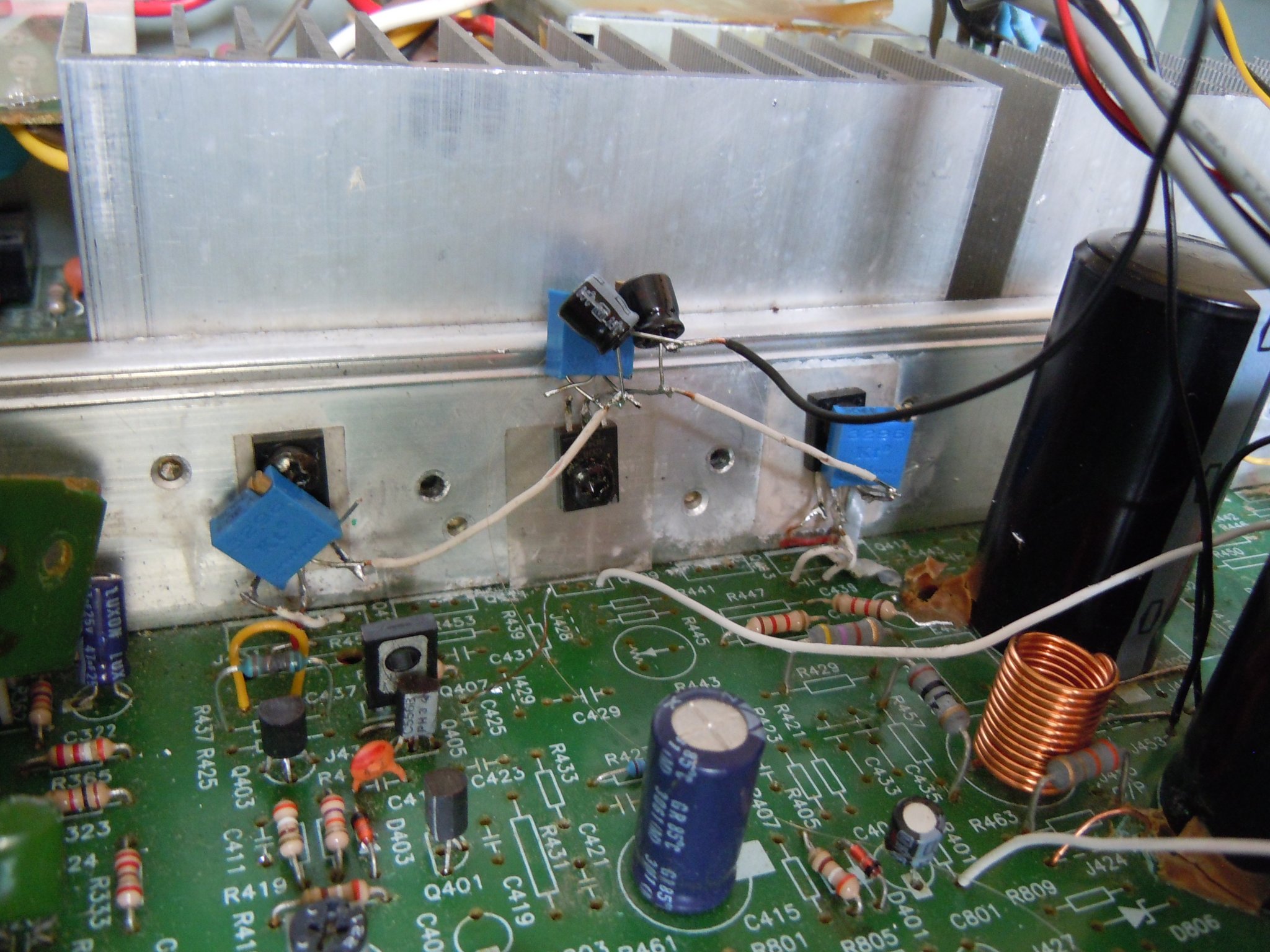

I robbed my NAD of the "driver transistors". Now it only has a simple PP stage as a power amp, no "Darlingtons" longer. Now the "musicality" is higher: more flow and openness and finer colors. Simply remove these transistors and connect their base connections to the end transistors base (two white wires downside, directly from C429 and C430 to the base connections.). Simply reduce the bias. I still want to modify the bias regulation a little. But the thing works quite well as it is. I'll have to see if it remains stable with 2 x 1 volt base voltage.
But I don't want to rebuild it completely. Just so that anyone who can hold a soldering iron can do it. I want it to remain a little NAD;-)
Always take it nice and slow. Step by step. And always listen so that you get a feel for changes and sound;-)
  • Thank You
Reactions: Hotep

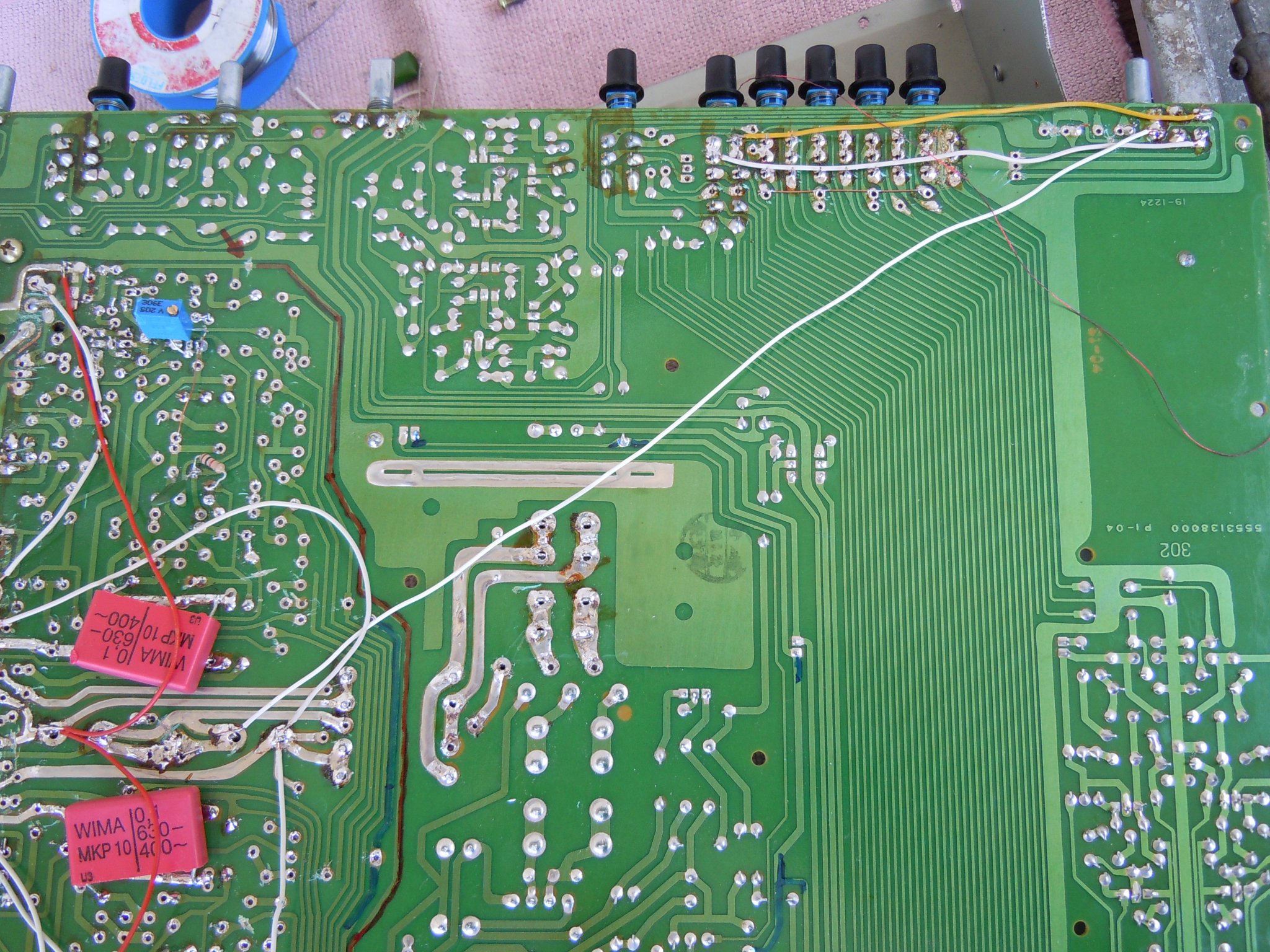

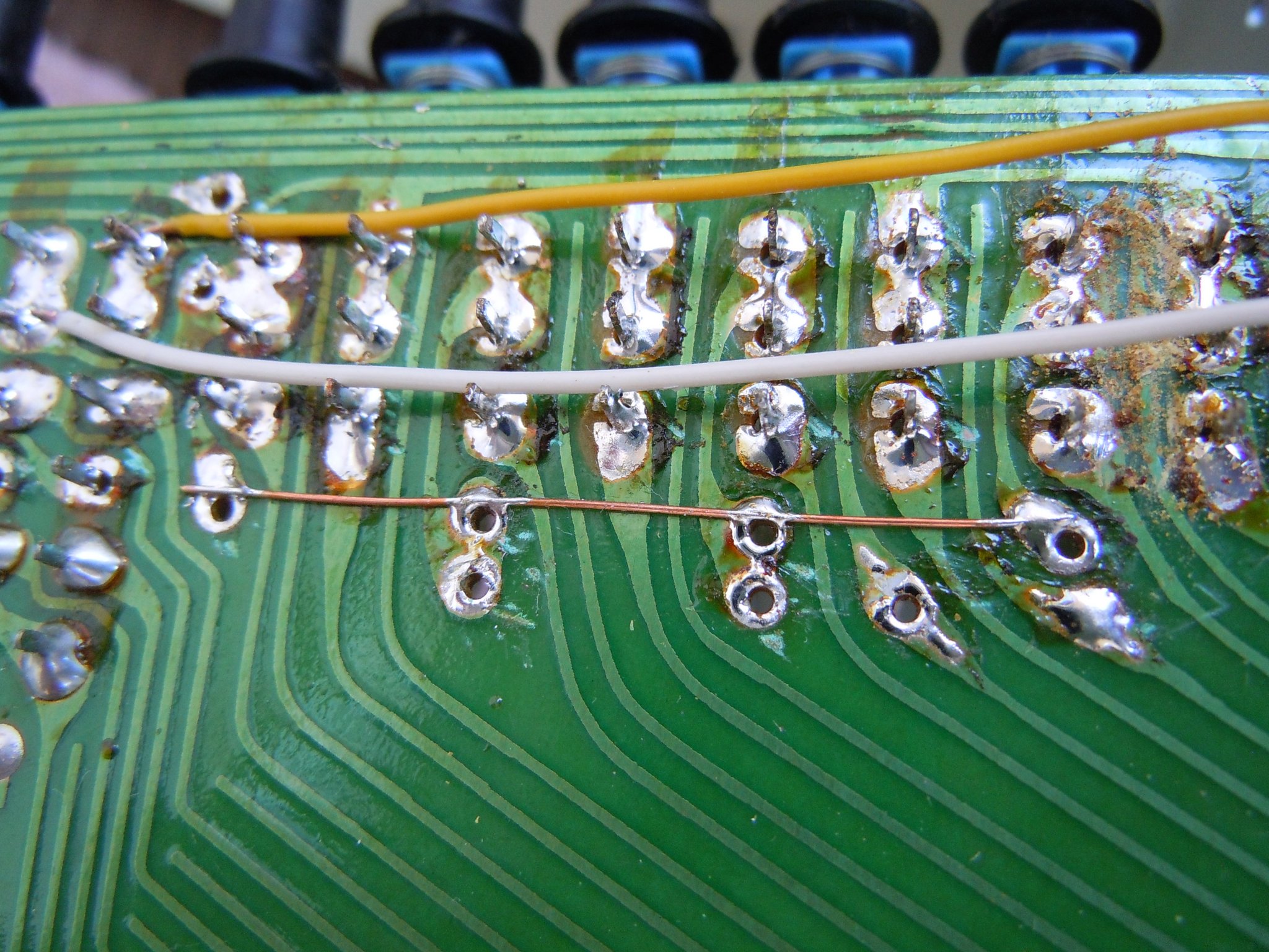

One of these little things is the different length connection of the two half-wave power supplies and the two half-wave amplifiers. I symmetrize these. For this purpose, 0.6 mm2 solid core is completely sufficient. We are not building a disco power amplifier;-) Simply directly from the psu caps to the output transistors. 4 identically long cables. Here (pictures) two white, two red. Here too: disconnect all the original connections so that there are no different paths.
Attention: the NAD has 1 Ohm resistor (R 455, R 456) in the plus voltages of the power transes. I let it run for the time being.
I also connected the potentiometer to the ground of the power supply with a long cable. The white cable across the circuit board. Here too: disconnect all the original connections so that there are no different paths.
And I would also advise to make a fundamental distinction: concept, such as circuit, and object, such as parts, physical build up. The experience gained from the audible qualities of the objects allows us to draw conclusions about audio-suitable and audio-unsuitable concepts;-)
  • Thank You
Reactions: Hotep

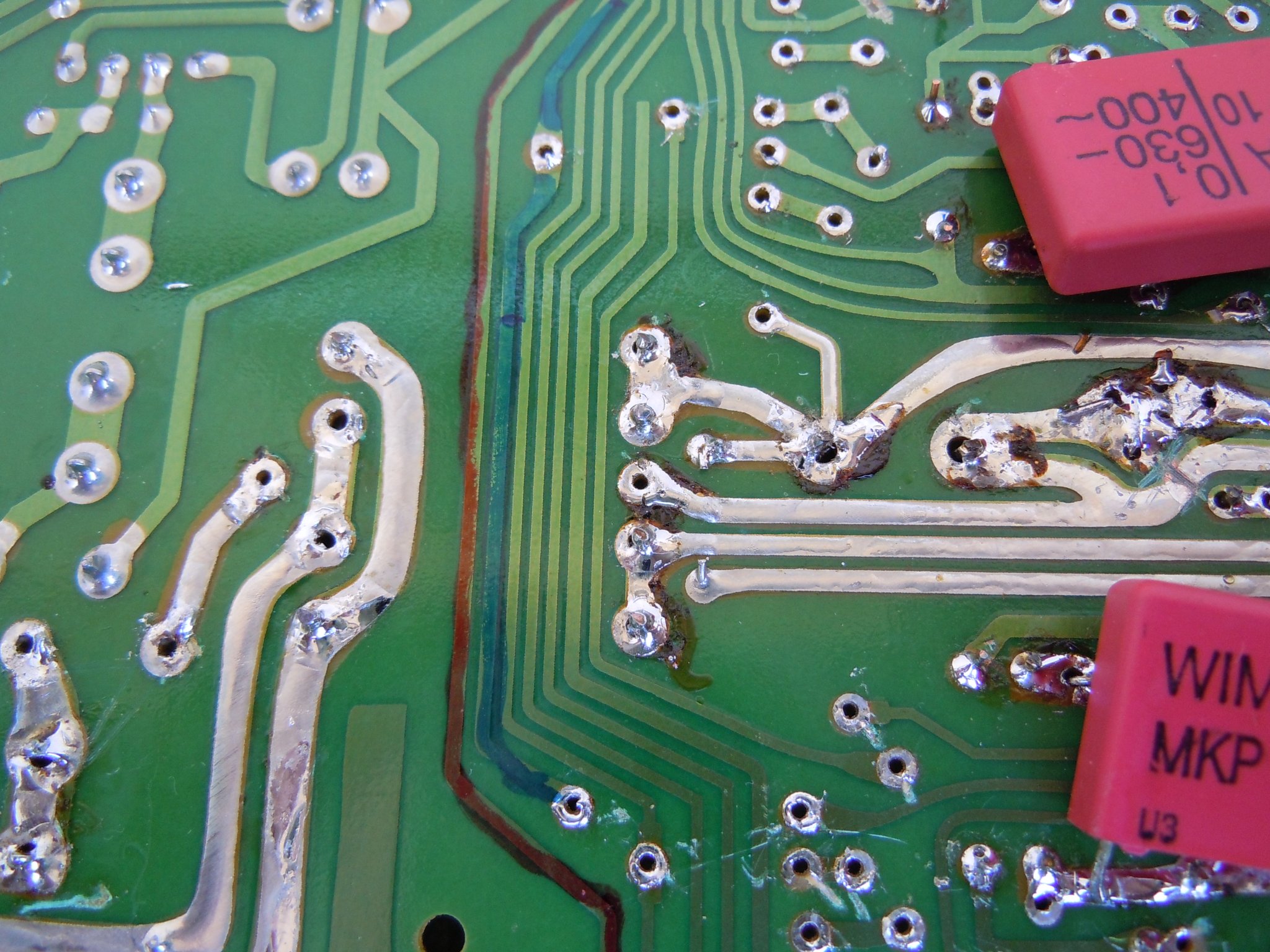

The reason why the board layers on my NAD (some photos) are sometimes gone: I didn't remove the board at the beginning and pushed the soldering iron and pump under the base plate and thus worked uncleanly. In addition, these circuit boards are 30 years old or more.

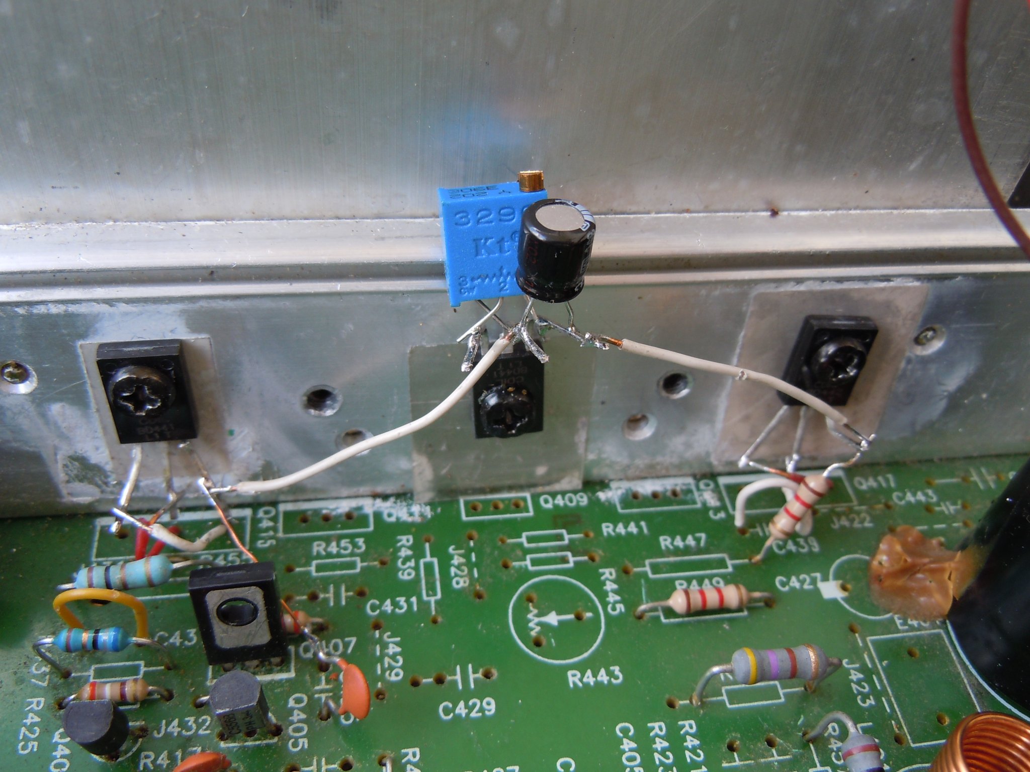

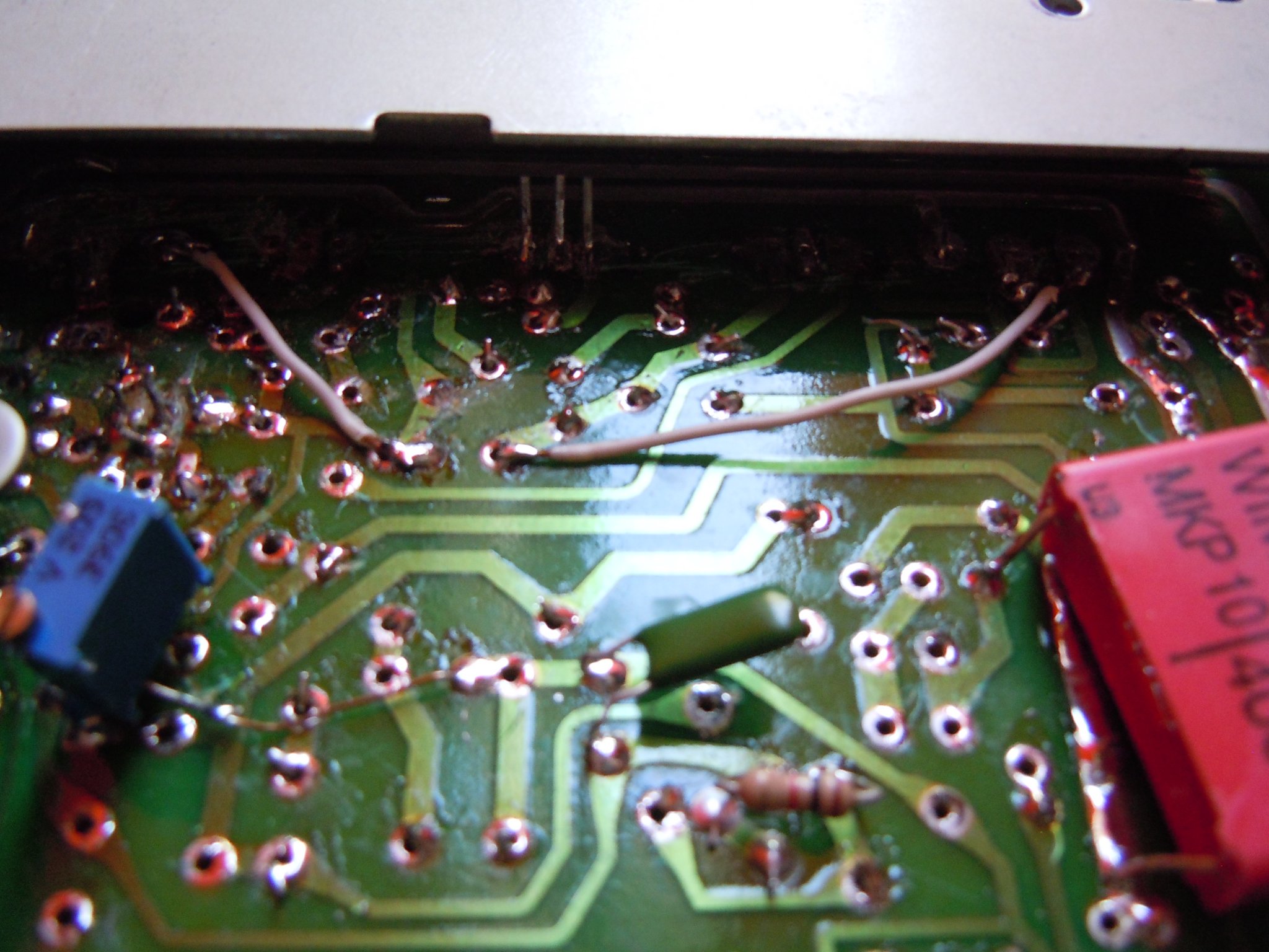

I have changed a little. I have reduced the bias regulator to just the transistor and a trimmer. I connected its center leg to the base connection of the transistor. One outer leg each to the emitter and collector. And then the electrolytic capacitor emitter-collector. That's enough. I use 2 kOhm trimmers here. This way I save components and solder connections and PCB paths. This is already an exercise in assembly without a circuit board;-)
Reactions: Hotep

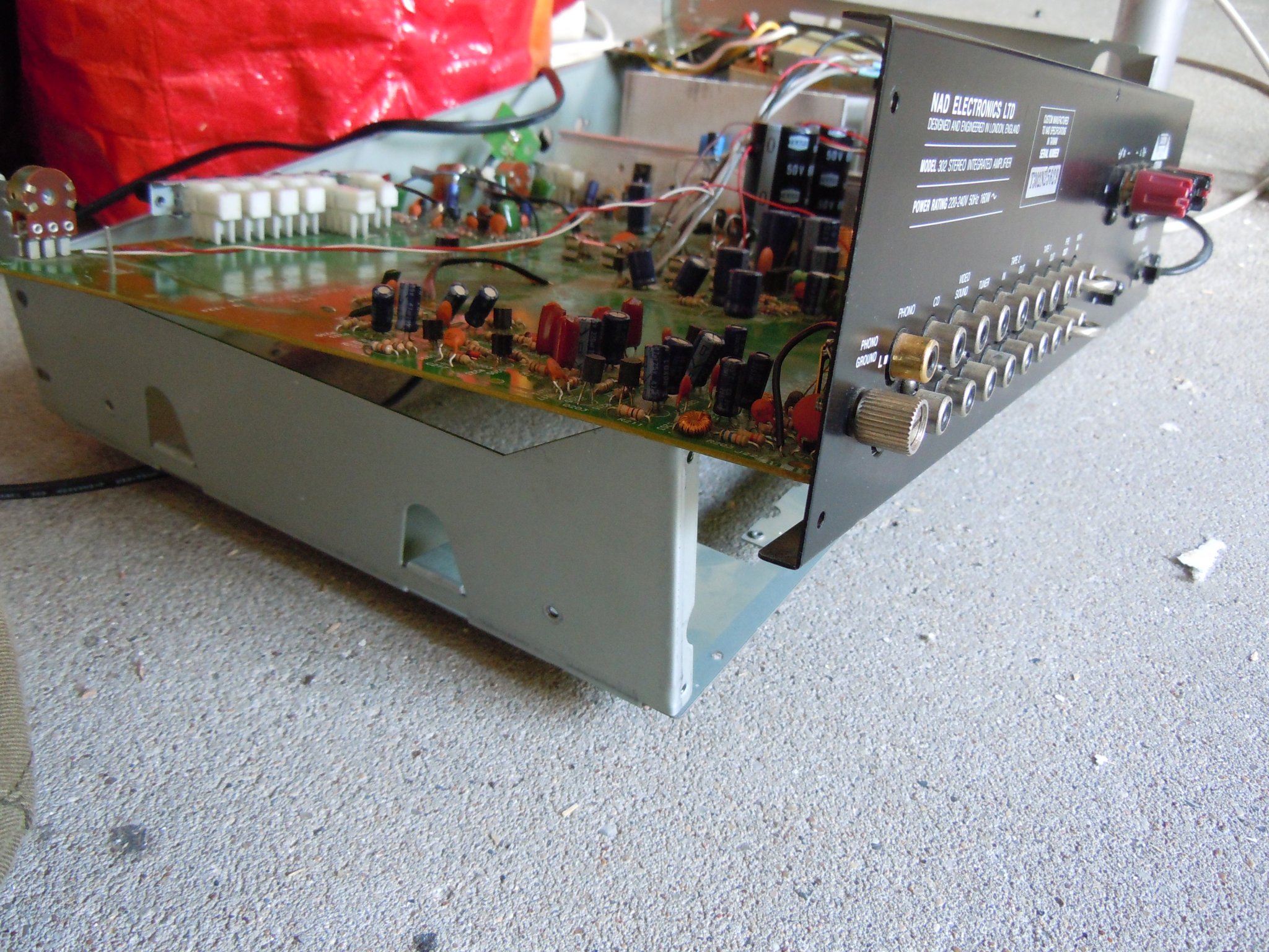

The NAD is easy to open in order to access the underside of the board: Remove the front panel, loosen the poti screws, loosen the screws around the rear panel, remove the screws of the heat sinks from the base plate and then you can lift the circuit board and turn it including the heat sinks.

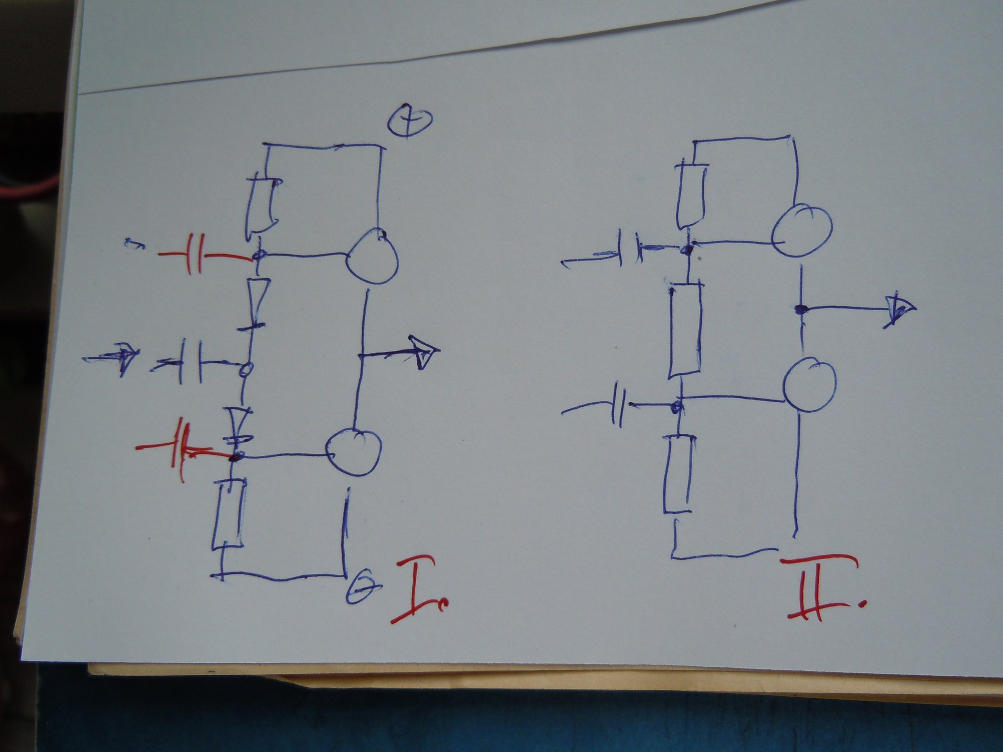

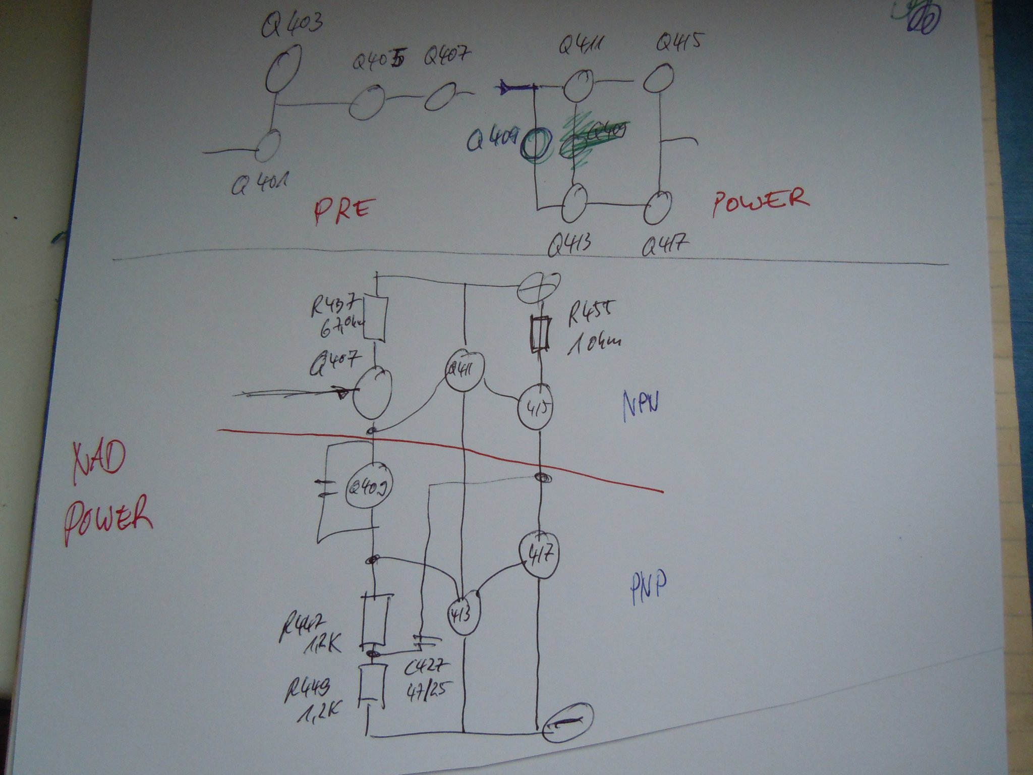

I have drawn the circuit of the complete "output stage": the first three stages are a clean single ended preamp. That's all it needs. Top sound quality. You could only do better with fewer stages, but you don't need more than three stages. After Q407 and Q408, the developers could have tapped the preamp output and routed it to the rear panel.
The "output stage" is a two-stage complementary transistor push-pull. But if you try to remove the driver transistors (e.g. Q411, Q413) and listen to only one power stage, you should hear that the sound will be more musical, more fluid, more pleasing. My experience is that as soon as we make power amplifiers complex, whether as here pure 2 stages in series, or whether Darlington or Sziklai or any compound or CS, then the character of further active components adds up: it sounds more technical, more slowed down, dirtier, grayer, flatter, harder. The advantage on paper is the disadvantage in terms of sound.
An exception here are "dynamic" (signal-guided) CS,
Then I painted this pure pp output stage to show its asymmetry. I've drawn a red line as a guide to roughly separate the two half-wave amplifiers. Both half-wave amplifiers are not mirrored. This asymmetry is a sonic limit.
Anyone who has tuned the NAD up to this point should stop here and be happy!!!
I will continue here. I have drawn up some more simple half-wave balanced pp concepts. I'll probably build one with diodes first, and then replace the diodes with a resistor/trimmer. Because the best capacitors and resistors sound minimal better better than the best diodes, I'll probably end up with the second circuit;-)
Step by step;-)
