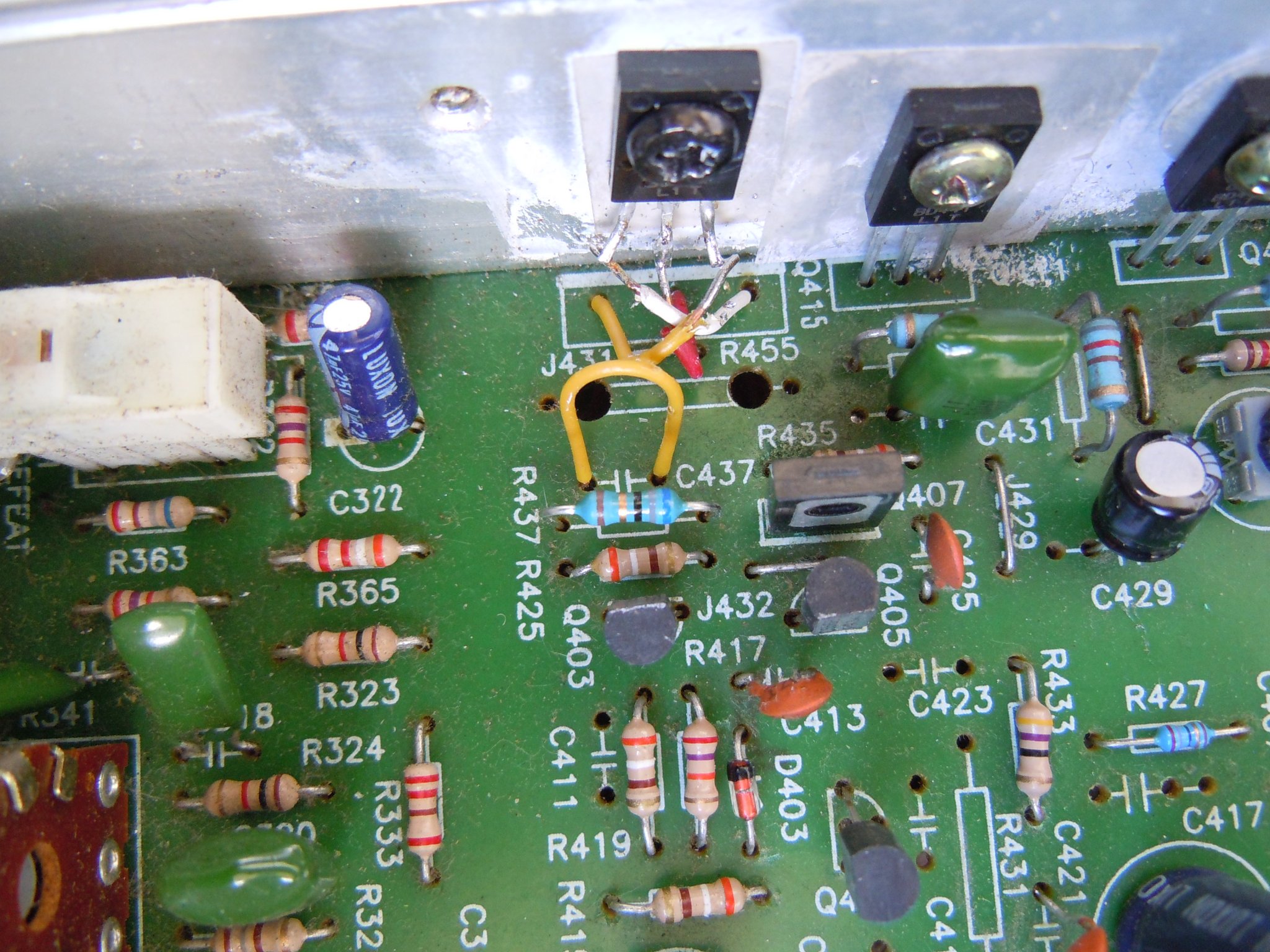

When replacing transistors: the aluminum of these heat sinks is very soft, the screws are very long. They have eaten away at the aluminum in my NAD. One screw also broke off when loosening. Somehow loosen it with feeling using a suitable screwdriver. And use new, shorter screws for the new transistors. And maybe put minimal grease on the threads.

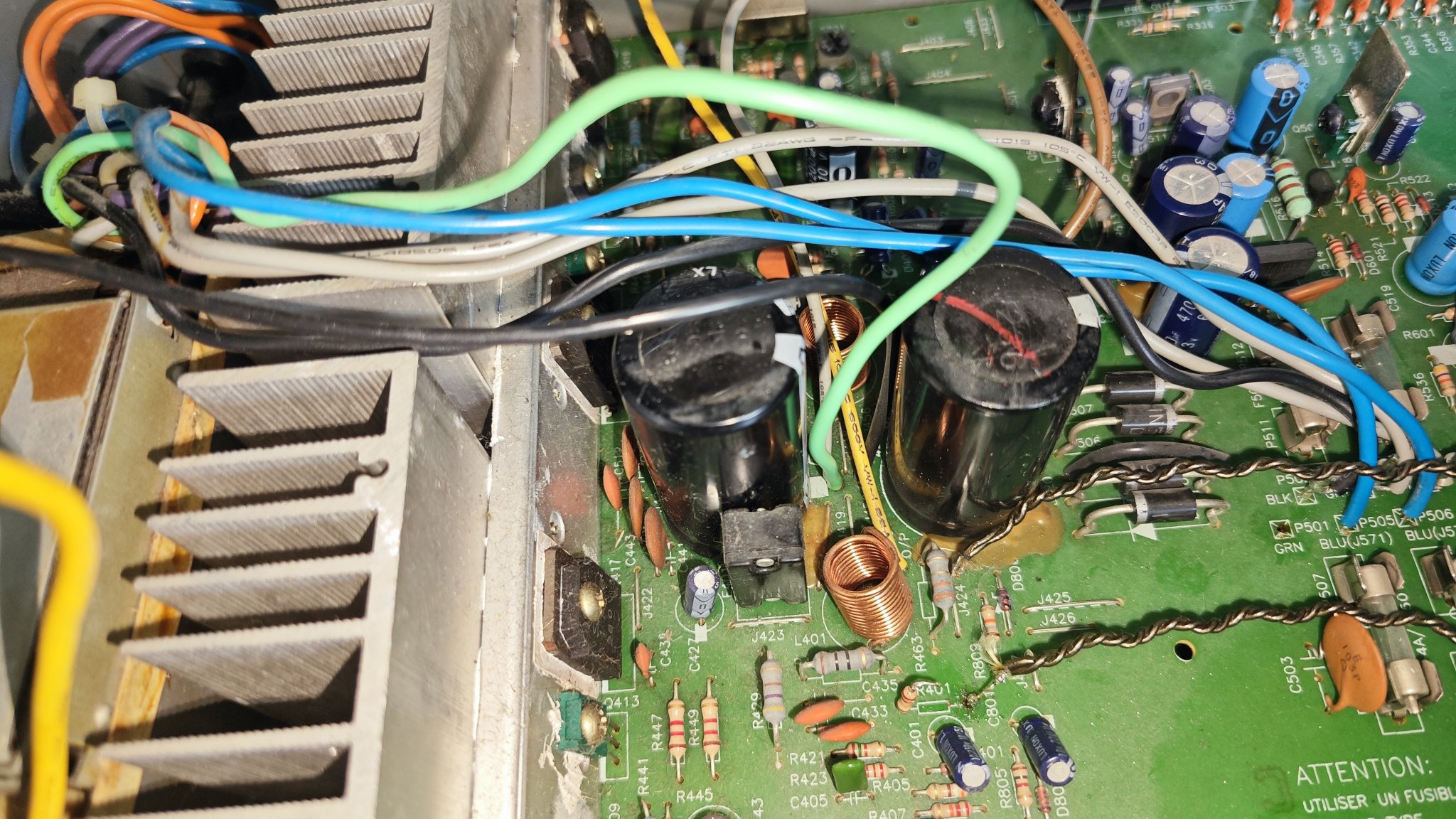

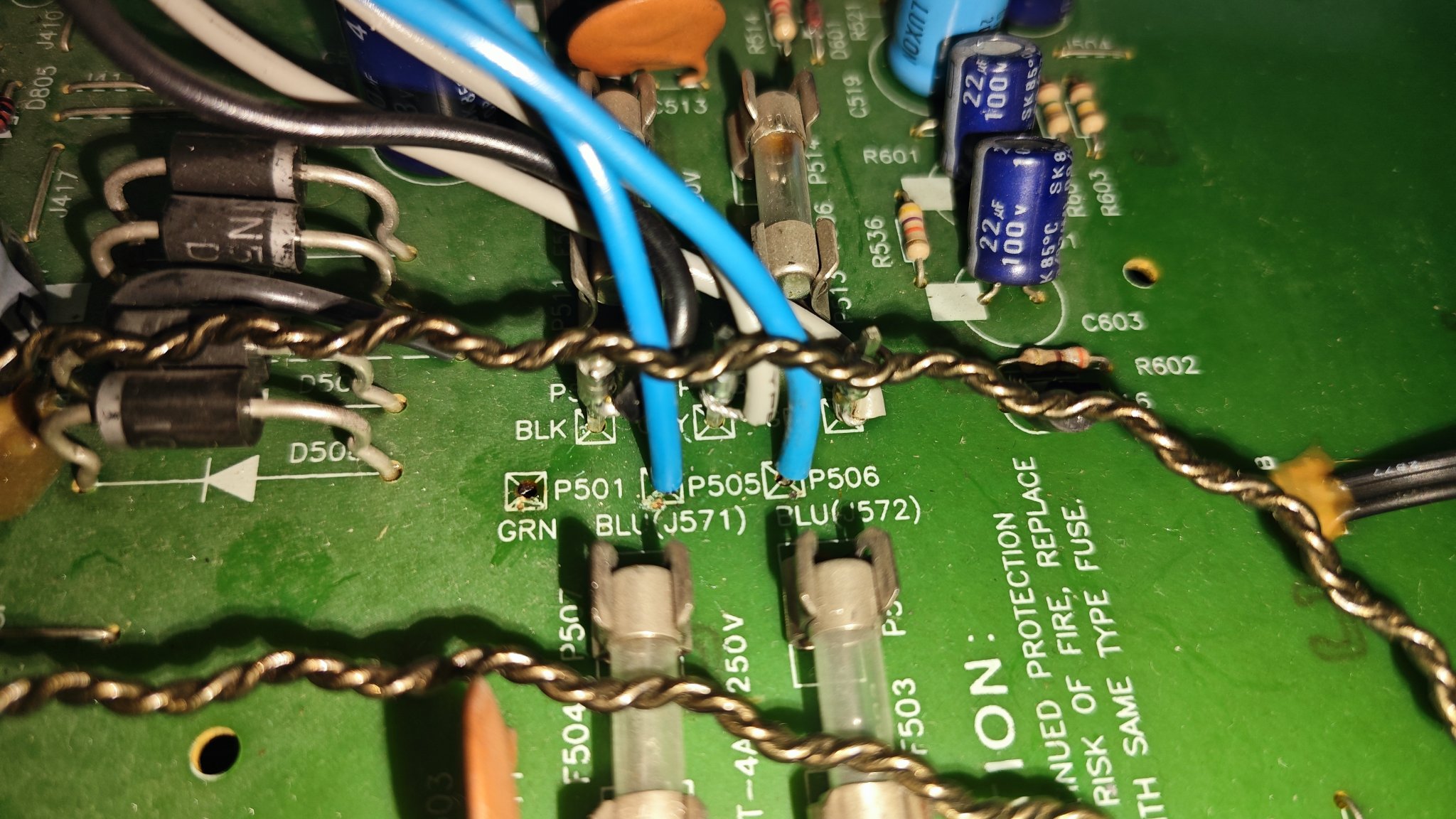

If I'm not mistaken, I did everything hereHere's a follow-up:

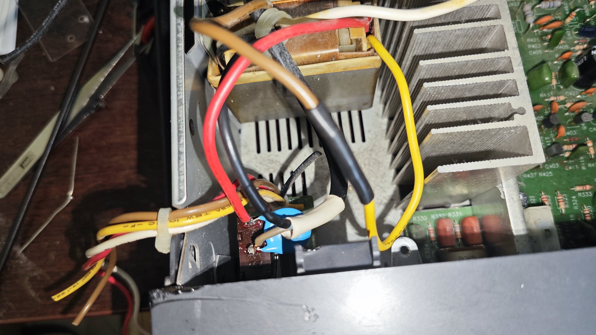

There is also work to be done on the mains switch: the direct connection of cables and switch and also the removal of unnecessary bridges and solder sockets.

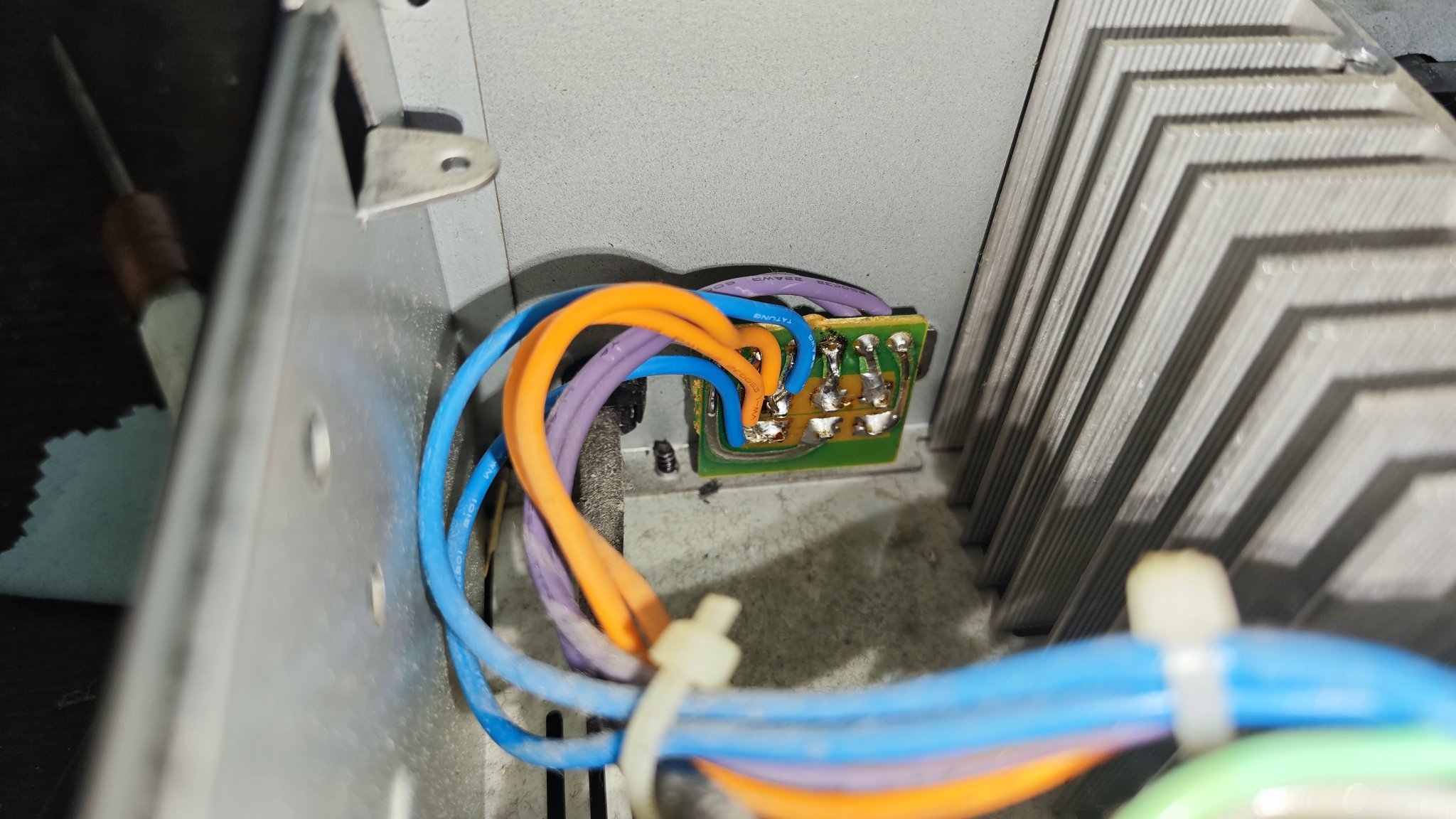

But the secondary windings can also be connected directly on their way to the circuit board: the 28/32 (2 x orange or 2 x violet to 2 x blue) volt switch can be bridged. This also further cleans up the sound.
Then there is the direct connection of the two blue wires to the circuit board: removing the solder sockets. And the ground connection, green here, can be connected directly to the ground center on the capacitors.
Then remove the small diode-bridging capacitors.
And remove the thick solder pads on the underside of the board in the area of the electrolytic capacitors.

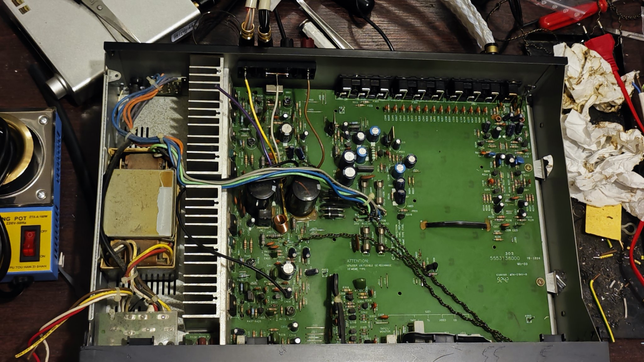

The 302 effectively has two power supply units. I recommend using only one power supply, the power stage supply, here the blue cables (the gray ones can operate the green LED alone;-) and connecting both the power amp input and the SUPERB phono amplifier - its circuit is one of the best far and wide, the implementation could still be a little better - to this one.
And one advantage of these remaining two fuses: you can remove one and hear the much cleaner and finer sound that is achieved with just ONE secondary winding. But in order to experience this sound always as a benefit, a few things still need to be done to the 302;-)

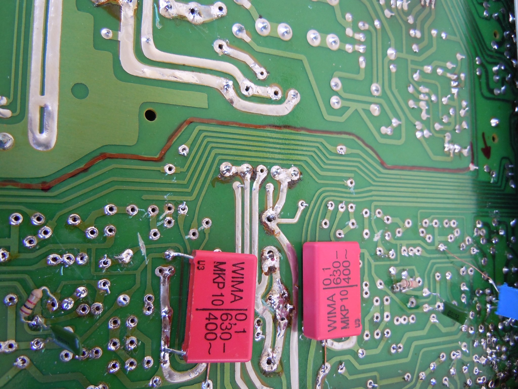

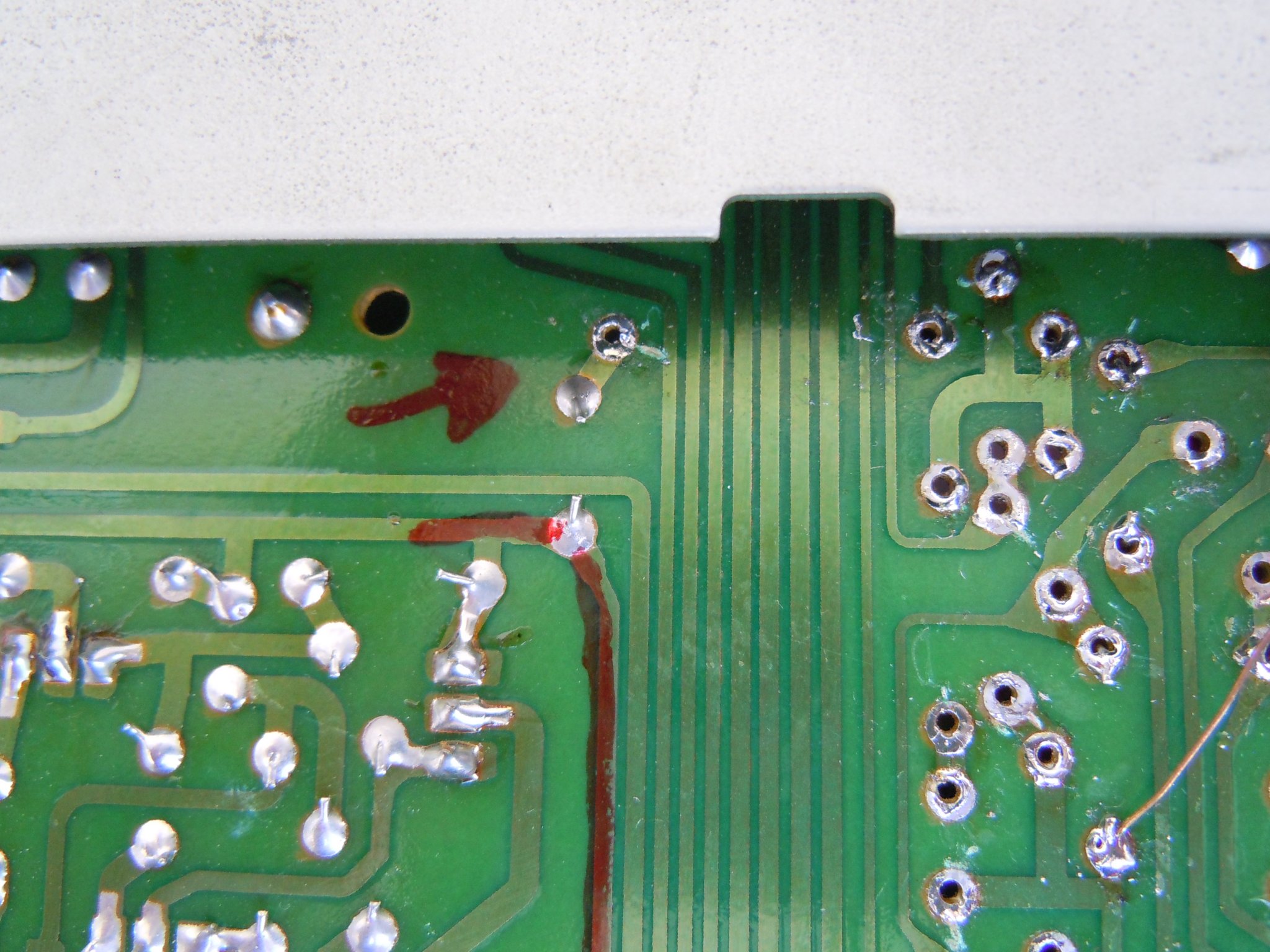

I am happy too;-)

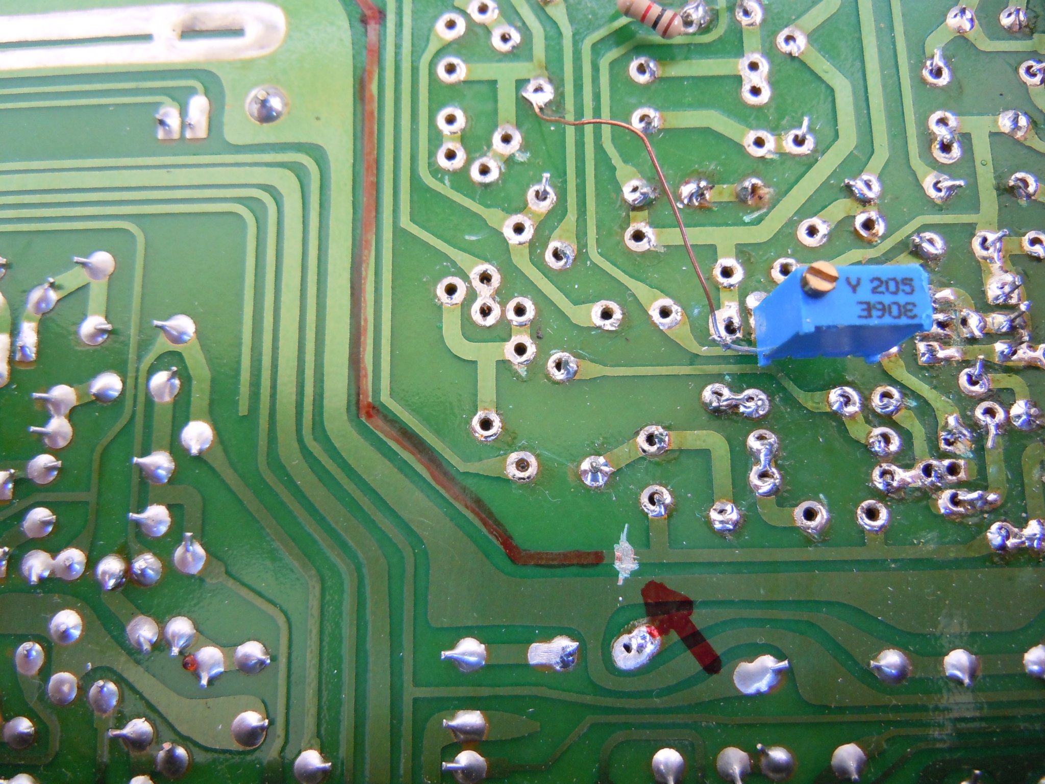

Disconnect the 38 V:
I have marked the 38 V strand in red. I have cut through the copper strand at one channel (arrow) and removed a bridge at the other channel (arrow). I then replaced C 437 and C 438 on the top with a wire - an example: Yellow wire image. These Cs are located between the 28 V and 38 V voltages.
I am happy too;-)

I am happy too;-)
