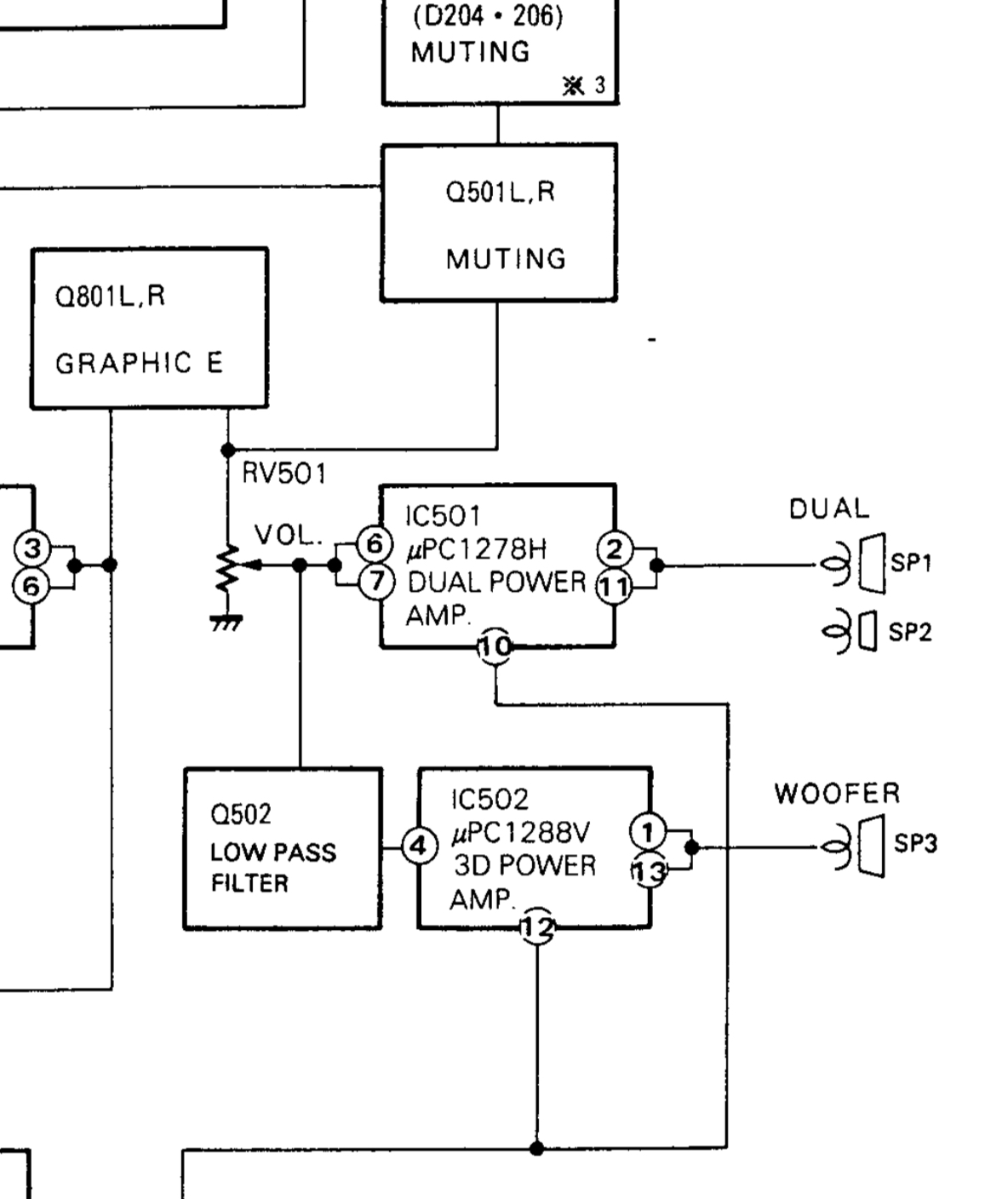

Looks like literally the output of the volume sliders is a good place:
Should be easy to find on the reverse and solder to.
Also looks like the mids and tweeters aren’t filtered??

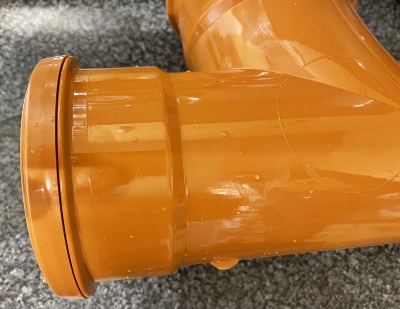

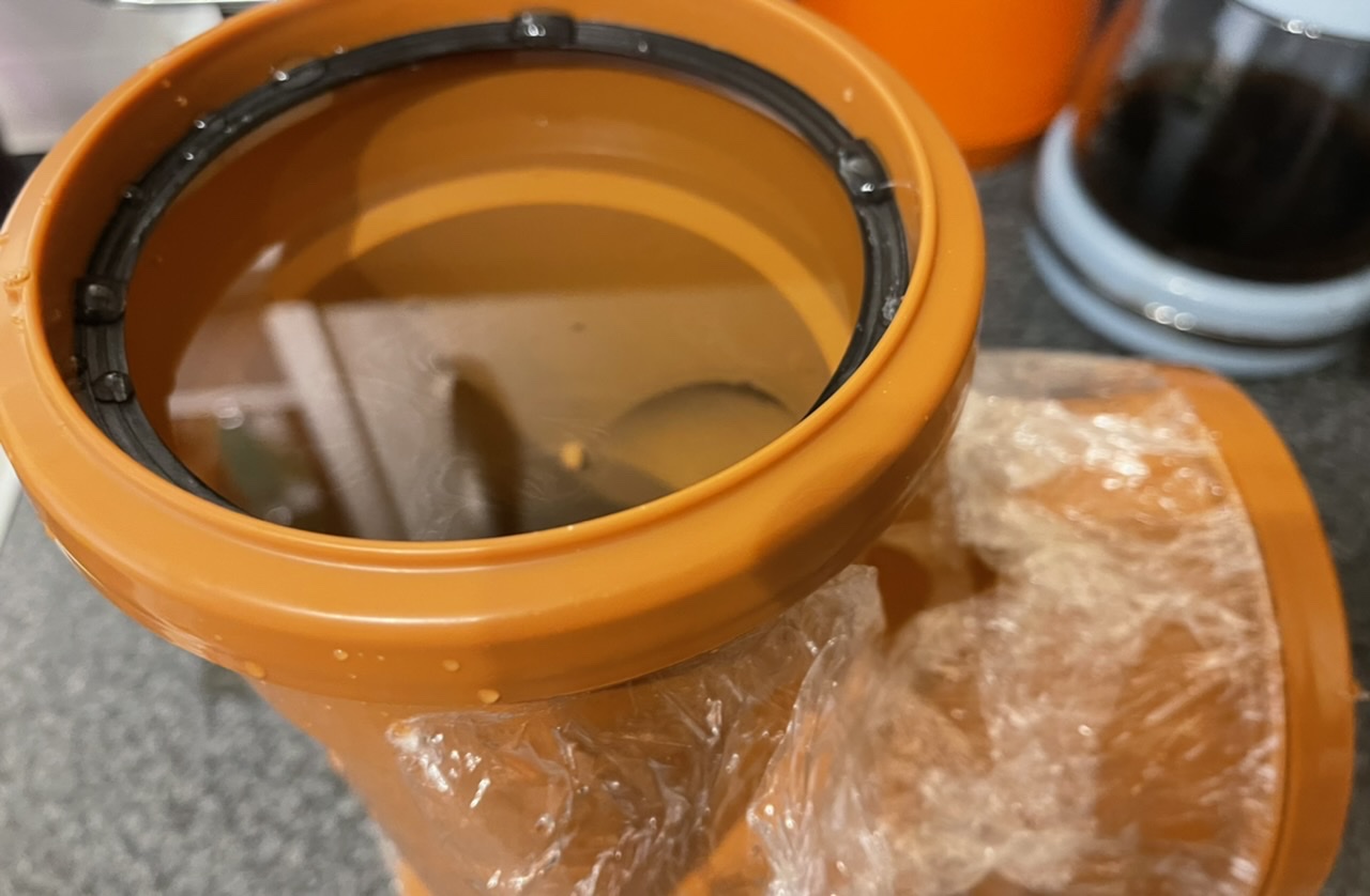

Should be easy to Dremel a hole in the end covers and glue that in there. Drivers face out (obviously) and the junction facing up can either have some switches on it or one of these:
Now I need to figure out what the ID of something like that is and how much VAS it will give. Might be easier to go to Plumb Base.
Drainage pipe?
I hope this project is not going down the drain! 😀
P.S. Vas is not the required volume of the driver enclosure, but is a T/S parameter that is used, along with the other parameters of the driver, to calculate the required volume.
The experts on the 'Full Range' speaker sub forum have software to match enclosure to driver and you could ask for help over there.
Got pipe?
It was easier to fill it up with water than work out the area…
It is 3L total.
But I will need to cut off about 1-1.5cm from the driver and top opening because otherwise it won’t look like a Mario pipe. Then after gluing a plastic disk in there to mount the driver, I think it’s realistic to take 3.5cm off it. So about .3L loss on that end. 0.1L loss on the top facing end, and nothing on the internal end. So total loss about 0.4L so 2.6L usable before driver… this could be tight.

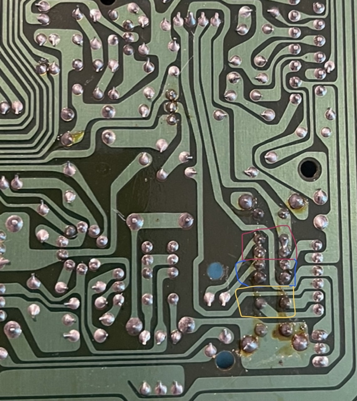

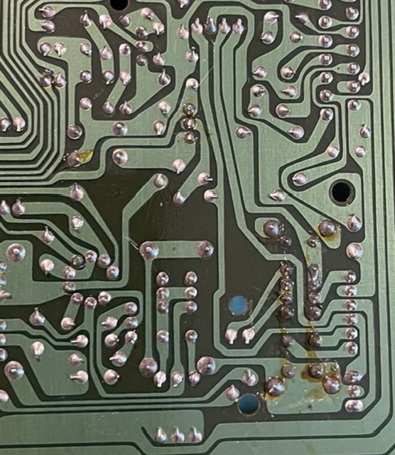

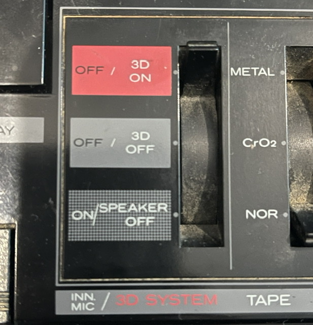

This switch:
Is THE MOST RIDICULOUS thing I have ever seen. In the top position, both the mids/tweeters and woofer are on. Or what you may call ‘Normal’ sound. In the middle position, the woofer amp is turned off leaving what can only be described as the worst awful tinny experience that no one is EVER going to use. The bottom position is both amps off and mic on
On the reverse we see that it appears that the switch bridges 2 sets of pins per side in each position:
I am seriously considering buying a second TPA amp board like this: £9.29 15% Off | AIYIMA TDA7377 2.1 Amplifier Board 20W*2+30W Hifi Subwoofer Amplifiers With Tone Volume Adjustment For Bookshelf Speaker DIY
AIYIMA TDA7377 2.1 Amplifier Board 20W*2+30W Hifi Subwoofer Amplifiers With Tone Volume Adjustment For Bookshelf Speaker DIY|Amplifier| - AliExpress
Then hooking the existing speakers and woofer to it, and the new full rangers to the other amp then cutting the tracks on the top 2 positions on the switch and rewiring so it’s:
Top position: both amps on
Middle position only original drivers amp on
Bottom: unchanged
This would completely bypass the original amplifiers.
Things I am unsure about:
1. Will the replacement TPA amp board be suitable for the original 3 drivers
2. Will cutting the tracks for that switch cut the power to the amps or the entire circuit
I am hoping that this will also prove to be more energy efficient, and possibly sound better.
If there’s anyone here who knows more about this type of PCB or is able to follow the tracks a bit better I would welcome any pointers.

1. Will the replacement TPA amp board be suitable for the original 3 drivers.
The 8 ohm superwoofer is driven by a mono 8 W amplifier. The 4 ohm mids are driven by a 2 x 3 W stereo amplifier.
The total power rating is 14 W RMS @ 10% distortion.
The existing drivers may have too small a power handling capacity for your chosen amplifier. 1 x 30 W and 2 x 20 W is claimed. However there's no indication that those are 'real' RMS figures so you might just get away with it! In addition, your use of a 12 V power supply will ensure the power output is much lower than the quoted figures.
Personally, I would keep the existing amplifier/driver configuration, which is true to the original boombox conception, and concentrate on the supplementary driver/amplifier idea. But it's your project! 😉
