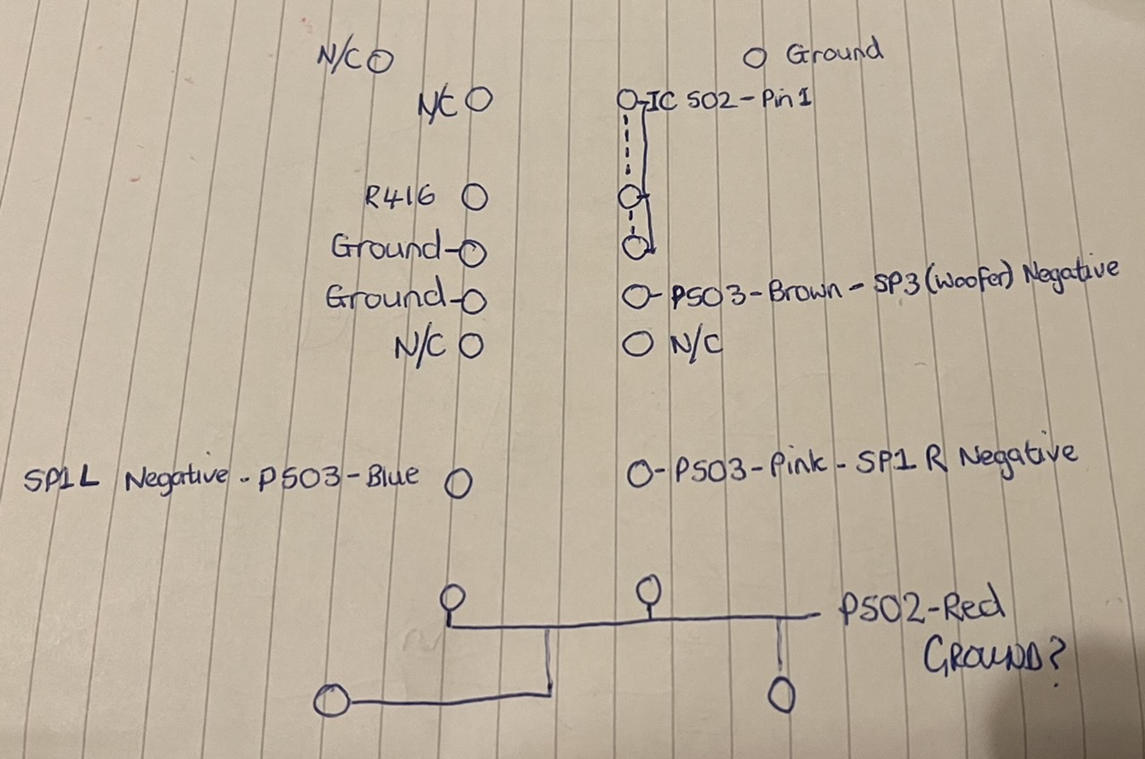

Have traced S502:
Edit: R416 leads to P403 pin 1, microphone
@MikePP at the moment the switch functions in the 3 positions:
502-1. Woofer on, left/right (inc headphone socket) on
502-2. left/right (inc headphone socket) on
502-3. Woofer off, left/right (inc headphone socket) off, microphone on
Edit: I think these are the correct designations
My plans for this switch are to cut the tracks for positions 1 and 2 and use them to ground or connect 2 low power TPA based amps that I have ordered. The switch should function like this:
502-1. Both TPA amps powered
502-2. Only 1 TPA amp powered
502-3. Neither TPA amp powered, microphone on

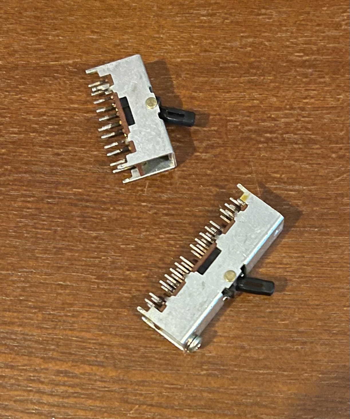

1. Do these amps just power the drivers or will disconnecting them affect the tape decks, radio, microphone and line in? I am thinking [and hoping!] not because on page 12 there seem to be preamps for the tape decks, Q401R and Q401L and for the microphone and line in, IC451? For the radio there appears to be Q101 and Q151 on page 10.
2. And probably a more important question, will this switch actually be able to take several amps of DC voltage? Is there anything in the service manual that you can see that would suggest it is capable of this? Or any ideas on how I could check what it’s capable of short of dumping current through it and hoping it doesn’t melt? 😱
What I often do if I'm repurposing (or overriding the tarnished contacts) orignal (and unobtanium) switches is to dis them from the original circuit by cutting tracks, then rigging up small signal relays that are switched/controlled by the original switch. i.e. you're just switching the relay control voltage throught the switch and letting the relays do all the heavy lifting .
  • Be warned you must absolutely clear which is the common.wiper and which are the contacts before continuing otherwise you'll end up in a right muddle and be extremely frustrated.
Yeah this hasn’t been low frustration to this point, maybe this would be a better approach:
I can verify what we’ve found without any interference from the PCB. Not sure if I could tell you what shape the wiper is, but I will be able to confirm by systematically running through each pin and checking against every other pin.

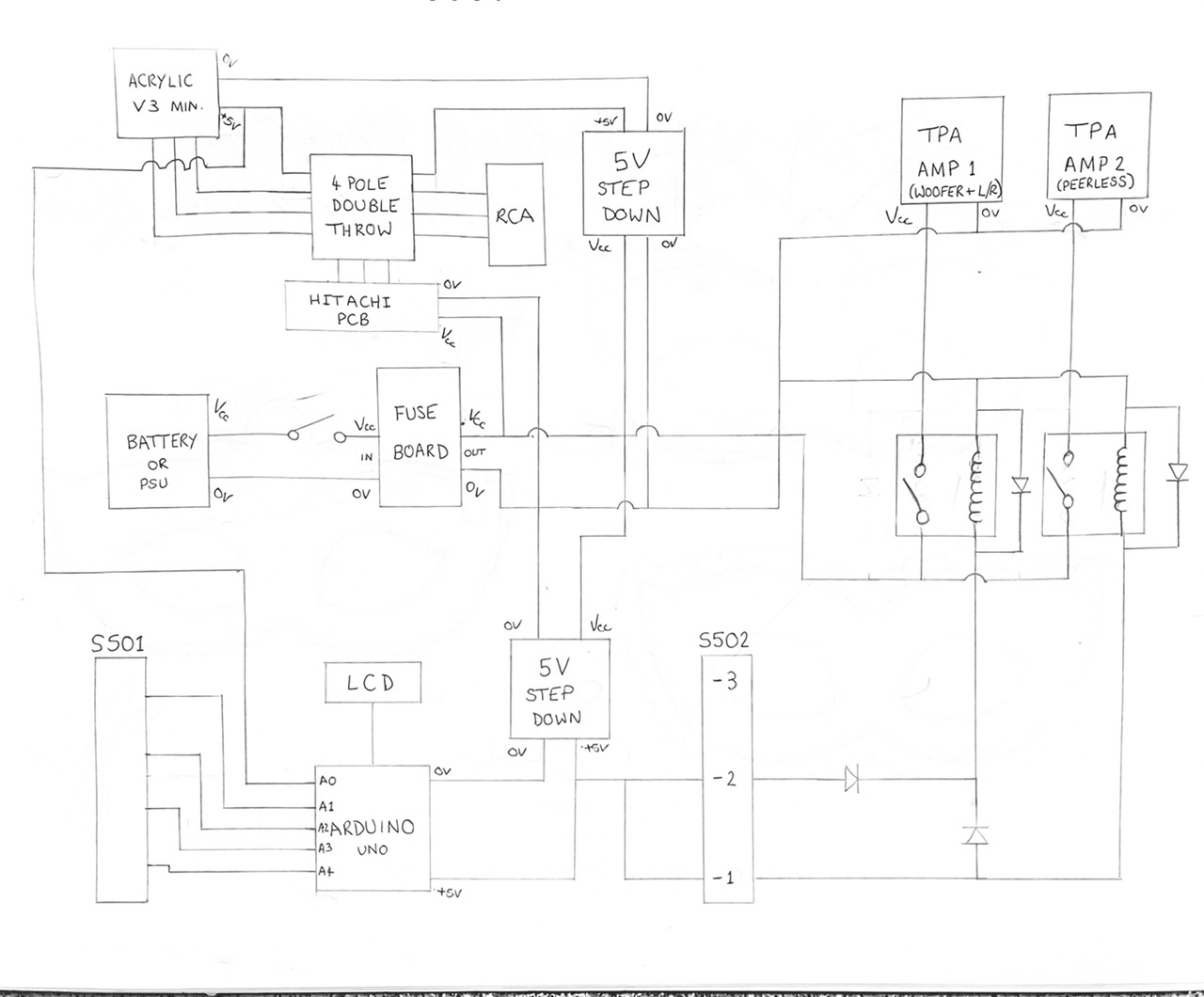

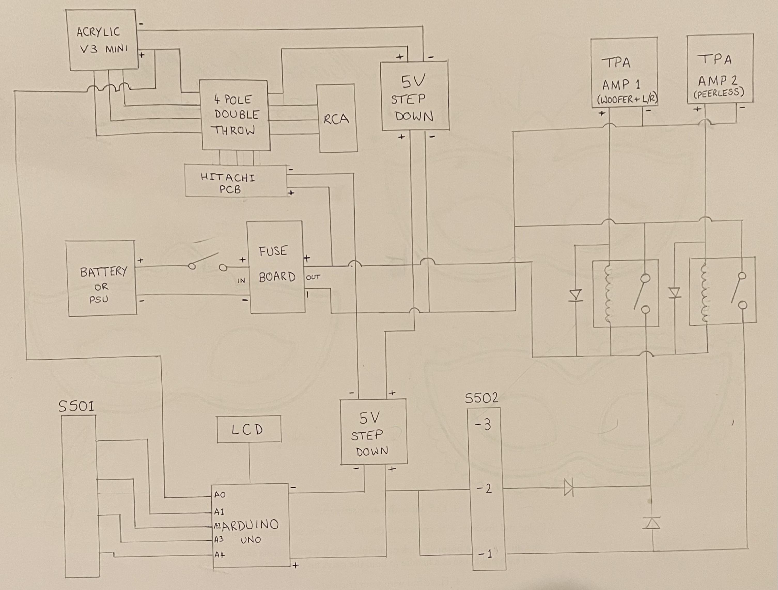

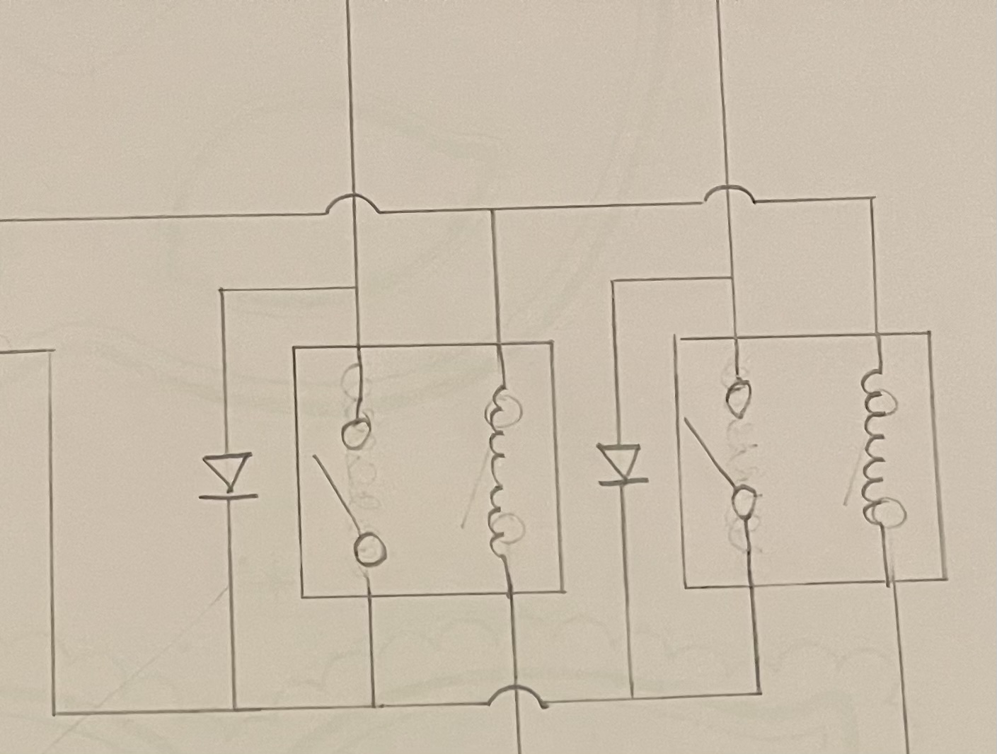

Right…. Here’s what we have so far. This is work in progress but I wanted to show what we’ve been up to 🙂
Here are the main changes and additions:

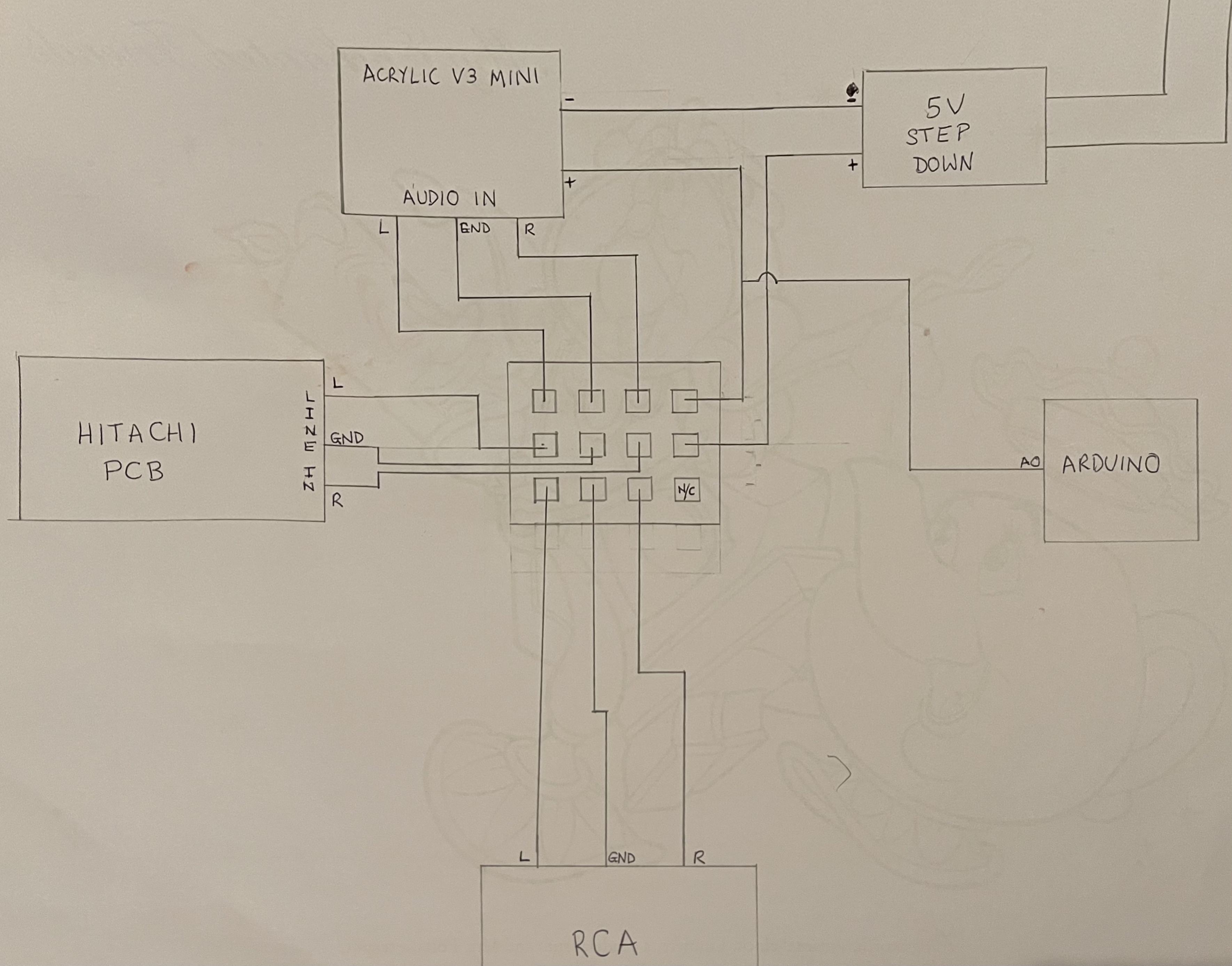

And here is more detail on the switch leading from the line in:
If you can see dark lines on the reverse, it’s because we borrowed an old Disney princess art pad ;-)
What do you think?
What do you think?
You've completely misunderstood the use of the relays !!
The original switches should be supplying the coil of the relays (either ground or the supply) to subsequently switch the load (the amplifier output ..... or supply - your choice)
But you created a very wacky circuit there, feeding the TPA + supply? through the coil of the relay.
(I take it the TPA + and - shown are the supply connections and not the outputs?, not that it makes much difference - you need to go back to the drawing board - big style - sorry ......

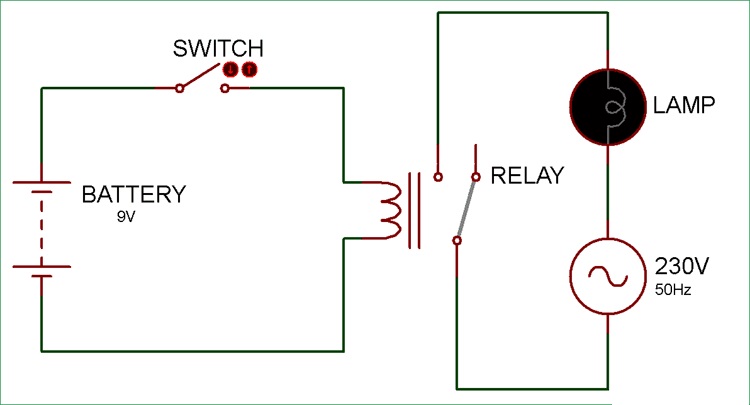

Take a look at a simple relay circuit, note the 9volts on the relay coil side will (can) if needed switch 230V (mains) on the contact side - it could be anything on the contacts side depending on the relay chosen: mains , 25V , a speaker output , a speaker ground , both !
but the lowly 9V (in this case) through the measly switch controls the relay, which actually does the switching.

Only slightly lol
You've got the protection diodes across the relays contacts..😱
Redraw the whole thing (or edit it) and repost it
and change the + to Vcc and the -'s to 0V or similar instead of + and - everywhere, it's easier to read.....
But don't call different voltages all Vcc, differentiate them.

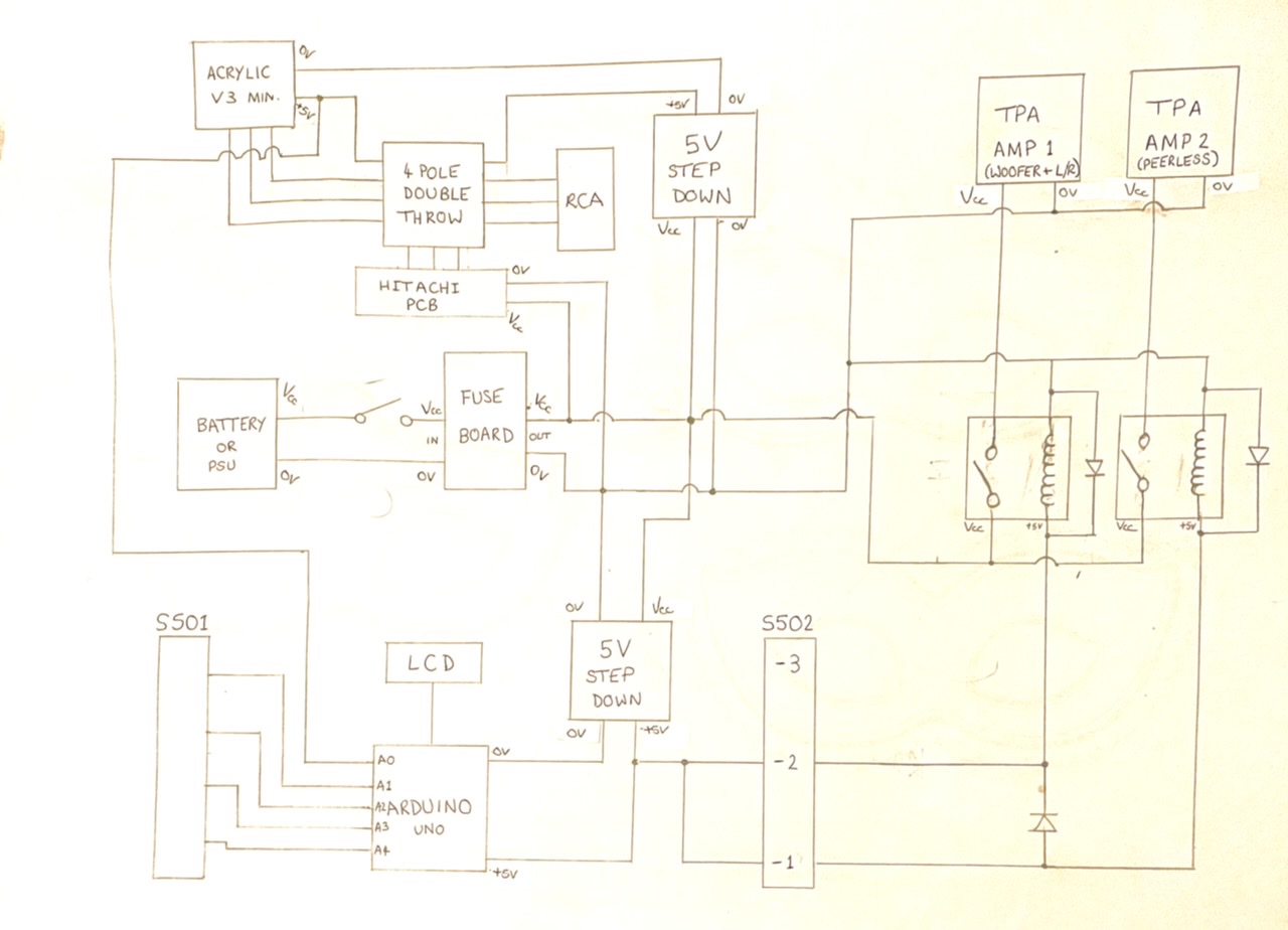

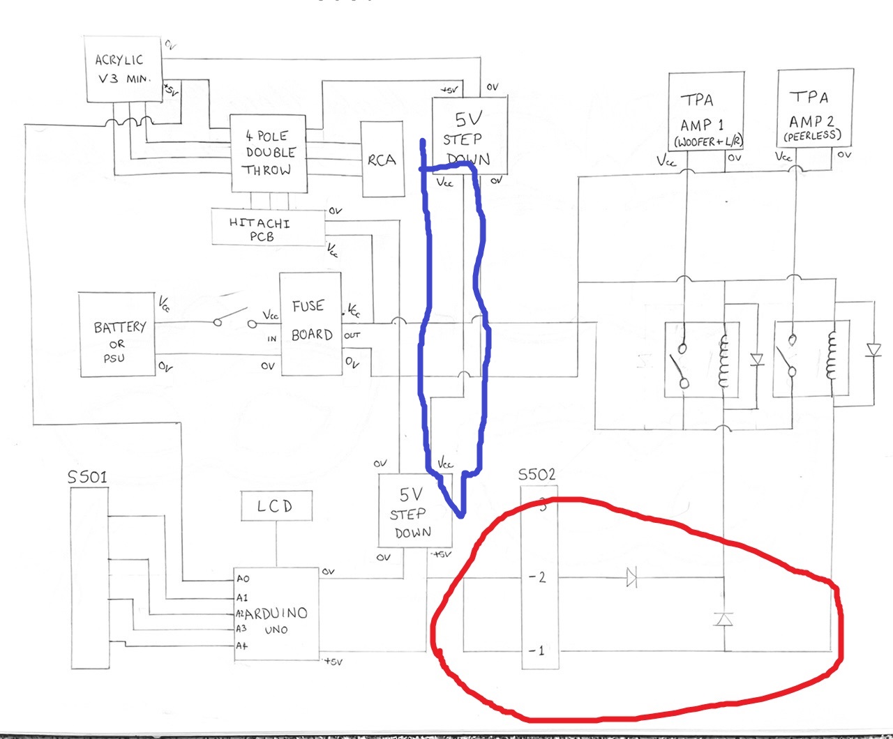

How’s this?
Blue circle - take another look and spot the mistake and correct.
You're doing right by doing hump back bridges for crossing over wires, but for deliberate connections of crossing wires you should be putting a bold 'full stop' at the connection, so everyone knows they're connected , at first glance it looks like the Vcc suuply doesn't feed either of these 5v step downs
Red circle - take another look at this diode configuration and correct. (although I'm not sure what you're trying to achieve in this area anyway)
With the diodes after S502, I was not sure about them. The purpose would be to stop the -1 relay energising when the switch is in position -2, else there’s no point in the switch (but we want -2 to energise when in position -1). Looking at it again, it seems like the diode after -2 is probably useless so I have removed it.
In the blue circle, did you mean the error is the dots signifying a connection? If so how’s this:
Please excuse the crappy colour on the right and any artefacts. Im having to take a photo on my phone in artificial light and bump the exposure.
I didn’t realise it was good practice to use both the humps and the bold dots. A lot of things I’ve seen use either one or the other.
If there’s something else in that blue circle, I’m not seeing it right now. I’ll have to look at it tomorrow after coffee. It does look messy though, could do with an untangle.
Edit: I’ll add labels for diodes and relays (part numbers) tomorrow as well.
