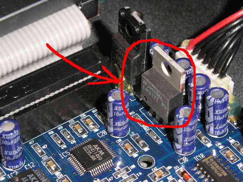

what is on regulator Vout LM317?

But the PS, the 9V is really really important, it feeds the 7805 that provides all chips that uses 5V, this includes the dac of cause.
And the 9V doesn't seems to go thru any inductor to reduce noise, so should be a good idea to add a coil and more caps for that 9v. The 7805 gets really hot with means its drawing quite a bit of current.
The LM317 will take the 5V and output 2.5V, so should be for the dsp chips. I found that there is a ceramic directly at the LM327 output, a real no no for this type of regulator, so I took it out.
Instead of improving the supply to the 7805, you would be better of removing the 7805's from the board, and using outboard discrete regulators like jung, super-jung or similar boards. Selectronic sells a replacement regulator kit at an affordable price, or you can do your own.
