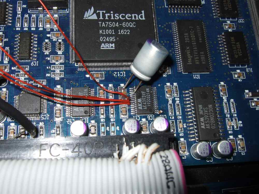

I just did a simple mod and find it very effective in improving bass (no, I don't mean pushing up eq of the lower fz)
If you study the ak4393 dac datasheet, look at the analog 5V decoupling for the Vref and Avdd pins, it requires separate 0.1uf and 10uf for each of those pins. Guess what, the deq only has only one 0.1uf for both pins, those pins are starving for quality power.
Obviously the best solution is to give it a separate clean PS, but I lack time and too lazy. I did the next next best thing, I put a Oscon SEP 470uf directly on the Vref & Avdd pins.
Nice improvement on the bass, but I am using direct transformer out, so YMMV.
Anyways, the deq is poorly decoupled and adding good caps in other place will likely improve things too.
Check the pic.
