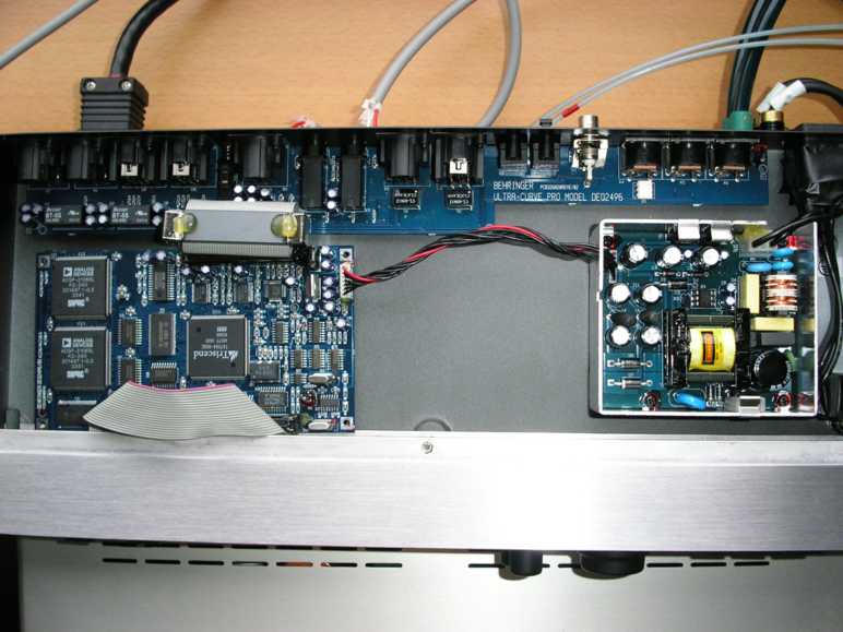

Did the mods many years ago, have no schematic, but it can be found on the internet, I cut the flatcable and made Cinch sockets where the AUX OUT sockets were.
I think this is the right schematic for the passive out, Thierry?
Another pic shows an example of the DCX2496 passive out, also copied by me, many years ago and stil going strong!

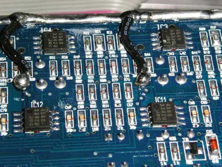

I think that instead of cutting the flat cable, I take the output of the dac by removing the 47uF electrolytic capacitors on the output pcb.
So I don't cut the cable. I think it's a good idea, right?
The 1k R ​​is recommended a metal film or better like a carbon film .. like kiwame?
Yes it is, much cleaner. That's what I used to do on last Behringers I have modified so many years ago, better than cutting the flat cable. I doubt you will hear any difference between a metal film over a carbon resistor. Metal film ones are slightly inductive because of the fabrication process (metal is removed in spiral) but it's probably impossible to detect by ear in this application.

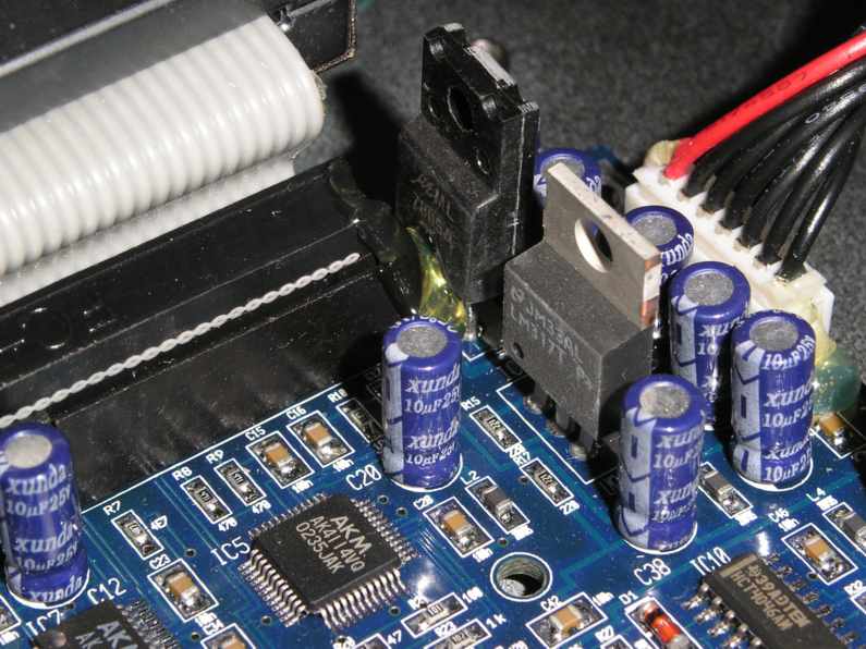

Yes the biggest one X1 ,But I looked at the data sheet for ak4114 and it has a spdif in and out pins, I hope to try those locations and see if it works as planed,I found stef had found some of the pins but not all in this thread.
I would like to find the digital in and out circuits, I would like to connect the digi out of the DEQ to the DCX digi in,I do not want any XLR connectors or cables just a twisted pair if the levels are close enough.
I want to retain the RTA mike in, I can make a preamp ,but need pin #'s.
