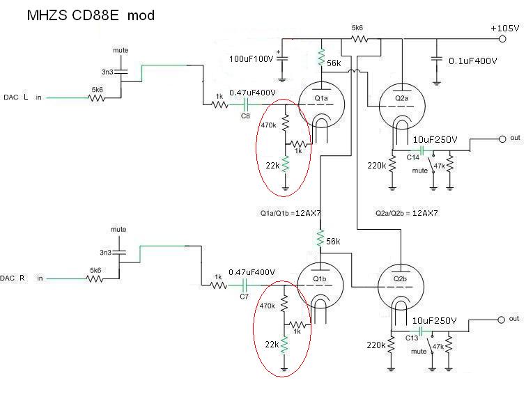

One of the problems that remains after MHZS opamp mod is done is too low output signal of the player. Much lower comparing with other players. The amplification of 12AX7 tubes is 100 times. So what we have here is either the signal is attenuated more than 100 times before output stage , or the output stage’ attenuation factor is less than 1 [0.8 or so] Can we do something about it with the existing schematic.
Changing 33k cathode resistor to 22k doesn’t make to much difference.
Is it possible that the signal was actually preattenuated in the dac digital domain? Did someone measure the signal after the dac?
The second possibility is that there is something like huge negative feedback applied in the tubes output stage shem.
Could some of you explain what impact on the signal makes that part of the schematic I circled in red? Does it work as negative feedback? What can be done here to lower the value of that nf? Will that help to make the output signal stronger?
Thorsten and Koifarm , what would you say about it.
I should have said "amplification factor is less than 1".
It is supposed to be :
So what we have here is either the signal is attenuated more than 100 times before output stage , or the output stage’ amplification factor is less than 1 [0.8 or so]
Yes, when you replace the 33k you can also try 27k. Some people had some distorsion with the 22k resistor.
First of all as I said couple of postes before I did change 33k resistor and that did not make too much difference as far as amplification is concerned.
Second of all my point is : what happens to that 100 times amplification factor of the 12AX7 tubes in that output stage. The amplification of the stage is not even 2 , it is actually probably less than 1.
So what part of the circuit is responsible for that. First is the very low anode supply voltage , but that's not enough to lower it[amplification] 100 times , so what else? My guess is that there must be some kind of negative feedback apllyed. I Suppose it is that part of the circuit I circled in red on the schem. Let's concentrate on that. Remember 100 times factor , not a fraction of one percent
