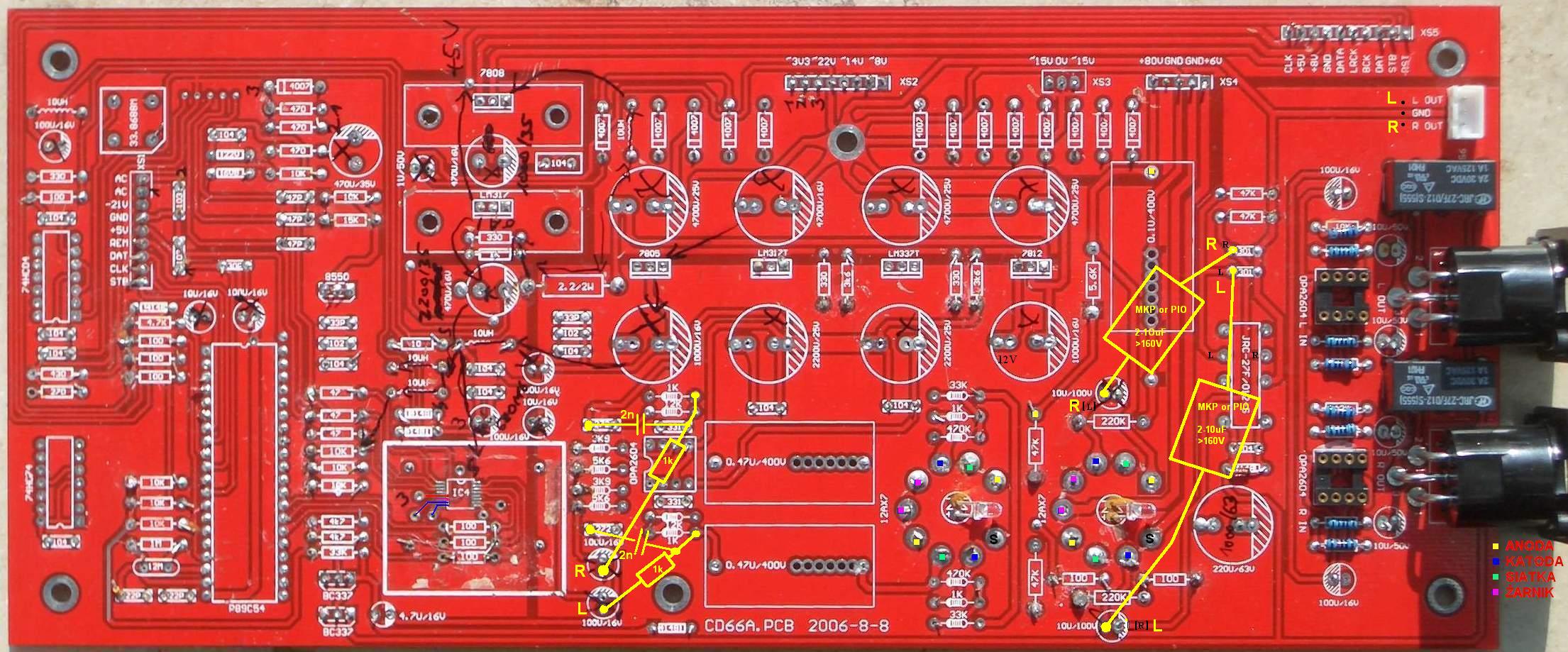

The first input resistor in the tube stage should probably be around 47k. 33k makes output signal from CD player much too high, otherwise the stage sounds a lot better than the original one.
In this pic you can see the two diodes removed and the L78L33ACZ 3.3V voltage regulator put in place for DAC Vdd+ supply - it gives steady 3.3 unlike diode solution that fluctuates the voltage depending on current draw. There are two wima's underneath the PCB bypassing the input and output of the regulator. Input bypass cap also tames +5V supply oscillations that were significant.
Filtering caps were replaced by Oscons and Nichicons.
All these modifications resulted in significant improvement in sound.
The modified player on the photo had a defect DAC ic. it had already the passive mod from page 1 and played good for 3 years. Replacing the origenal DAC was not a option because there are much better dac's . I toke a lampucera type2 dac board and connected it to the sdpif out from the player, i removed the opamps(3 x AD827) from the dac board. Put in 470 ohm resistors in pin 2 and 3 for I/V conversion in the first two dipsockets and connect pin 2 to the input capacitors of the mhzs tubestage. The powersupply i have got from the mhzs pcb, one 5V for analoge circuit and one 5V for digital circuit. +/- 12V i do not need because i removed the opamps.
Now the player has a pcm1798 dac like the 88G.
Here's my mod of the DAC board:
OpAmp removed, DAC output directly to coupling caps via two signal wires, coupling caps - .47uf auricaps, output caps - 6.8uf ERO MKT1813, filtering cap replaced with Rubycon 220uf 200v, 33k resistor to 22k for gain compensation.
Everything sounds excellent.
I was considering running output caps directly from output tube to RCA bypassing mute relay, hope current solution of mounting them vertically is mechanically stable enough. Everything looks clean now.
Oh, and the blue leds under the tubes are gone.
There is easier way to connect output caps. One can fit caps of bigger size and better quality. And what you think about that little passive filter I aded after dac? Where 2n caps should go - after or before 1k resistor?

I think with PSM1798 current out you could bypass coupling caps and go directly to tube grids. 470R resistor then would be RG...
This two regulators oscilate like hell because the people of MHZS have forgotten to place the decopplingcaps of 100nf.
Just place 4 x 100nf capacitors as near as possible to the voltage stabilizors.

That is possible, but it can also be the cable to the dsplay. try to move the cable or place a ferritcore on the cable.
I can recommend to ad the four capacitors. The voltageregulators stays much cooler.

I beleve you were wrong saying that they feed the dac. These two have nothing to do with the dac. They supply 5V[LM317] and 8V[7808] to the other board[transport control].
And in case of decoupling LM317 , you should decouple it rather directly to the ground, not through resistor when you go to ADJ .
