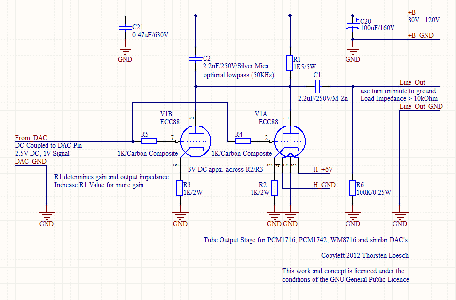

You are by far not through and extreme enough.
First, connect the output from the DAC directly to the gridstopper (1K carbon composite will be nice) of the gain tube. Connect the second halve in parallel with it's own gridstopper.
I would suggest 1KOhm cathode R per section and a 1.5K common anode resistor for the gain-stage.
This gives a gain of a little over 2, just right for a little over 2V RMS output. Output Impedance is a little on the high side, at 1.5KOhm, but it is a "real" output impedance (see BAT's white paper on their "unistage" or whatever design for more) and sounds great. It gets rid of the cathode follower and of unnecessary gain and attenuation.
You cannot get more direct. Signal to grid, straight out from the anode.
Using good quality resistors in at least 2W (better 5W) is recommended.
For the coupling Cap use the best you can get. My take would be 2.2uF/250V as either diyhifisupply Obbligato Tinfoil & Polyprop Film or the Mundorf M-Cap ZN or Audyn KPSN. If you really have too much money get Audio Note Copper Foil or Silver Foil.
Ciao T
PS, I would keep the Tube Rectifier, but replace the resistors with chokes, this reduces noise and brings up the voltage too.

The passive mod is half done, you need to bypass all circuitry from DAC output to coupling caps. Koifarm mod leaves series of resistors between DAC output (that already has op-amp stage) and coupling caps leading to tubes. Just solder two bypass wires from DAC output to C7 C8, remove the opamp and leave the rest of the circuitry intact.
Here you go.
Ciao T

ThorstenL,
The schematic you draw completly changes the sound of the MHZS player. I think people bought the player because of his sound. I do not say with will sound better. Because this is very personal. But if people want to rebuild the entire tubestage, why buy the player at all?
Is modification not about changing the design to improve the sound without changing his characteristic properties.
Ronny

Here's my simple solution:
1. Remove opamp
2. Remove two coupling electrolytic caps that are closest to the DAC
3. Run two signal wires from the DAC output to the big coupling caps
4. Change 33k to 22k as per Koifarm instructions (gain compensation)
