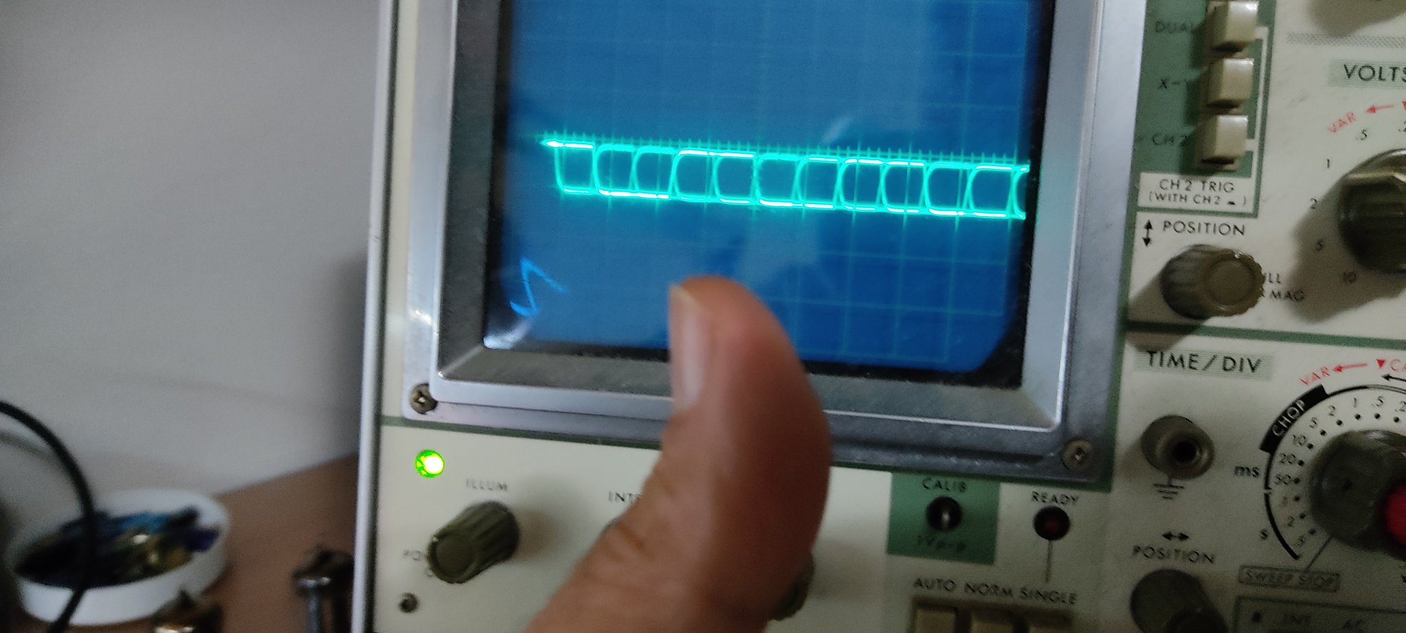

Modification of MHZS CD players
Aggiornamento spdif..

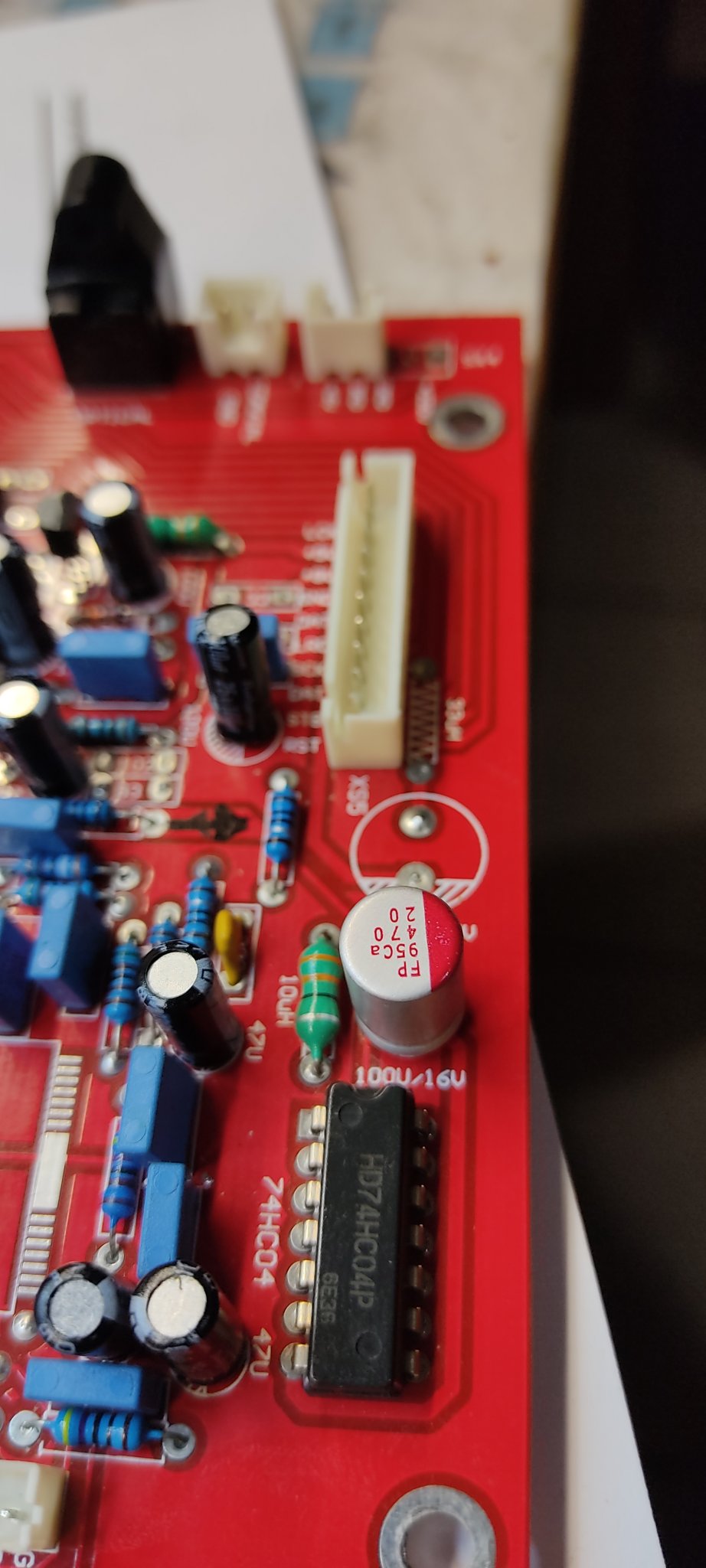

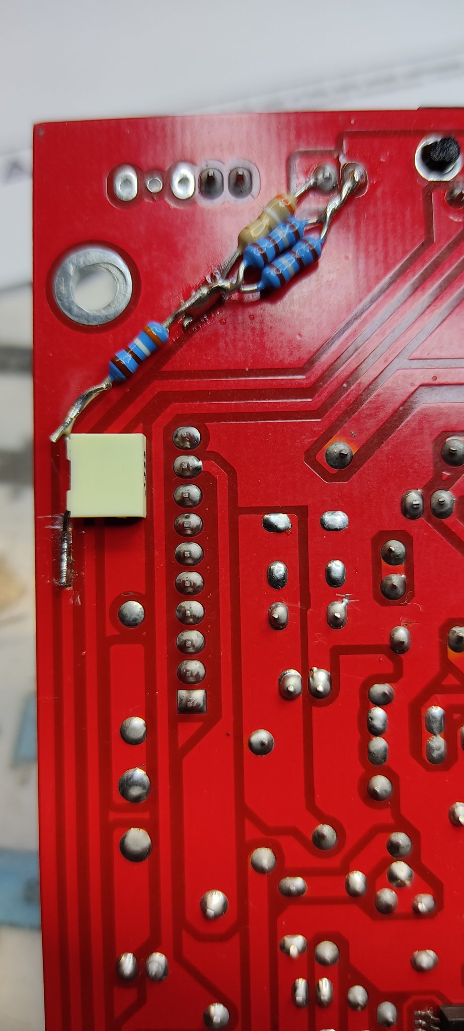

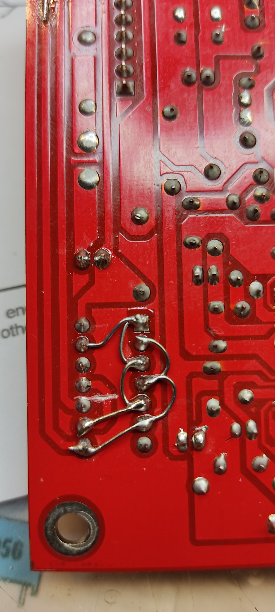

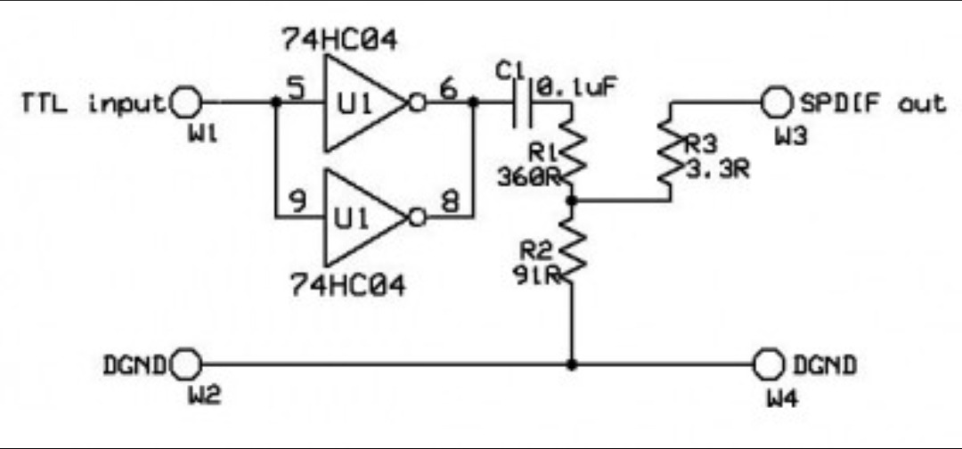

I wonder will this mod restore my MHZS CD88E? I was using mine as a transport only but now it outputs a high pitched sound from the spdif into my external dac. So far it's now confined as a boat anchor collecting dust. In the past, I've used it as a CD player and Lampizatored (bypassed the opamps and wired it to the tubes and output caps directly to the RCA plugs) only for that to fail as well
