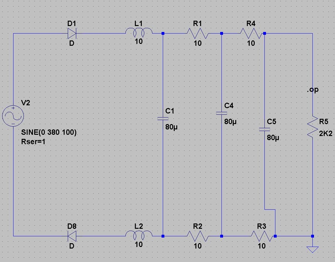

I have a general question concerning calculating the ripple voltage in an LCRCRCRC (after the rectifier bridge). (In my case, it's for tube pre-amplifier, with a shunt regulator following the PSU filtering. However it is a general question for such filtering).
I know that Ripple V = I / (f * C), or It = CV. However, that formula applies to 1 capacitor in the filter (or few parallel capacitors, which are calculated as 1 big capacitor).
I also know that for 1/2C*R*1/2C the ripple is lower than for 1C.
Is there a formula, or another way, to calculate, or simulate, the ripple voltage for CRC filer?
Also, is there a formula, or another way, to calculate, or simulate, the ripple voltage for LC or LCRC filer?

The nice thing about simulation is that you can go the extra yards if you really want to, providing you're willing to do some extra fiddling, or hunt down other's efforts ... as it just happens, there was a recent conversation in the LTspice user forum at Yahoo: Yahoo! Groups, in a thread called "Simulating Frequency Dependent Inductor"
One needs to join the group first to see this material ...
Frank
I don't try to sim the trafo myself, rather I use a sine source and feed that through a diode bridge. That works well enough to get the waveform into the filter looking how it looks on my scope.
It doesn't work at all with a sine source. See the attached schematic. I get all zero voltages and currents.

I have looked at the schematic, seems you have not digested what I'm saying about needing to run a transient analysis, not an operating point. Right click on the text '.op' which opens the window where you select the kind of sim, the left most tab is what you want. Fill in details like how long you want it to run and how precise you want the results (min timestep). Bear in mind that a diode feeding an inductor directly will give simulation problems when the diode switches off as the inductor current has nowhere to go....
