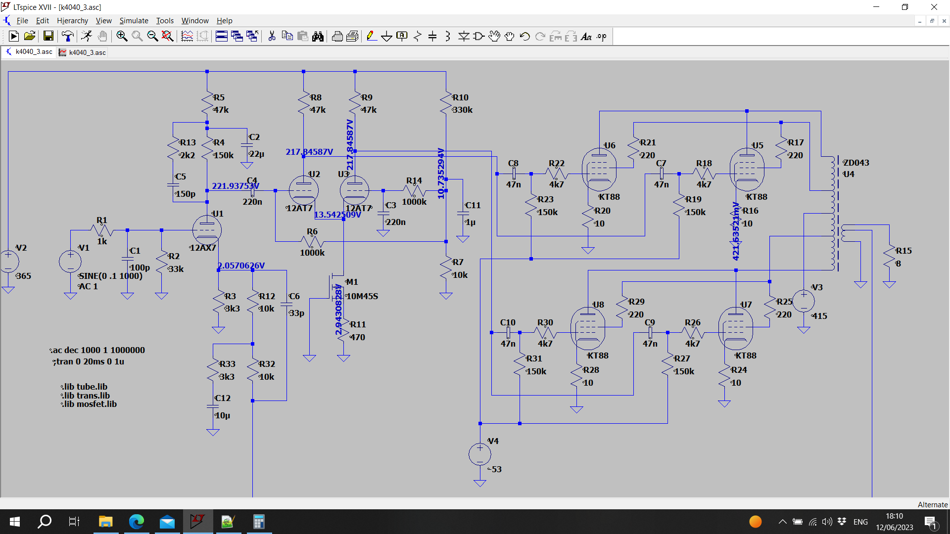

Yep. From memory the transformer is not that good at HF. So that means placing the dominant pole quite low (say 8KHz). The cap your talking about is the lead compensation. There is a good article on this just cannot find it.
In the plate ckt. of the 12AX7 there is C5 and R13. This is an RC filter of some sort, isn't it? What is it's purpose?
Yep. C5 and R4 in parallel with 12AX7 Ra are the dominant pole which you would set to 7-12KHz. C5 and R13 are the zero which would be say 50KHz and matches the first pole of the OPT. C6 and R12 should also be at about 50KHz. There's no simple way to explain - you are building a lead-lag compensation network.

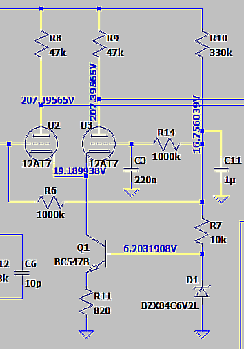

Sorry this does not include the grid stopper on U3 and I am not sure which CCS you ended up using.
I have added some real parameters to the ZD043 OPT model based on sketchy info elsewhere (-3dB BW 3-125KHz). I find the circuit very close to instability at about 2Hz. If you back to the original K4040 schematic C8, C7, C10, C9 (referenced on #97) are 22nF - that's why. This makes it much more stable. However thats a break frequency of ~30Hz which is too high and could result in the driver stage clipping. I have made them 47n, but made the NFB more complicated with the addition of C12 R33. This is lead compensation similar to what C6 does at HF, but at LF. C12 can be a electrolytic +ve up bypassed with a metal film or just a metal film - it only has 1V across it. You could also go back to the simple NFB with the 47nF for C8... but increase C4 to 1-2uF but at 400V its big. Even then its not as stable. As usual nothing is simple with NFB...

Hummmmm........must order mo' parts it seems. I do not have the 47nF caps. I didn't end up installing the grid stopper resistor. Do you think that I need it? I ended up using the BC547B based current mirror that you posted. As far as I could tell it worked good, as did the 10M90S's. Thanks again for your hard work in trying to help me make the most of this project.
Well, I got my parts and made the NFB to match the schematic with the addition of C12 R33. I also changed C8, C7, C10, C9 to 47nF and had to reverse the output transformer phase. However, the gain was super low so I tried a 47pF across a 68K resistor and and gain was good and it sounds fantastic. I think I may put the covers on it and listen to it for a while. I've spent more time tinkering with it and now I just want to listen to it and enjoy. ....plus there are other summer projects that need my time.
