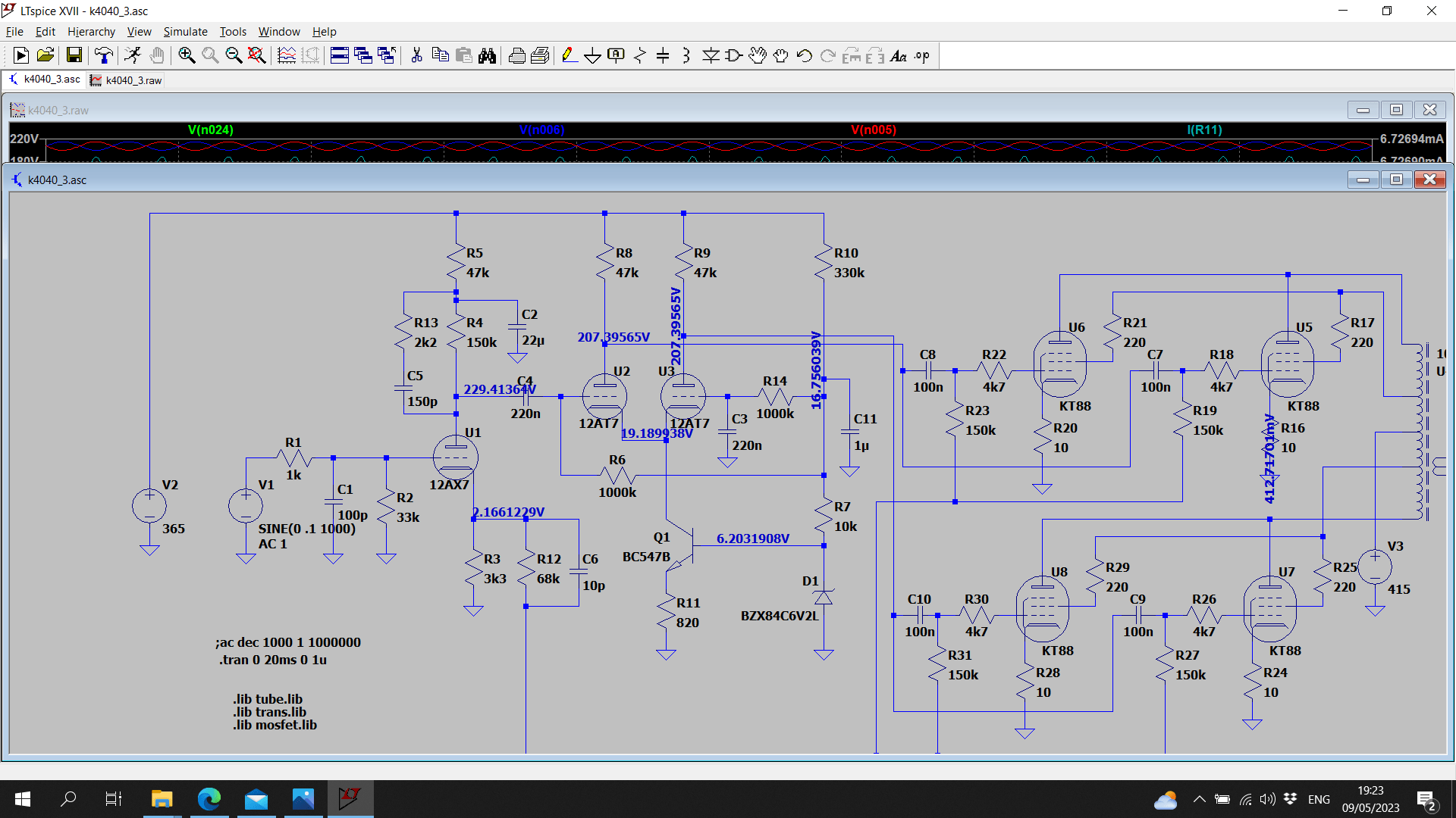

Do you have some BC547 or similar. If so you could build a current mirror instead of the MOSFET.
A current mirror requires two transistors at least - plus a CCS. What an effort. I'd prefer a cascode CCS instead.

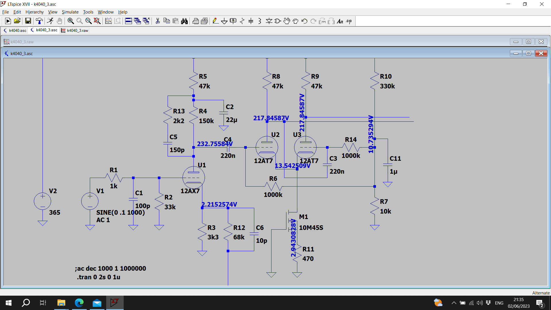

Hummmmm...... Since the 10M90S's have already been shipped, I think I will try them first. If they don't work I will try this CCS but will have to order the BC547 and the zener. Thanks for mo' info. and possibilities, baudouin0. 🙂
I ordered the parts for the current mirror alternative since they were cheap and locally available. I hate to drag this project out any more than I have to and this way I should be able to get the phase splitters operational one way or the other very soon. Thanks again for all the help.
I received the 10M90S's and they worked great. Now I need to install the output tubes, adj bias, etc.. Getting excited now!
I finally got around to inputting some music and found that I some significant motorboating at output tube sockets pin 5. I don't have the output tubes installed yet as I wanted to make sure I had clean audio out of the phase splitters first. I have the motorboating without any input also. Do you think that changing C4 (and C3 ?) to 100nF would fix this?
I replaced C4 & C3 with 100nF caps without any change. I guess I will next replace the CSS in one ch. with the current mirror source and see if that changes things.
It may be its oscillating at VHF which you don't see but causes the motorboating. Try a grid leak resistor in series with the grid on U3 1K. If you have the output tubes unplugged then there is no method of LF oscillation I can see other than if there's also HF instability.
I don't completely understand, if I add a 1K in series with U3 grid, wouldn't that be in series with R4 (1 meg)? I thought (although probably wrong) that grid leak resistors were from grid to gnd. (?)It may be its oscillating at VHF which you don't see but causes the motorboating. Try a grid leak resistor in series with the grid on U3 1K. If you have the output tubes unplugged then there is no method of LF oscillation I can see other than if there's also HF instability.
I was wondering if the motorboating was being caused by the 10M90S's (?).
Thanks for the help, baudouin0 & gerrittube.
Sorry grid stopper resistor in series with all else to grid. The word leak means grid to ground I used it wrong.

Yes I saw on another thread here that the 10M90S can oscillate with a LTP. This is HF oscillation but can causes all sorts of problems from hiss to motorboating to picking up radio.
I don't think that circuit can just motorboat without the output valves and FB connected. If its just an LF problem it should show up in LTspice anyway.

OK, thanks. I think I will try a bc574b based current mirror as per your previous schematic for one channel and see if that fixes the problem. I had the motorboating with the output valves not installed and even unhooked the global feedback even although I didn't think that should matter with the outputs not installed. The audio was clean coming out of the 12AX7's but not at the 12AT7 plates.
Can you send a scope trace of the motorboating. Do add the grid stopper (1K-2K2) on U3 as its grid go directly to ground through C3 and the 12AT7 does go up to VHF.
10M90S’s can oscillate without output tupes installed. It only needs the driver tube it feeds to create a lot of noise if you’re unlucky. Same for 10M45S’s chips.

OK I can get the LTP to motorboat if you have C3 connected to the plate of U2 instead of ground. I only say this because the original K4040 was wired as such.
