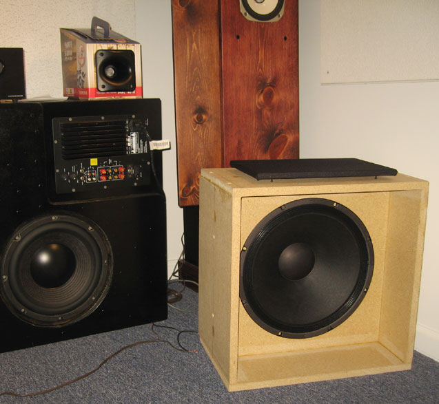

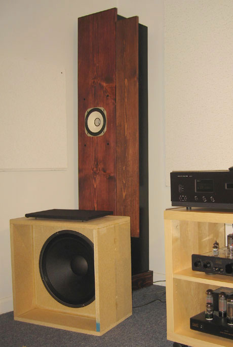

More pics of the H-Frame with 165k BIB. It's not easy to see but if you look carefully you will notice a BIB-Wing. I only hear a difference when the wing is fully extended and flush with the main baffle. They fold back but i usually leave them open. The midrange seems fuller when the wing is open. But the difference is subtle. It's possible the sound changes because the rear firing tweeter may be effected by the wing somehow. Sometimes i feel like removing them since the change is small and they clunk up their looks.
Will add low feet (probably the kind used for sliding furniture around on carpet) to the H-Frames. Have no clue how to finish them... I may have a little fun with color. Any suggestions welcome.

The H-Frame on the other side. Note the 12" powered sub in the black box... very heavily braced inside... heavy to move around... It has a bulky uninteresting look. The H-Frames look interesting are light and easy to slide around. The Alpha 15's magnet is small compared to the SV12 subwoofer. I haven't really played with H-Frame positioning, just put them where the fit and played with the crossover and volume. A few hours of tweaking and you're set.
The coffee container contains an inexpensive Eminence compression tweeter and the smallest Dayton Audio waveguide. Crossover set to 11khz with an L-pad to adjust. The way i have them set you can barely hear them but when i turn them off i miss them. They add a detailed treble and air i like. I always liked super tweeters tho. I already have wood cut up to make small boxes for the tweeter. That's my next project. Probably sit them atop the H-Frames and be done with this system for a while... next i need to improve my office system.
