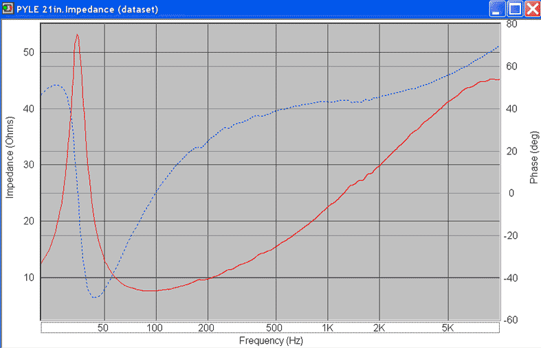

MisterTwister said:Pyle PDW21250 are very nice woofers.
I got a pair recently. they are about 0.7qts
very smooth impedance curve and no humongous cone breakups,
easily can be crossed at 200hz. I am using them on 24in x 24in plywood baffles.
How did you come by the Qts? I don't see this on any web source I could find. If they are .7 then I am VERY interested. Do you have an xmax or any other specs?

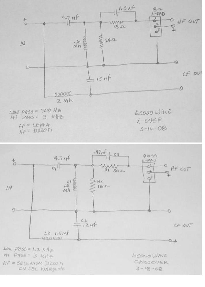

Could someone please run a simulation of the alpha 15 crossing at 1200hz in the H frame. I am planning to use it in the "econowave" project that everyone rave about at audiokarma http://www.audiokarma.org/forums/showthread.php?t=150939
Will the alpha be good crossing that high or should i cross it at 900hz. Thanks.

InclinedPlane, I measured them with speaker workshop.
I just rechecked one of them on flat baffle
qts 0.674
fs 35hz
re 6.7
I can't measure xmax unfortunately.
these results don't match with manufacturers' description, nor these results: http://www.diyaudio.com/forums/showthread.php?postid=1555936#post1555936
I If you decide to get a pair, get them from the same vendor,
so woofers more likely will be from the same production run.
Despite inconsistency, they are excellent woofers. I wish PYLE were making 24 inchers 🙂
