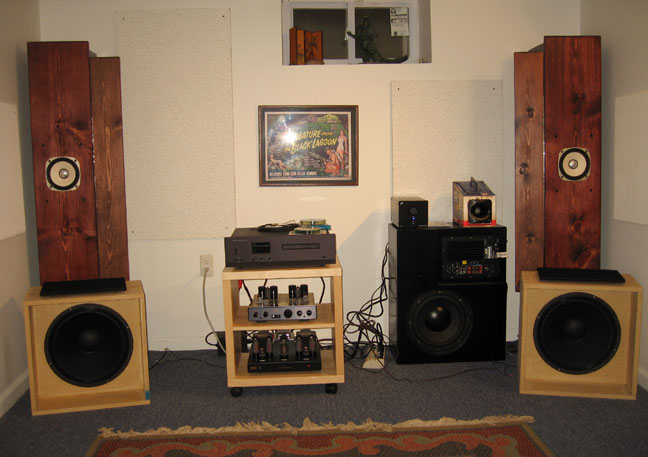

I'd love to go to Martin's house and listen but now i don't have too. I built my own H frames using Alpha 15s and hooked them up this afternoon a few hours before the Super Bowl.

The photo shows exposed messy wires but i was excited to hear the H-Frames. Basically i have been unhappy with the sealed subwoofer (black box) for quite a while now. It never integrated with the BIBs and always sounded disconnected and somehow 'thick' in the bass. I would slide it around into different places but it pretty much sounded the same. It's a nice ACI SV12 in a 2.5L sealed box. I've had it for several years. The plan is to replace this sub with something better. The H-Frames certainly offer more guttural impact, dynamics and loudness. They do not sound thick or slow but i still have not dialed them in 'just right' yet. Their potential is awesome! I keep reducing the crossover and lowering the volume knob because they have the ability to scare you out of the room. Based on initial listening i do believe they can recreate the sound of a real live airplane landing in my basement! I did have a great listening session with them yesterday and know know all i have to do is fiddle a bit more. The variable crossover is set to around 70hz (needs to be lower) and the volume knob is maybe up an eighth. There is more detail to the bass and a room filling ease compared to the 12 inch sealed... there really is no comparison. The H-Frames offer much more bass output, they just need to be tamed.
I am excited to find the right amount of tweak to make these things work in my room with my BIBs. Room placement was not an issue. I thought it would be from reading Martin's paper... but they always pumped out plenty of output even when closer to the rear wall. In the pic they are about three feet out.

Very nice, an Alpha 15A in an H frame is a very interesting combo. A high Qts driver in an H frame provides a surprising amount of bass in both depth and quality. I bet they sound great.

A circuit diagram and pictures of the crossovers are in the write-up. Every time I try and add a picture to a post I get all hosed up. They are just classic second order filters so a text like the LSDC will have an adequate diagram.
I have also built an OB using the Alpha 15A in an H-Frame. To drive the Alpha's I am using a high level inputs to a 70 watt PE plate amp that has variable 2nd order crossover to 200 hz. I currently have it set to somewhere around 150 hz with the gain set a little over half way to blend in with the EV's on top.
The top baffle is a U-Frame with an overall depth as measured from the front of 5". The centerline of the Electrovoice SP12B wideband driver is about 34" off the floor with a passive 2nd order high pass at 200 Hz. This is more or less the same configuration that Martin outlined for the Jordan/Goldwood project. To fill in the high end I am using a Fostex T90A supertweeter with L-Pad with a first order high pass at 7500 Hz (2.7 uf cap). The top baffle is loose and can be move around to suit.

I spent a lot of time using Martin's worksheets to model this set-up and I am very pleased with the outcome. They are every bit the equal of my Fostex FE166-ES-R Factory Recommended BLHs. The bass is wonderful, visceral, and very detailed. When listening to an up-right bass it feels as though he is right in the room. The mid range off the EV's are a delight, very detailed without being harsh. They are well broken in as I have been using them pretty much everyday for the past 34 years. '😀' My wife initially objected to them but after listening for the past couple weeks her objections have waned.
Work that needs to done to finish them off: clean-up and build a box for the plate amp and crossover components; play with a series inductor on the EV to clean up small amount of upper mid grunge; get a hold of some stone to add mass to the top of the H-Frame; and complete the finish.

I think there are a couple of things that contribute to the low end performance of the Alpha 15A in an H frame.
1) I measured the fs of my four Alpha 15A drivers to be an average of 41 Hz. When you put them in the H frame the air in the frame loads more mass onto the driver's cone. Theoretically, I calculate a new fs value of 31 Hz. I don't think it gets all the way down to 31 Hz, probably an fs closer to 35 Hz with an f3 of about 30 Hz,
2) The big driver moves a lot of air by displacing just a little distance, I think this helps with the bass transients. I found my Goldwood 18" drivers don't move very much in the H frame even with the 1812 overture. How much are the Alpha 15A's moving on heavy bass music? The Goldwoods are a few inches bigger but you pick up almost another 10 Hz of bass extension.
Big driver with a Qts that is appropriate for dipole operation, it is different from the smaller low Qts driver approach where you apply lots of EQ/power trying to force bass fomr a dipole. I love the small and easy build, it will have to be a very special design for me to consider building another big box. The concept seems counter intuitive and to primative, but in my opinion it works really well.
