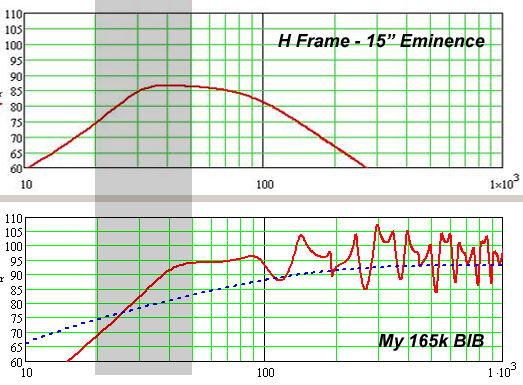

Martin, is there a reason you chose to compare such small U and H frames to such a large OB? I suppose you could argue the wings of the U and H frame contribute to their size but the comparison doesn't seem entirely fair
Two reasons.
1) I was trying to build off of the two way passive OB design to see what could be gained or lost by using an H or U frame.
2) To me, a 20" wide OB is a very attractive size and I think going narrower for a passive set-up is sacrificing bass response. So I was trying to compare what I consider real world high performance design options.

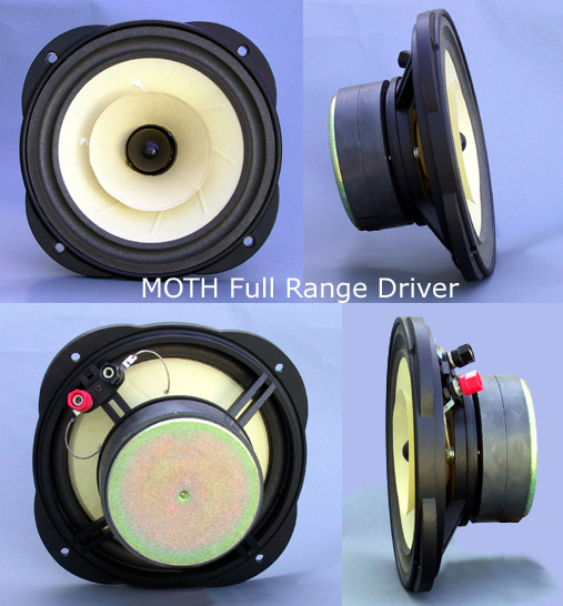

Hi MJK,
I really like the look of your design here, both the aesthetics and your measured performance.
The Goldwood GW-1858 woofers will be in my hands in a week. I'm mating them up with an open baffle pair of MOTH drivers. I already own the MOTH's and wanted to give them a try.
The published specs for the MOTH's are not accurate. GM measured his pair at:
Re= 11.2 ohms
Le= 0.13mH
Fs= 47.3Hz
Qms= 9.6
Qes= 1.23
Qts= 1.09
Sd= 201 cm^2
Vas= 58.5 liters
Cms= 1.03 mm/N
Mms= 11 gramms
Rms= 0.34 kg/s
BxL= 5.42 N/A
SPL= 91dB
Any thoughts regarding the MOTH drivers for the OB portion of this design?
Thank you!
-David

MJK said:David,
The Moth driver in an OB sitting on the H frame should work fine. The only thing you need to pay attention to is the relative efficiency of the two drivers. I had to apply 6 to 10 dB of boost to the H frame to match the efficiency of the Lowther ML TL, so you probably will need to use an active crossover. The reason I have been focused on smaller full range drivers is that they are less efficient so in the future there is the potential for a passive crossover option.
Thanks for the positive feedback,
Meant to include this original comment from Martin in my post. BTW, I'm planning on using an active crossover. I'm looking for thoughts regarding the specs of the MOTH's in post #103.
Thank you!
-David

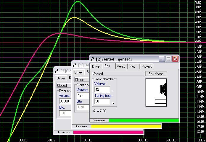

Well what do want to know ? Qts =1.1 pretty much rules any
sensibly sized box design but is near ideal for a big open baffle.
Some form of aperiodically leaking box well stuffed might work.
Re is very high = an ~ 15 ohm driver.
Xmax linear and mechanical would be nice to know.
http://www.stereophile.com/floorloudspeakers/104moth/index1.html
Fig 4 is PITA to interpret, I wish it was not normalised to on axis.
It does indicate somwhat off-axis will be better, but so might be
on axis and some trap fiters at 2.2 and 10 KHz.
I cannot work out the bass loading.
🙂/sreten.
I cannot work out the bass loading. edit : Well it does appear
to be vented, exaggerating the upper bad peak and giving
the knee around 30Hz, done for power handling I assume.
I cannot work out why 50Hz tuning increases output down
to 30Hz but not around 50Hz, no expert on high Q tuning.
Shown is very large baffle, sealed and vented.
🙂/sreten.

Why not just put the Moth into a 30,000 L box. It sims nicely.
Har har...

Based on those T/S parameters, I think the Moth driver will mate well with the Goldwood H frame. The 91 dB/W/m efficiency is about the same as the Jordan JX92S and the Fostex F120A and FX120 which are all aout 89 dB/W/m. So based on that limited information, I would probably just substitute the Moth driver for the Jordan driver on the same OB and use the active crossover to blend them together. I would use the original 2nd order crossover frequencies and slopes given at the top of Figure 19 in my write up and probably just increase the boost to the H frame form 2.5 dB to 4.5 dB. That would be my starting point and you can then adjust the crossover by ear until the system sounds best in your room.
Godzilla said:Why not just put the Moth into a 30,000 L box. It sims nicely.
Har har...
I would use the Moth on an Open Baffle or the design that it was made for. I have the plans somewhere... but can't seem to find them. I do like the idea of the Moth on OB with the Goldwoods in H frame. I think it will sound splendid.
I first looked at building a BIB for the MOTH's. With GM's very considerate and helpful guidance in the MOTH BIB thread, the idea went bust. They need a 9^3ft box and even then did not sim well.
OB seems like the only way to go with the MOTH. I was very excited to read about Martin's H-frame work with the GW-1858. Seemed like a fit.
Nelson says the MOTH's PM6A's sound is very good, but a notch below an actual Lowther PM6A. But hey, with a $1000usd price difference we cannot have everything.
Thank you for your help to steer a noobie in the right direction.
-David
