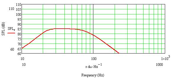

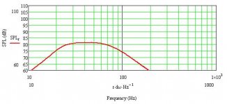

Valleyman, is that measurement for the 18 or 15 inch Goldwood?
If not the 15 inch could you run a sim on this please.
http://www.parts-express.com/pe/showdetl.cfm?Partnumber=290-346
TIA,
Godzilla

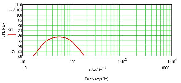

Hi Godzilla
That sim is for the 18. I can run one for the 15 no problem, but I can't find info on the BL anywhere. Goldwood don't seem to provide datasheets for their drivers...
I think it will sim pretty similarly to the 18", just with lower efficiency (and max SPL). That seems to be the tradeoff they have made with the smaller driver.

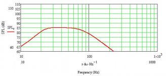

Seems I was wrong... that last FR i posted was in fact for the 15" goldwood, not the 18"... Here in fact is the sim for the 18". Electrical LR4 @ 75Hz.
As I suspected, very similar but with more efficiency. It's not all that surprising though as the drivers have very similar parameters. (btw calculated BL for the 15" is around 10.65)

valleyman - I have also been frustrated that Goldwood doesn't provide enough T/S params to use Martin's worksheets. I tried emailing them earlier in the year to obtain both the BL and Sd params for the GW-215/8 without a reply. Unfortunately I don't have a woofer tester yet and can't get these figures for myself.
To sim this woofer I used a calculated BL of 6.167 which isn't close to the 10.65 which you came up with (so the sim I got wasn't anywhere near as good). Can you post how you came up with the BL? I used Martin's T_S_Consistency_Check_Vad worksheet; fed in the published Fs, Re, Qms, Qes, and Vas; and used an Sd guess of 820 cm2.

Does your sim show the efficiency of the driver is about 81db per watt? I am going to use a dedicated sub amp and want to make sure I have enough juice.

I used Unibox to work out the Bl. I just double checked it and got the same result. Also double checked the sim for the 15" and it came out the same
The efficiency is only 81dB with the 15" so a reasonably powerful amp is probably needed

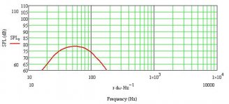

valleyman - Oops - I just realized that the woofer I sim'd is different than the one Godzilla linked to. I sim'd the GW-215/8; Godzilla linked to the GW-215/40/8.
The GW-215/40/8 is a better woofer for a H-frame. Once I entered the same params I got the same result.
Godzilla to answer your question, using the H-frame lenght of 11.25" you specified earlier I also got a sensitivity of 81 db/w.
Godzilla - to add to the previous post: you can use GW-215/40/8 and go to 200 Hz if necessary using a 120 Hz LR2 crossover (the rising response of the H-Frame is reduced by the xover). Above 200 Hz the response of this H-frame (again 11.25" in length) drops approx. 20 dB by 400 Hz.
Unfortunately this woofer in the H-frame is relatively insensitive and it has an advertised X-max of 3.5 mm. At 100 watts input this system has a sim'd output level of just over 100 dB and sim'd woofer displacement over 4 mm for all freqs below 45 Hz. Martin (MJK) has argued in many posts that, in practice, this is much less of a problem than it may look. In contrast, John Janowitz (of AESpeakers) disagrees with this. There has been a very interesting discussion of this over in the AudioCircle.com site in the Open Baffle Speakers area (see http://www.audiocircle.com/circles/index.php?topic=59619.20).

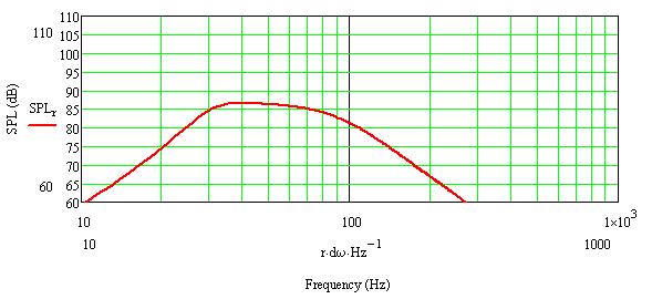

Here's the Alpha 15. Less extension, more efficiency than the goldwood 15".
So we seem to have:
Goldwood 15": Low efficiency, good extension
Alpha 15: better efficiency, less extension
Goldwood 18": best of both worlds
It's worth noting though that the goldwood 15" is quite a bit cheaper than the Alpha 15. Going for a straight OB tends to sacrifice extension for efficiency, so the Goldwood 15" in OB could end up looking like the Alpha 15 in H frame for less money and in a smaller package.

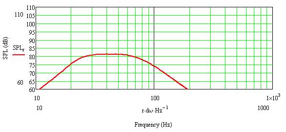

Here is a sim of the Goldwood 15 in an OB, same size as the H frame (17.5x17.5). Strangely enough it has less extension and less efficiency than the H frame.
Upon rereading Martin's article, I notice that the OB used is actually both wider and taller (20x40) than the U and H frames it is compared to which gives rise to the greater efficiency. Running the sims with this baffle show it to be around 83dB.
Martin, is there a reason you chose to compare such small U and H frames to such a large OB? I suppose you could argue the wings of the U and H frame contribute to their size but the comparison doesn't seem entirely fair
