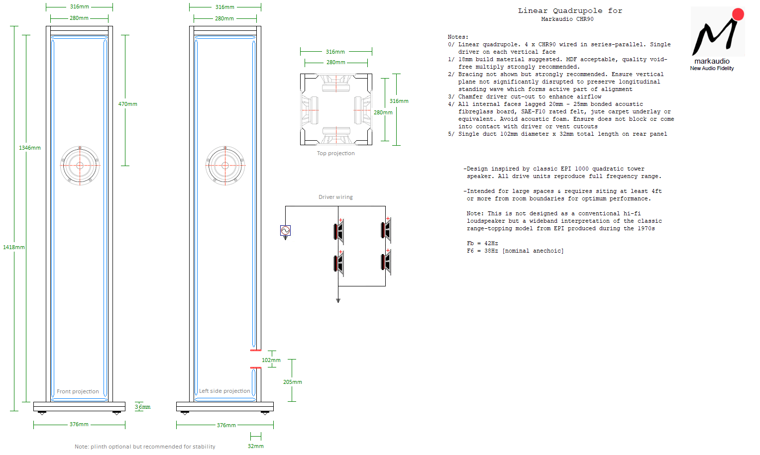

Any monitor size designs for the Alpair 10.3 with a folded MLTL design?

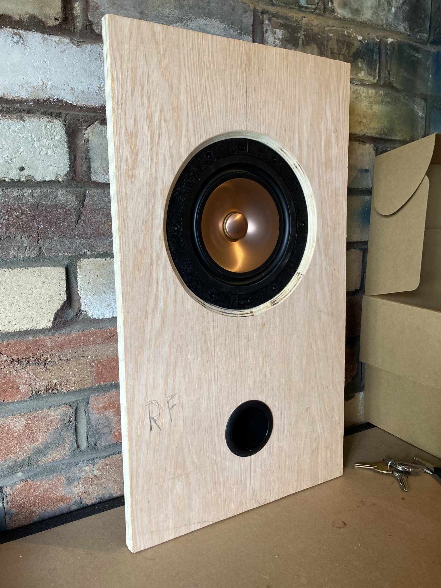

Apologies for the topic hijack, but I thought I'd update on this post; I finally received my CHR-120s! Super impressive. Love that they look like a monster version of my gold 7MSs.

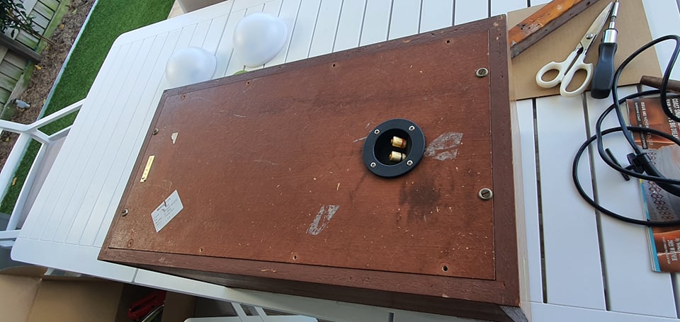

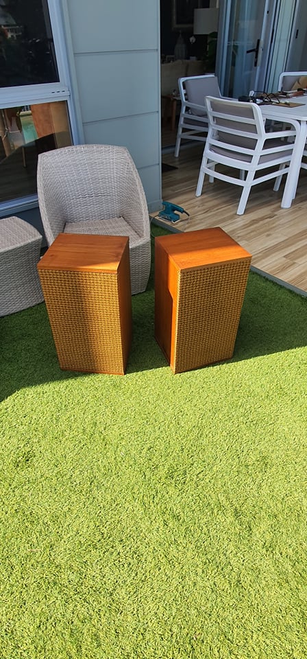

This is a budget resto-mod job so my expectations aren't sky high but I'm certainly hoping the drivers can bring the cabinets back to life in a meaningful way.
I'm curious to try the original Pioneer SX-440 amplifier which was purchased at the same time as the cabinets - I've found a restoration kit on eBay which could be a fun parallel project.
Pandemic travel permitting I'll be travelling interstate to my father's place to fit the new baffles and drivers in the next month or two 🙂
The grille fabric is still in great condition and will be reused. Port is on the front as they'll be against a wall. Any recommendations for stuffing?
Update from interstate where I posted the CHR-120 drivers and new baffles up to my father for initial fitting tests!
I am visiting next week to help finish off which will include better sealing in the cabinets and then to start listening.

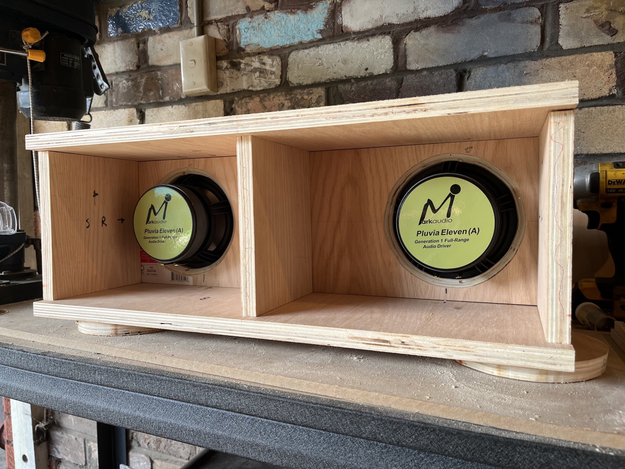

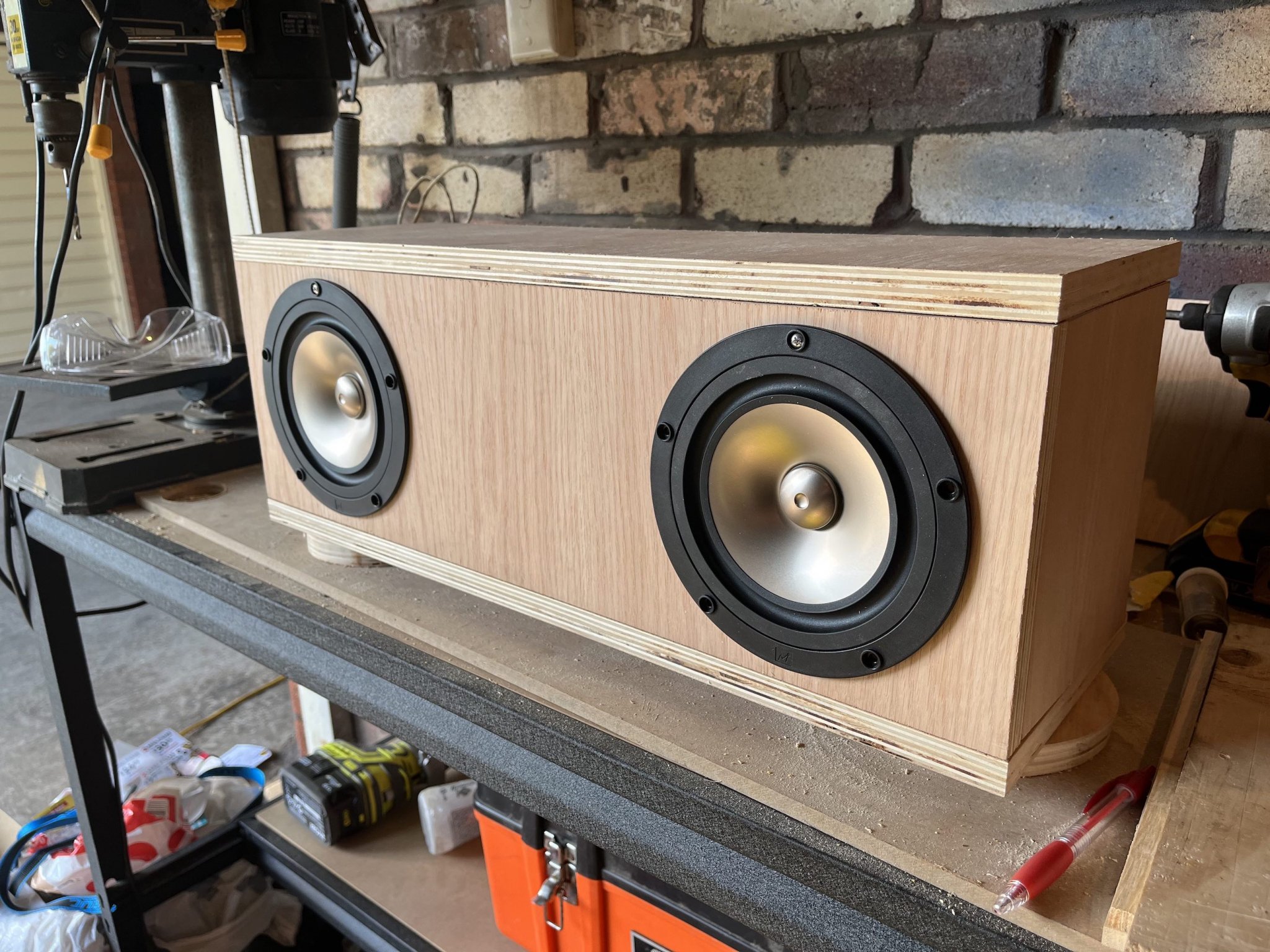

Also, I have just kicked off another build for a portable speaker using Pluvia 11s and the Compact Monitor 0v8 design... more to come 😎

I'm hoping the claimed reduction in directivity from MA on the P11s is helpful here - this speaker will be placed in situations where I will be moving around (office, garage, outdoor in the back of my car [12v], etc.).
Amp is a TPA3116 based 2ch board with bass and treble controls so I can dial the end-product in a bit more. Expectations aren't huge, this is more of an exercise in taking a "Misc" design and making it a little more misc!
