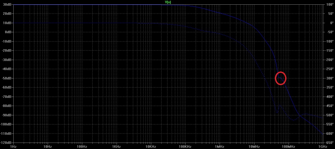

Hi everyone,
I've made the analysis of the main nodes using Tian probes, and the results are fine to me, but when I put a voltage source at the input (AC 1 0), I have a peaking at 50-60 MHz? Why? 🙁
Maybe the Tian probes are showing me wrong results, I've checked all main nodes, they seem fine and now I have this peaking, and I don't know it's origin. Can you help me?
All the results look fine to me too.
The peak at 50-60 MHz is way below 0 dB, this is not uncommon from feed forward or similar usually minor effects.
Such peaks are not a problem themselves but sometimes are a clue to some other problem.
I don't think that is the case here.
There is a minor effect that Tian probe does not consider.
The Middlebrook GFT probe (not the usual probe from 1975) does consider this and I will practice on your amp and see what I learn.
May take a while, I am not very familiar with it yet.
Best wishes
David
... caused by the improved current mirror, without it it doesn't appear.
Thanks for that, quite educational.
I have seen this mentioned in one of the Cordell threads, but didn't really think about it because I have only used simple current mirrors so far.
I think this is in line with my earlier comment - not a symptom of any problem, just a minor effect and your amp should be fine.

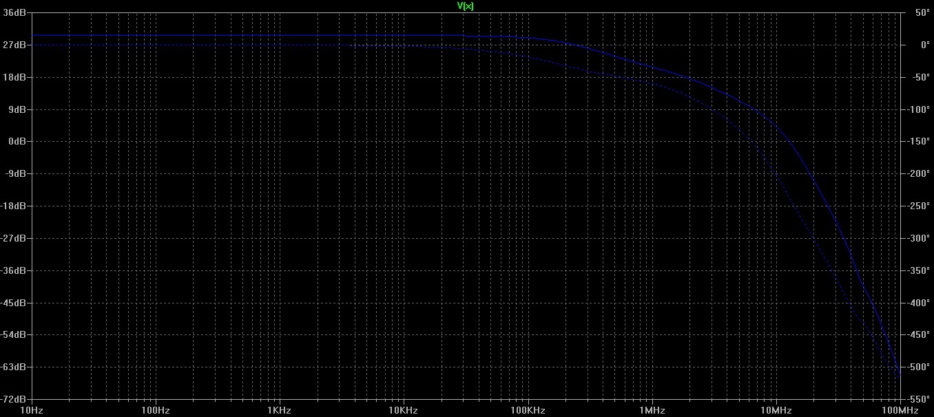

Hi everyone,
I'm also doing a smaller version of my MOSFET design, but with a BJT output to use as a headphones amp to incorporate in my project, but it seems to have a VAS instability related to the OPS I'm using, to have a little more stability I have to add a zobel network from base to collector in the drivers, I don't know if I want to use a capacitor in parallel with the VAS resistor, what I should do?
PS: LTSpice schematic attached

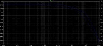

Hello David,
At the moment, I don't think I have any further (useful) information to add as to what causes the positive phase, but I have to admit, I haven't thought about it a great deal.
Other than, in my opinion, the plots where the loopgain phase is positive are still 'correct'. To measure the margins, I just use the 360 degree point, rather than 0 degrees.
Attached is an example plot. In this case, the phase margin is approximately 54 degrees (414-360), and the GM is approx 15 degrees (measured at the freq where phase=360).

...measured at the freq where phase=360...
Phase is a bit arbitrary of course.
And, like you, I found the "adjusted" value to be usable.
So it is probably "correct", in the sense it's mathematically consistent.
Perhaps the confusion arises because what I think of as polarity inversion is presented as a 180 shift and the phase looks to move the reverse of what I expect.
Write me if you have any more ideas, it bothers me that I don't quite understand such a basic issue.
Best wishes
David
