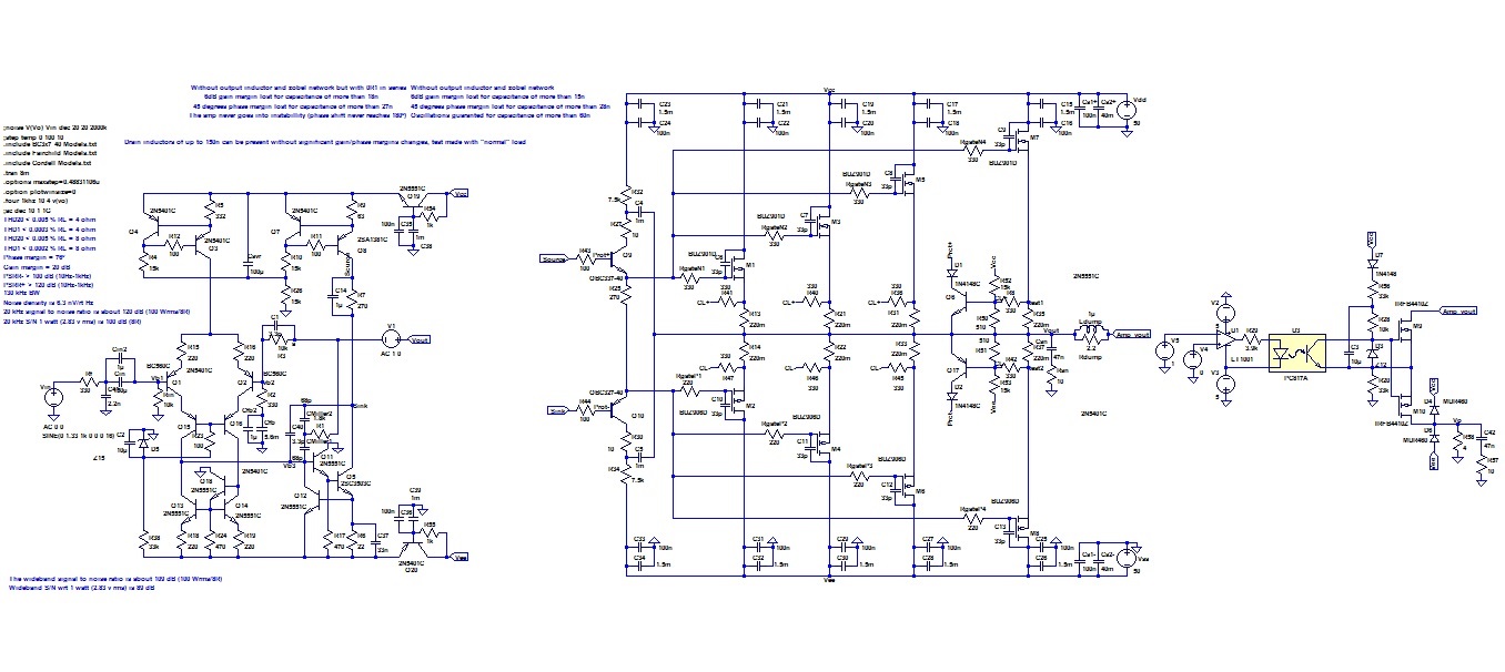

Hi everyone, thank you for your help,
Why are there 1GF capacitors connected to Q2 of the input pair?
They are used to break the global NFB loop, I saw Michael Kiwanuka using them, but with a lower value. But if you think that's wrong, can you please tell me what I've to do?
PS: It's possible to create different frequency compensation schemes?
I only know, dominant pole compensation, output inclusive Miller compensation (I can't use this type of compensation, the amplifier will oscillate, but I know that many comercial amplifiers uses "IMC", also called Pure Cherry, like LM4766 IC for example), two pole compensation, transitional Miller compensation, I think that those last two can be bridged to have more phase margin at low frequencies, shunt compensation also known as lead lag compensation and the last one is Miller input compensation also called MIC, I've never simulated those last two. There is also a variant of dominant pole compensation with a zero added by a resistor in series with the Miller compensation capactior. My favourite form of compensation is BTMC a bridged transitional Miller compensation to have more phase margin at audio frequencies, but this increases the THD1 values 🙁
It's true that the 0dB point of the open loop gain should always be at 500kHz? I've mine at 2MHz (maybe a little lower), if I use 500kHz I've higher THD20 values, similar to the values produced by dominant pole compensation. 😕
There's any formula to calculate the TMC resistor?
I'm using f = 1/(2*pi*CMiller_series*Acl*Rltp) [Hz]
CMiller_series = 34 pF
Acl = 30 V/V
Rltp = 234R
Rtmc = 1/(2*pi*CMiller2*2*f) [ohm]
CMiller2 = 68 pF
f = 0.7 MHz
Rtmc = 1K7 (I'm using 1K8)

...can you please tell me what I've to do?
Only what I have already recommended.
I find it effective to draw a simple block level schematic of the circuit to work out exactly what loop you want to probe. It's easier to be think clearly at this level about what you want to do.
Then the trick is to think about how to correctly place the Tian probe in the LTSpice ASC to examine that specific loop.
Correct placement means you should not have to "isolate" the loop with enormous inductors or capacitors, their use is both inaccurate and also prone to actual mistakes.
The Tian probe itself calculates and allows for forward and back transmission, so placement rather than attempted isolation is the key.
I would NOT use those capacitors.
I like to start with a simplified circuit with all the clutter removed, like the power supply capacitors that have no effect in your simulation because the V sources are perfect anyway, unused Spice directives, comments, protection circuitry. etc
Probe that to make sure each loop is OK.
That is, plot the Return Ratio for the outer loop, the OPS loop, the VAS loop.
That makes it easier to isolate an anomaly to a particular loop.
Your crossover frequencies look reasonably safe to me, so far.

Hi everyone,
Thank you very much for your suggestions Dave Zan they were very helpful,
I've removed all the components that don't influence the signal path, and I've uncovered an instability at the VAS caused by the degeneration resistor, you can see the instability in the file attached (Amp7_5_12_probe3_instability.asc), I solved the instability with a 33nF capacitor in parallel with the VAS degeneration resistor, and now the instability seems to have gone, I've also tried to test a beta enhanced cascoded VAS that it's said to have a poor stability, but something strange happens, the phase plot is weird, and I can't understand the Bode plot.
Resuming I wanted to know your opinion about the 33nF capacitor in parallel with the VAS degeneration resistor and why I can't correctly probe beta enhanced cascoded VAS? 😕
I'm also interested about your opinion about the other loops that I've tested.
I've removed all the input capacitors present in the non inverting and in the inverting input.
I've probed the nodes represented in page 90 figure 4.9 of Bob Cordell's book.
PS:
The attached picture is the complete amplifier with the capacitor added.
Thank you once more Dave Zan for your great help.
Best regards,
Daniel

Hi everyone,
I'm with doubts in Amp7_5_12_probe3 I don't know were to place the Tian probe, I don't know if I should put it after or before the compensation take off point, can you help me here please, and about the other nodes I'm doing it right?
The results are strange with a cascoded beta enhanced VAS and for dominant pole capacitor. Why?

Hi David thank you very much for your reply,
It's a 33nF capacitor that I've added in parallel with the VAS degeneration resistor, because I've noticed instabilities without it, the problem is that I've never seen an amplifier with a capacitor in parallel with the VAS resistor, I'm doing some mistake in my VAS minor loop analysis?
The file is attached in a previous post amp7_5_12_probe3.asc, could you please take a look?
This is the subject of some discussion in the "TPC vs Cherry" thread.
It is recommended by some experienced people, Cherry especially.
I still do not understand all the complications.
Even Richard, despite his extensive experience, is a bit unclear.
So I have some work to do.

Hi everyone,
I've tested my amp without the bootstrapped drivers and know I don't have to use the capacitor in parallel with the VAS degeneration resistor. There's any problem with the bootstrapped VAS?
I've noticed that an amplifier could be locally stable in the VAS with the global NFB applied and unstable without it and vice versa, this is really strange, and another thing that I've discovered is that an amplifier with dominant pole compensation cannot be probed at the VAS with global NFB applied, otherwise I don't understand the results, the phase shift is positive 😕
With bootstrapped drivers the VAS also seem to have problems with the global NFB closed, and so I added the capacitor, when I looked at the VAS plot without global NFB applied (1GF at the inverting input) it was awful. Can you help me?
I also have an headphones amplifier with stability problems, and I don't know how to solve them, because I've peakings in the VAS plot when NFB is enclosed, with NFB open I don't have instabilities.

..I've tested my amp without the bootstrapped drivers and know I don't have to use the capacitor in parallel with the VAS degeneration resistor. There's any problem with the bootstrapped VAS?
I also discovered that your bootstrapped drivers are a source of unusual behaviour.
I have never tried this myself so it took a while to study
I recommend you drop them until the rest of the issues are resolved.
Then not only would the drivers be simpler but the VAS too.
Start simple and add complexity when you really understand.
Even apparently simple circuits have subtleties.

With bootstrapped drivers the VAS also seem to have problems with the global NFB closed, and so I added the capacitor, when I looked at the VAS plot without global NFB applied (1GF at the inverting input) it was awful...
Unless you plan to add a 1GF capacitor to your actual amplifier then I don't think this is useful.
Why do you persist with this?
