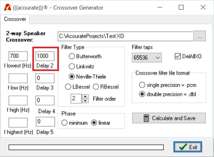

Earl, Merry Xmas!
Off the top of my head…take a 2 way speaker and design a linear phase digital XO implemented as a FIR filter as we want to adjust amplitude and phase independently. While I use Acourate, my limited understanding is that rePhase should be able to this. Choose a target frequency response as we want both test setups to have the same frequency response. The single unit under test here is the time alignment (i.e. digital delay) as follows:
Test 1 FIR – delay the woofer XO by some arbitrary amount like 1 millisecond for example. Sound travels roughly 1 foot per ms, so in the 2 way that puts the acoustic center of the woofer about a foot behind that of the tweeter relatively speaking. I can do this in Acourate, but not sure if RePhase can do this. Then linearize amplitude (to target fr) and phase, generate FIR filter.
Test 2 FIR – identical to Test 1, except the digital delay is set so that the woofer and tweeter are exactly time aligned. Again linearize fr and phase. Generate the 2nd FIR filter.
Using JRiver or other Convolver, load Test 1 FIR filter and listen to your favorite tunes. In JRiver, one can switch FIR filters on the fly while music is playing with a small (silence inserted) interruption.
My claim is that there should be a) an audible difference between the 2 filters and b) the time aligned filter will sound better than the delayed bass filter 🙂 Even though both amplitude and phase have been linearized.
I can do this in Acourate where I can correct both amplitude and excess phase, but can also independently adjust the delay (by the number of samples) in each leg of the XO like this:
I then use the same target frequency response and excess phase correction settings in both filters with the only change being the delay. Not sure if this can be done in rePhase. While in Acourate, I can apply the delay before or after amplitude and excess phase correction, for the purpose of this test, the delay should be applied first and then linearize amplitude and phase.
Of course there are several things to keep track of, ensuring the FIR filters are level matched, etc.
Thoughts?
