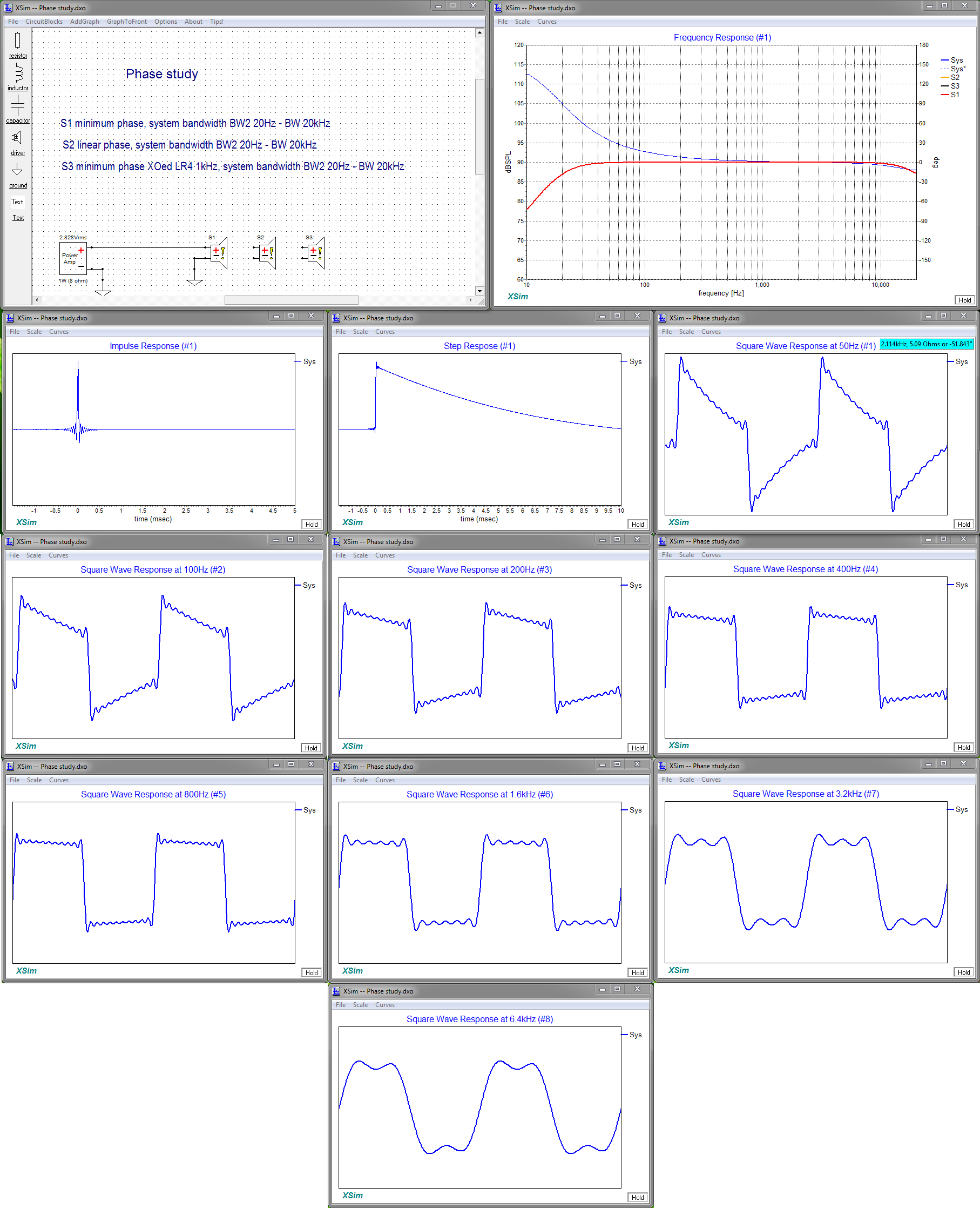

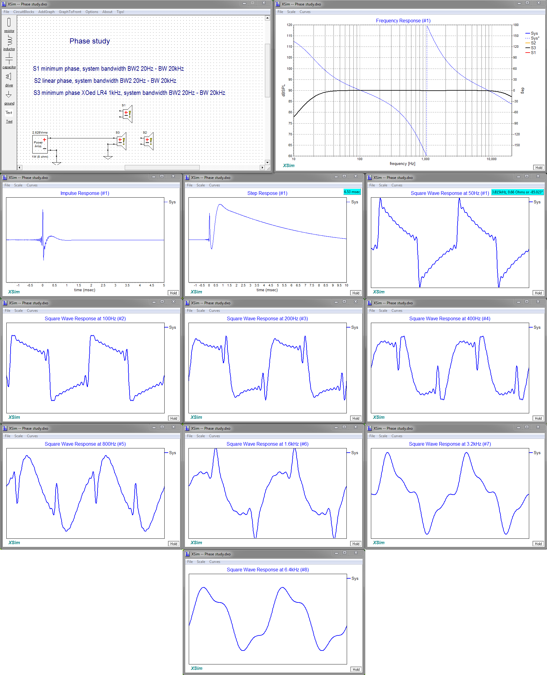

Some modeled visuals for the phase talk : )
All three examples has system bandwidth 20-20kHz and BW2 stop band slopes.
First is a two-way minimum phase with LR4 XO at 1kHz.
Second is minimum phase full range system.
Third is linear phase system.
Personally enjoy a 2-way system with 3" full ranger 10F/8424 combined 10" woofer SPH250KE, and run it linear phase all way to that systems stop bands as in third example.
Also is attached a zip-folder with dxo-file to open in free XSim http://www.diyaudio.com/forums/multi-way/259865-xsim-free-crossover-designer.html (a bit fun and action with all the windows open when one switch between the three drivers).
