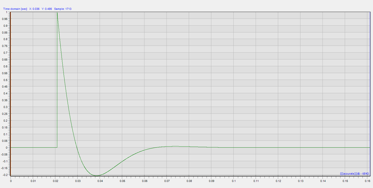

So what does the ideal STEP look like? For that I look at a loop back of my DAC signal back to the REW microphone input with a simple cable and do a sweep. When I do that I get this graph:
When I set everything in my processing chain to linear phase with a flat response I get this:
Not entirely the same, but close. I do not listen to this (though obviously I tried it) I have a preferred room curve that has been discussed on another thread and as shown I have the "Excess phase removal" stage set to minimum phase.
What I actually listen to looks like this:
And has a wavelet result (of the stereo pair) that looks like this:
Not bad results in a living room I'd say. As measured at the listening position.
I can show a result deeper than -20 dB but that will show you the ugliness of my room .
