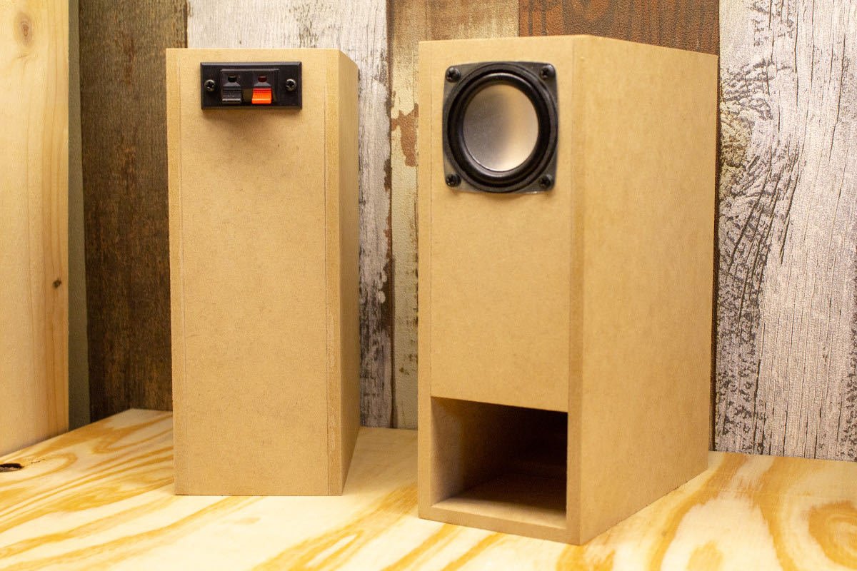

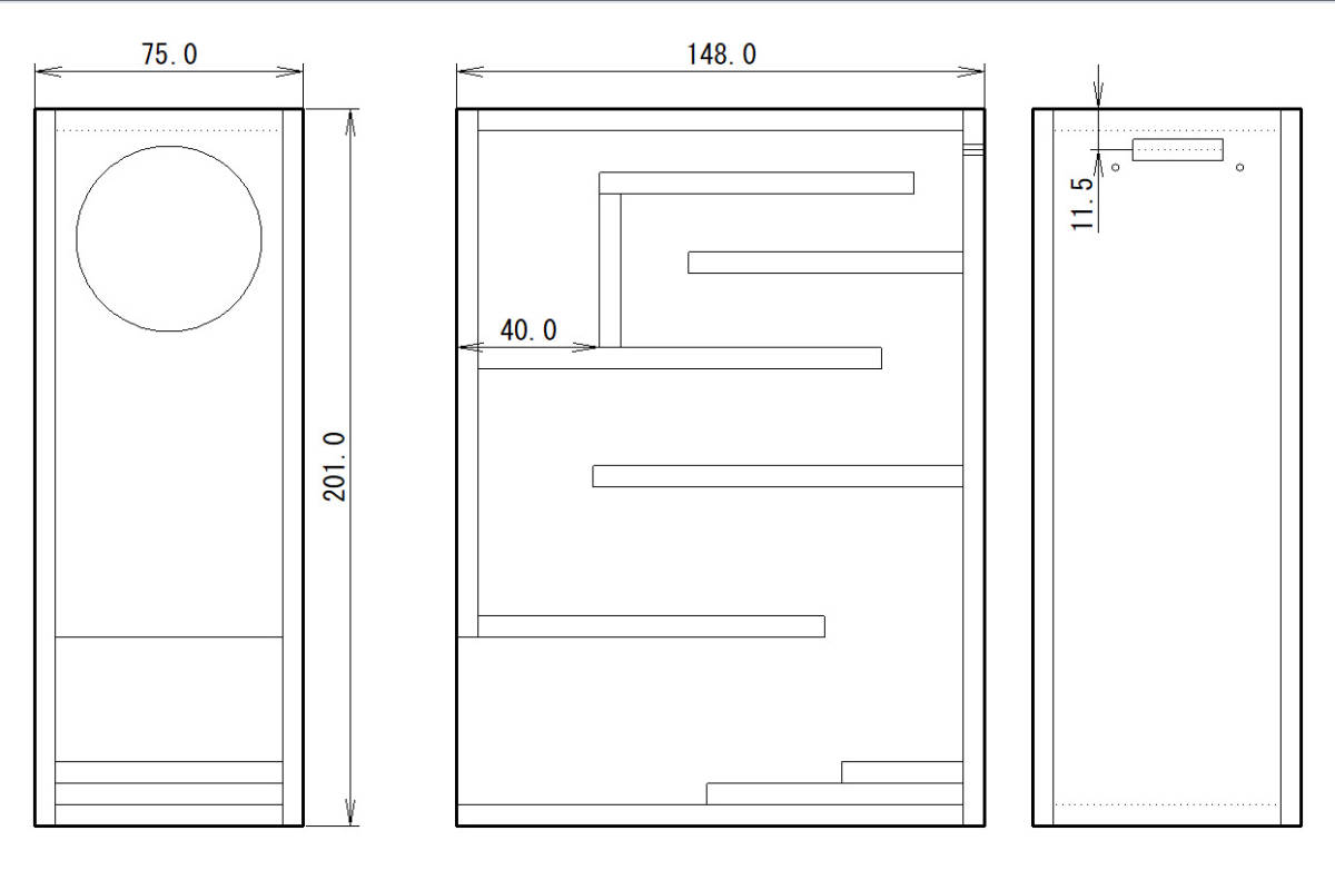

Can you 3D print wood onto MDF, or PVA glue it to MDF, resulting i n a hybrid printed/non printed speaker?
How much does it cost for sufficient filament to make a box like that?
About 250g for the small one.
The one in post#1 about 1 kg per box.

We did one by 3D wood printing, just yesterday.
Hi Patrick.
Wow, excellent work.
Do you use sound absorbing material?
In the front chamber.
Patrick, I understand.
I hope you can listen the sound you like.

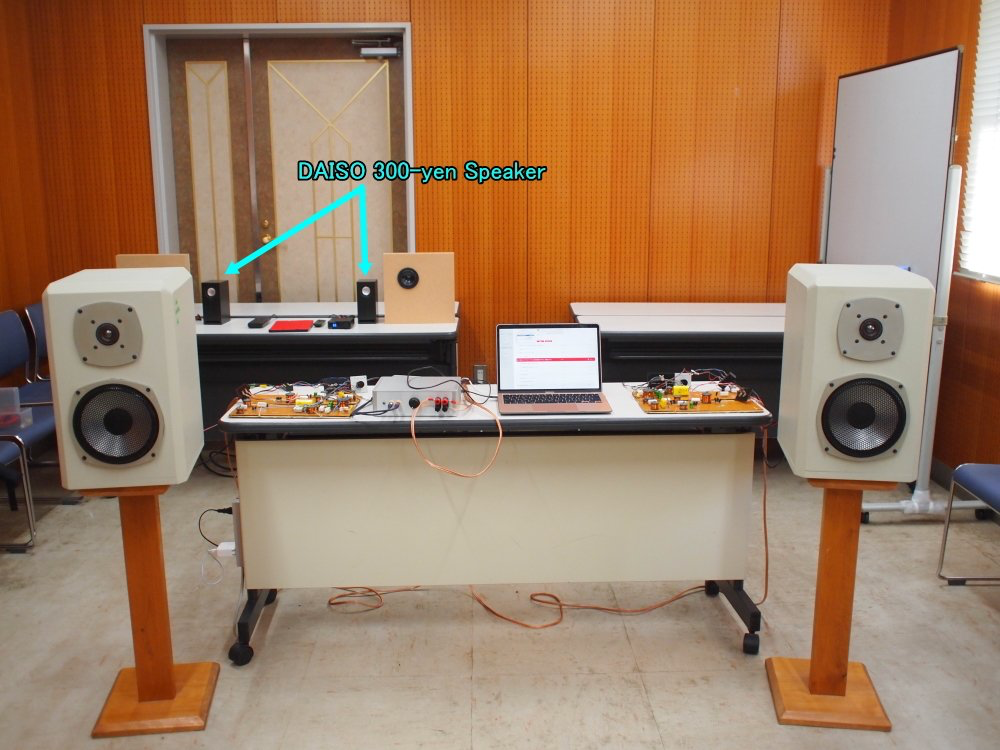

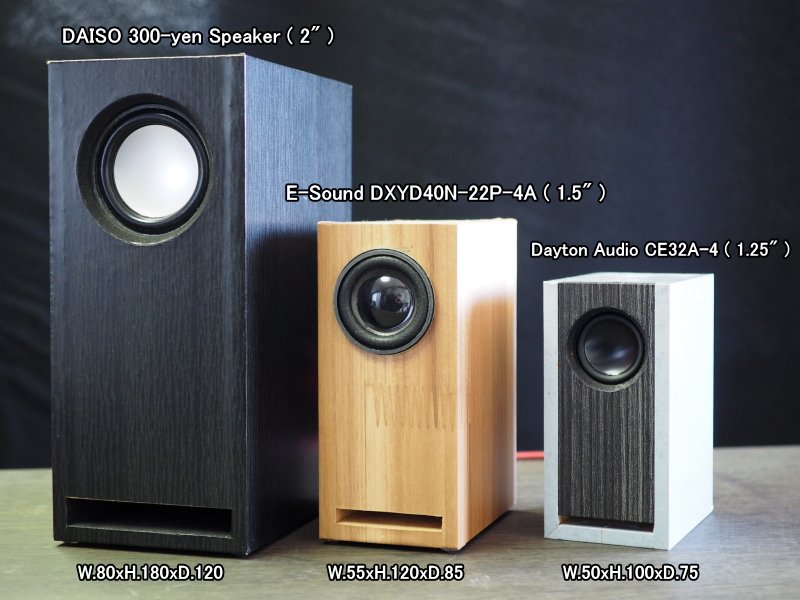

Hi Freedom666.
I think it is a dream to achieve a better sound at a smaller size & lower price.
My goal is to exceed a high-end system like B with a very inexpensive system like A.
System A
System B
Hi ChrisABC.
The comparison video with JBL K2 S5500 is not DAISO but E-Sound DXYD40N-22P-4A (1.5").
Since it has a 1.5-inch diameter, it does not produce bass sound at all, but it produces enough sound for vocals.
Of course, it does not produce loud sound.
Hi Patrick.
This is a summary of your introductory video.
[DAISO 300-yen (2.2 USD) speaker]
"Quite narrow bandwidth as expected.
Distortion is also high for music appreciation.
Sound pressure was also insufficient.
The sound quality in the mid-range is unexpectedly good for video viewing and videoconferencing.
Perfect performance for 300 yen."
By the way, I do not agree with the above summary.
There is enough bandwidth for listening to music, and I don't feel any distortion.
The sound pressure is also sufficient for my needs.

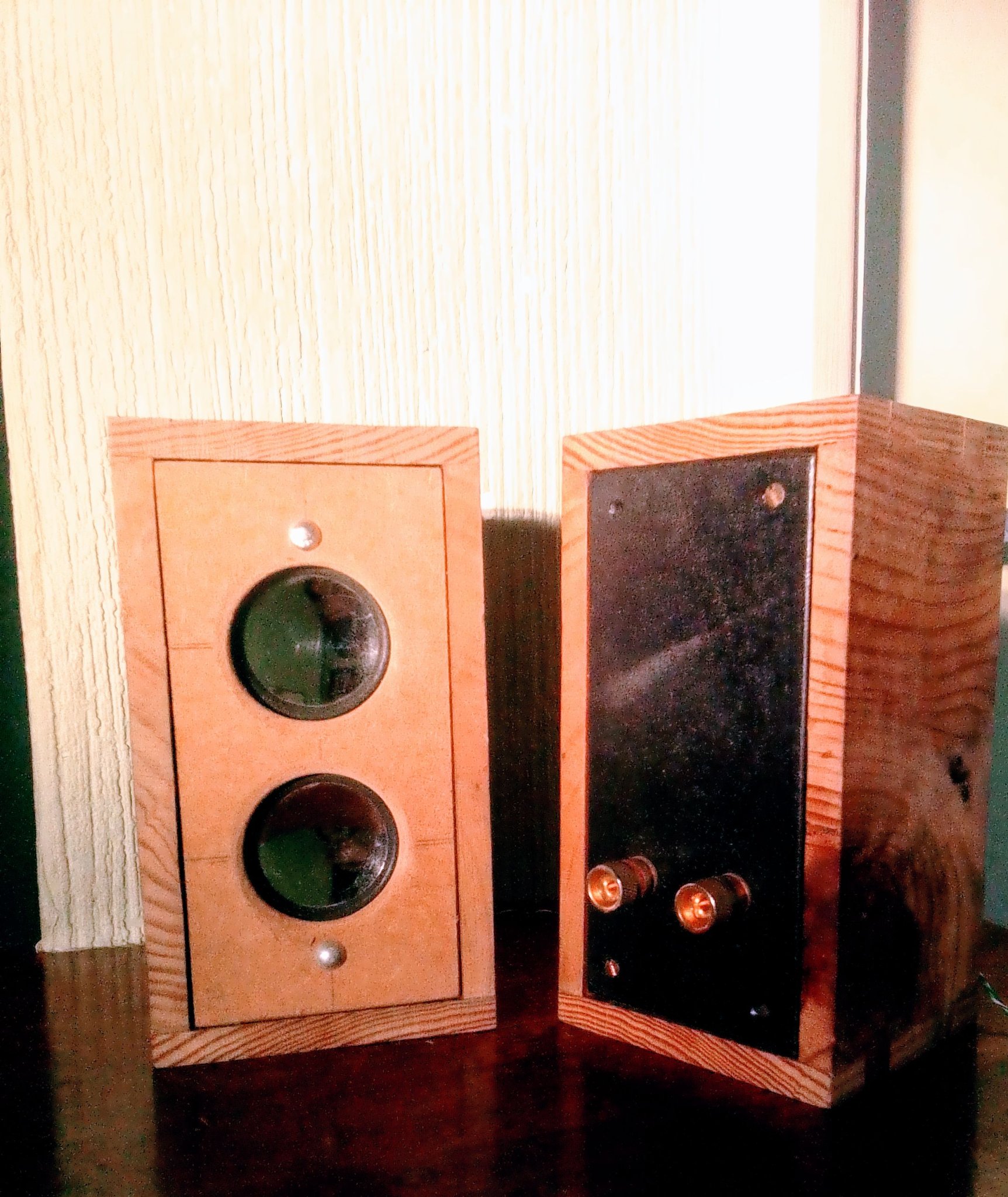

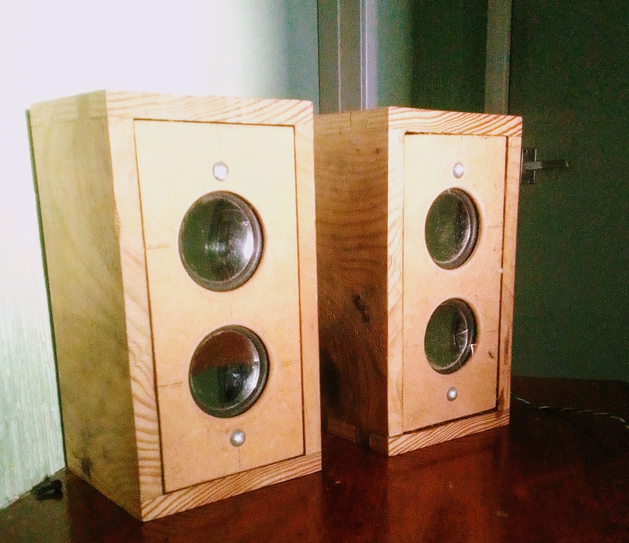

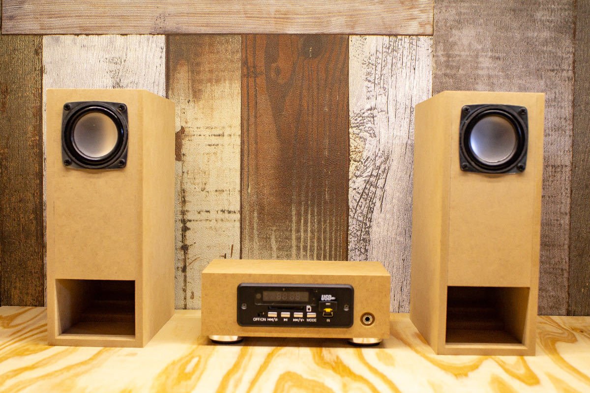

These are small speakers that I made ages ago utilising the drivers from a portable speaker that are much the same as that used in the DIASO speakers. The are inspired by the BBC LS35a, in that the front and backs are mechanically damed from the main enclosure, the front is held on by tension springs, the back is screwed on, both have foam gaskets. The drivers are wired in series, with a 1.5 if cap across the bottom one.
Hi cracked case.
What is the sound quality like?
I couldn't remember what they sounded like so I've wired them up and giving them a listen. I had Nirvana (live in New York), very crisp sounding. They have a bit of sibilance, so I used a graphic equalizer to dip around 6,000 Hz and they're very neutral now. The bass limes were quite well revealed dispite the obvious lack of low end - obvious from the tiny size, not the sound.Hi Patrick.

Hi cracked case.
Thanks for the feedback.
It's nice to be able to enjoy music even with speakers that don't have sufficient specs.
- Full Range
- Mini speaker - Japanese 100 Yen shop "Daiso" - 300 Yen speaker's modified model
