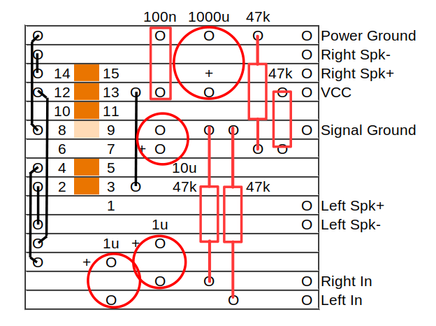

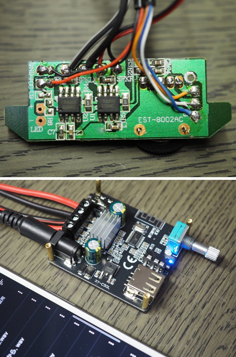

With the TDA7266, we know that the drivers are loud enough even with 5V supply.
That means USB power is sufficient.
We do not want to use those cheap amps provided with the speakers.
So we built our own PAM8406 to suit our own needs.
It is housed in a small 3D printed box, with an aluminium plate on top.
A flexible thermal pad helps to transfer heat from the IC to the aluminium cover, acting as heatsink.
The USB power is LC filtered (on the bottom side of the PCB), separately for each channel.
As it is meant to be used with computer / laptop, (digital) volume control is at the source, and not with pots.
