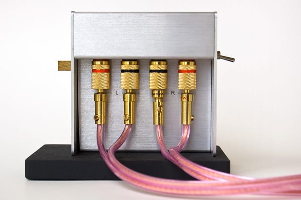

Nice Amp

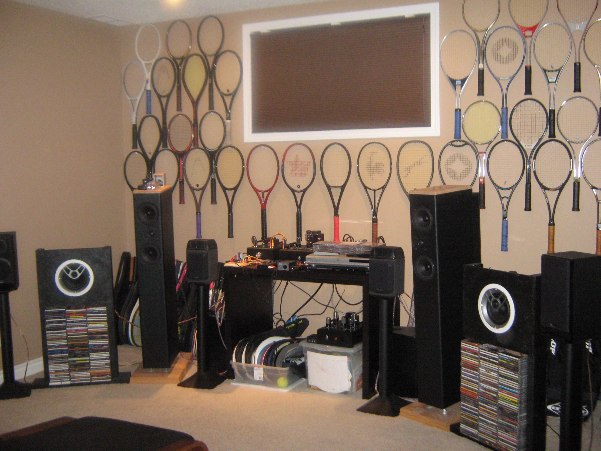

Here's some of my stuff,
Modified Ariels, PolkMC60 Open Baffle, Pure Acoustic 900S (these are just a little taller than Rogers LS3/5a) with Radio Shack 40-1354, 1mfd cap , 20 ohm 10 watt damping resistor across tweeter terminals + lambs wool stuffing

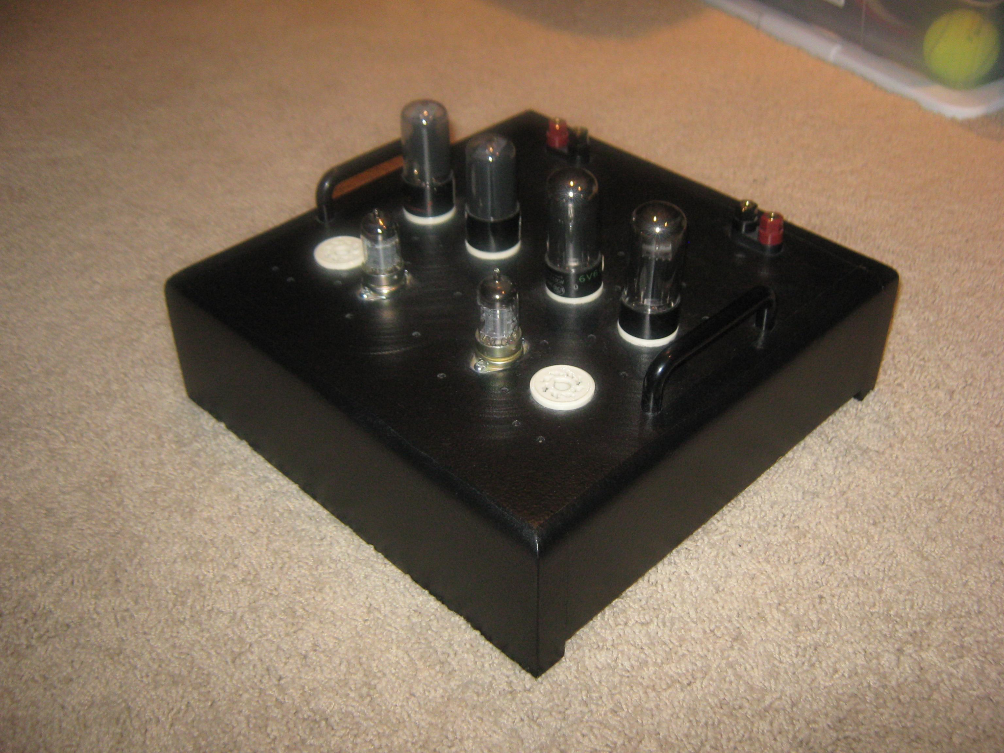

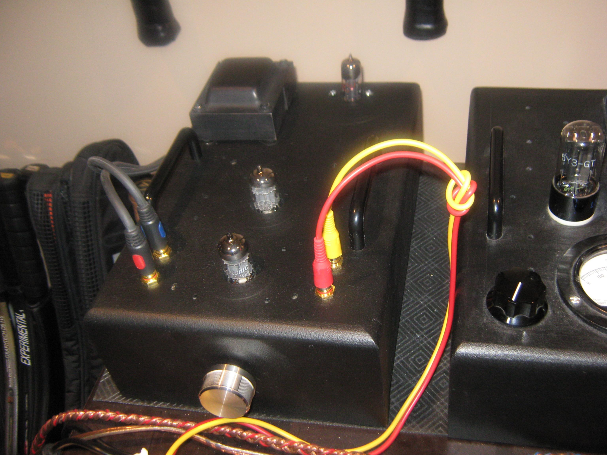

Tube amps , 6sn7 or 6fq7 with reg ps,12ax7/12au7 preamp,
Regulated Power Supply<==> plug & play 6v6 pp or 6aq5 se or 6bx7 pse (not shown)
Easiest speakers-Open Baffle

reg ps,6sn7 or 6fq7 with reg ps, 6aq5 se

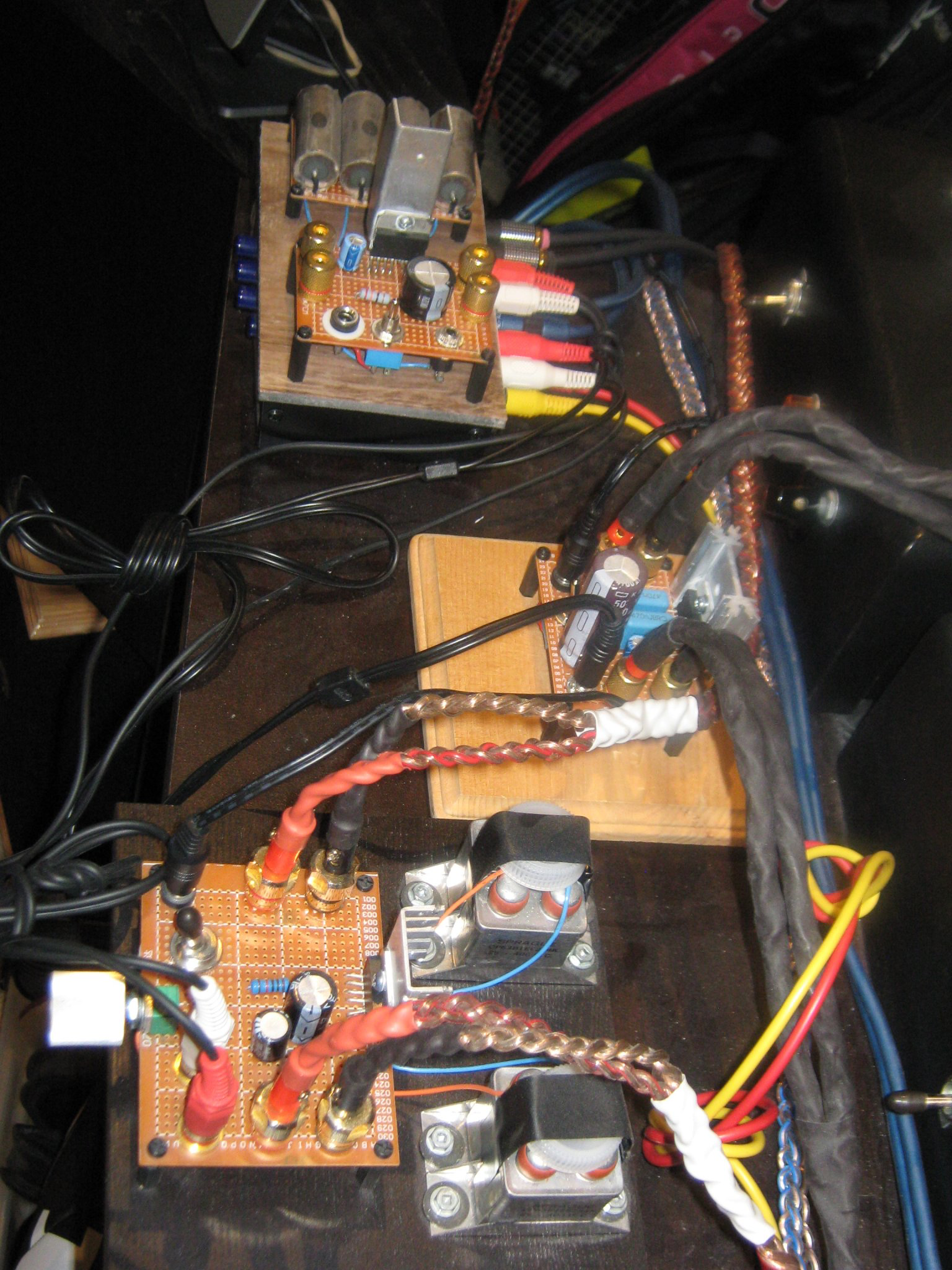

TDA 7377
You can build them with bigger heatsinks

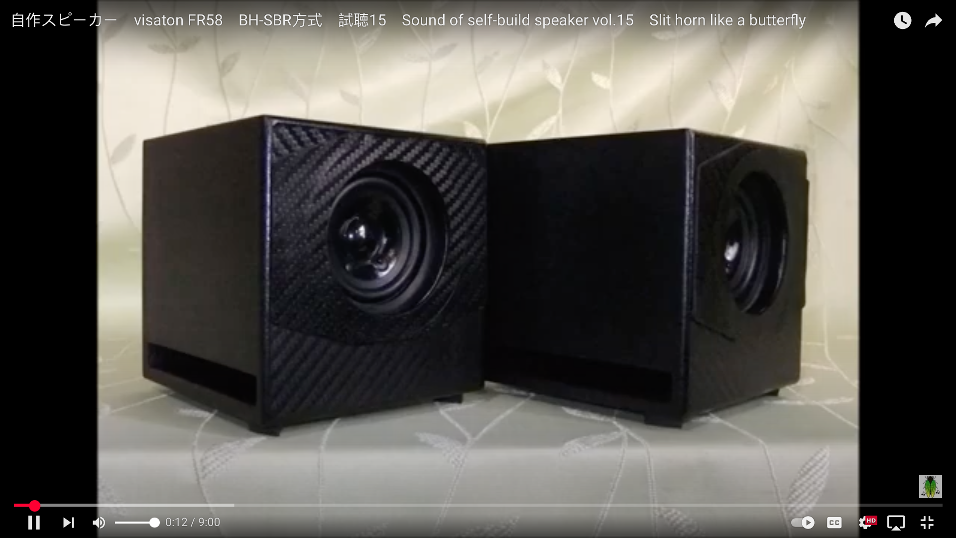

Tiny Horn Visaton FR58
I realized once again that air recording is not useful as a reference unless the equipment used and recording conditions (microphone, installation distance, etc.) are disclosed.

Thank you for introducing your work.
I'm more interested in the tennis racket than the audio equipment.
Does the racket vibrate or resonate?
