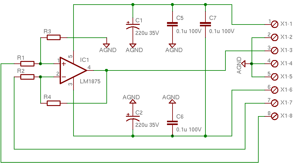

Mini LM1875 design
Ex-Moderator
Joined 2005
Since everyone seems to be talking about the LM1875 lately, I just came up with a very compact layout for a simple circuit using the LM1875. Attached is the schematic.
Attached is an image of the layout. It's a double sided board (red is the top layer and blue is the bottom layer) utilizing surface mount components. The board dimensions are 1 inch by 1 inch 😉
There are a number of things worth pointing out about the layout since you may miss them at first glance.
First is the use of rail to ground and rail to rail decoupling caps right next to the power pins. This is a good example of how to place the decoupling caps.
Second is the placement of the electrolytic caps very close to the power pins. This allows you to route short, low impedance traces to the power pins. Of course the physical size of the cap will dictate how short you can make the traces, so size the caps accordingly to your design requirements.
Third is the use of ground planes. If you look carefully in the picture you can see that the bottom layer ground pour connecting the electrolytic caps, the decoupling caps, and the power and speaker grounds is intentionally isolated from the other ground pours EXCEPT at the speaker ground. This ensures that all of the high currents are contained in that small ground pour AND that the other ground pours are at the same potential as the speaker ground, which is the ground reference. The 4 vias placed around the board connect the ground pours on the bottom layer to the ground pour on the top layer.
Fourth is the order in which nets are assigned to the connector. From left to right the connections are as follows: IN+, IN-, VEE, GND_VEE, GND_OUT, OUT, GND_VDD, VDD. There are 2 separate supply ground connections to accommodate a power supply with dual secondaries (this is actually my preferred type of supply). Take note that the speaker ground connection is very close to where the electrolytic caps connect to the ground plane to minimize the impedance of the ground returns.
Fifth is the position of the input and feedback resistors right near the input pins of the chip. This is good practice for any kind of sensitive inputs.
Sixth is the routing of the input signal traces away from the power supply traces as well as ground plane isolation between adjacent signals. The two input traces are purposely offset so that each is over a ground plane instead of on top of each other. This minimizes capacitance between the input nodes.

Hi BWRX,
WOW. Nice-looking layout!!!!! You seem to have been able to lay out basically everything in the most-ideal ways. Kudos!!
It looks like it's definitely time for me to start using surface-mount parts. What are the case-style designations of the ones you have used, on this PCB? Are there any slightly-larger sizes, that might be easier to hand-solder? Or is that not a big problem?
You have the LM1875 configured as a differential amplifier. Cool. Can it accept both single-ended (i.e. one side grounded, I guess) and balanced inputs? Or maybe I should just ask how it is intended to be used.
Could you explain, in more detail, how and why the grounding scheme works? I am very interested in that part. (And my eyes are getting bad-enough that it's difficult to follow, with both layers included on the PCB-layout image.)
At first glance, it looks like the 'input ground' will share a ground-return conductor with other ground-return currents, on the way to the power supply. Or maybe I'm wrong. Or maybe I'm not wrong but it works OK, somehow.
Oh wait! It's a differential amplifier! So the R3 ground SHOULD be referencing it to the 'new' output ground level. Nice.
Have you tried it, yet??!
P.S. Is there any reason that you might want to also minimize the capacitance between each input and ground, in addition to the capacitance between the two inputs?

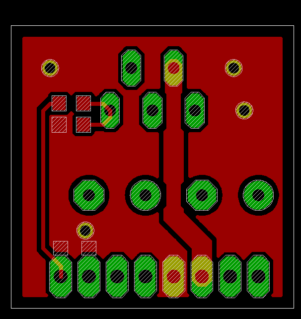

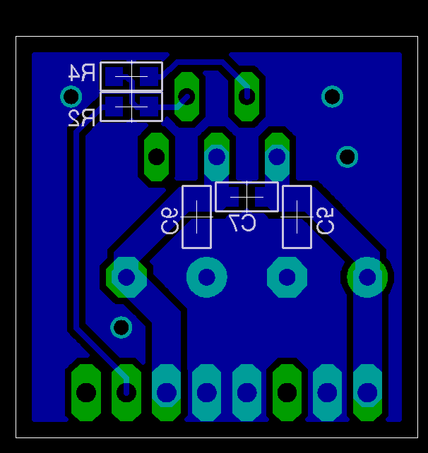

It is a little hard to see everything with both layers displayed. Attached a picture of the bottom layer so you can get a better view of the supply ground connections. It's just a copper pour connecting the supply rail grounds, the electrolytic cap grounds, the decoupling caps grounds, and the speaker ground.
Refer to my next post for comments about the ground plane on the top layer.

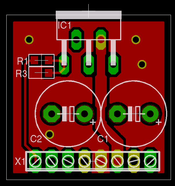

Attached is a picture of just the top layer. Look carefully at the pads of the electrolytic caps and the pads of the connector used for the supply rail grounds. I used keepouts around the pads so that they do not connect to the ground plane on the top side. This forces the high currents to stay in that small area of ground plane on the bottom side and allows the use of the top ground plane as a reference and shield. We want the ground reference potential to be the same as that of the speaker ground, which is why only the speaker ground is connected to the ground plane on the top side.
As you noted, a differential amplifier should reference to the output ground potential. That is why the one side of R3 is connected to the ground plane on the top layer.

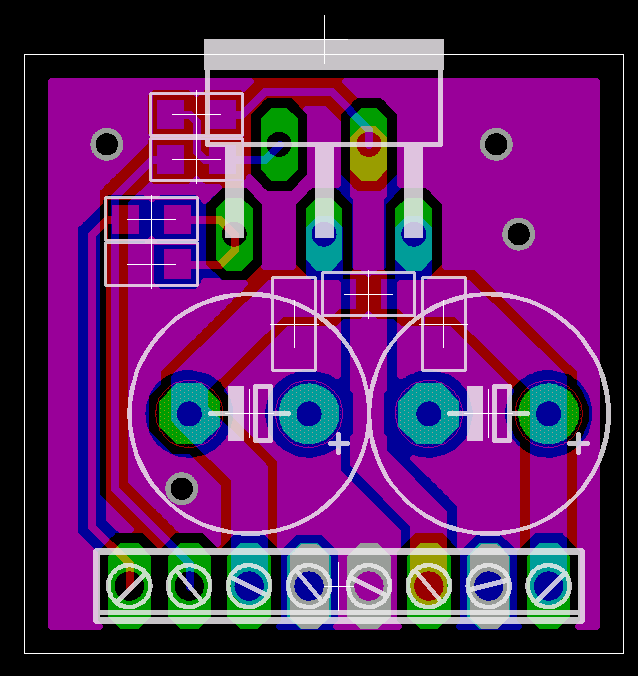

What you don't see on the picture of the layout I provided earlier is that there will be exposed areas of the ground plane next to each input so that they can be bridged to ground should you want to make a non-inverting or inverting amp (these are the most common anyway).
Attached is a picture of the top layer showing the solder stop mask. Areas with hatch marks will not be coated with solder mask. As I mentioned above, note the two small rectangular hatched areas above the input pads of the connector. A non-inverting amp would require R2 to be grounded, so you would simply bridge that connection to the ground plane. Likewise, an inverting amp would require R1 to be grounded, so you would just bridge that connection to the ground plane.

The stability criteria of the amp is more critical in an inverting configuration and you have neither a dominant pole capacitor accross the feedback resistor or a Zobel network on the output to be able to adjust the stability criteria should it end up being unstable..
If you are proposing it as a general purpose amplifer it should probably have a output inductor as well. Capacitive speaker cables and even some crossovers can cause the amplifier to oscillate if there is no isolation for the amplifer from capacitance on the ouput. Experiennce suggests than arround 10nF to 100nF is the level of capacitance that normall sets off these chip amps. So if you can be sure that the load capacitance on the output will not be in this region you should be ok.
It may work without these but it also might oscillate especially as you have ground plane arround all the pins which can couple the output signal back to the input in unpredicatable ways at high frequencies which again might lead to oscillation. This amp tends to go off in the 2-5Mhz region if it is going to go unstable.
I am unsure why you are concerned about capacitnace between the input nodes. It is normal practice to keep input traces as close together as possible as this reduces the loop area from which they can pick up noise. Having said this it is unlikey to be a problem in this design. I would however move the input to a seperate connector if it was my design to keep it away from the high power recified currents comming into the local smoothing caps.
Since this is not a high speed digital design I don't think there is any benifit to having a ground plane. There may be some benifit to guard tracks arround the input connected to ground but the rest of the plane is just picking up noise from the high currents flowing in the circuits and injecting it into the ground referance. I am open to hearing a rational for the plane but my experience has been that apart from arround the low power, high sensitivity front end of amplfiers planes should not be used and even then you need to really know what you are doing to use them sucessfully.
Having said that I do like the way you have isolated the decoupling ground from the signal ground using the different layers and there is no reason for the decoupling ground not to remain as a plane as it does not couple into the signal ground.
