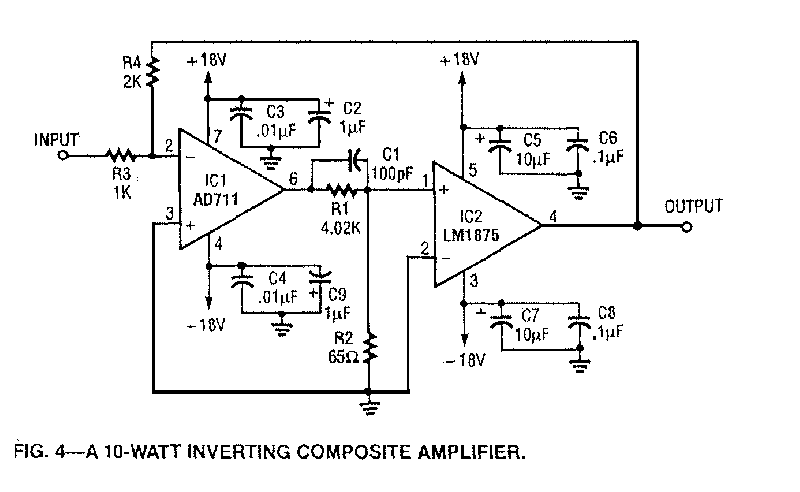

Is it possible to use the little LM1875 to drive a FET output, and at the other end, also have a buffer input?
Re: Question for BWRX
It would make much more sense to use the LME49810 or one of its siblings to drive a FET output stage, even though it's roughly twice the price of the LM1875.
danielwritesbac said:Is it possible to use the little LM1875 to drive a FET output, and at the other end, also have a buffer input?

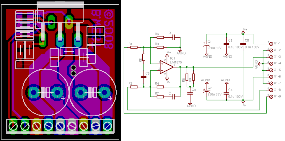

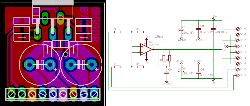

In terms of the design, I've decided to try two different layouts - a basic and a full version. The basic version is just the basic components and fits on a 1"x1" pcb. A picture of the basic version schematic and layout are attached.
The full version includes options for components suggested by others and fits on a slightly larger 1.15"x1" pcb. A picture of the full version schematic and layout are attached.
I'll be putting both layouts on one board and have them made using expresspcb's miniboard service, which is three 3.8"x2.5" boards, no silkscreen or soldermask, for $59.90 shipped (very fast turn around too). If anyone knows of a better place to have these proto boards made feel free to let me know 😉 Two basic and two full layouts plus another little layout will fit on each board. These will just be used for testing the design.
