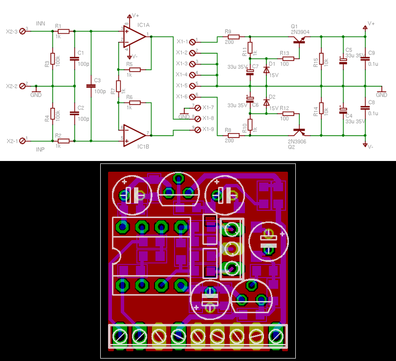

I just finished the other "little layout" I mentioned earlier. It's a differential buffer that when used with the LM1875 configured as a differential amp makes a 3 op amp instrumentation amp. This is the same configuration I'm using with my LM3875 amps.
I managed to squeeze all that stuff on a 1"x1" pcb, make the power connections line up with those of the other two LM1875 boards, and make the outputs of the differential buffer line up with the inputs of the LM1875 boards so they could easily be stacked.
That's an excellent question! I had originally planned to place a small mounting hole in the upper right corner of each board but it seems I forgot to do that while laying out everything
I guess since the board will be so small and light that just running the 7 wires down from the upper board to the lower board will be enough to hold it in place. What do you think?

7 off 0.6mm wires will be quite rigid. If you are unsure, then increase the hole diam to 1mm and use 0.9mm wire.BWRX said:That's an excellent question! I had originally planned to place a small mounting hole in the upper right corner of each board but it seems I forgot to do that while laying out everything
Hi Andrew. Thanks for the assurance 🙂 The diameter of the plated holes for the 9 pole connector should end up being around 1.1-1.2mm, so there's room for 0.9mm wire or maybe even a really tight fit of 2 0.6mm wires.

then use 1mm or 1.1mm wires.BWRX said:Hi Andrew. Thanks for the assurance 🙂 The diameter of the plated holes for the 9 pole connector should end up being around 1.1-1.2mm, so there's room for 0.9mm wire or maybe even a really tight fit of 2 0.6mm wires.
Much stiffer than twin 0.6mm. (~4times stiffer)

Any chance you could put some holes on the board in the resistor areas so we could tombstone some if we wanted to go with something other than SMD? I certainly don't mind using SMD parts (having built quite a few projects with them), but it'd be fun and possibly more versatile if you had the ability to throw some boutique stuff on there. I can't imagine it would drastically increase the layout size.
Mike
You can position through hole resistors vertically and solder the leads to the SMD pads on the board if you really want to (don't need through holes for that), but there is really no point if you use good quality metal film surface mount resistors. If you want to use some film caps for supply bypass instead of ceramic you can solder them to the pins on the underside of the board.
Well, I have used double sided foam tape under PCB's to mount stuff for lab gizmos in the past, so I probably shouldn't offer my opinion! 😀BWRX said:I guess since the board will be so small and light that just running the 7 wires down from the upper board to the lower board will be enough to hold it in place. What do you think?
Seriously, the wire hanging trick sounds like a winner. I am not even approaching being concerned about the weight of both of the boards being supported by the chip.
