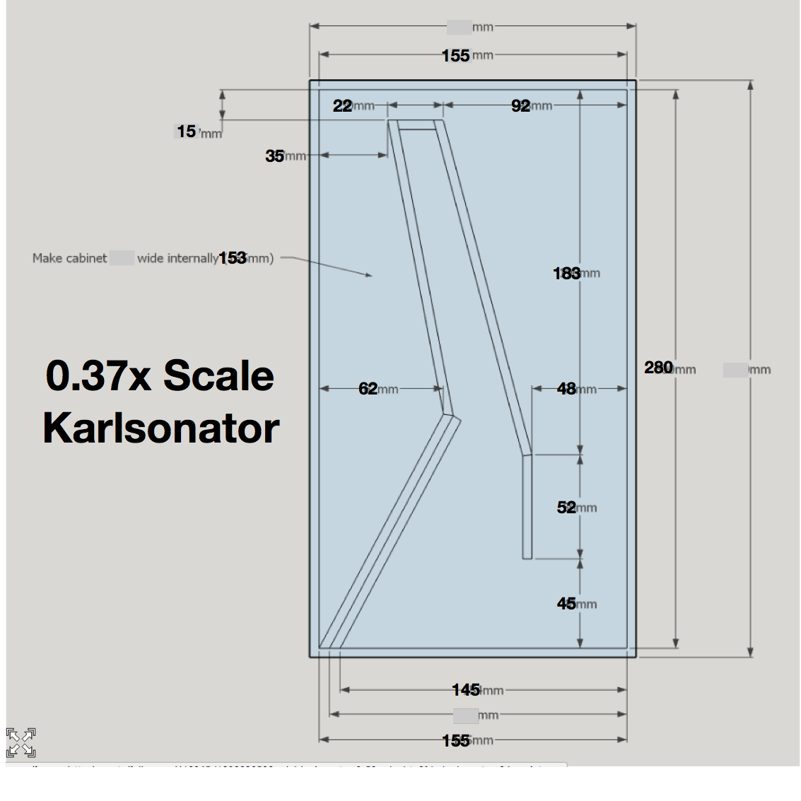

Here's a 0.37x scale from the 0.40x drawing. Please forgive that I simply just pasted the numbers over the existing ones... and, I only used internal measurements.
Will be building this one sometime over the weekend, if I have time.

I had a request to see how well an Alpair 10.2 would work in a Karlsonator. Based on the size and optimizing for a smooth response, a 7/15x or 0.47x scale works well. Looks like it could be a great sounding speaker - just watch the cone excursion below 60 Hz.
X, If you are able to take a pause from your amplifier endeavors... What are your thoughts on this .47 scale alignment loaded with an alpair 10.3 instead of the 10.2? Relatively, the 10.3 has a slightly lower QTS (.316) and also a bit less xmax.
Thanks,
Pete

I am on travel at present and do not have my computer with Akabak with me. I will look at it when I get back next week. My guess is that a lower Qts driver will have less bass reach.

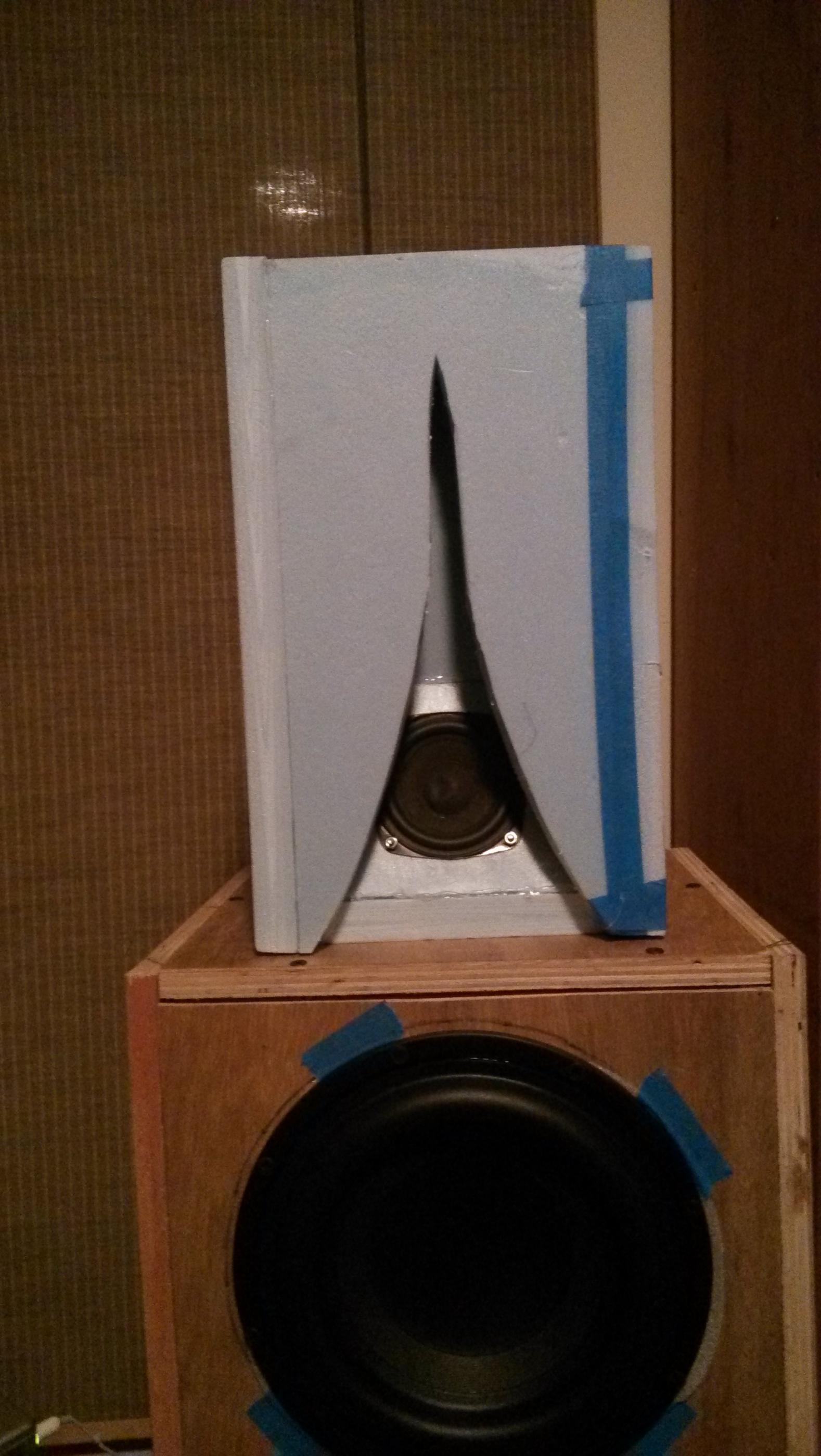

That looks like it should sound quite balanced. The shape of the apex of the K aperture affects the bass extension. What do you have now? Expand the cusp to a slot for more bass punch but less extension frequency wise. But the shallow roll off you have now will sound quite nice.
It does make a difference to build it according to simulations.
Simulations you've provided, thank you! So many of us are in debt to you and your prowess with Akabak.
This is the aperture I have at the moment... It was cut just before lunch, when I was quite hungry, and my hand wasn't exactly steady!
