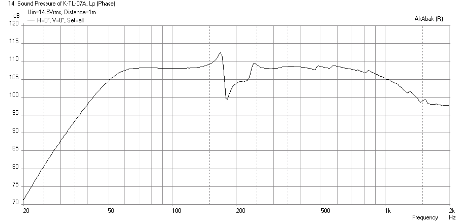

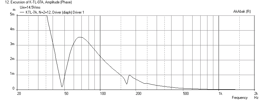

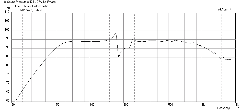

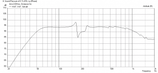

Monacor SP250p works well in 0.83x Karlsonator
The SP250p works very well in a 0.83x scaled Karlsonator (10/12 scale). Great sensitivity and decent bass extension. Can produce 108dB max at 14.5v drive if you limit with a 50Hz high pass filter, or don't play music that has deep content to avoid hitting the mechanical stops on the driver.
SPL at 1m with 2.83v:
Cone excursion at 14.5v:
Max SPL at 14.5v:
Max SPL at 14.5v:
