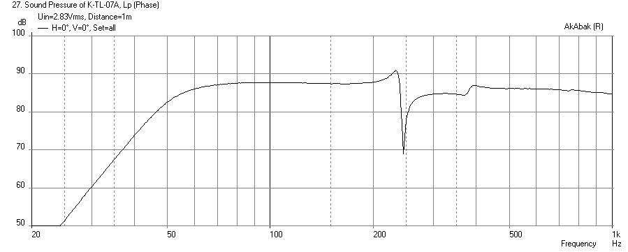

Karlsonator for CSS FR125SR
I received a request asking if the CSS FR125SR driver would work and what size box is optimal.
http://diyaudioprojects.com/Drivers/CSS-FR125SR/CSS-FR125SR-Speaker-Datasheet.pdf

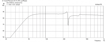

According to my simulations, a 0.53x scale in height and depth and 0.46x in width makes a nice box that has an F3 of about 59Hz but with superb bass amplitude of 88.7dB after baffle step losses - so no BSC circuit is needed. It should sound really nice - full rich bass.
Frequency response:
558496d1467825935-mini-karlsonator-0-53x-dual-tc9fds-k7tl-fr125sr-freq-0.53x-0.45w.png

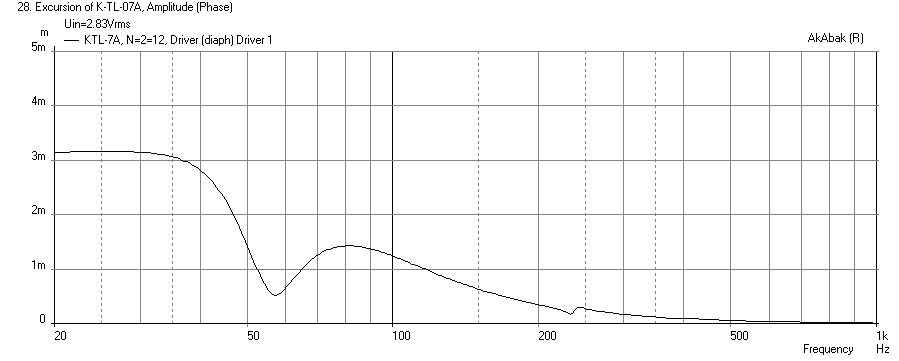

Cone displacement:
558497d1467825935-mini-karlsonator-0-53x-dual-tc9fds-k7tl-fr125sr-displ-0.53x-0.45w.png

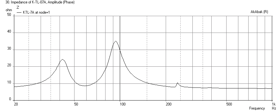

Impedance:
558498d1467825935-mini-karlsonator-0-53x-dual-tc9fds-k7tl-fr125sr-impedance-0.53x-0.45w.png
