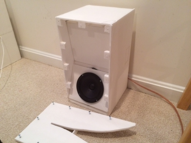

Mini Karlsonator (0.53X) with Dual TC9FDs
0.53x K'nator with PA130-8 Rocks!
Ok, surgery was a success and this thing is loud and great bass punch! Love it!!! 😀
One of the best values in full range higher SPL drivers.
Photos...

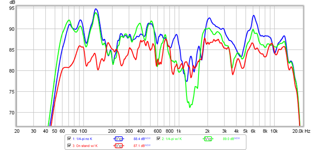

0.53x K'nator with PA130-8 Measurements
The 0.53x K'nator with K-aperture does a good job in the frequency response department: about +/-3.5dB over most of the range (this is very good for a K without any EQ). The response on the floor and against a wall(1/4-pi has enhanced bass but at the expense of a large floor bounce cancellation. When placed on a stool up high, the 1.2kHz dip goes away and the exaggerated peaks actually smooth out.
Here are the frequency response measurements (blue is without K-aperture, green is with K-aperture & on floor, red is with K-aperture & on stand):

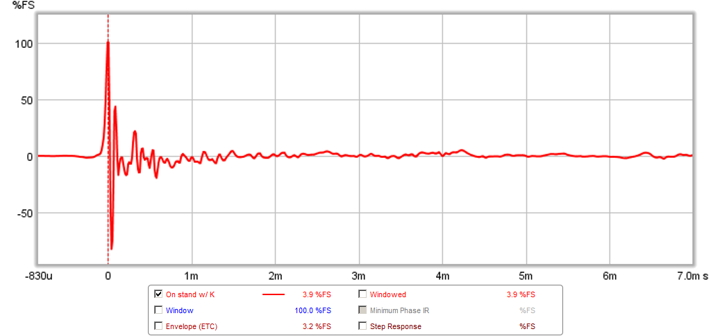

Here is the Impulse Response:
474640d1427700312-mini-karlsonator-0-53x-dual-tc9fds-0.53x-knator-pa130-8-ir-0.5m.png

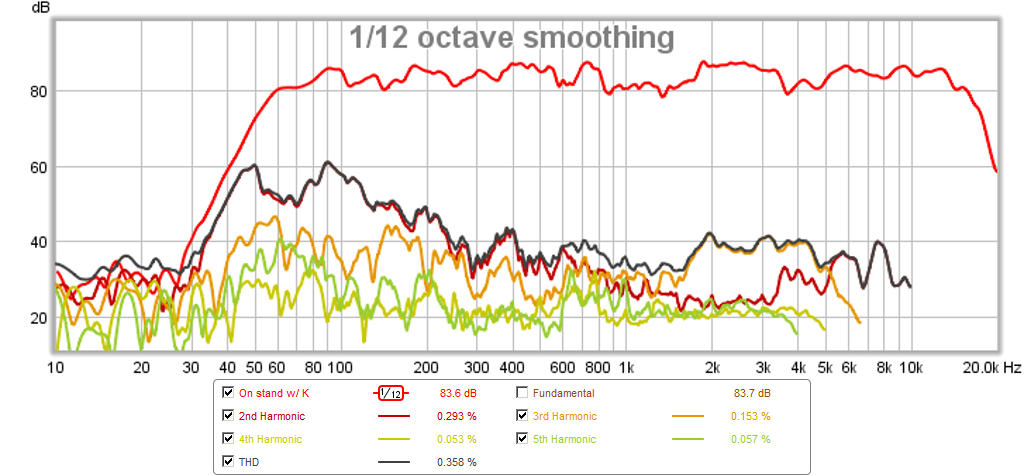

Here is the Harmonic Distortion:
474641d1427700312-mini-karlsonator-0-53x-dual-tc9fds-0.53x-knator-pa130-8-hd-0.5m.png

I think that the variation over the 60Hz to 15kHz is quite minimal given a K-aperture on the front. This helps contribute to a very clean musical sound.

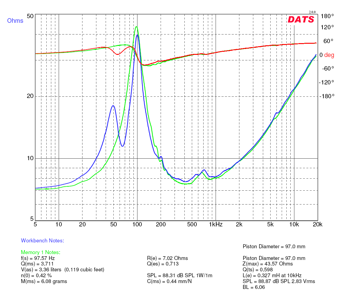

Here is the impedance sweep of the speaker (with bare driver sweep):
474644d1427701289-mini-karlsonator-0-53x-dual-tc9fds-0.53x-knator-pa130-8-impedance.png

I finally finished the matching pair for stereo. Sounds great - a truly easy to listen to speaker suitable for all genre's. Quite loud with a TPA3116D2 amp - very portable and easy to have a great music for a get together.
Foam Core Lab:

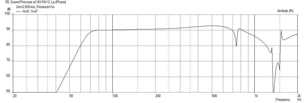

Good question, it has similar Qts to RS100-4 which worked very well in XKi. I will run a sim and see what I come up with. I think the XKi should be a lot more compact compared to a 0.53x K'nator. However, you may have to deal with a steep notch at the upper bandwidth where the vent tuning causes destructive interference. I like the PA130-8 in this setup so much I don't envision them leaving this box anytime soon. 🙂
A PA130-8 in an XKi needs to be tuned a bit higher at 73Hz but produces a pretty high bass SPL of about 90 dB down to 67Hz (-3dB). The box is 7in wide x 7.25in deep x 12in high approximately 0.35 cu ft - similar in size to a 0.4x Karlsonator. So quite small but with pretty good punch covering below 80Hz for ability to get the first overtone of 41Hz bass. Box uses 7in wide x 0.75in high x 9.0in long vent. 7.5 liter rear chamber and 2.5 liter front chamber. Max SPL is 98 dB at 2mm xmax.
Freq response at 1m and 2.83v:
In a way it's kind of like a more powerful 0.4x Karlsonator.

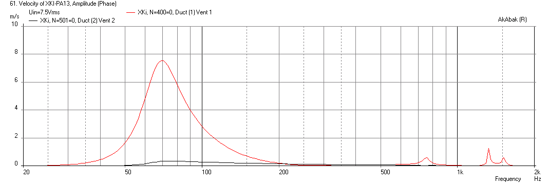

that should make a cool 2.1 system with a powered subwoofer - are those internal box dimensions? is that destructive dip prediction what I've seen in some K12 with too small area single vent?
this case was worse than a sealed rear chamber- it seemed to play and measure ok when I opened the area up a bit
The velocity in the vent shows up as a minor couple of resonance velocity peaks that will cause a little bit of cancellation at 750Hz and 1300Hz and 1500Hz. They will be minor dips though as you can see in the velocity plot for the vent.

That might be floor bounce? Have you ever tried elevating the speakers for a measurement? I was getting 18dB dips and tried adding foam in back chamber and did not help. Then I elevated it and it went away. Studio monitors are often on a stand about the same height. I wonder if that had something to do with it. If you put them on a desk, the desk bounce is like a floor bounce.

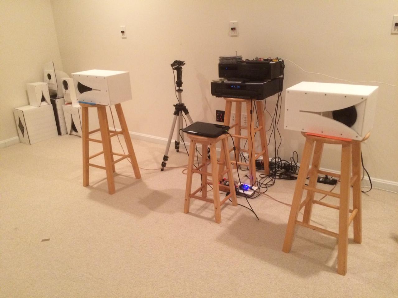

Have you listened to these laying on their sides with the open end of the aperture pointing toward the left and the right walls? I ran my Fostex FE166 K-Lines this way they sounded excellent with stunning stage and image.
No, I haven't before but I will give it a shot. You mean like this? The K-apertures work their polar magic when oriented vertically. Initial impression is that the central phantom image is more powerful in side orientation but sweet spot is smaller and walking around the room the phantom image is not as stable. I will give it a day or two in this configuration though. Doesn't sound bad at all though - surprising actually.
